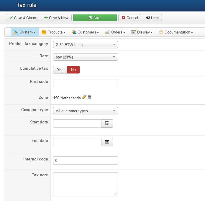

- only one tax rule.

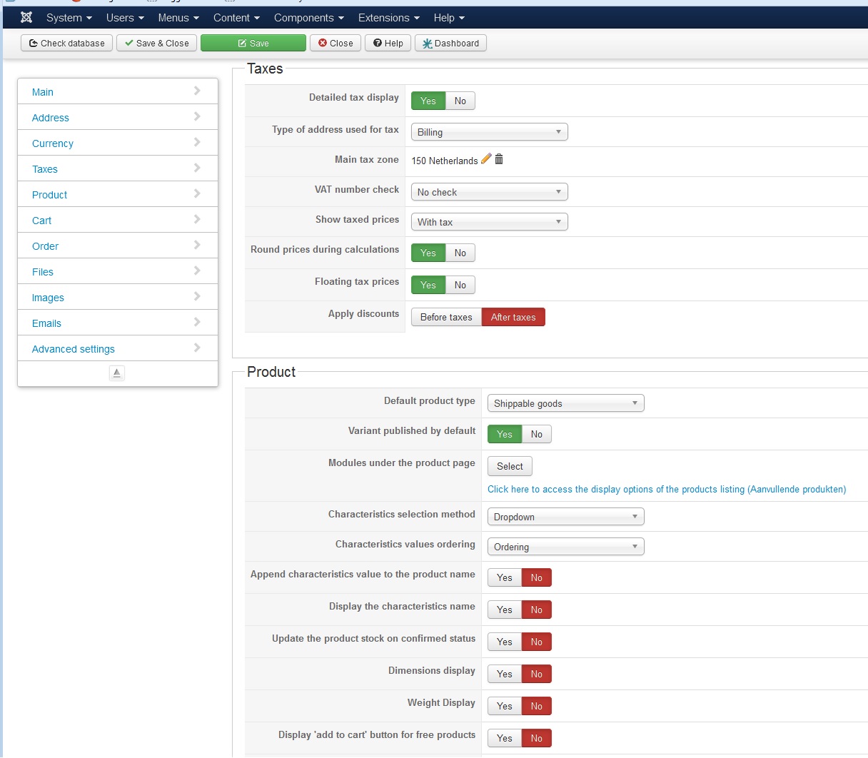

- each time I refresh the Address and Shipping Checkout page, the shipping price is lowered with the taxprice : initial €2.50 , first refresh €2.07 (-21%), second refresh (€1,71)
- each time I change the paymentmethod (is also an refresh) the shipping price is lowered and the tax recalculated.

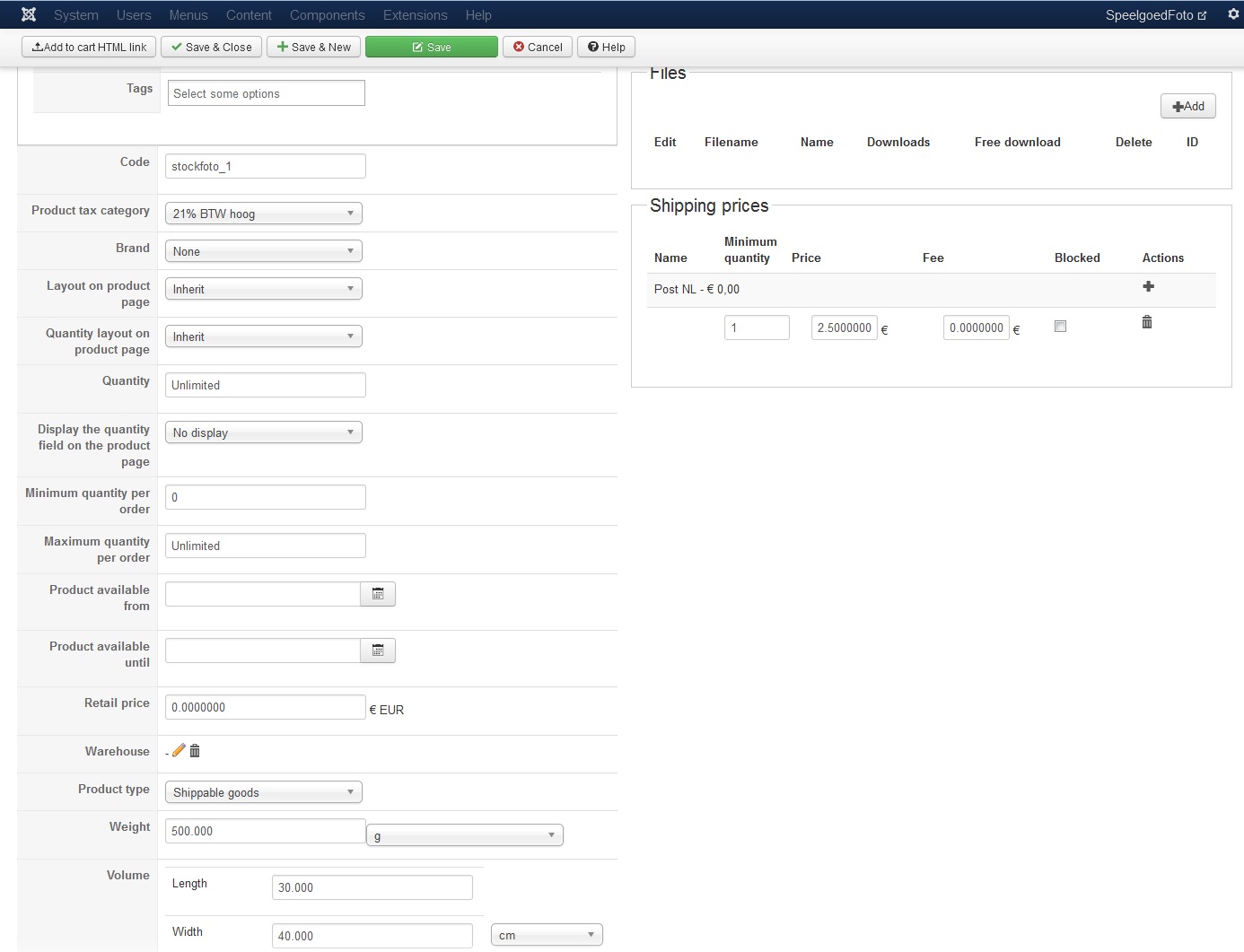

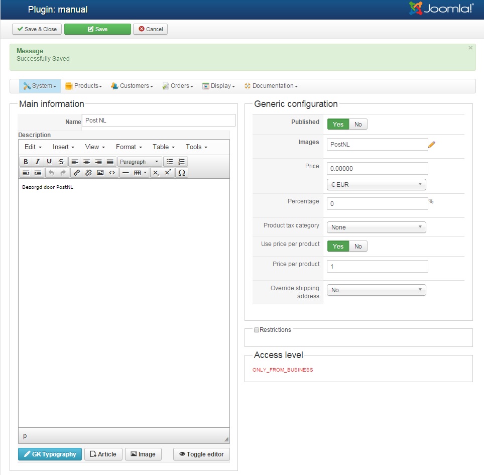

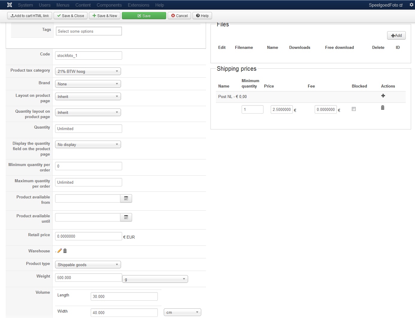

each product has its own shippingscost (tax included) using the manual shipping plugin.
The solution will be to :
- Use the "Use price per product" option of your shipping method configuration page
- Go to your products configuration page
- Set a shipping price for your product through the "Shipping prices" tab of your product configuration page

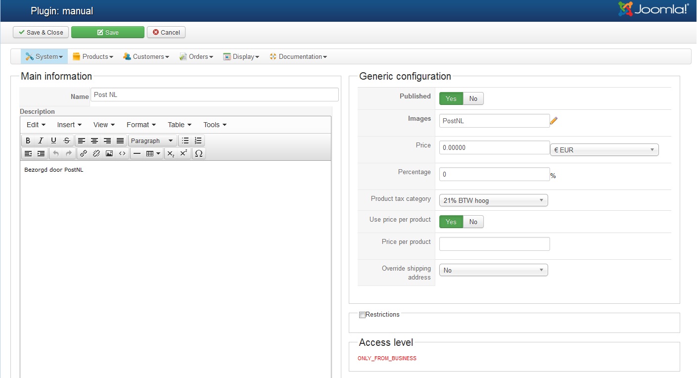

  • Posts: 13
11 years 8 months ago #186825
Hi Mohamed,
Thank you for your reply.
I have configured Hikashop like the screenprints.
The problem is that during the checkout proces and on the final invoice, the shippingscost and taxes are not correct calculated.
Each time I make a choice in the checkoutproces (select shipping method, choose payment method) the shippingcost are lowered with the taxes and the taxes are recalculated.
Maybe I have something wrong configured, maybe there is an error in Hikashop ?
Thanks.

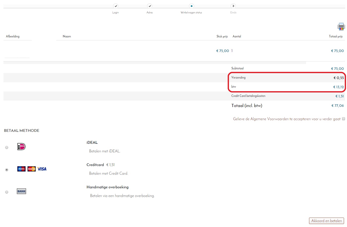

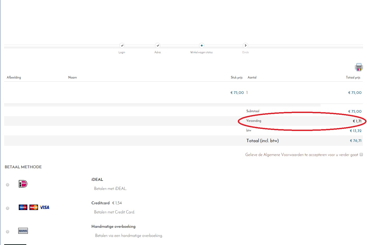

  • Posts: 13
11 years 8 months ago #187006
Hi Mohamed,

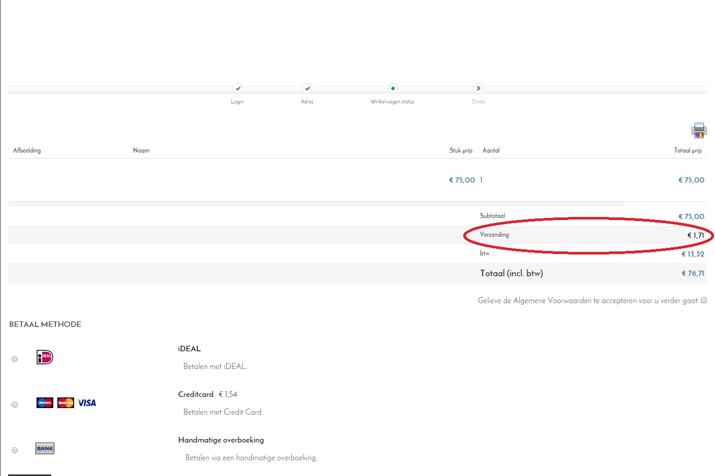

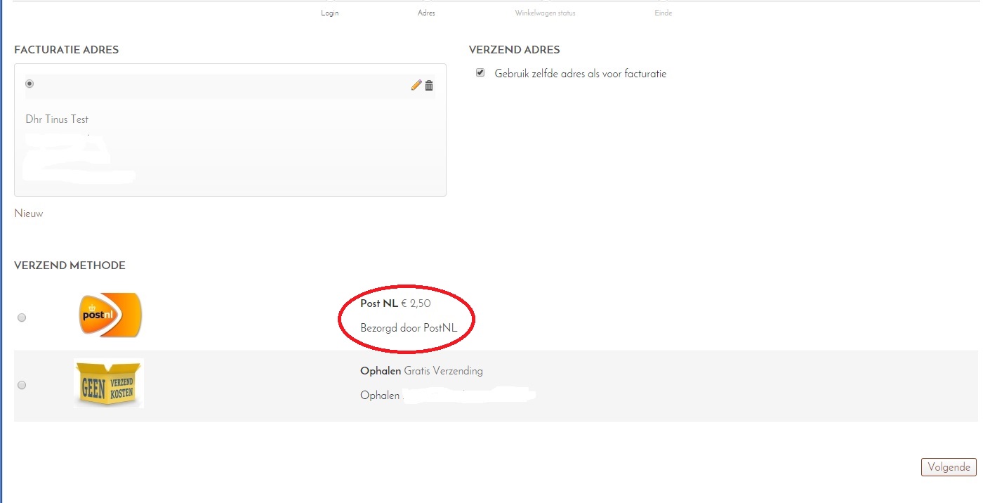

As you can see in the screenprints the shippingcosts are decreased each time I make a choice in the checkout process.
In the productdef. the shippingcost is € 2,50

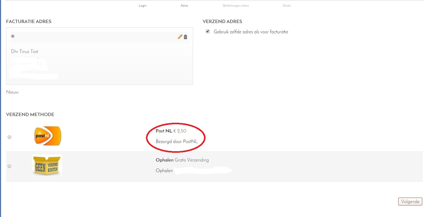

Initially on the select shippingmethod in the checkout process, the shippingcost is € 2,50, this is the right shippingcost.

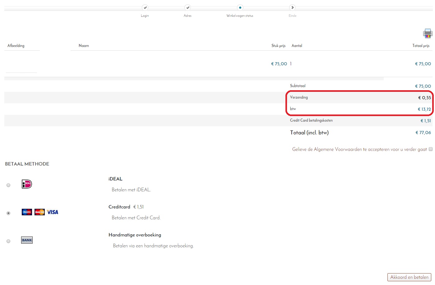

After selecting this shipping method the next screen appears: the select payment method. But now the shippingscost is € 1,71
After selecting the payment method Creditcard and changing the payment method to iDEAL, the shippingscost is now € 0,55
Each time I make a choice in the checkoutproces (select shipping method, choose payment method) the shippingcost are decreased with the taxes and the taxes are recalculated.
So again, maybe I have something wrong configured, maybe there is an error in Hikashop ?
Thanks.

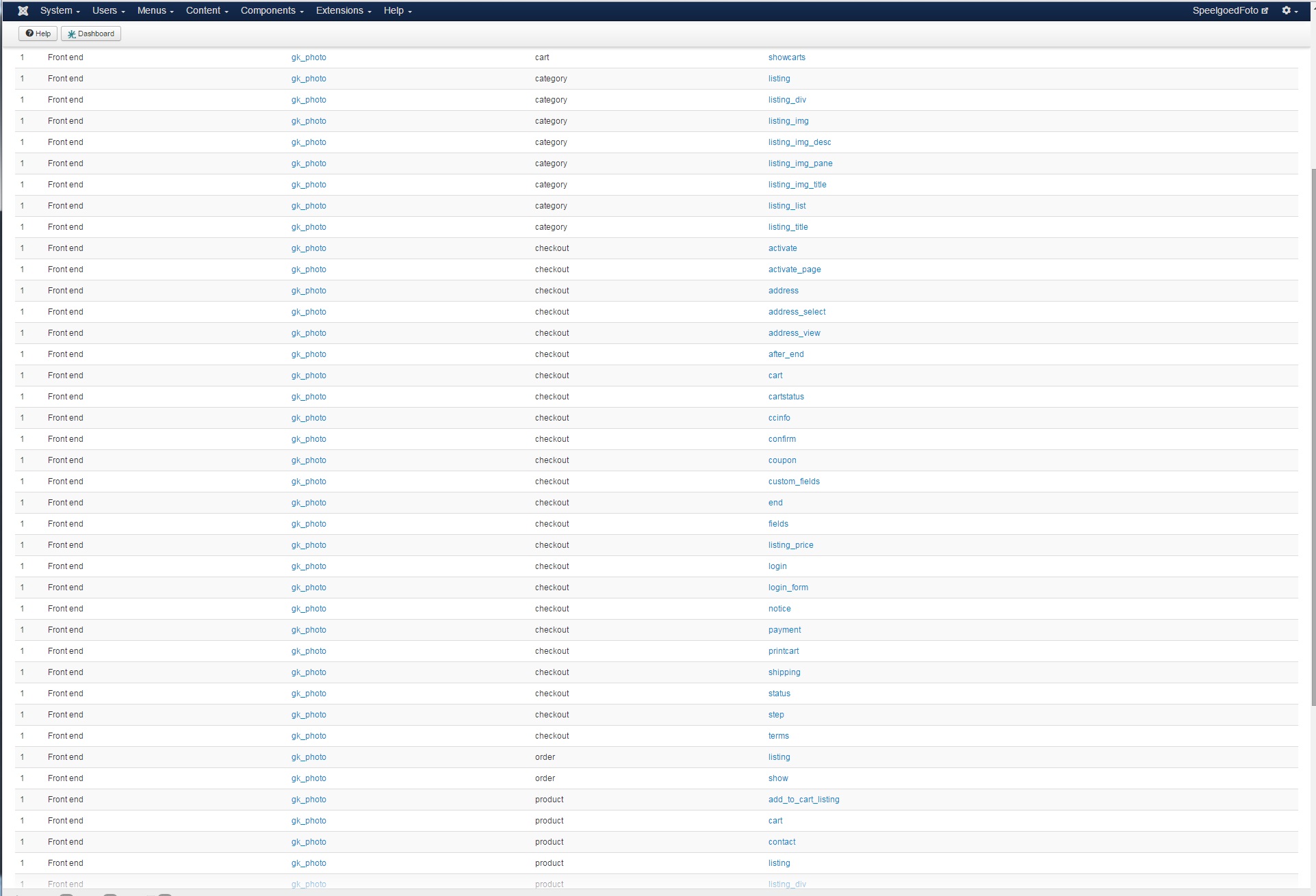

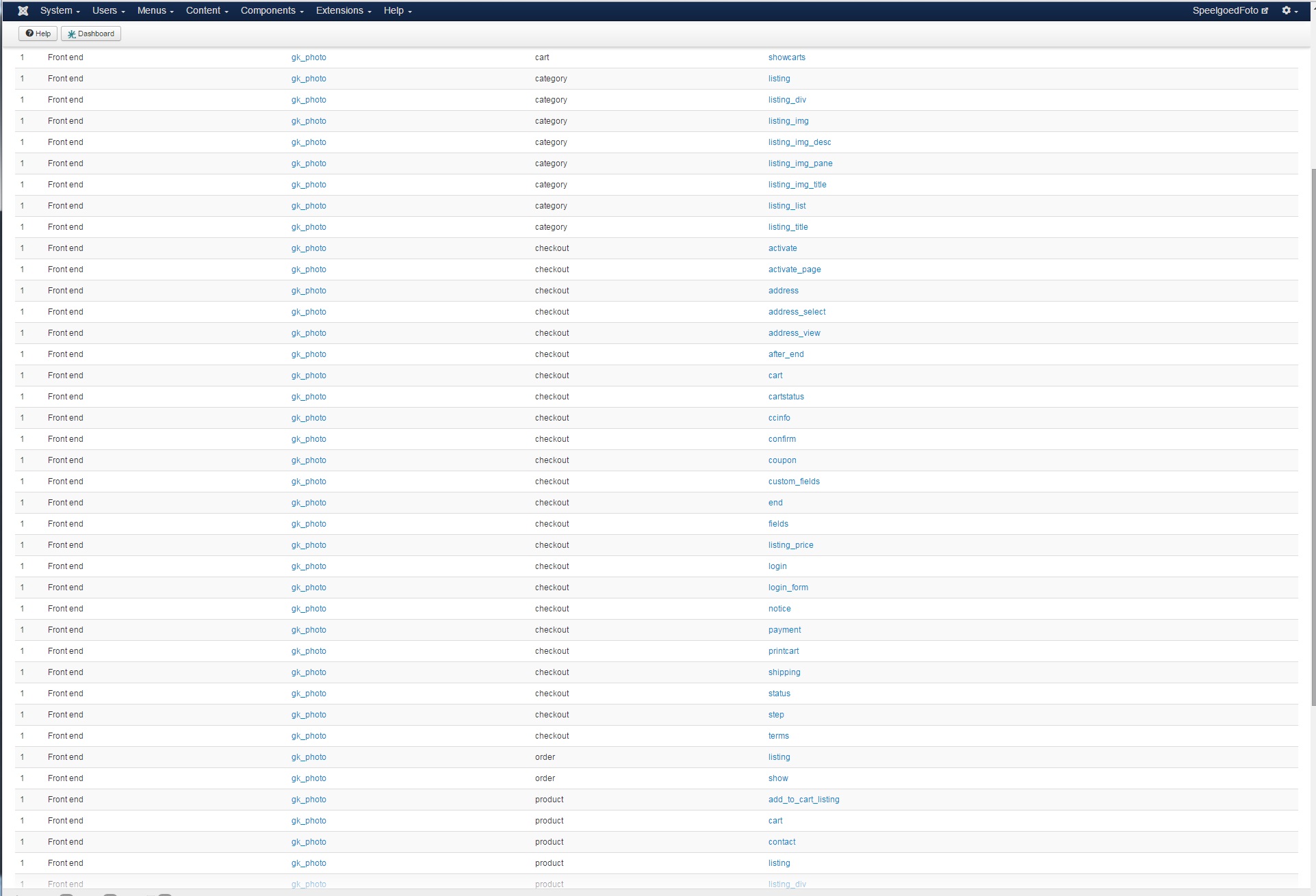

Did you add some code customization through the files of the "checkout" view of your front-end template via "Hikashop->Display->Views".
If that's the case can you test it without it ?
Thanks.
  • Posts: 13
11 years 8 months ago #187467
Hi Mohamed,
I have removed the customization ( see the screenprint) but the problem is still there: the shippingcosts are decreased each time I make a choice in the checkout process.
Han

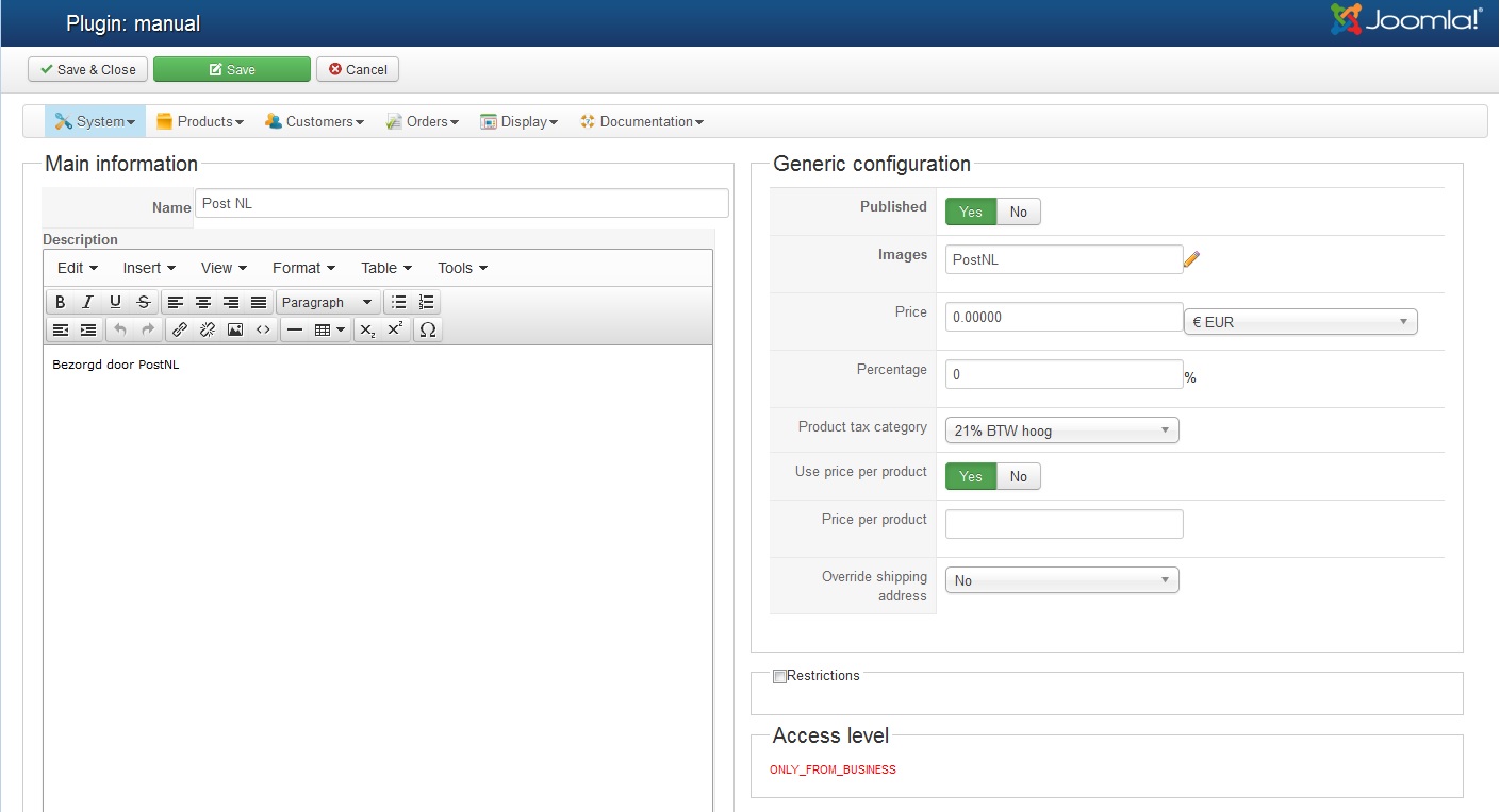

Hello

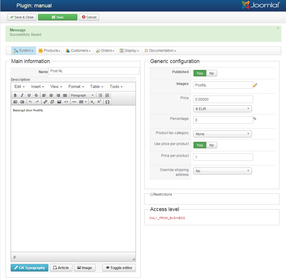

I still can't reproduce your issue on my en so does it work if you set the "Product tax Category" of your PostNL to none ?
  • Posts: 13
11 years 8 months ago #187629
Hi Mohamed,
If I set the "Product tax Category" of PostNL to none (see screenprint) the shipping costs are not decreased and stay € 2.50 each time I make a choice in the checkout process. But the shipping costs are taxed in the Netherlands....
Han

11 years 7 months ago #188577
After some test we made a fix about that issue, there was an issue with the tax calculations for shipping fees if the "floating tax prices" option that you can find via "Hikashop->System->Configuration->Main" was activated.
To fix it you'll just have to edit the file "administrator\components\com_hikashop\classes\currency.php" and change that line :
if(!empty($rate->shipping_tax_id) && bccomp($rate->shipping_price,0,5)){
by :
if(!empty($rate->shipping_tax_id) && bccomp($rate->shipping_price,0,5)) {
	if(!empty($usable_rates[$k]->taxes_added)){
		continue;
	$usable_rates[$k]->taxes_added = true;
Also don't forget clean your browser cache before testing it again.
