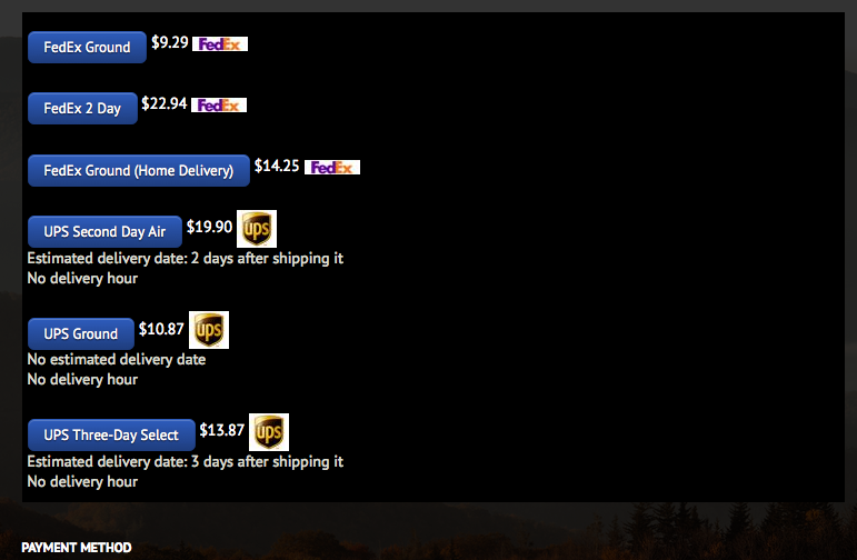

I downloaded and installed the plugin and turned ETA option to yes. However I'm still getting "No estimated delivery date
No delivery hour"
