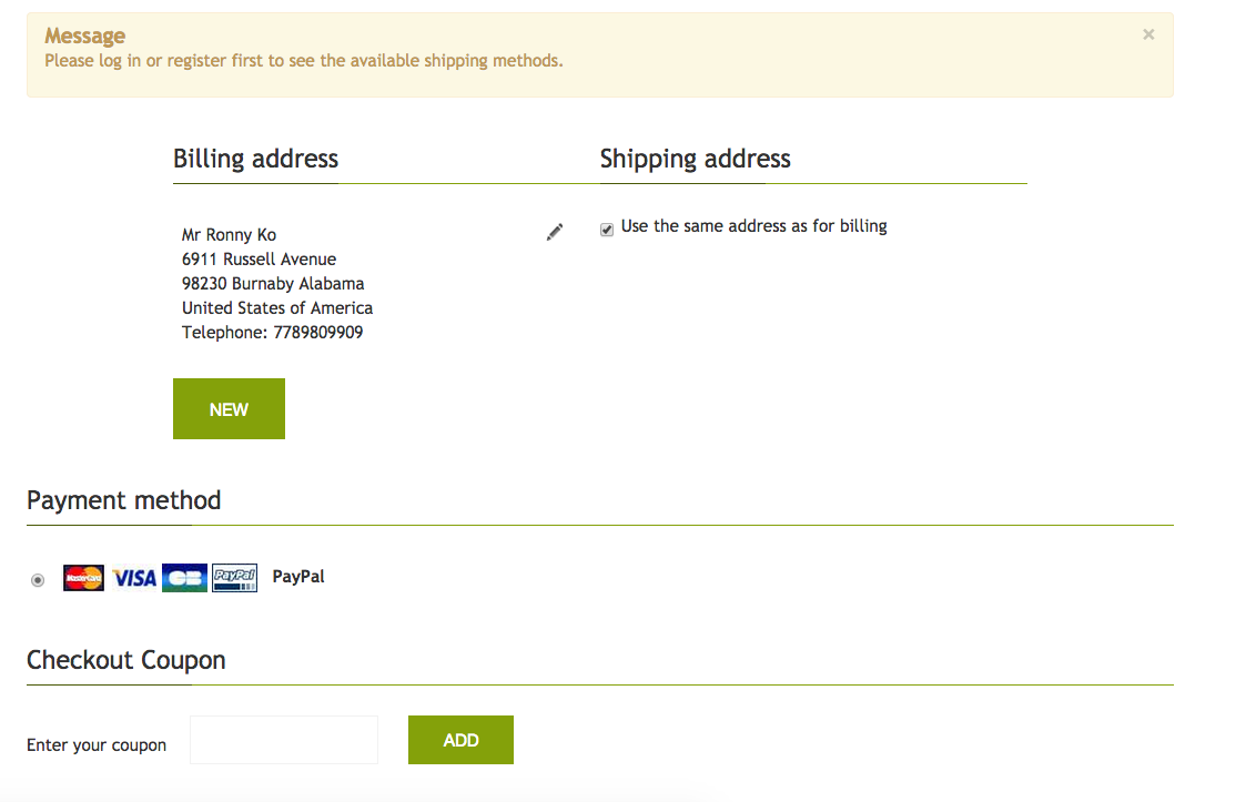

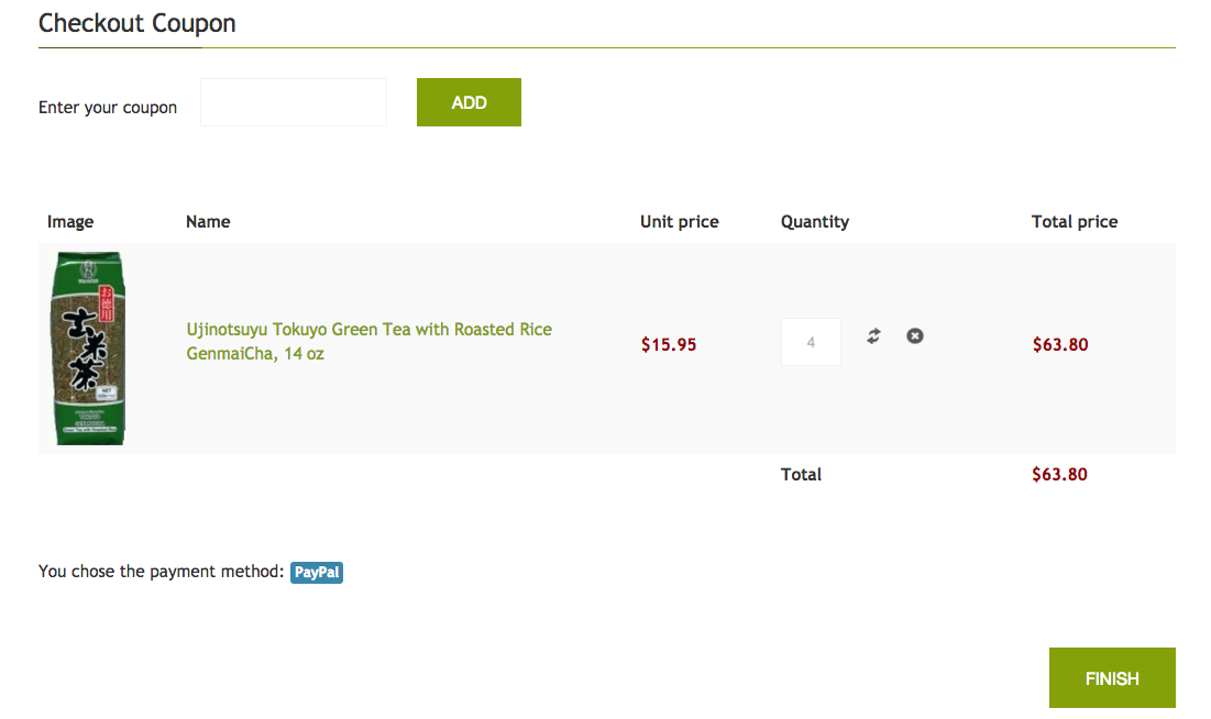

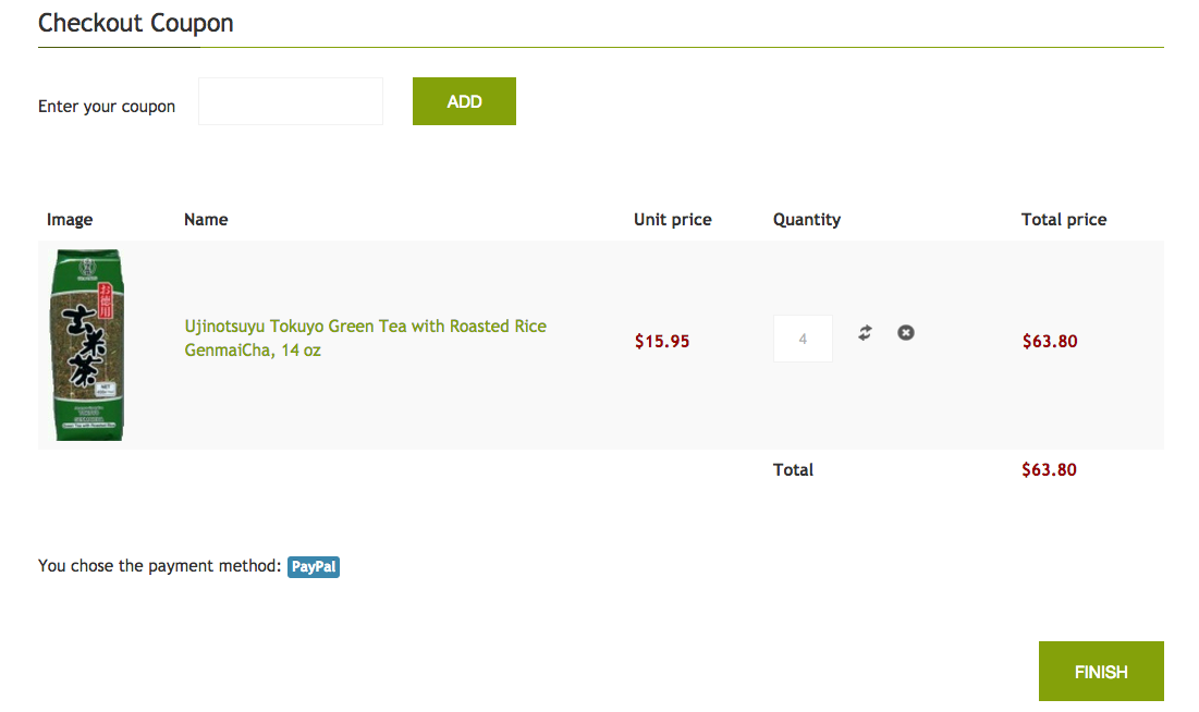

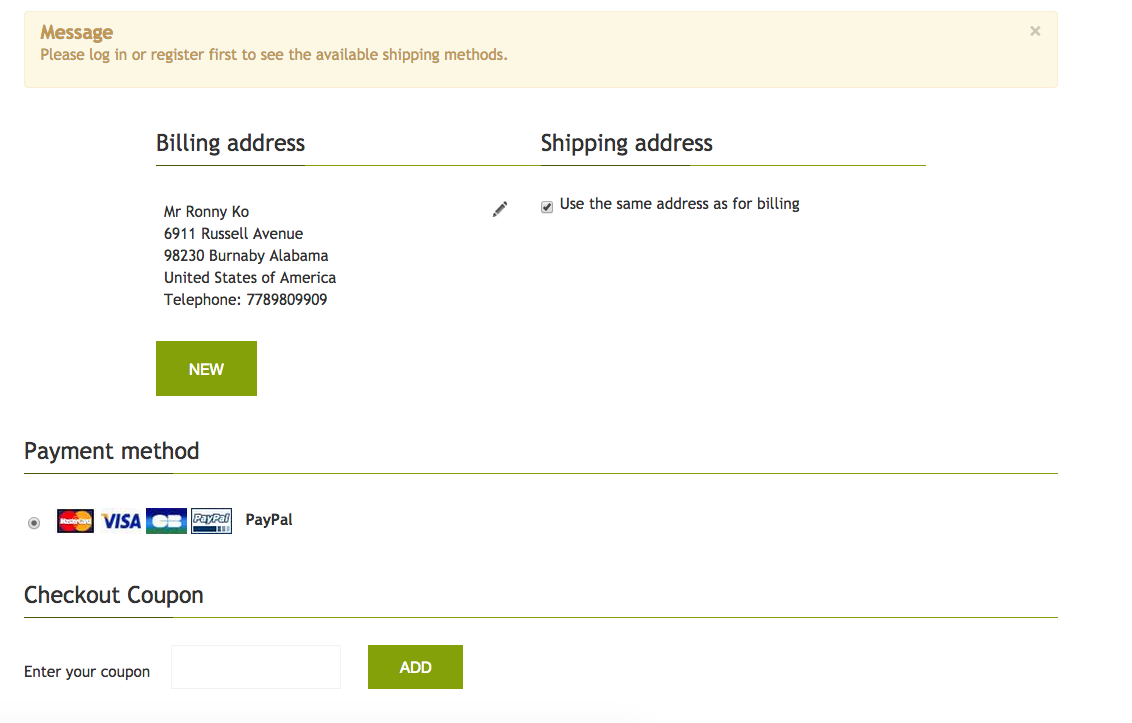

OK, I did what you suggested previous and created the manual shipping method.
Now I have this new problem in the attached screenshot.
I am logged in but I am getting a message stating that I still to login?
This happen when I change the quantity from 3 - 4, why?

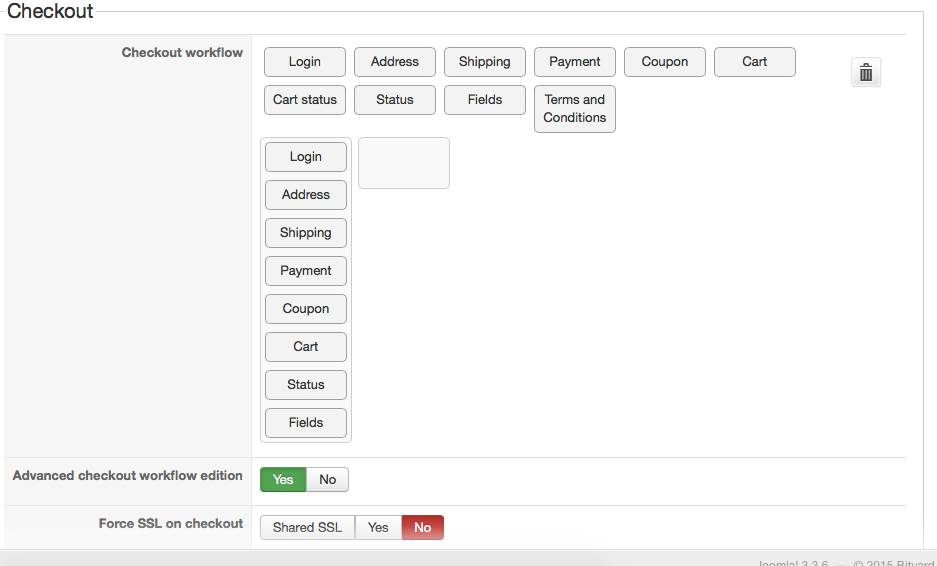

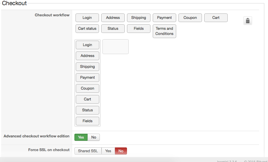

Can you show me how did you configured your checkout workflow via "Hikashop->System->Configuration->Checkout" through some screenshots ?
Thanks.
  • Posts: 41
11 years 4 months ago #187759
As per your request.
11 years 4 months ago #187781

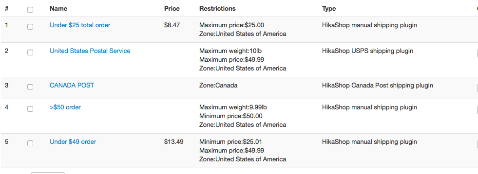

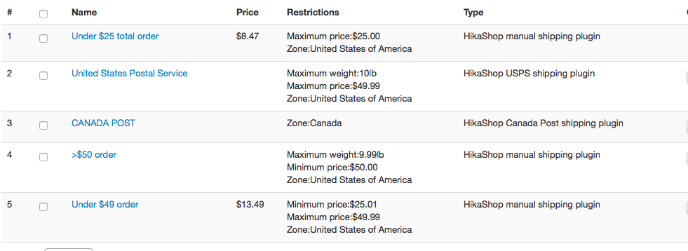

Your checkout workflow seems to be correctly configured, can you show me how did you configured your shipping methods ? Did you use some access level ?
  • Posts: 41
11 years 4 months ago #187901
As per your request. I've also sent you the login information because I think it will help speed up the process. I would like to be able to start making some money and use it to upgrade HikaShop.
11 years 4 months ago #187957
I just tested it again, and the "United States Postal Service" shipping method was correctly displayed, but when my order exceed $49.99 I have the "Login" errror, but your issue is coming from the fact that you didn't published your other shipping methods like ">$50 order"
