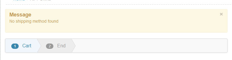

-- Error-message(debug-mod must be tuned on) -- : Message
No shipping method found
Before I ask a question I search the forums and google for an answer, I usually find answers related to my problem but the never seem to help.

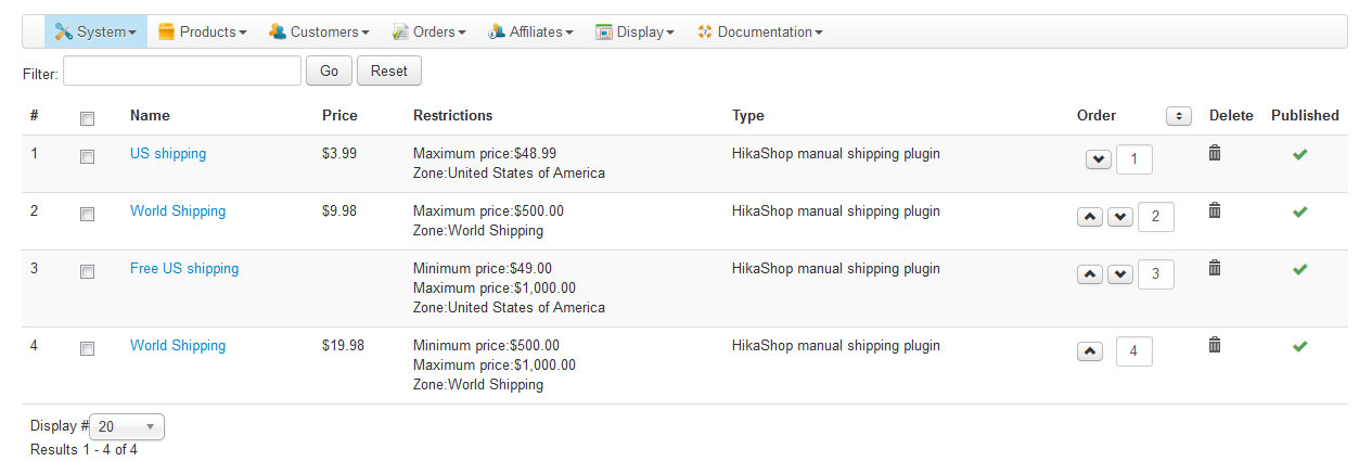

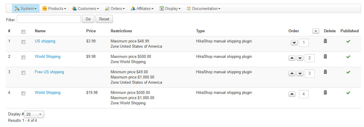

At checkout I get a "No shipping method found" and I tried everything I found before I wrote this post and nothing works
I have shipping methods set up, and published (see image)
I tried all set ups on configuration but I still get the message
How can i fix that issue?

11 years 7 months ago #190361
I just tested it and your shipping methods were correctly displayed but I had to refresh the page to make sure that the address was taken into account.
Can you edit your checkout workflow through "Hikashop->System->Configuration->Checkout" and set 2 step on your checkout workflow :
- login + address on the first step for example
- shipping + payment + .... on the second step
And then test it again ?
Thanks.

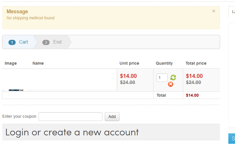

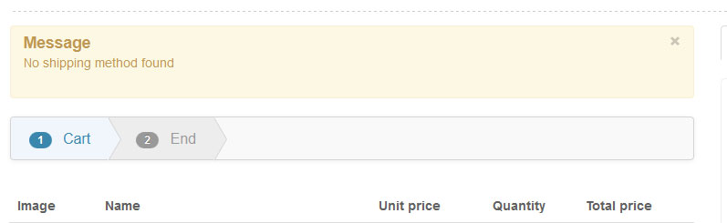

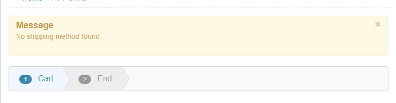

11 years 7 months ago #190483
I think that there is a communication brake down. I know I can set it up where I have two steps .... but I want to set it up in just one page.
The image included in this post is from this morning. Can I have the check out on one page without that "no shipping method found" notice pop up?
It is very confusing if you go to shop for something and just before you pay you see a notice telling you that what you are about to pay for may not be shipped to you.
If it is the case that you can not have a one page checkout without that "no shipping found" that should be disclosed before people buy the software or fixed by your software developers.
Now again ... back to step one... how can I stop that "no Shipping Method found" from poping up for my costumers at checkout?

11 years 7 months ago #190488
Edit the file "components/com_hikashop/views/checkout/view.html.php" and replace
if(!$shippingClass->displayErrors() && $this->has_shipping) {
	$app->enqueueMessage(JText::_('NO_SHIPPING_METHOD_FOUND'));
By
$user_id = hikashop_loadUser(false);
if(!empty($user_id) && !$shippingClass->displayErrors() && $this->has_shipping) {
It will avoid the display of the message if the user is not logged and the shipping methods are displayed in the same step.
Even if the user is not logged, HikaShop can retrieve some shipping methods by using the "main tax zone" option of the HikaShop configuration.
But I admit that it can be useful to not display the message if the configuration is not providing default shipping methods for non logged user.
