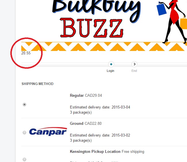

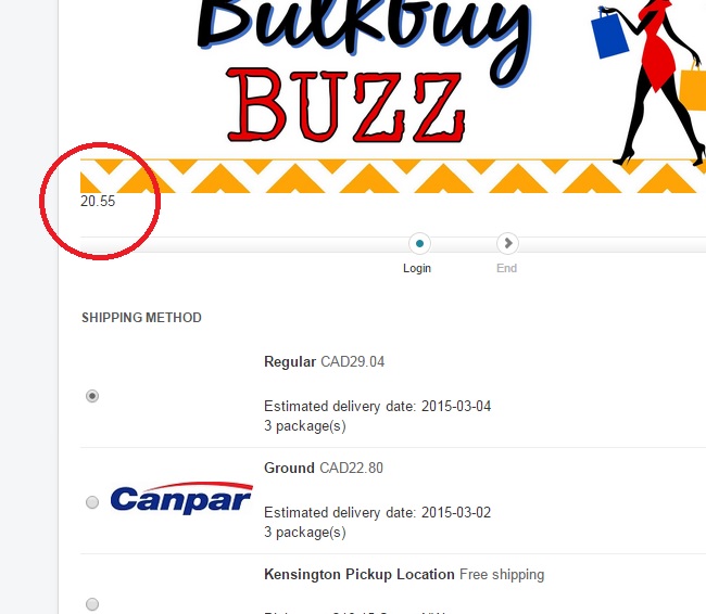

Also, the canpar base rate is appearing at the top of the checkout page. I'm not able to locate where in the code this is being generated. Please advise.

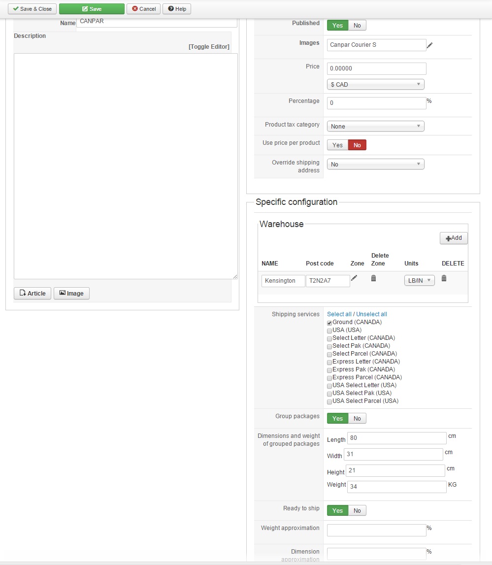

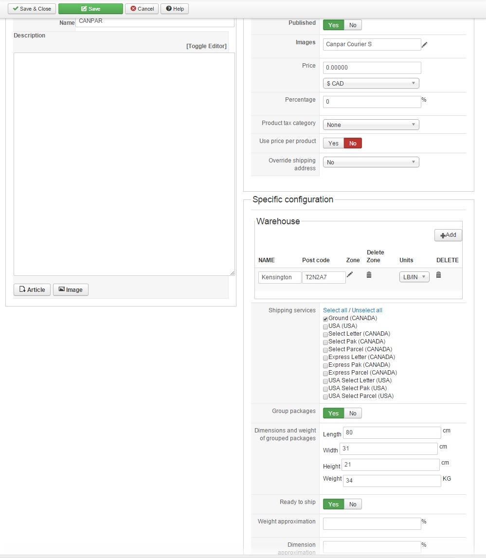

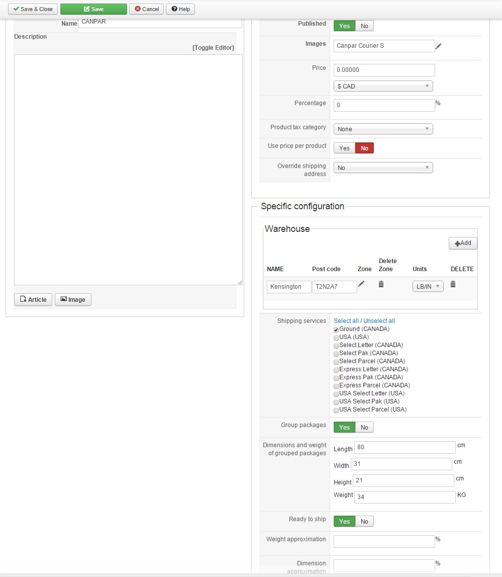

  • Posts: 20
11 years 6 months ago #192444
Here's my current config.

11 years 6 months ago #192739
Hello Steve,
I just tested it on my end, and I'm not having any notice/fatal error.
Regarding the number that is currently displayed during your checkout workflow when you publish your Canpar shipping method, you should edit the canpar.php file and change this line :
echo($method['value']);
By :
//echo($method['value']);
