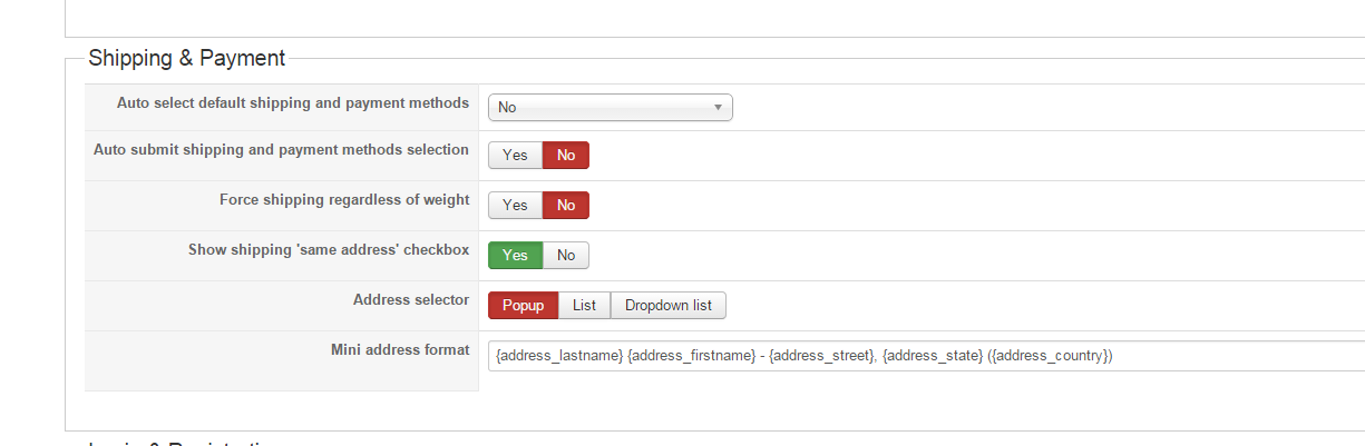

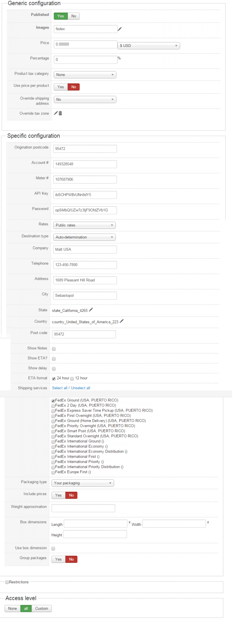

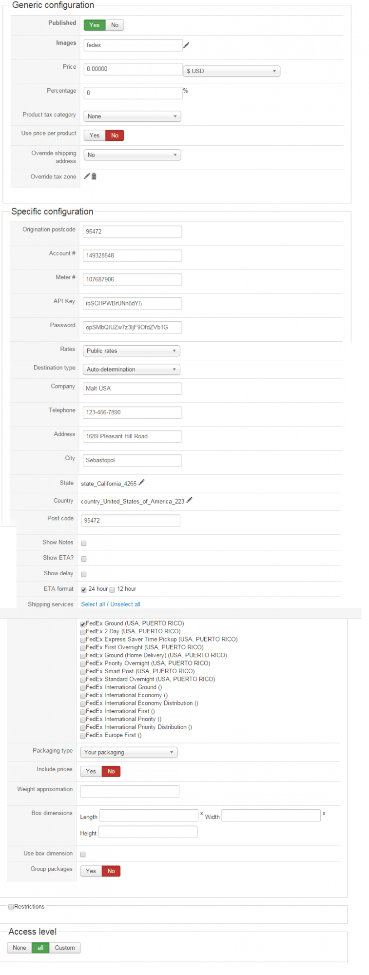

I had this working fine and even had orders with the Fedex option but updated to the latest version of hikashop and now have no shipping method found on my order. I have double checked that there is weight on the items and no restrictions on the fedex plugin are listed. Turned off all other shipping options so only Fedex should be showing. Even tried deleting and recreating the fedex plugin. See my attached screen shot for admin config.
