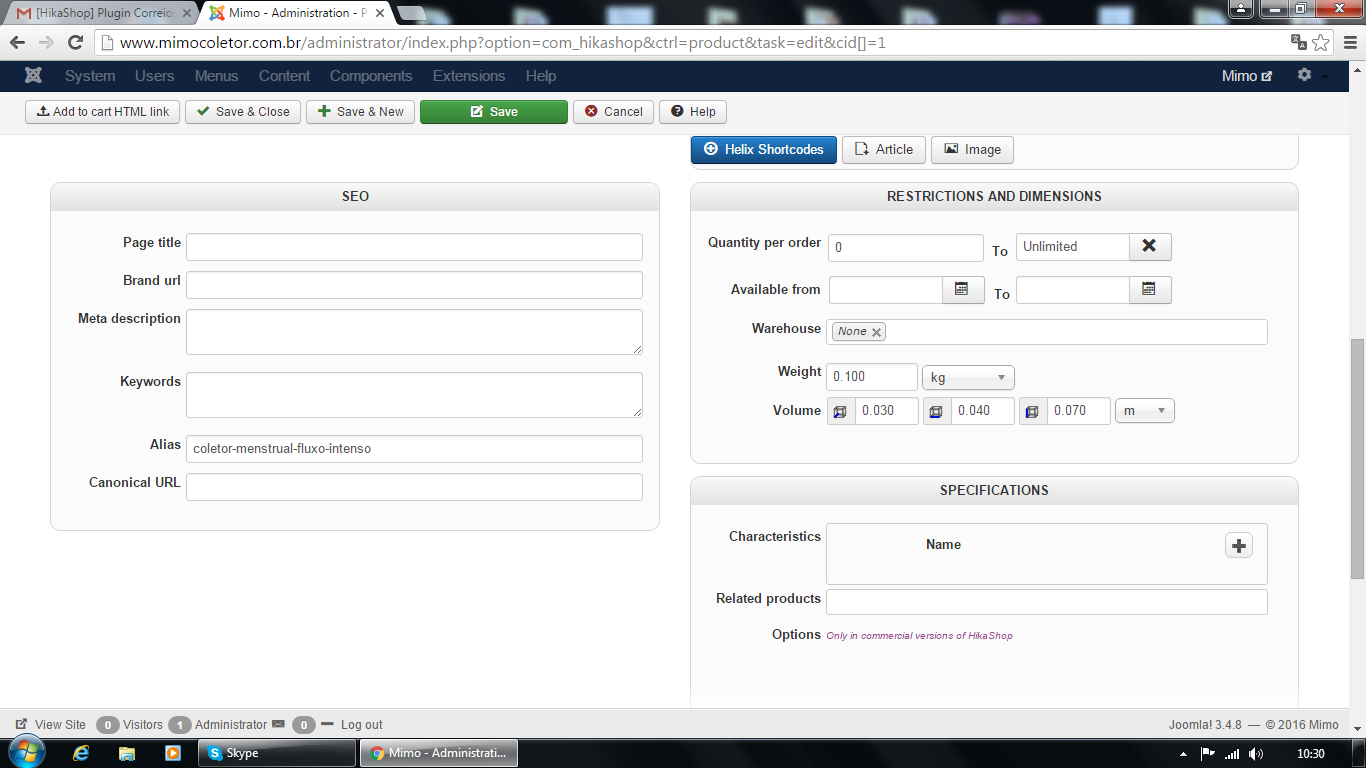

You need to configure the weight and the dimensions of your products when you edit them so that correios can calculate the shipping fees for the products in the cart.

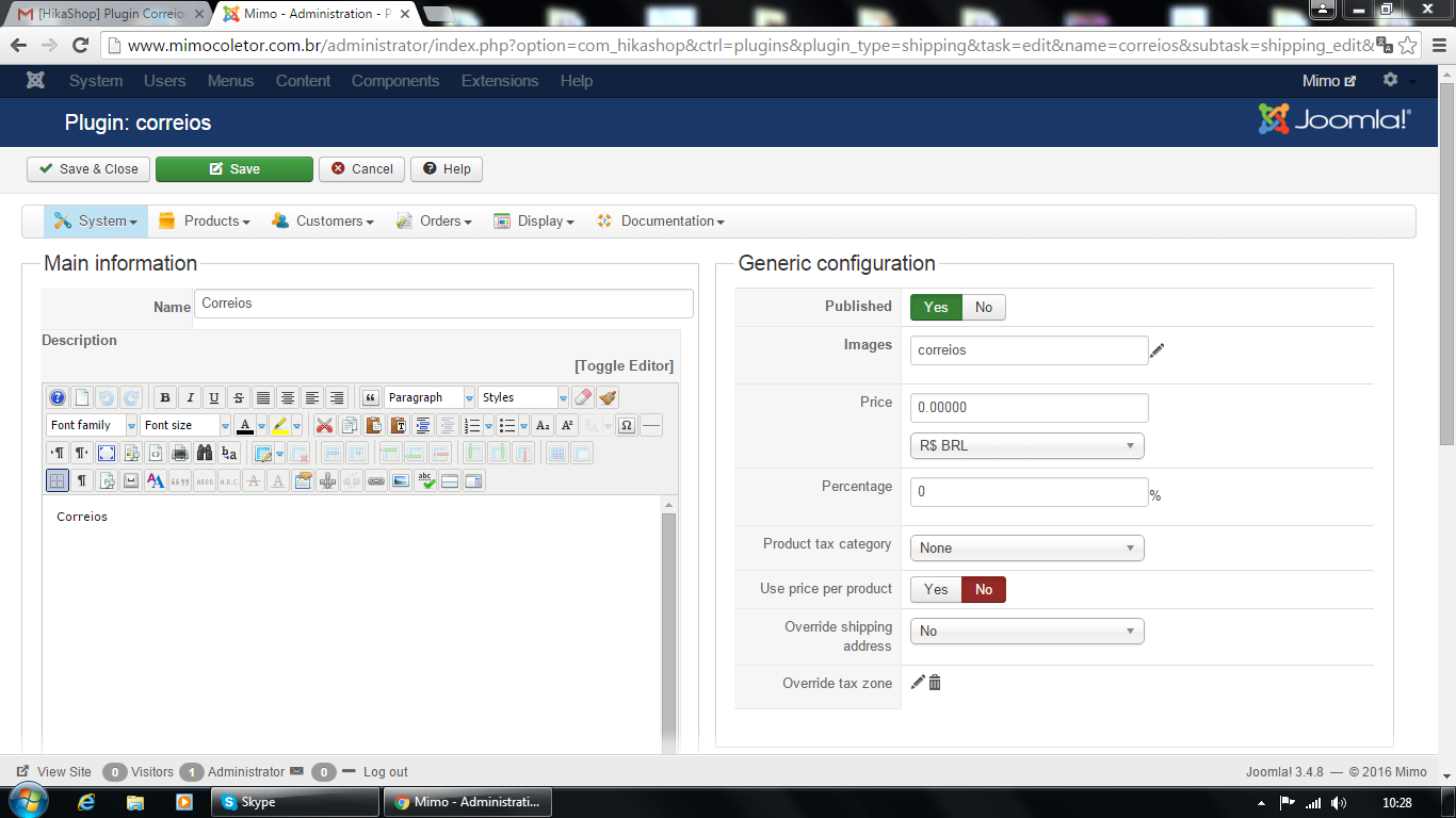

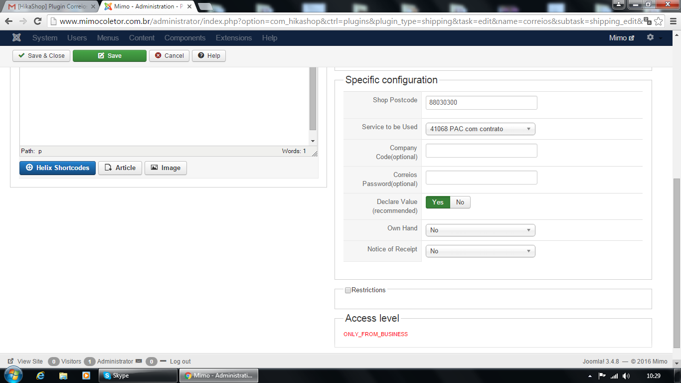

Can you show me some screenshots of how you configured your Correios shipping method and the dimensions/weight of the product in your cart ?
Thanks.
  • Posts: 5
10 years 7 months ago #228900
Please find attached the screenshots.
Thank you
10 years 7 months ago #228924
Note that it's working fine on my end with your configuration, did you :
- Use a Brazilian shipping address
- Set some of the "Restriction" options through your shipping method configuration page ?

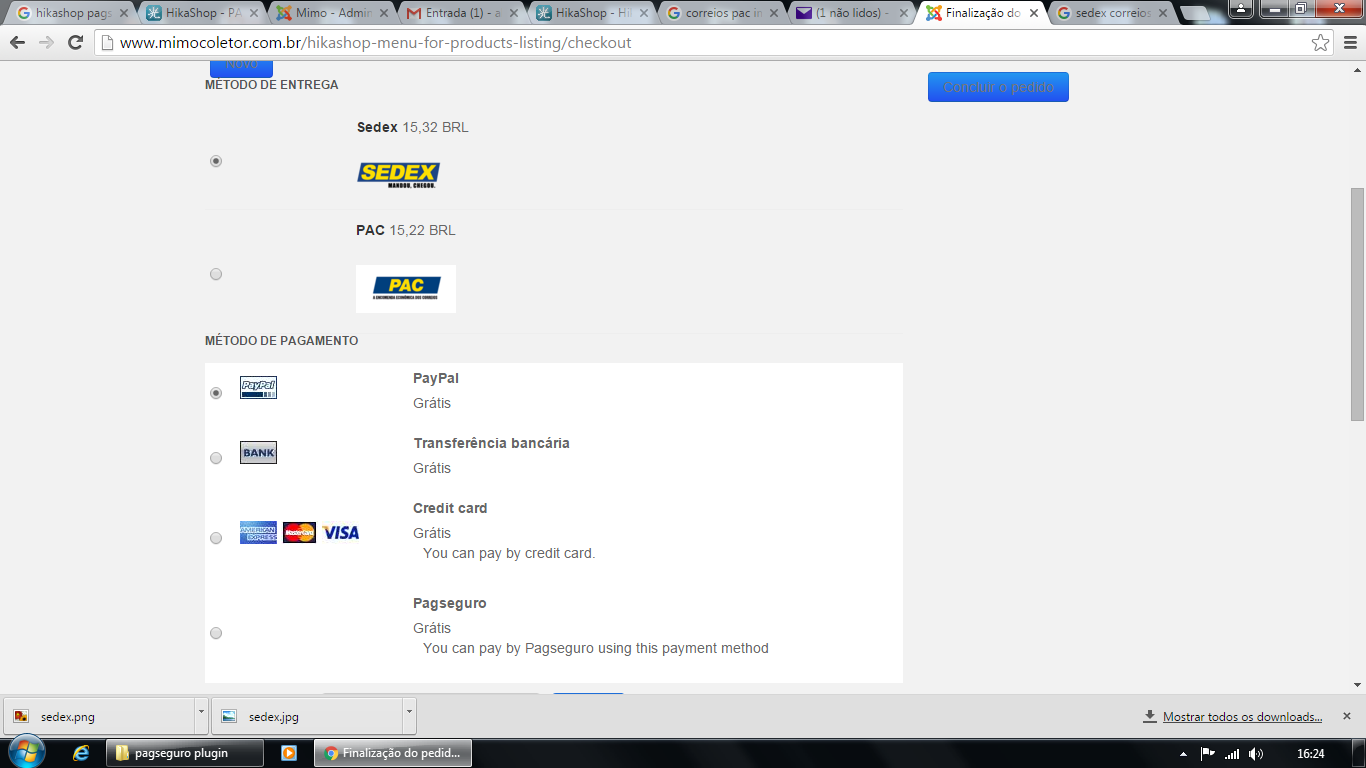

  • Posts: 5
10 years 7 months ago #229860
please see screenshot of my check out page.
I would like to have the images aligned with PayPal, Bank transfer, credit card...
Is it possible?
thanks
Pedro
  • Posts: 5
10 years 7 months ago #229863
I found the answer on how to have the images avaiable on the "Pagseguro payment method documentation".
However, (if it is not too much to ask) what would be the step-by-step of "If you want to add additional images, you can upload them via FTP into the folder media/com_hikashop/images/payment/ of your website and you will then be able to select them in that option."
Thank you again. :)
Pedro
10 years 7 months ago #230041
Hello Pedro,
In your case your should upload it to the folder media/com_hikashop/images/shipping and then you'll be able to select that image through the image option of your shipping method.
Time to create page: 0.654 seconds
