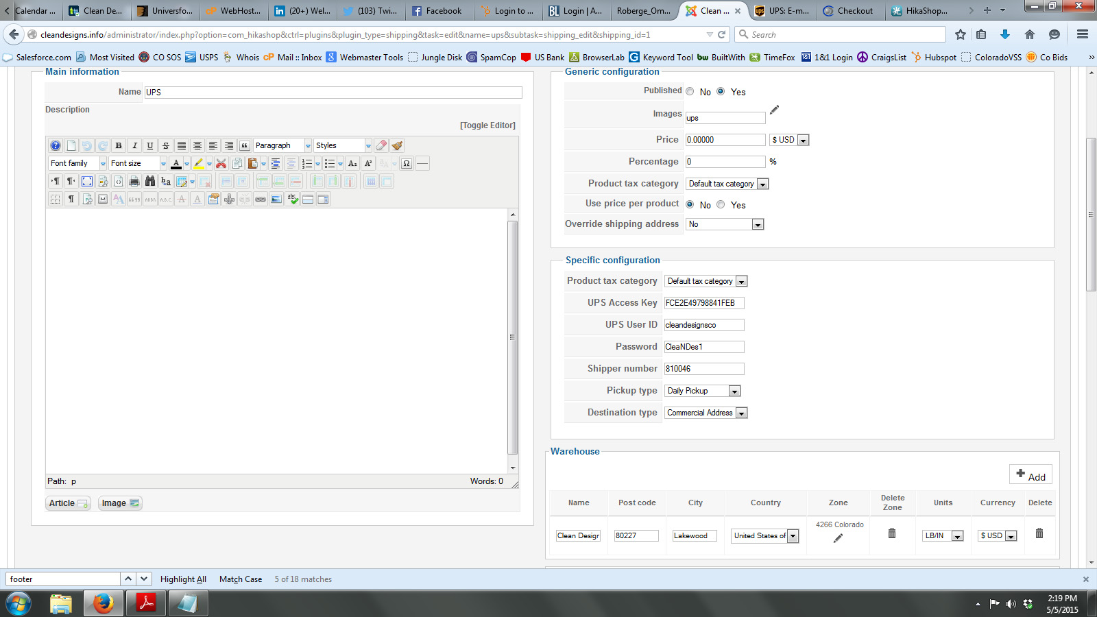

Testing Purchase in HikaShop using UPS Plugin and receiving this error:
No shipping method found

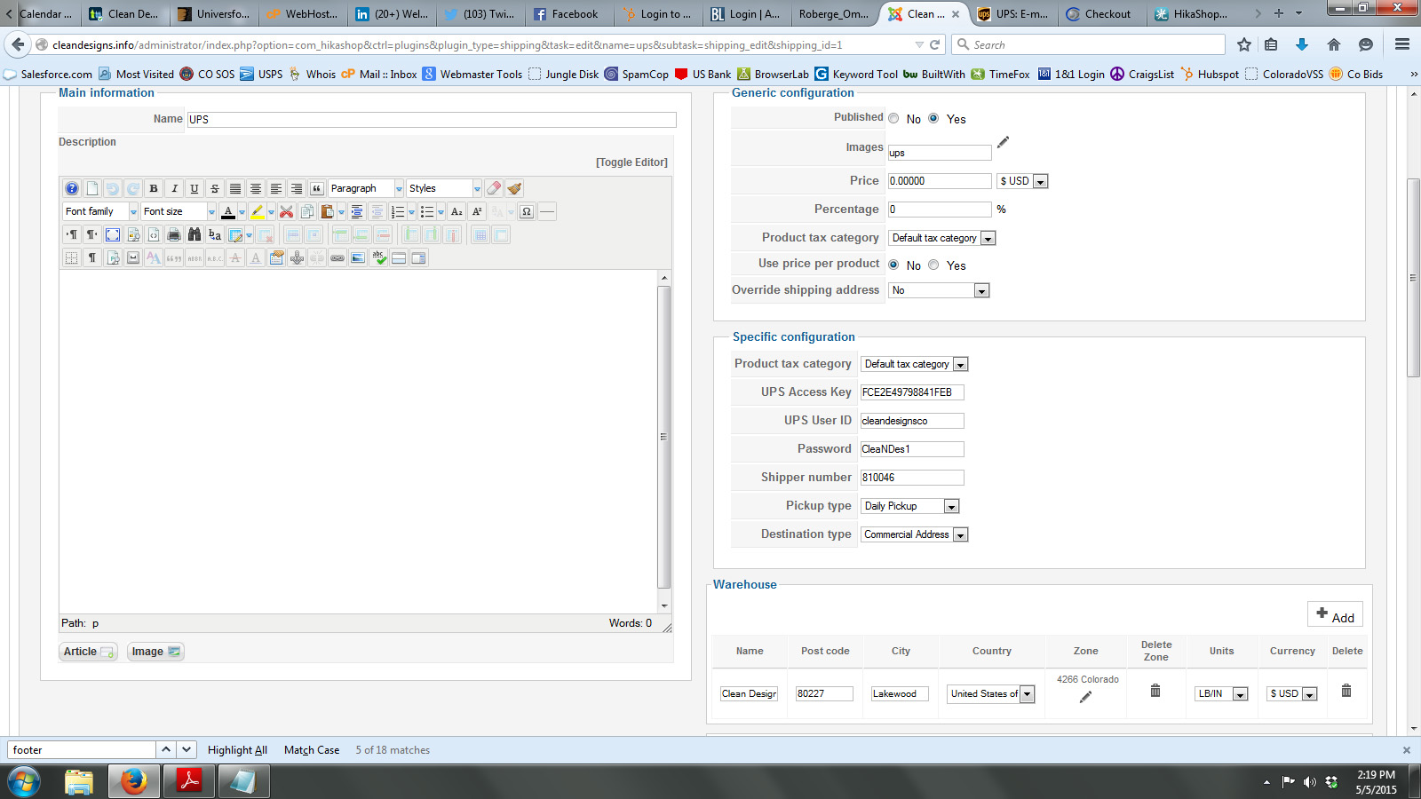

Screenshot of UPS Plugin Configuration is attached.
Gene Fourney
InteractiveWest

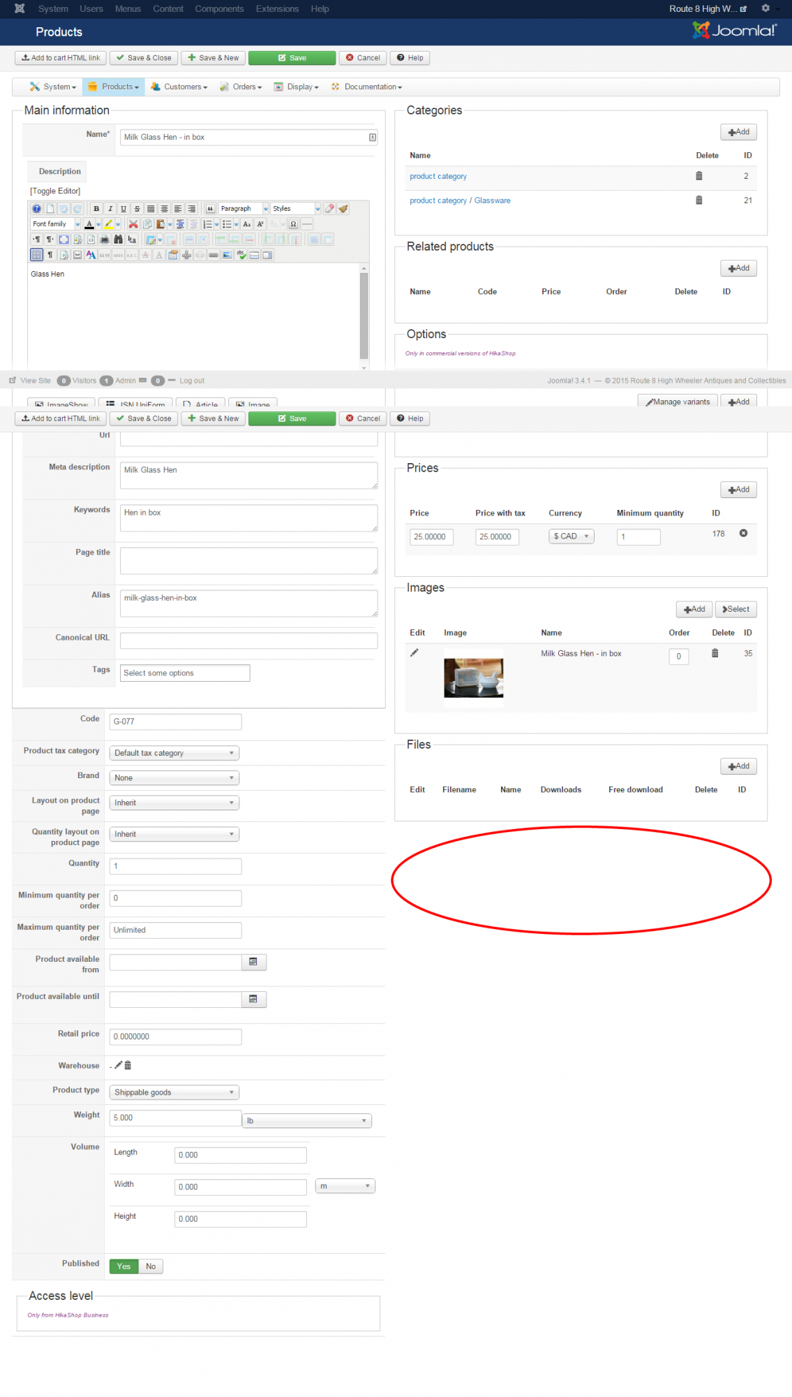

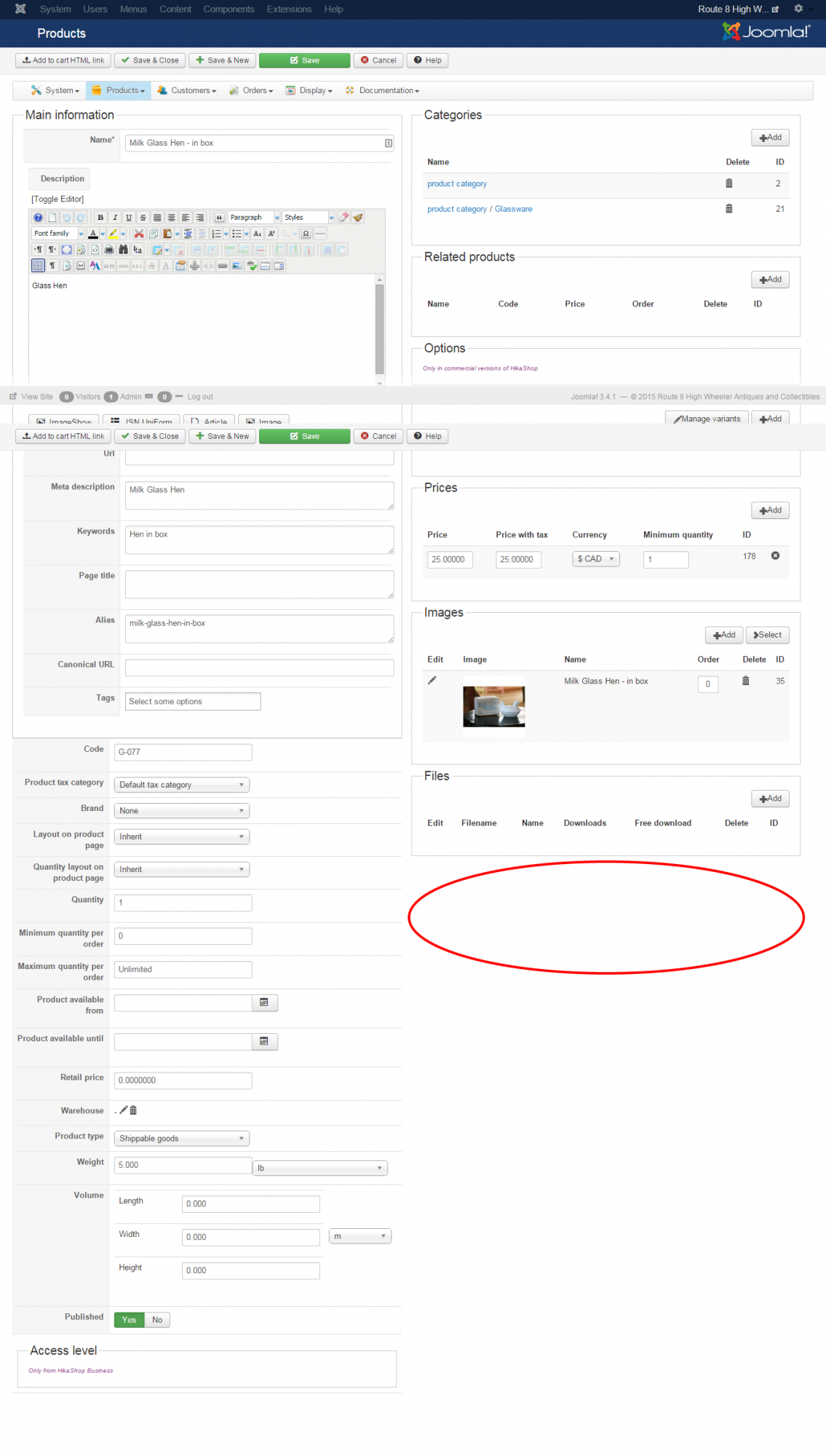

Hi I am having the same issue I believe. When I go to my products details page no shipping options are displayed at all.
I've already looked at the suggested link above and gone through the steps but nothing seems to be jumping out at me where there may be something miss configured. Any help would be greatly appreciated.
  • Posts: 26387
  • Thank you received: 4078
11 years 4 months ago #202045
The shipping methods are displayed in the HikaShop backend, under "system > shipping methods".
You can't manage the shipping in the product edition page ; I think you confuse the "shipping price per product" which is something totally different.

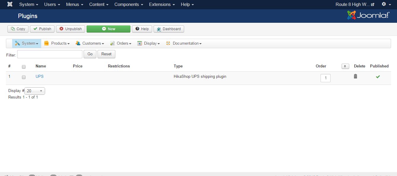

11 years 4 months ago #202118

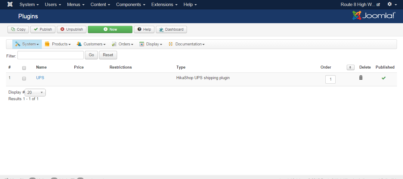

My UPS shipping plugin is published as shown below

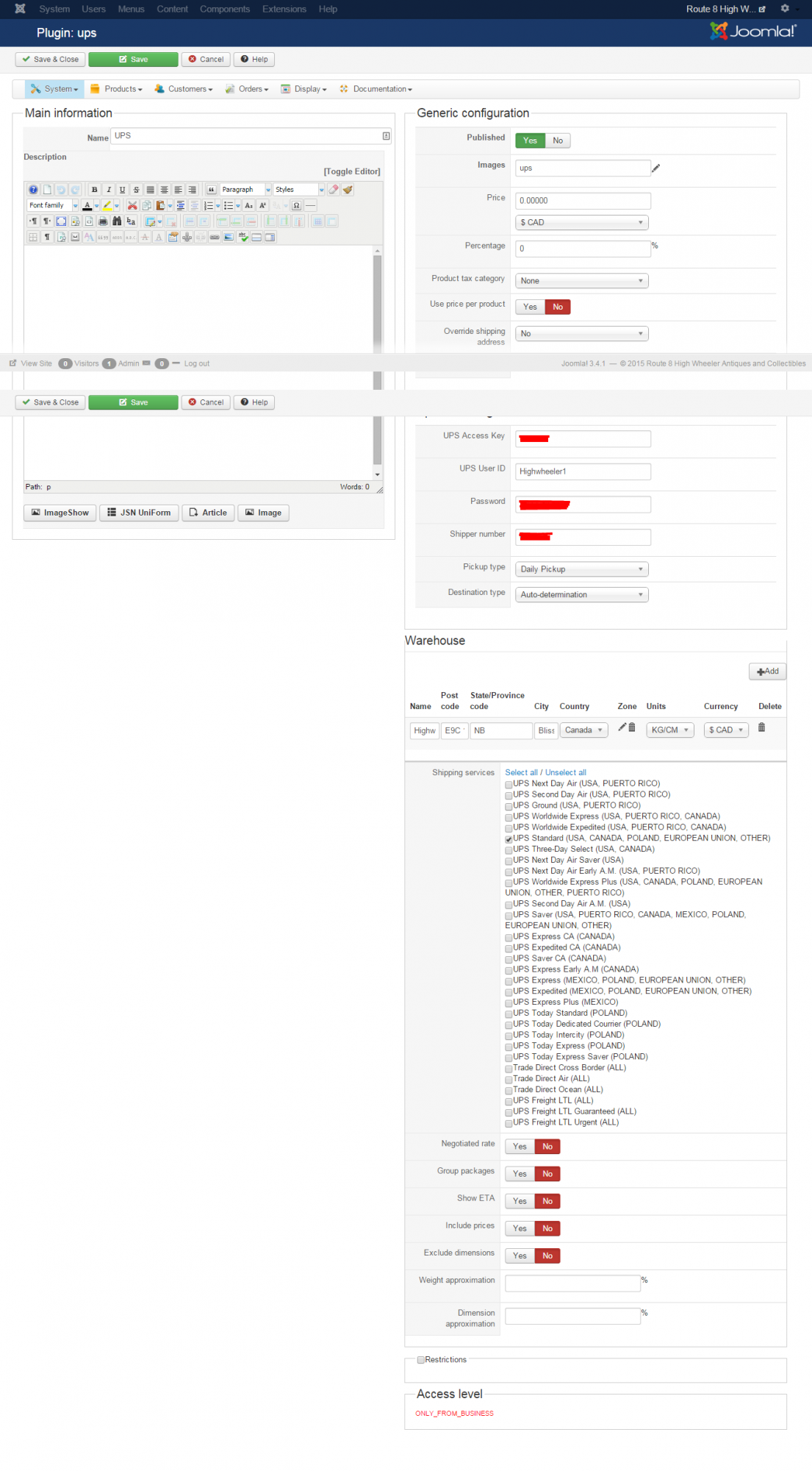

and configured as follows

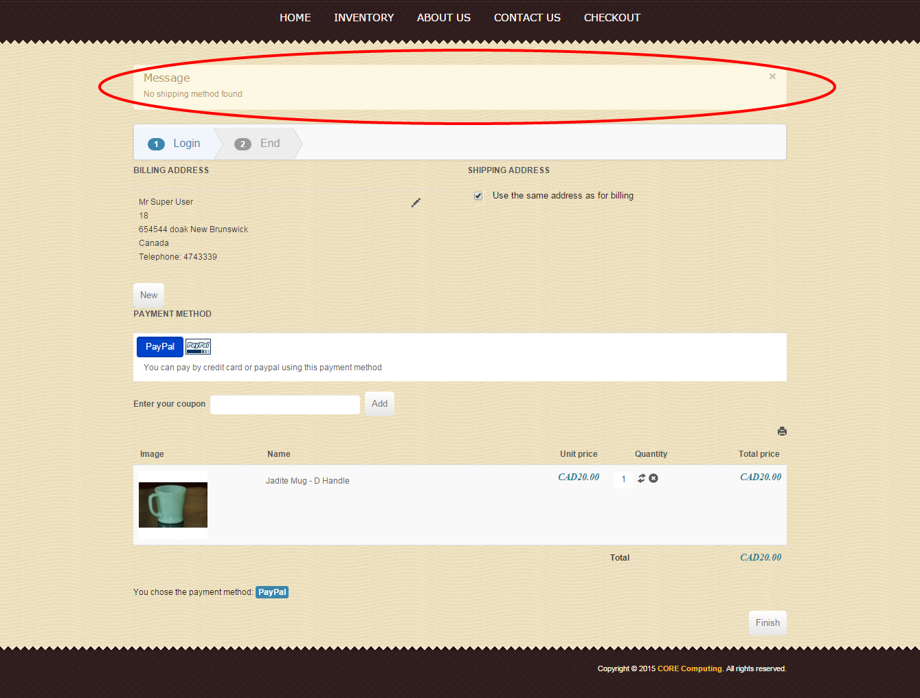

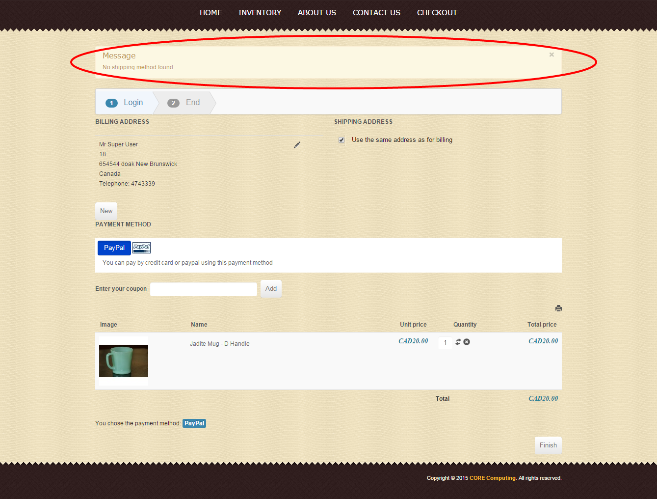

and this is the result when I go to checkout page to pay for the item
Where am I going wrong?
Last edit: 11 years 4 months ago by drrakken.
11 years 4 months ago #202155
Your issue can be coming from multiple factors, so firstly, you should follow each step of the shipping section of the FAQ : www.hikashop.com/support/faq.html#ship

11 years 4 months ago #202259
Maybe the "UPS standard" service wasn't available for your order parameters (order weight/size/shipping address/..), can you check each UPS services and test it again ?
Also, are you sure that you didn't set any restriction option through the "Restriction" tab ?
