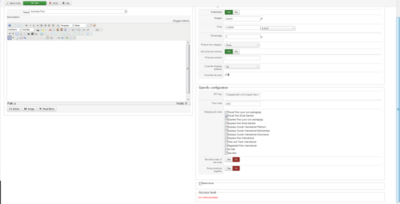

Are you testing the Australia Post 1 or Australia Post 2 shipping plugin ?
Could you do a screenshot of your settings for the plugin ?
  • Posts: 59

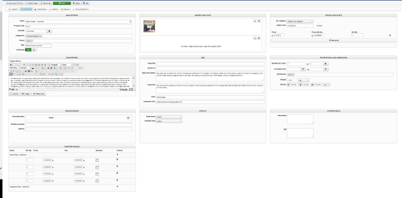

10 years 10 months ago #219635
I am using the new V2 plugin with the API from Aus Post. As you can see in the screenshot, AUS-PostPlugin, at this point I am using the "Price per product" option. If you look at the Product restrictions and dimensions, you can see a weight of 1.1kg and a volume of 30 x 30 x15 cm. 1 item selected equals $8.25, 2 items equal $24.75 and 3 items equal $33.00.
If I change it to "Price per product" No, then the same selections give me 1 item $8.25, 2 items $8.25 and 3 items $33.00. If we assume Aus Post calculate that 2 items will fit into 1 satchel at $8.25, selecting 3 items would have to fit into 2 satchels which should be $16.50, not $33.00, which equates to 4 satchels, by the way. I understand that Hikashop doesn't have anything to do with the calculations, this is done at AU post, but there is something wrong with the figures that are being sent there as you can see that 1 item will fit into 1 satchel. 2 items will also fit into 1 satchel but 3 items needs 4 satchels. This doesn't make sense to me. If I can fit 2 of the same items into 1 satchel, I should be able to calculate in my head that if I want to send 10, 20 or 30 items the numbers should be 5, 10 and 15 satchels respectively. Happy to keep testing, all the best.
