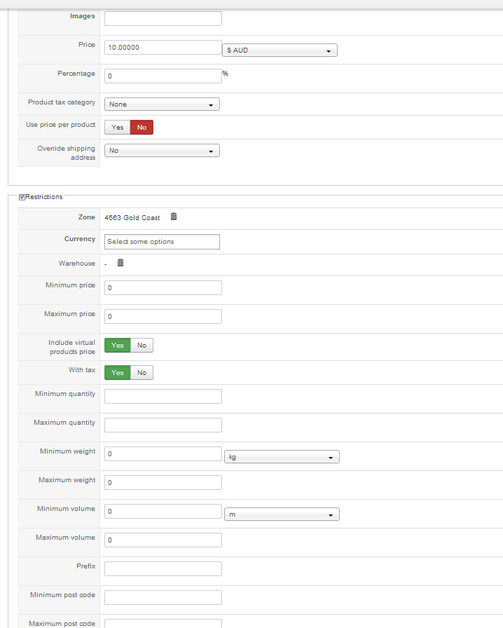

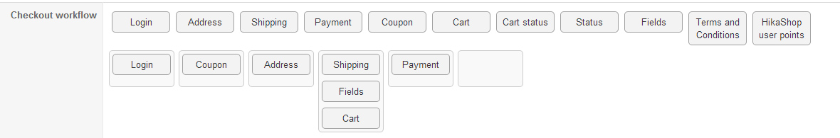

11 years 4 months ago #201598
Hi Screenshots of my checkout workflow and shipping method restrictions config are attached.
In the shipping method config, the Gold Coast zone is a shipping sub-zone of a state zone which is then a sub-zone of a country zone.

Can you show me how did you configured through some screenshots :
- Your "Gold Coast" shipping zone via "Hikashop->System->Zones->'YourZone'"
- The shipping address that you are using through your checkout workflow.
