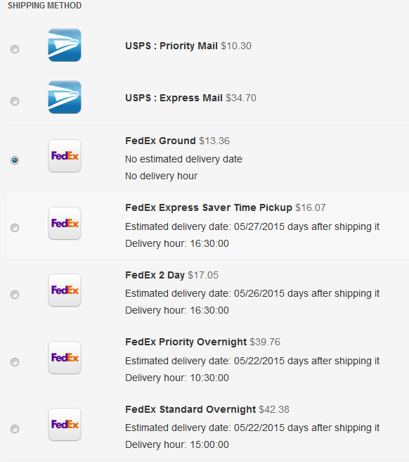

If I set "Auto select default shipping and payment methods" to Yes, it is not selecting the least expensive shipping option. I have USPS and FedEx shipping enabled, but it always selects the least expensive FedEx option, even if there is a less expensive USPS option.

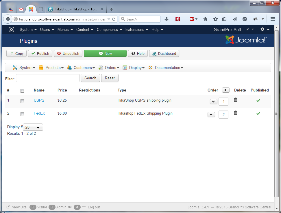

When you set it to yes, it selects the first one of the list.
If USPS is less expensive than FedEx, then swap their ordering via the menu System>Shipping methods and that should do it.

If that is the case, then it is not working correctly. I have USPS ordered to display before FedEx.

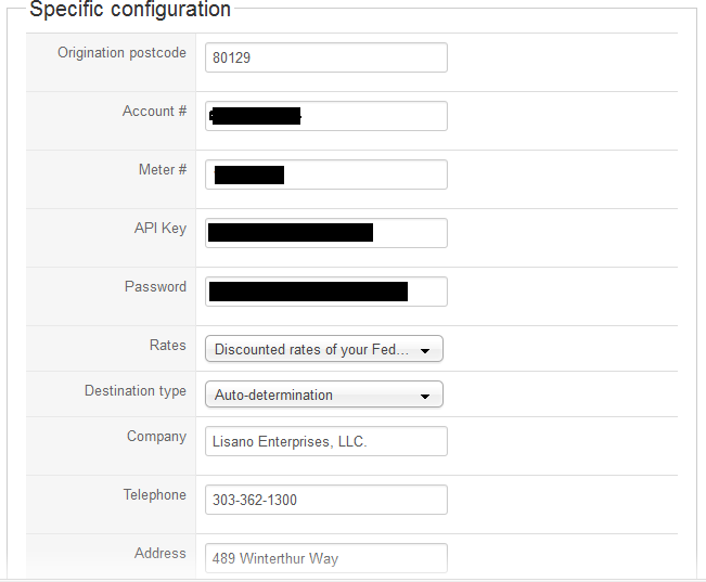

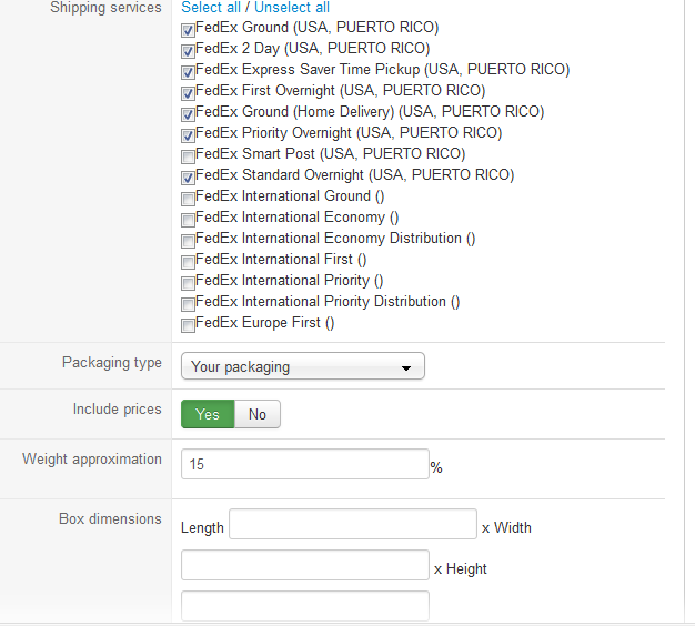

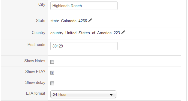

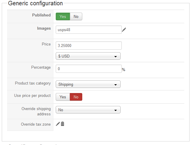

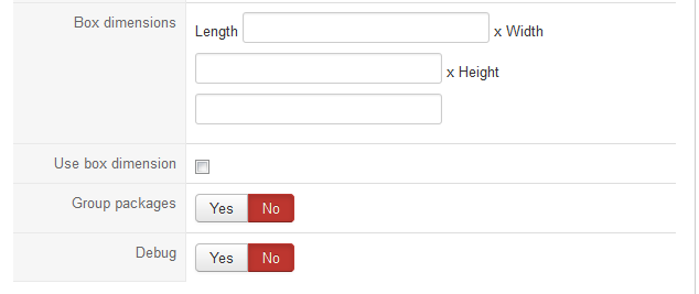

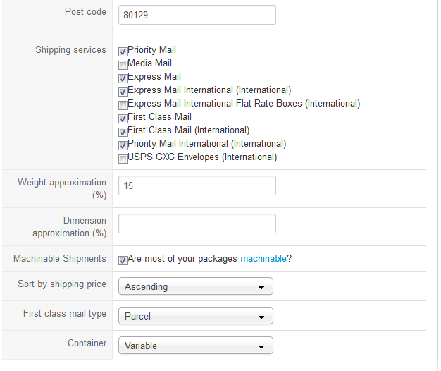

Please provide screenshots of the shipping methods listing and the settings of FedEx and USPS.
This way we will be able to reproduce the issue on our end and debug that.
  • Posts: 166
  • Thank you received: 11
11 years 3 months ago #202384
Here's the screenshots.
Last edit: 11 years 3 months ago by gpraceman.
  • Posts: 166
11 years 3 months ago #202386
Here's one more.

I tried it on a different browser and deleting out the browser cache. It still selects the cheapest FedEx option, which is more expensive than the cheapest USPS option.
11 years 3 months ago #202564
