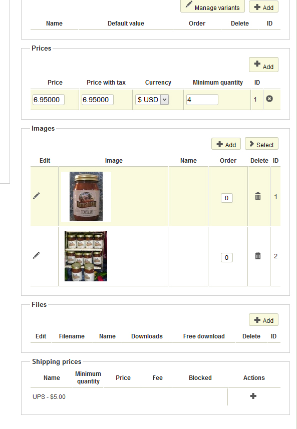

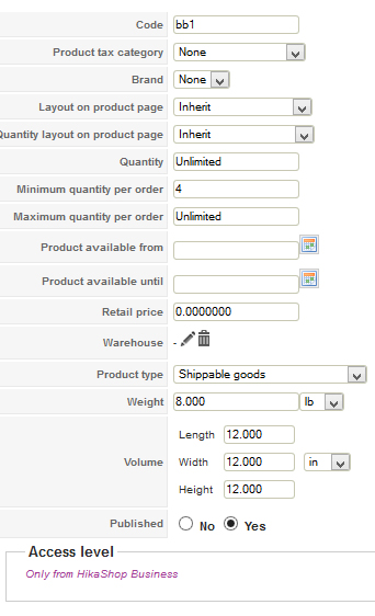

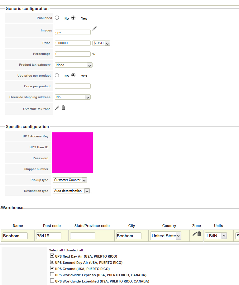

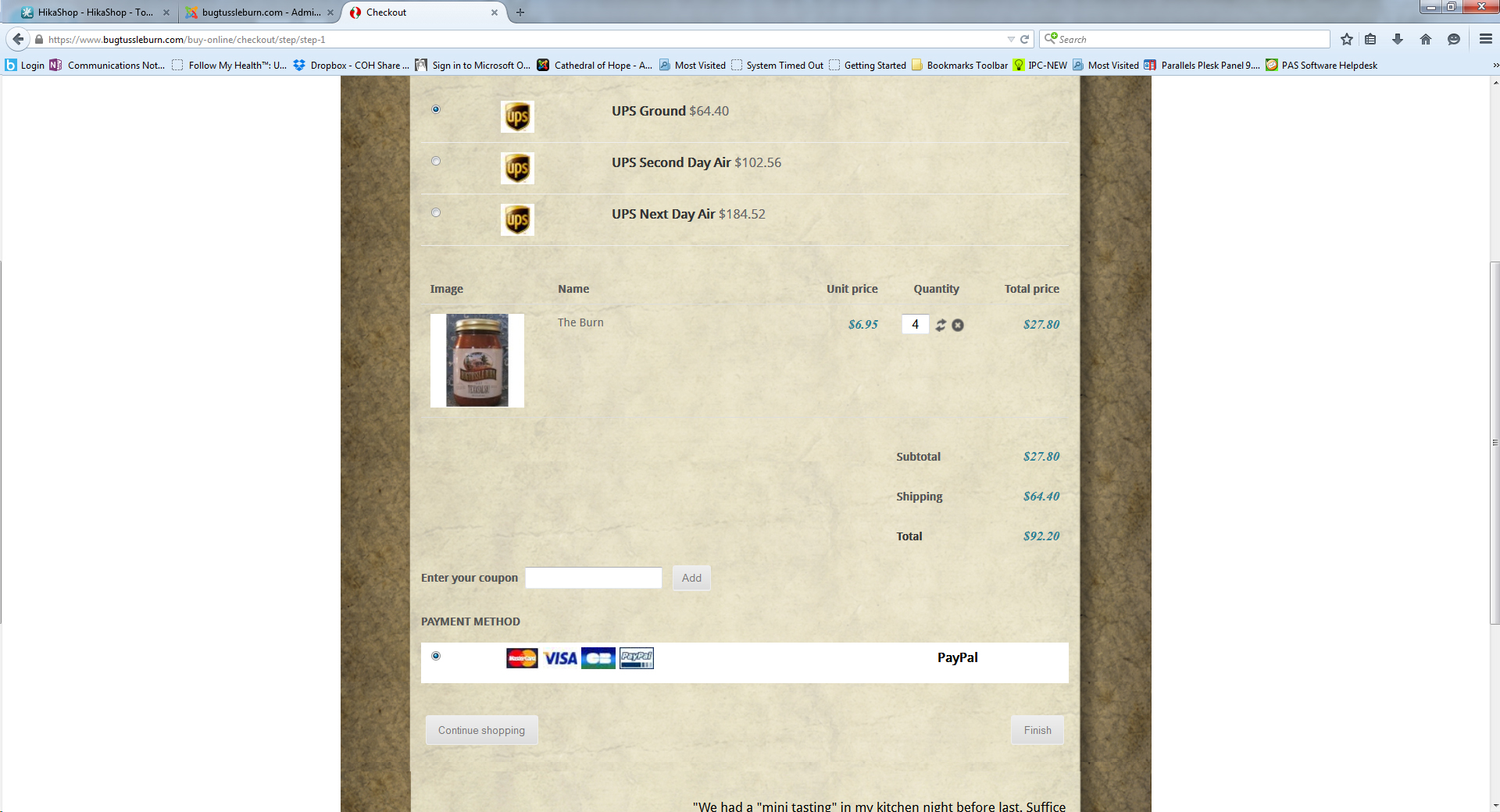

I've attached some screen shots. I used the UPS plugin. The package is 8 lbs and 12x12x12.
It SHOULD cost about 18$ but it's coming out as 64 or 56 or WAY more than 18

Note that you have set the "Price" option to 5, so that rates will be equals to the rates that UPS is sending + 5$.
You should also set a state/province code through you UPS shipping configuration page.

I checked your UPS configuration and note that you should remove the UPS "Price" option that you have set to 5, and also set the "Group packages" option to YES.
The following user(s) said Thank You: Shelley

Thanks...that helped. How do I make it into 1 package instead of 2?
My shipper says she can get 4 jars..my minimum into one 12 x 12 x 12 box with a total weight of 8 lbs. When I set the size and weight on the product level..does it mean for all 4 minimum bought..or is it for 1 single jar?
Thank you so much already!!
  • Posts: 15
11 years 2 months ago #203253
figured it out!!! Thank you so so so so much!!
