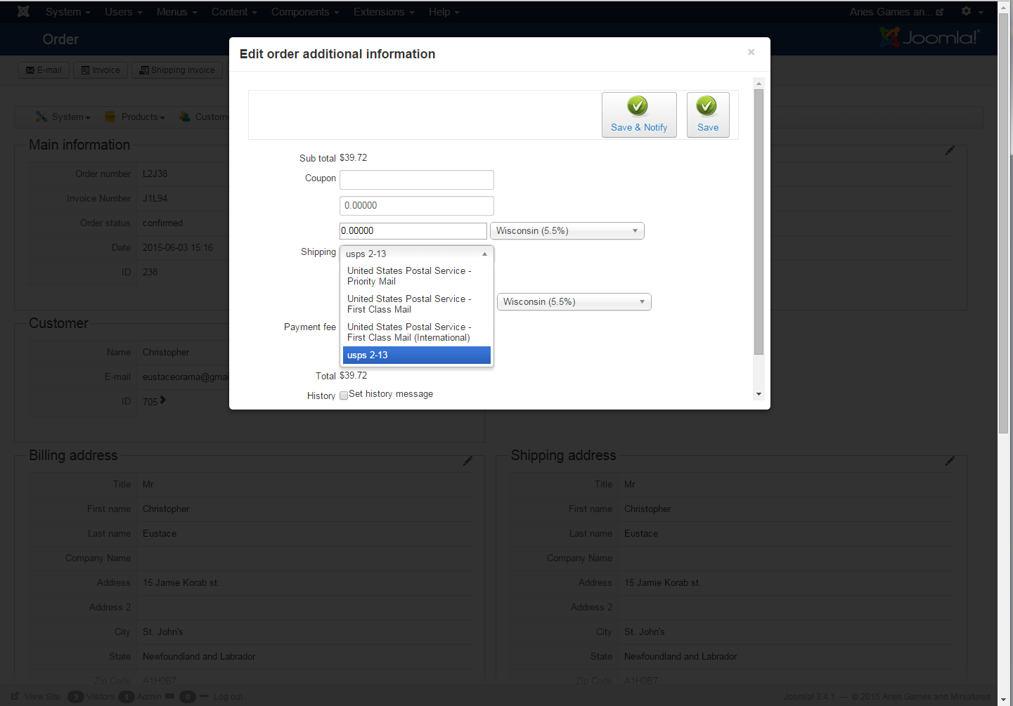

Found more info...in the actual order, if I go to edit the shipping...look what I find in the attached picture. An entry where Priority Mail International should be is "usps 2-13"
Does anyone know what the heck is going on?

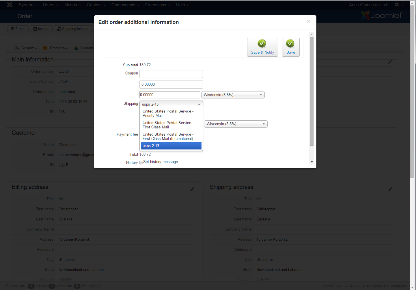

EDIT...as you can see in the attachment, they still do offer standard Priority Mail...as well as the Flat Rate International.
