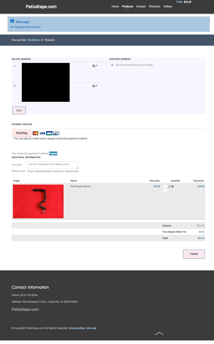

-- url of the page with the problem -- : testpatiodrape.dependentmedia.com/produc...checkout/step/step-1
-- Joomla version -- : 3.5.3
-- PHP version -- : 5.4.13
-- Error-message(debug-mod must be tuned on) -- : Message
No shipping method found
Attached are screen captures that might help. I had shipping working great and then after setting up taxes the shipping stopped working. I want the shipping calculated by the UPS shipping plugin. What did I mess up?

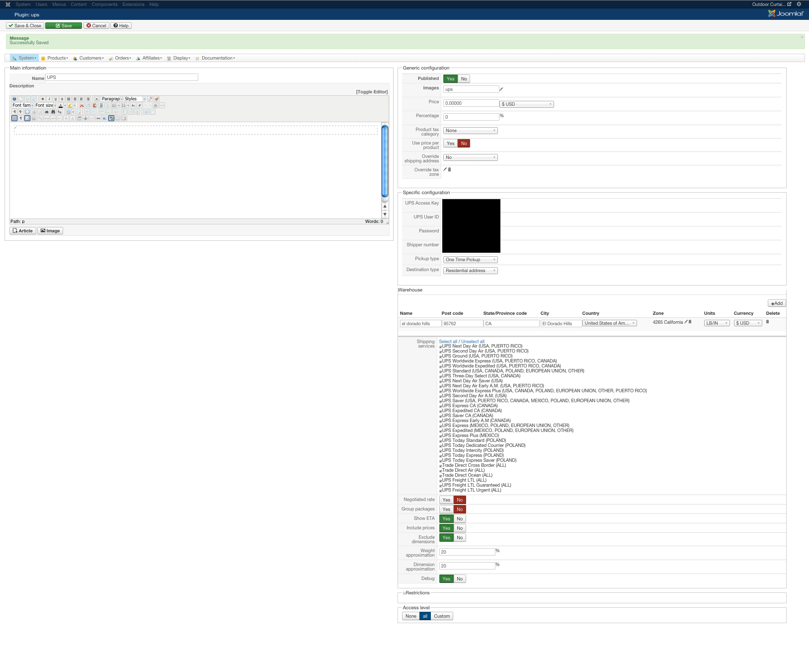

The way you configured your shipping method, it will only display if your address is in California.
I suppose that you want to remove the Zone that you selected in the warehouse area of your shipping method so that the shipping method can be used for addresses outside the zone that is currently selected.

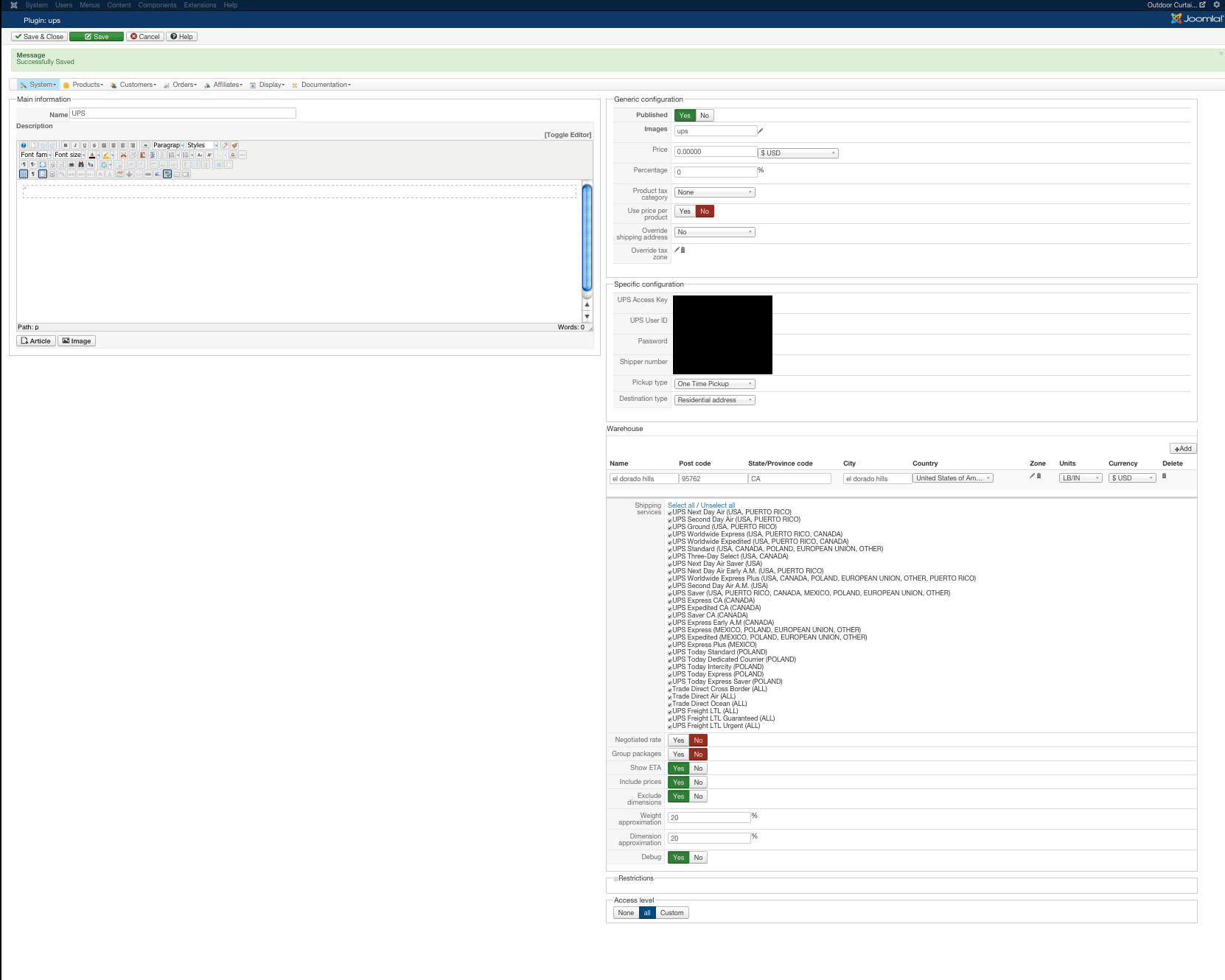

Please remove the Zone that you selected in the warehouse area of your shipping method. You don't want it.
  • Posts: 61
11 years 1 month ago #210442
Still says "No shipping method found"
See the attached for settings verification.

11 years 1 month ago #210716
Yes ; regarding the ticket, Mohamed performed some tests and found the issue.
It looks like it was coming from the fact that you have edited your "California" state for the value "Code 3 letters".
So Mohamed reverted it to use the default and correct configuration.
