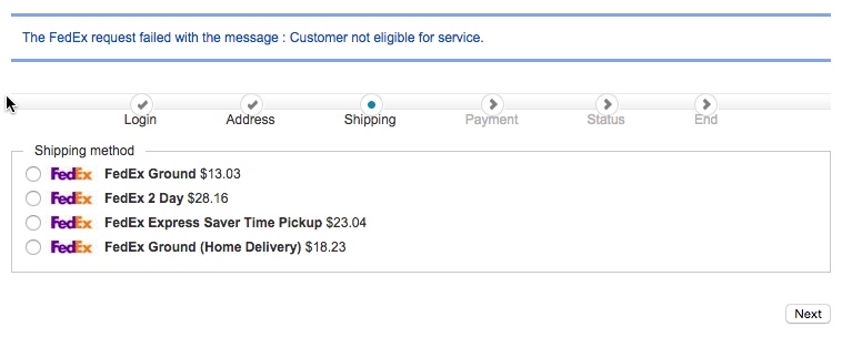

Regardless everyone needs to know that the Fedex shipping plugin IS NOT RELIABLE.
I have attached a screen capture of a test I just did with it. I used a PO Box, and got shipping rates for Fedex Ground, Fedex 2 Day, Fedex Express Saver Time Pickup, and Fedex Ground (Home Delivery), which are all shipping methods that do not deliver to PO Box addresses. Also, you can see I get an error that reads "The FedEx request failed with the message : Customer not eligible for service." That is from turning on FedEx Smart Post.
People need to know that this plugin is not returning valid shipping results at all.
10 years 11 months ago #210907
That error message is only telling your that your FedEx account is not enabled for SmartPost services. To get your account enabled for SmartPost, contact your FedEx Account Manager.

The Hikashop FedEx shipping plugin is only displaying the rates and information returned by the FedEx platform based on the order information that we sent them.
Also, using that kind of code through the "fedex.php" file of the plugin :
if(isset($null->shipping_address->address_street) && preg_match("/PO/i", $null->shipping_address->address_street)){
	$messages['po_address'] = "Your error message";
	continue;
just after the line :
$receivedMethods=$this->_getRates($rate, $order, $heavyProduct, $null);
Will probably do the job, that code will enable you to display an error message and don't display FedEx shipping services if your have "PO" on your customer shipping address.
