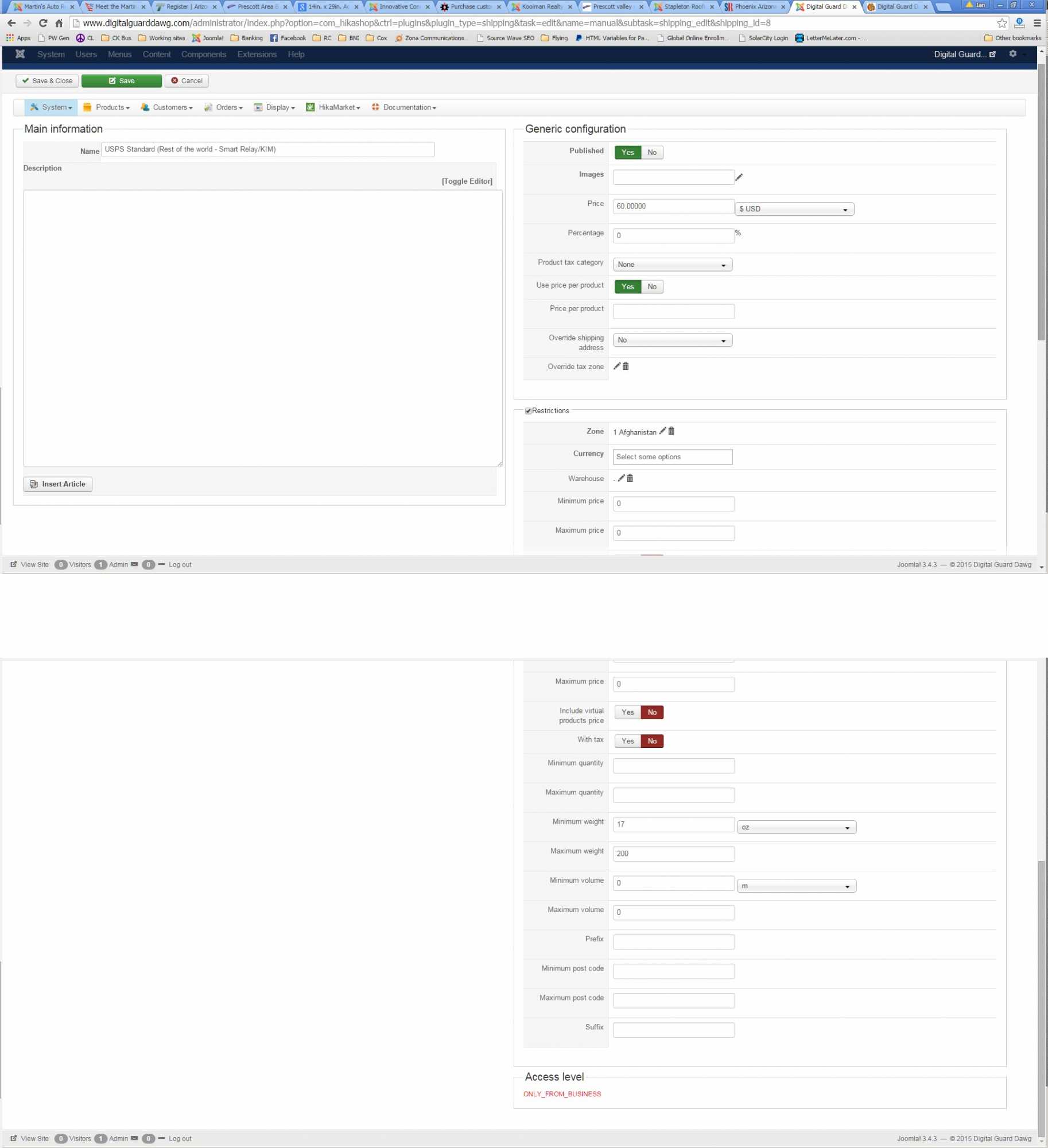

Because USPS and UPS "lookup" facilities just never seemed to work correctly, I added a manual shipping method (with the manual plugin) to "The rest of the world" being everywhere except USA and Canada. I assigned a min weight of 17oz and a max weight of 200oz. It is published.
The shipping options is shown on a particular product weighing 2lbs (28oz). A customer from Australia tried to order it and he got that error, as did I when I used an Australian address.
Why? It seems in 2.5.0 that every shipping method is assigned to every product regardless. I guess this saves time in setup, but doesn't seem to make sense when there's a shipping method for max weight 17oz assigned to this product.

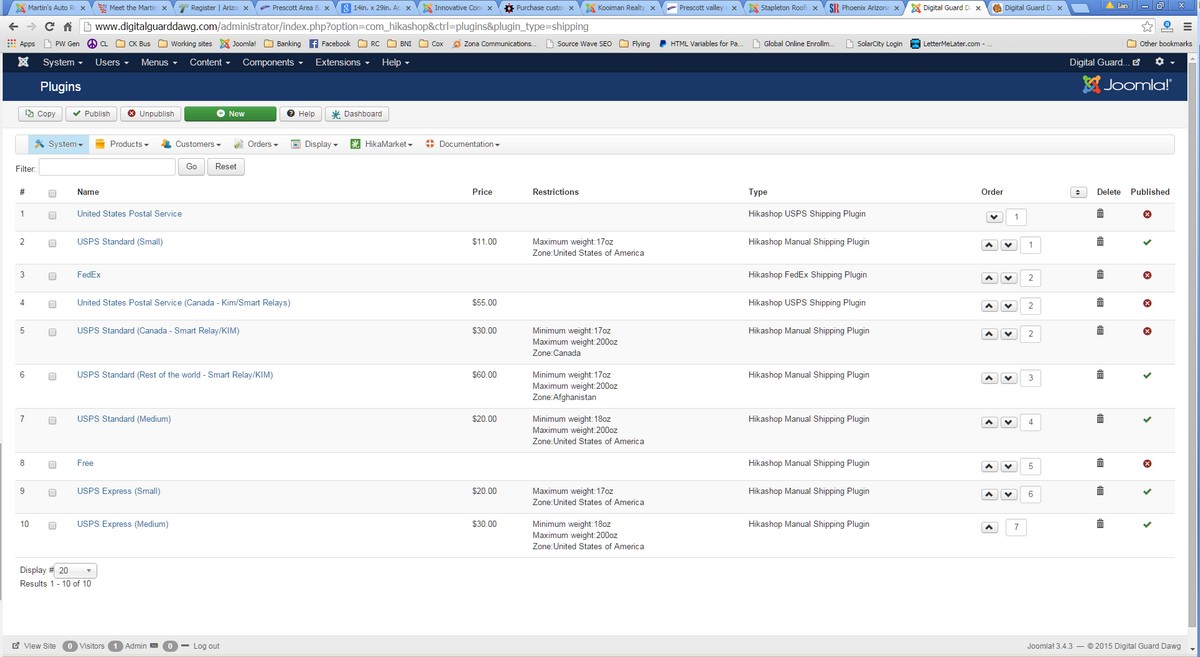

10 years 11 months ago #212524
Why?
Can you tell me where do you exactly want to ship your products ? Because with your current shipping configuration, you'll only be able to deliver your products to :
- USA
- Canada
- Afghanistan
You didn't configured any shipping method by using the "Zone" option to ship your products to Australia.

Well then, that's a HS fault. I selected EVERY country then deleted USA and Canada so E dry other country should be selected. Do I have to make a separate shipping entry for each individual country?
10 years 11 months ago #212589
No, you'll just have to :
- Go to "Hikashop->System->Zones"
- Create a custom shipping zone and add in it every countries different that USA and Canada
- Create a "The rest of the world" shipping method, and add your custom shipping zone on the "Zone" option.
Then you'll have a shipping method for every country including Australia.
  • Posts: 279
10 years 11 months ago #212662
Thank you Mohamed that worked. Unfortunately, I couldn't find documentation on doing this so I thought that, during the setup of the shipping method, I could select multiple zones in the zone field which, honestly, makes a lot more logical sense to me. I didn't realize that a special zone needed to be created first then THAT zone applied to the shipping.
