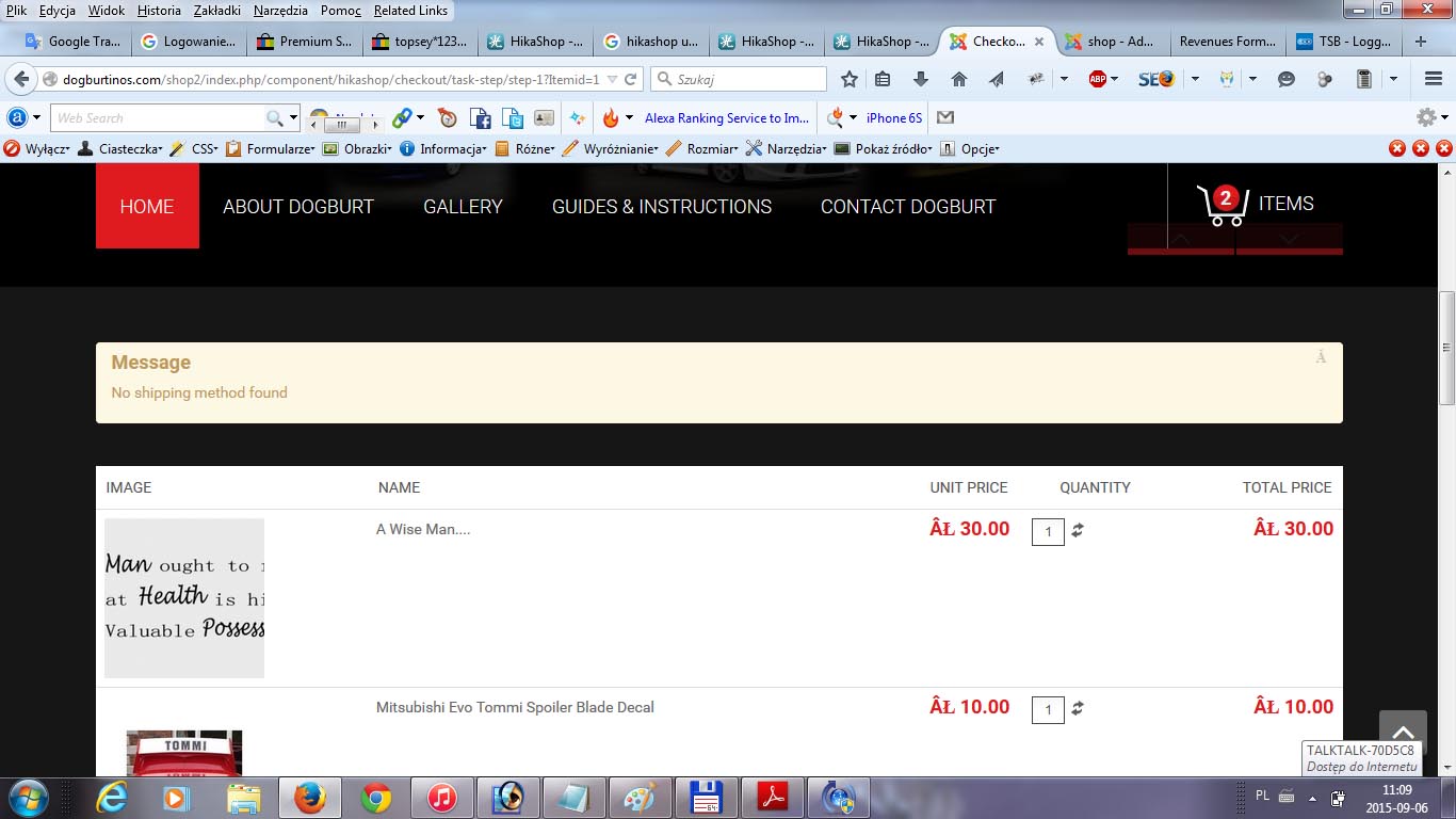

I got one issue about Shipping method
When I want to buy something from my online shop I am getting alert that :
Message
No shipping method found
but I was creating 3 manulas methods in hikashop->System->Shipping MEthods
I dont tick none 'Restrictions' on these method, also my products dont have none 'weight'
Thanks for help

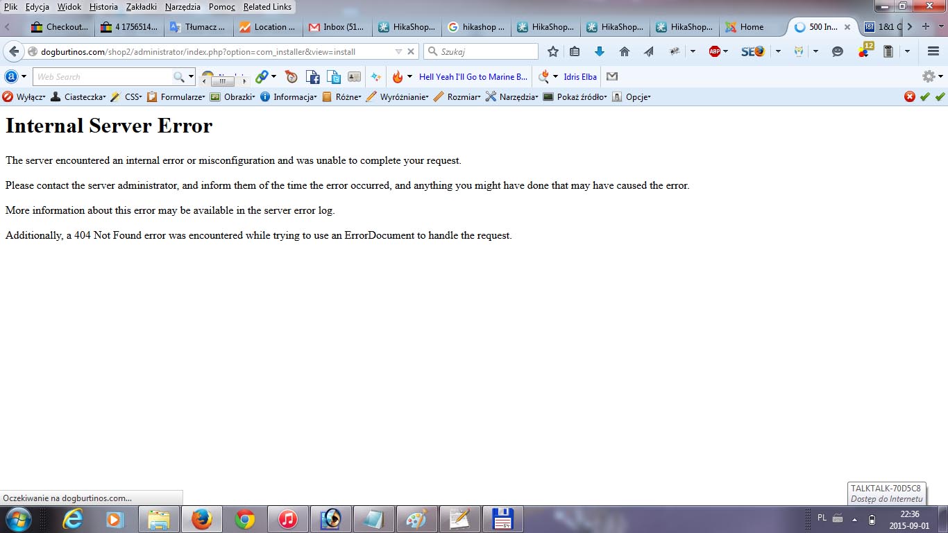

thanks for answer... yes i am trying to do that, but i am geting this error:
I attached screen
I cheked logs/error.php and i have nothing there...
[/b]
thanks for help
  • Posts: 26380
10 years 11 months ago #213075
You won't find that kind of information in the Joomla error log ; but you will find them in the PHP error log.

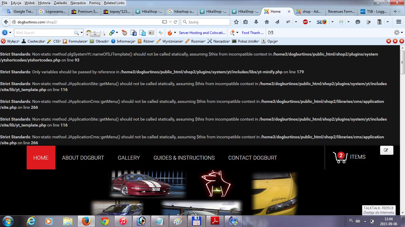

  • Posts: 9
10 years 10 months ago #213436
Thanks for answer
Yes I changed for error_raport 'maximum' and I got installation of a new version of hikashop, but still is not working shipping method
I have attached screenshot

10 years 10 months ago #213444
These are just "Strict Standards" errors, they will just disappear when you'll lower the "error reporting" option.
Can you follow each step of the "Shipping methods" section of the FAQ regarding your "No shipping method was found" ?

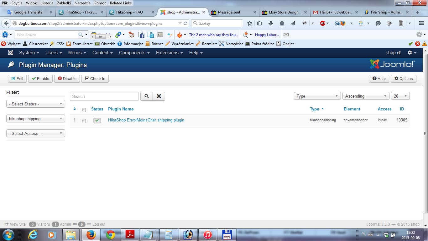

  • Posts: 9

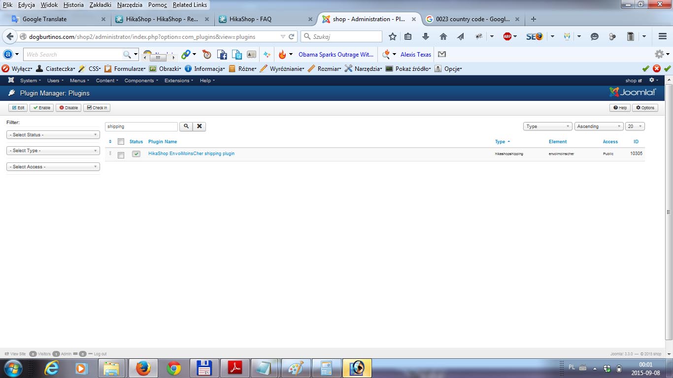

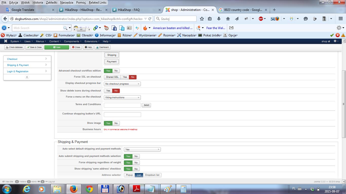

10 years 10 months ago #213543
Hello
Oki I check this list and everything i have the same like is writing there, but I have some questions about 2 points:
1) Check that the manual shipping plugin is installed and published
- so i got one (you can see on the screenshot)
6) Check that you have the shipping view in the checkout workflow option of the configuration
I think I got (see the screenshot)
Another points i understood and i have correctly
Thanks for help
  • Posts: 85995
  • Thank you received: 14167
10 years 10 months ago #213587
1. You've got one. But you probably don't use it, as this one is only for France. So that means that you uninstalled the others and that' why you get that error. Install again HikaShop and it will fix the problem by installing back all the plugins that were removed.
6. Yes, no problem.

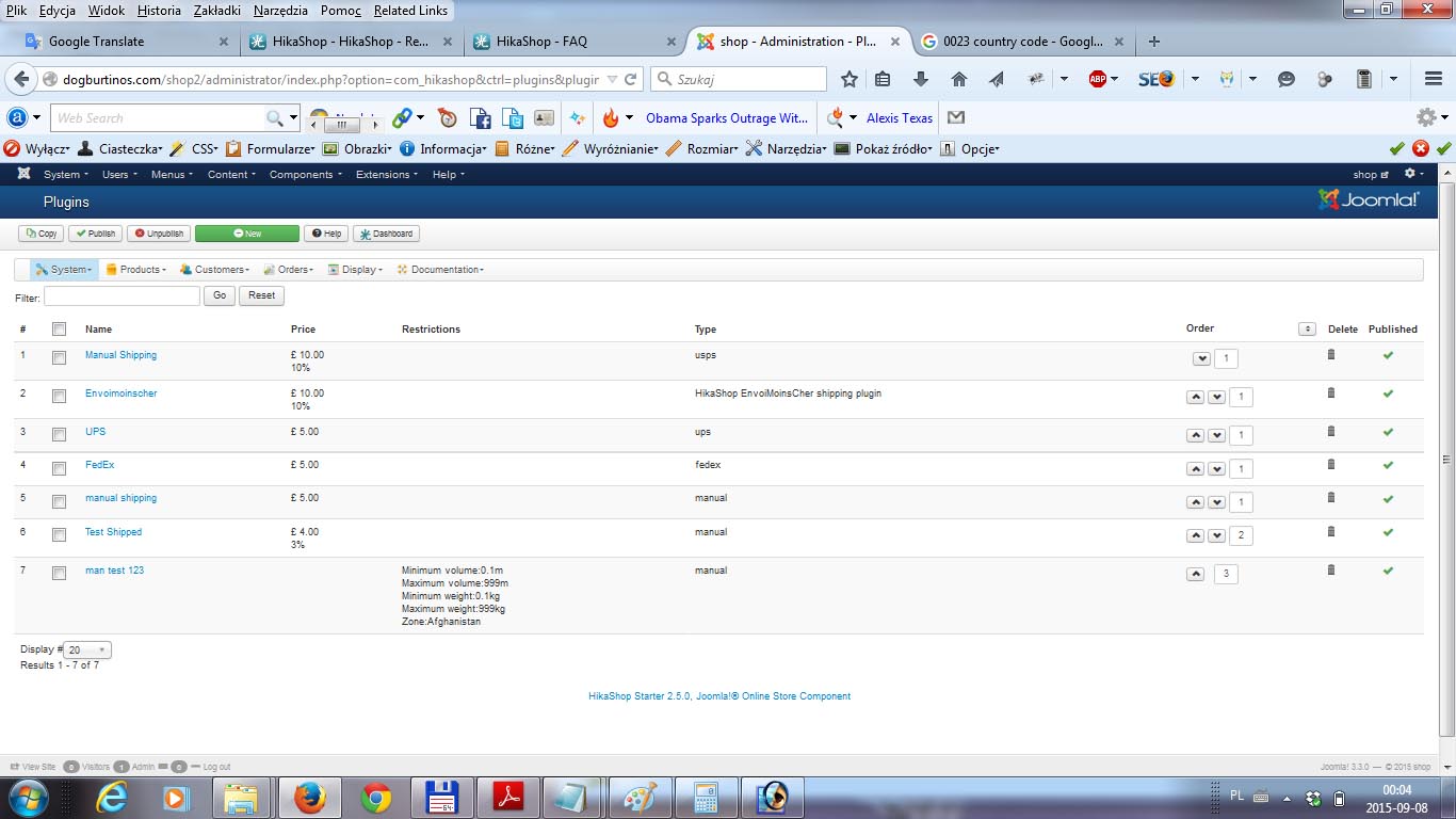

  • Posts: 9
10 years 10 months ago #213638
I looked on my files in server and I nothing unistall... I have plugins of shipping, Please look I attached screnshoots

  • Posts: 26380
10 years 10 months ago #213647
We removed your screenshot because they were some private information available.
Even if the files are there, the plugin could be "uninstalled" and not being present in the database.
In that case you should use the "discover" feature in Joomla extension manager ; where Joomla can detected plugins files which does not have an entry in the database (and then it can register them).
