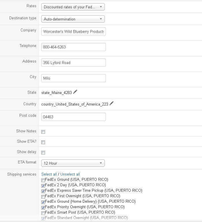

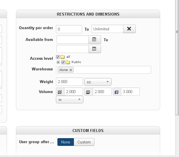

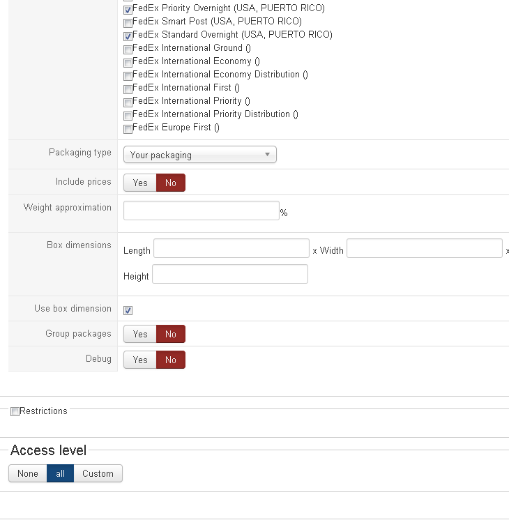

10 years 10 months ago #213939
The order placed to generate the request mentioned above was for a quantity of 40.
The weight for each item is 2 oz.
The volume is 2 x 2 x 3 in
Screenshots attached
10 years 10 months ago #213948
I just tested it on my end and the FedEx plugin is correctly sending a product with :
- Weight : 1KG (minimum is 1KG)
- Dimensions : 5.08 x 5.08 x 7.62 cm <==> 2 x 2 x 3 in
That shipping method is correctly working on my end I'll probably need a temporary access to your back-end to directly test it. You can send it through our contact form : www.hikashop.com/support/contact-us.html
Thanks.
