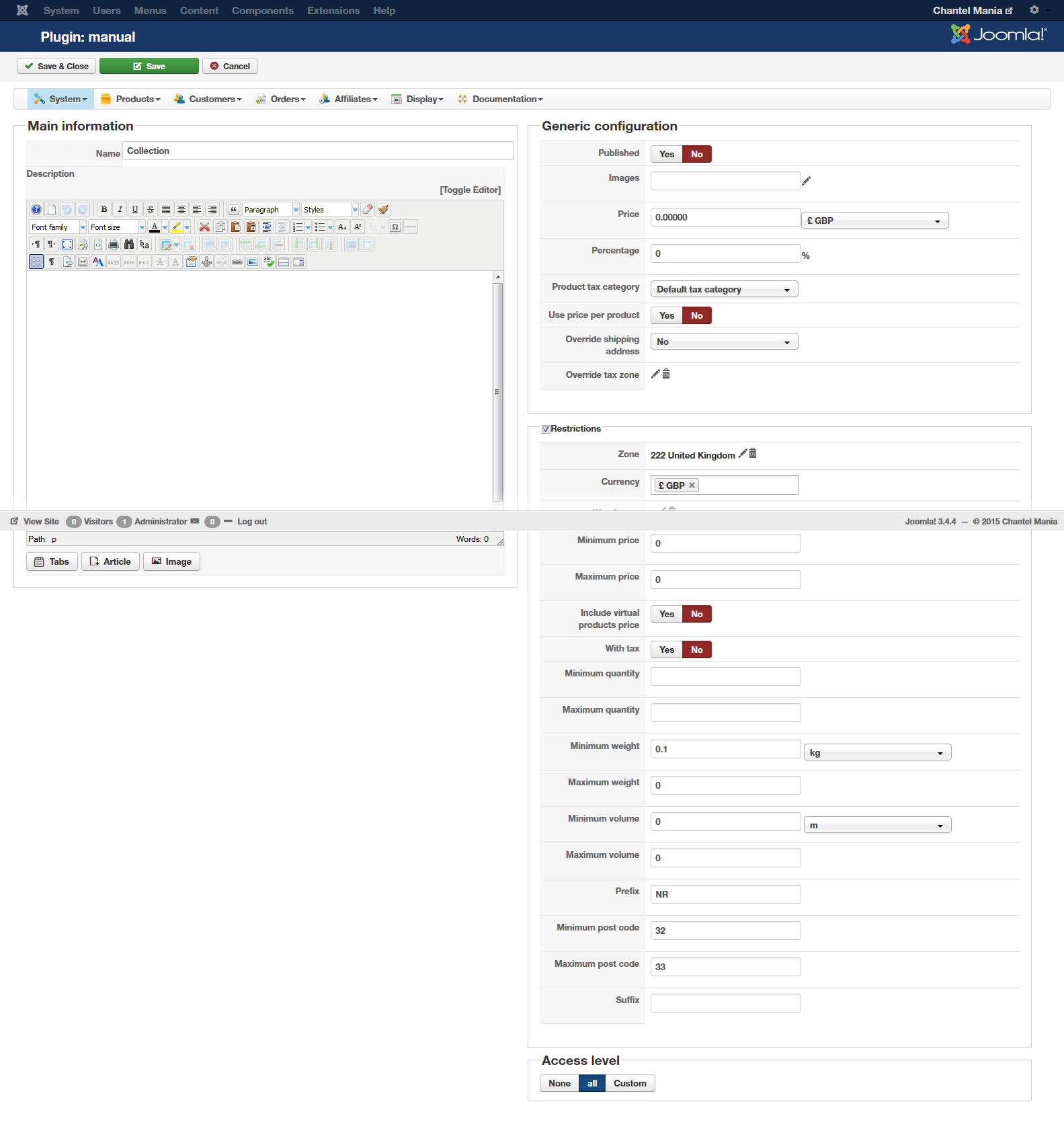

10 years 10 months ago #214798
Hello Mohamed
Please find attached the screenshot for the free shipping method.
Dave
  • Posts: 85995
  • Thank you received: 14167
10 years 10 months ago #214805
The problem is probably with the post code.
The way you set it, the payment method would only appear if the post code of the customer is exactly NR32 or NR33
