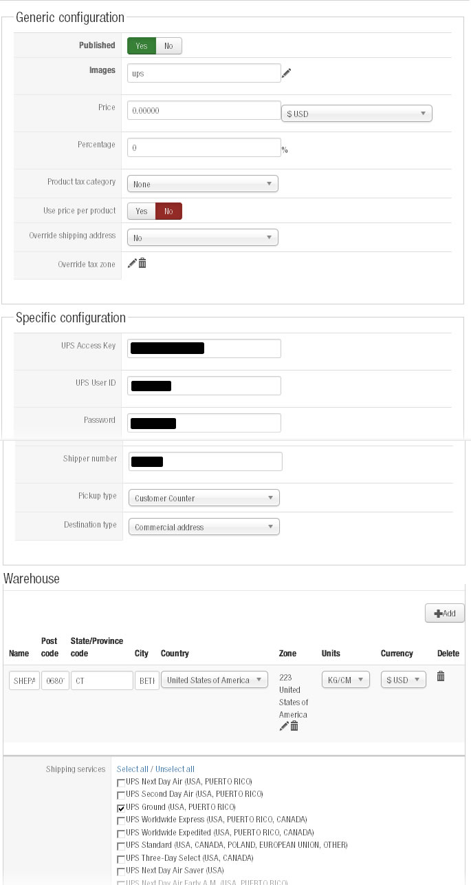

Could you provide a screenshot of the settings of your UPS shipping method ? (you can blur the values for the credentials)

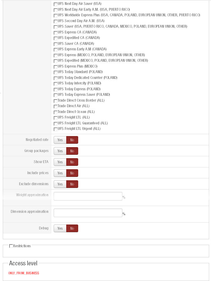

Here are the screenshot of the UPS plugin.

10 years 11 months ago #215056
Can you test it with all the UPS services selected through your UPS configuration page ?

10 years 11 months ago #215131
Did you also set a shipping address from USA ? Can you test it without the "Zone" option of your UPS Warehouse ?

10 years 11 months ago #215318
It seems like your issue was coming from the fact that your UPS shipping method can't be available because you had a "SHEPARDS INC" warehouse on your products but not on your shipping method.
It's working fine now.
