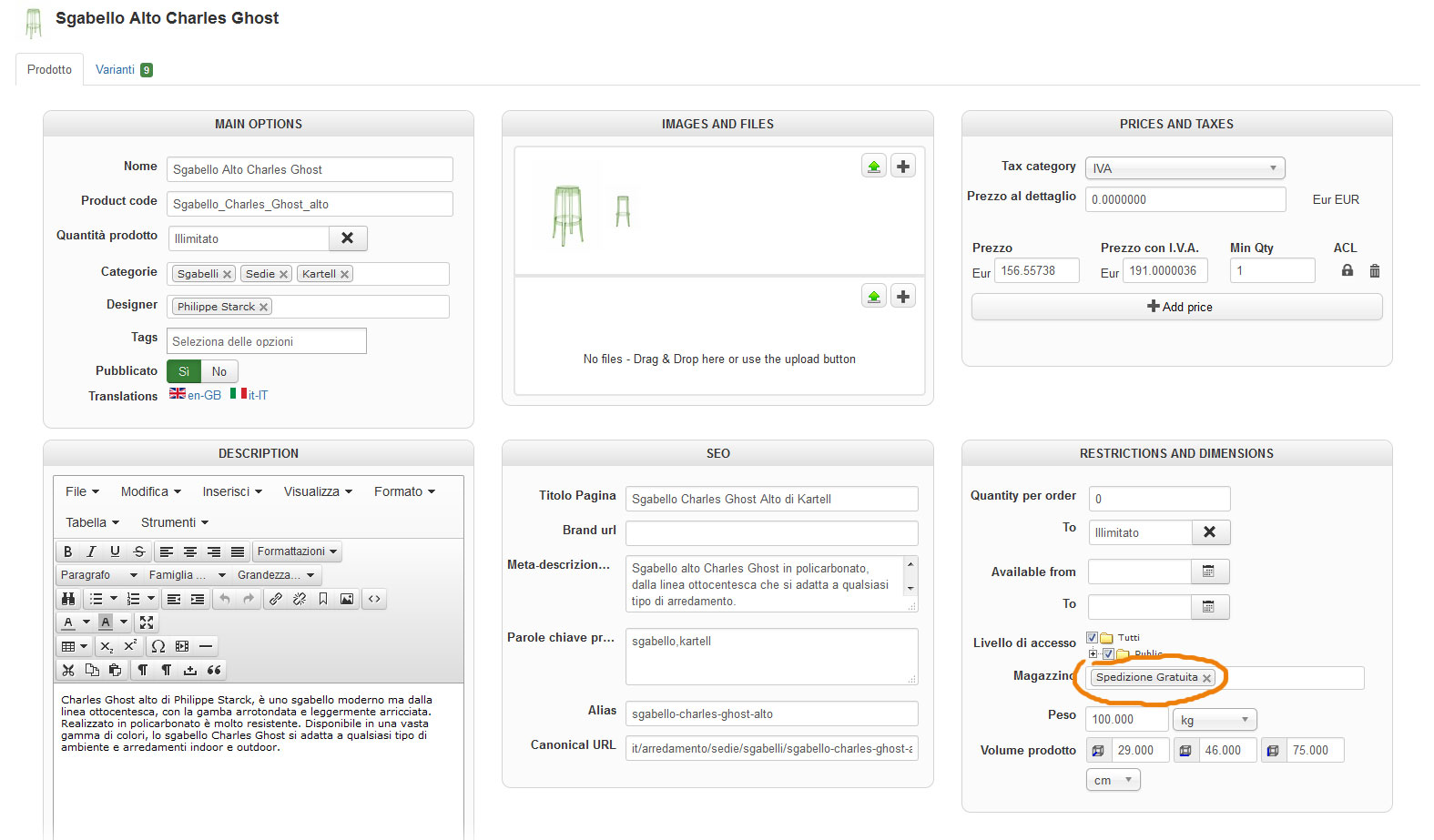

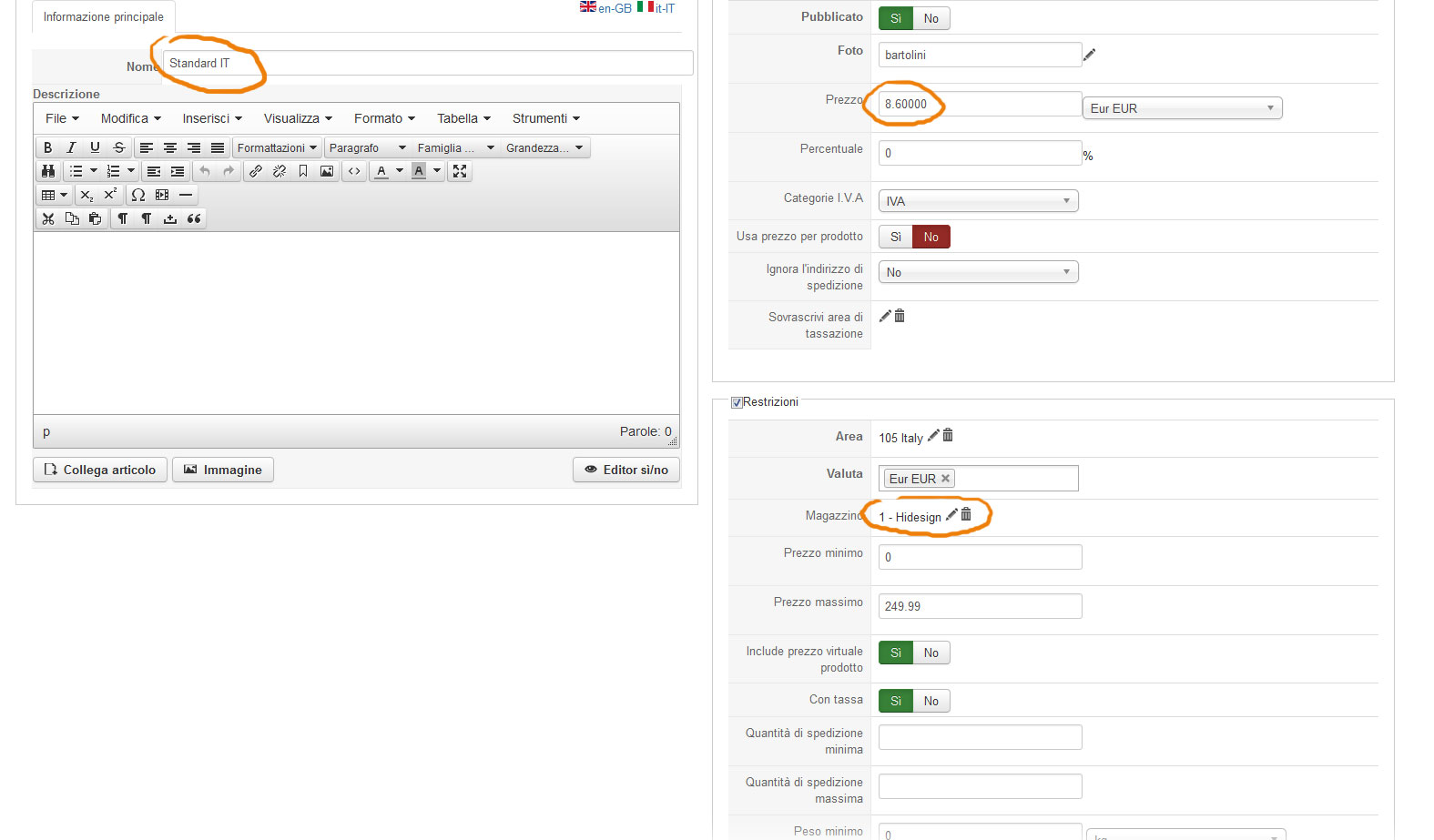

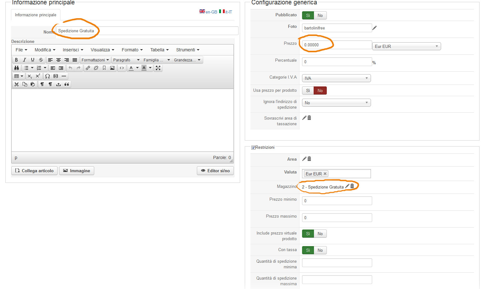

This setting is for shipping cost restricted to warehouse 1
This setting is for shipping cost restricted to warehouse 2

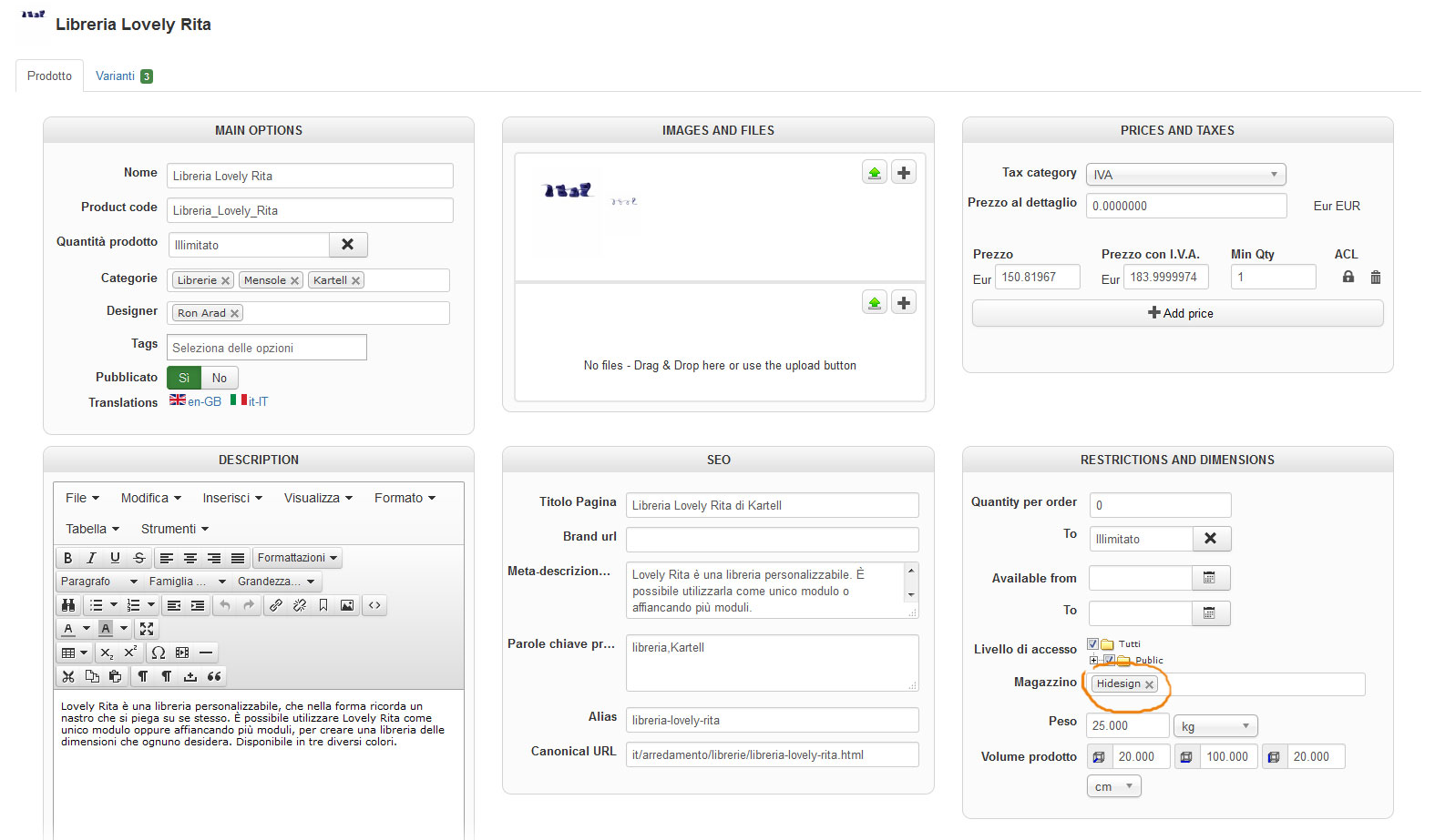

This product is from warehouse-1
ams20.siteground.eu/~hidesign/en/furnish...ria-lovely-rita.html
This product is from warehouse-2
ams20.siteground.eu/~hidesign/en/furnish...host-high-stool.html
If you try to buy the product from the warehouse-2 you should have free shipping, but is not so.
Last edit: 10 years 11 months ago by Nello.

I have more than one shipping methods associated with warehuose-1(hidesign). PROMO 250 IT is one of these, Standard IT is also one of these.
But the shipping method associated with warehouse-2 (Spedizione Gratuita) is only one, and it is Spedizione Gratuita.
So purchasing the second product "Sgabello Alto Charles Ghost" you should have the shipping cost "Spedizione Gratuita", instead you get PROMO 250 IT or other shipping cost associated with warehouse-1(hidesign).
