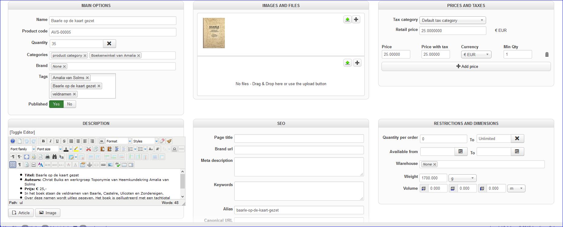

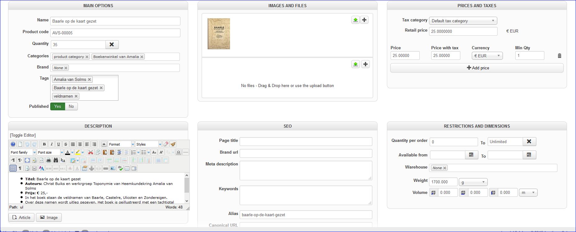

I created some products (books) each with there own weight in grams.
e.g. book 1 is 1700.00 grams

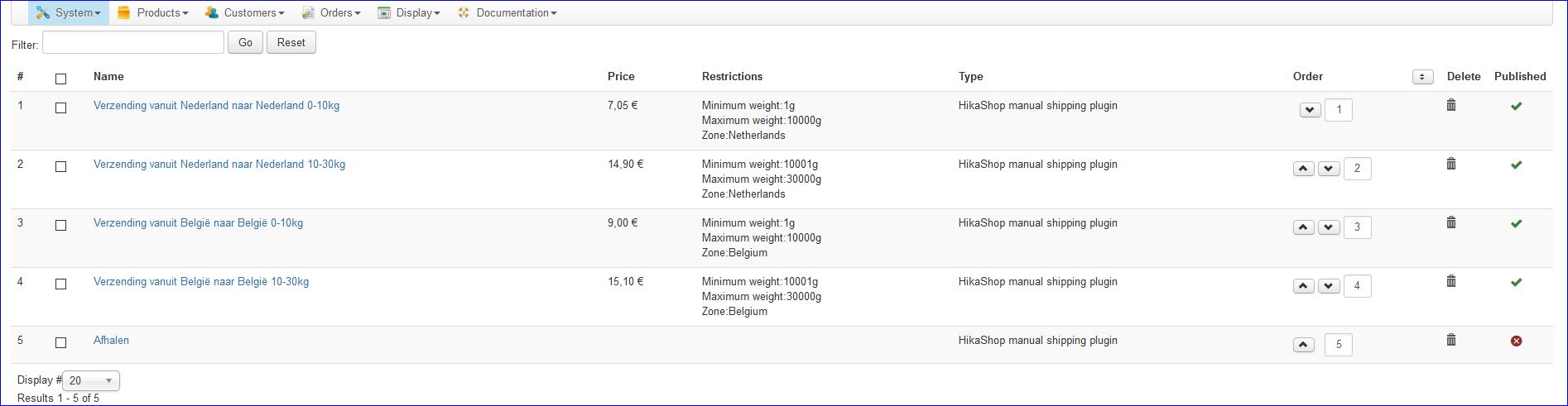

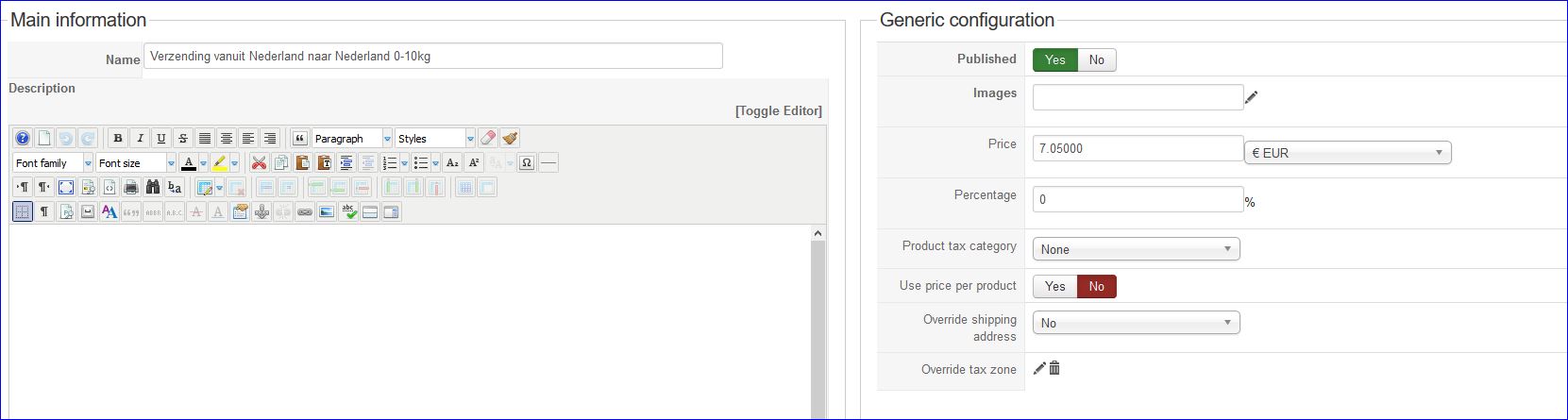

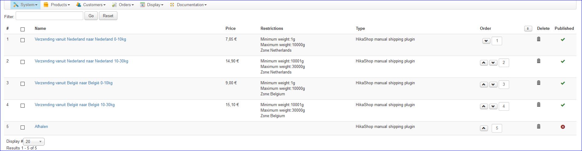

I made 4 shipments :
1 for Netherlands from 1 to 10000 grams
2 also Netherlands from 10001 to 30000 grams
And 2 for Belgium in the weight classes just other prices.
I created a customer who lives in the Netherlands.
But here it ends. No shipping methode is used on checkout.
What did i do wrong ?

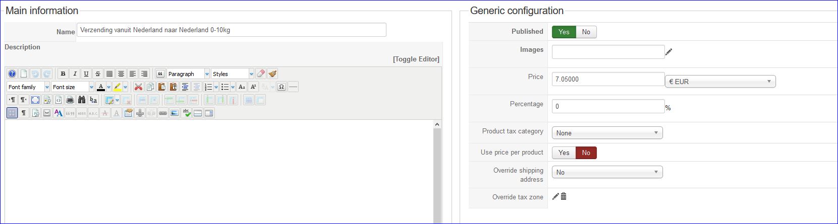

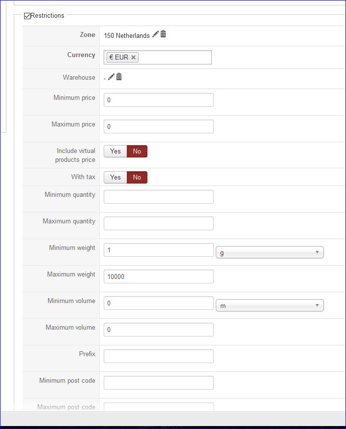

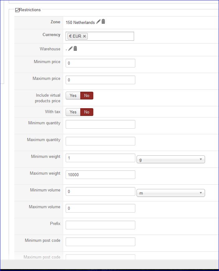

This is one of the shipment methodes:
regards Jan
  • Posts: 88
10 years 11 months ago #217863

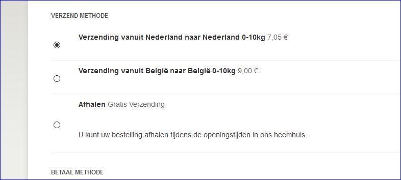

i just found out that if i remove the zone from the 2 methode for weight between 1 gr and 10000 grams (so for Netherlands and Belgium)
it works partly i now can choos between the shipments.
Could it be possible the system cannt compare the country from the shipping methode with the country from the customer ?
regards Jan
Last edit: 10 years 11 months ago by Polleke.

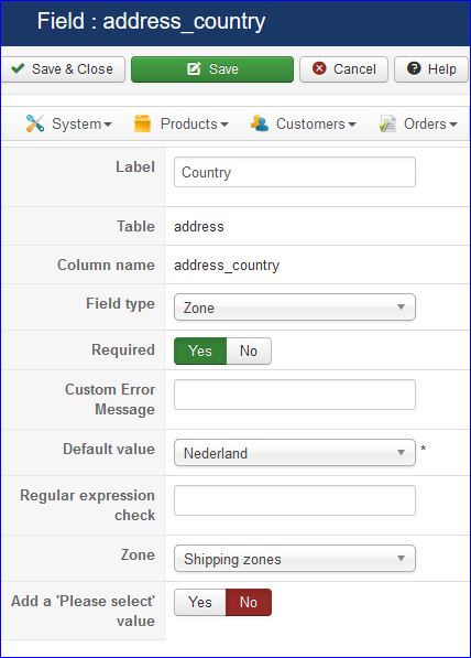

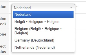

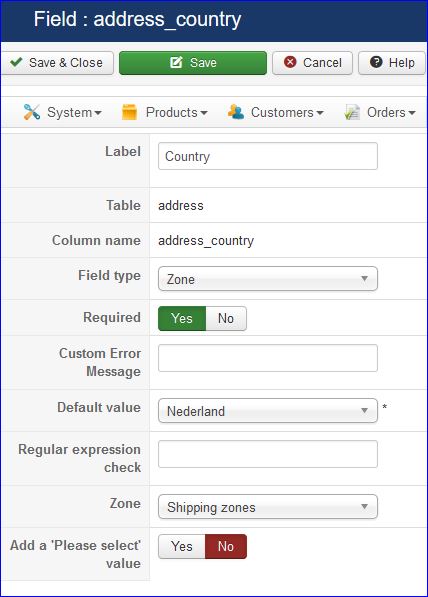

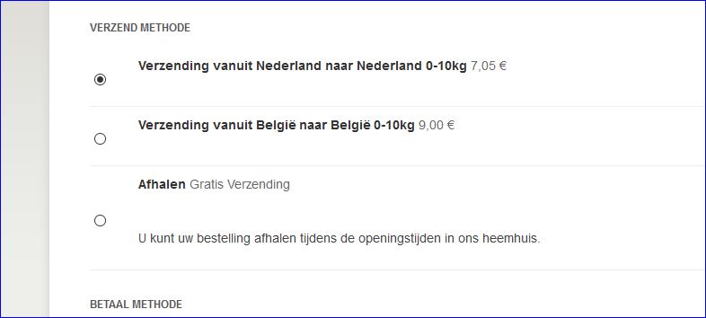

Well in the shipping method i used the zones "Shipping zones" Because country would not work.
Then i altered the custom field "Adress_country" and added the 2 countrys (Netherlands and Belgium) as shipping-zone country.
See picture
This seems to work. Accept when a new customer is added he sees 2 time Netherlands and also twice Belgium.
See picture
regards Jan
10 years 10 months ago #218044
The best solution will probably be to use the default "Country" zones, but note that you can also unpublished the countries and use your shipping zones.
