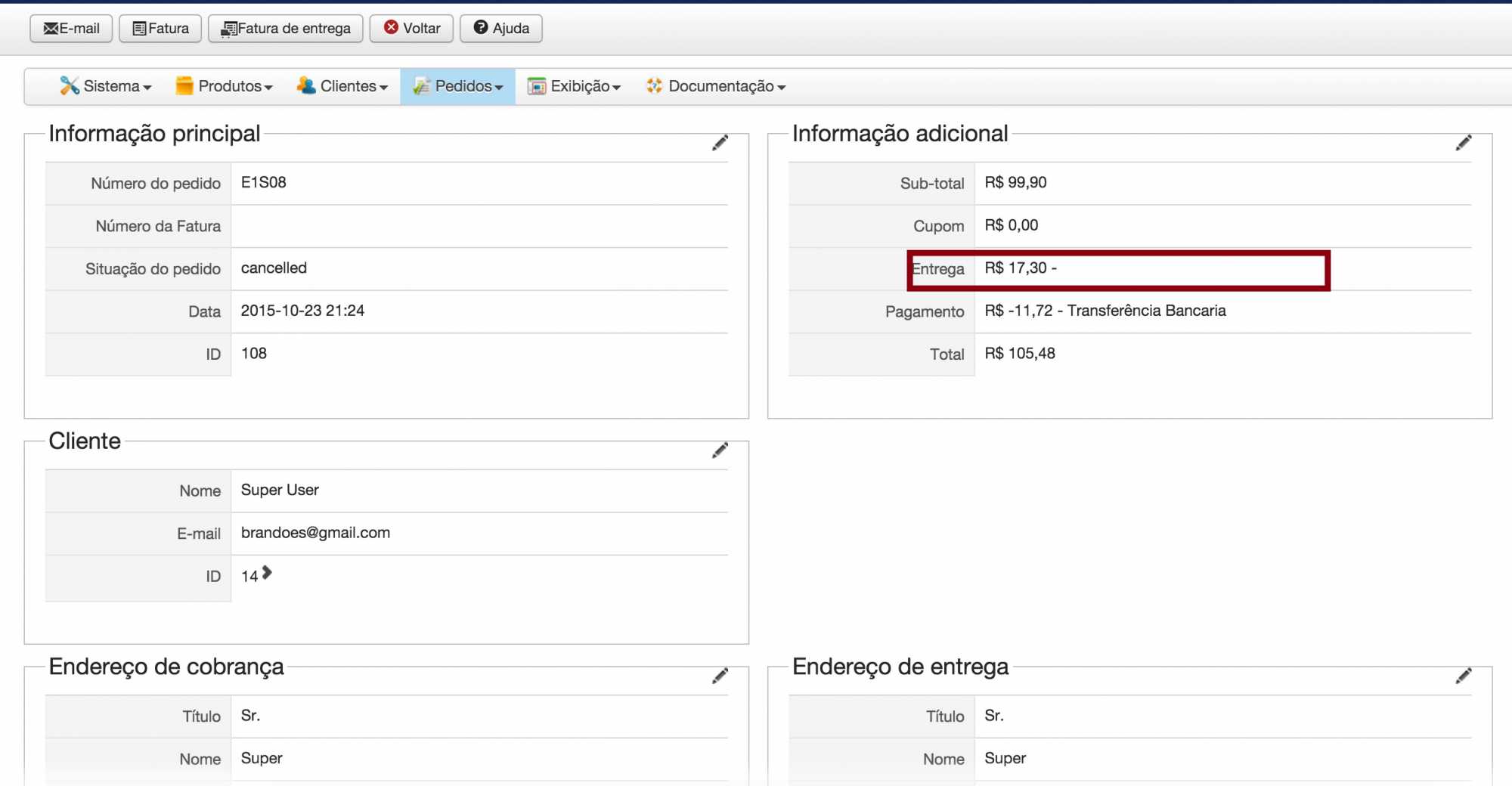

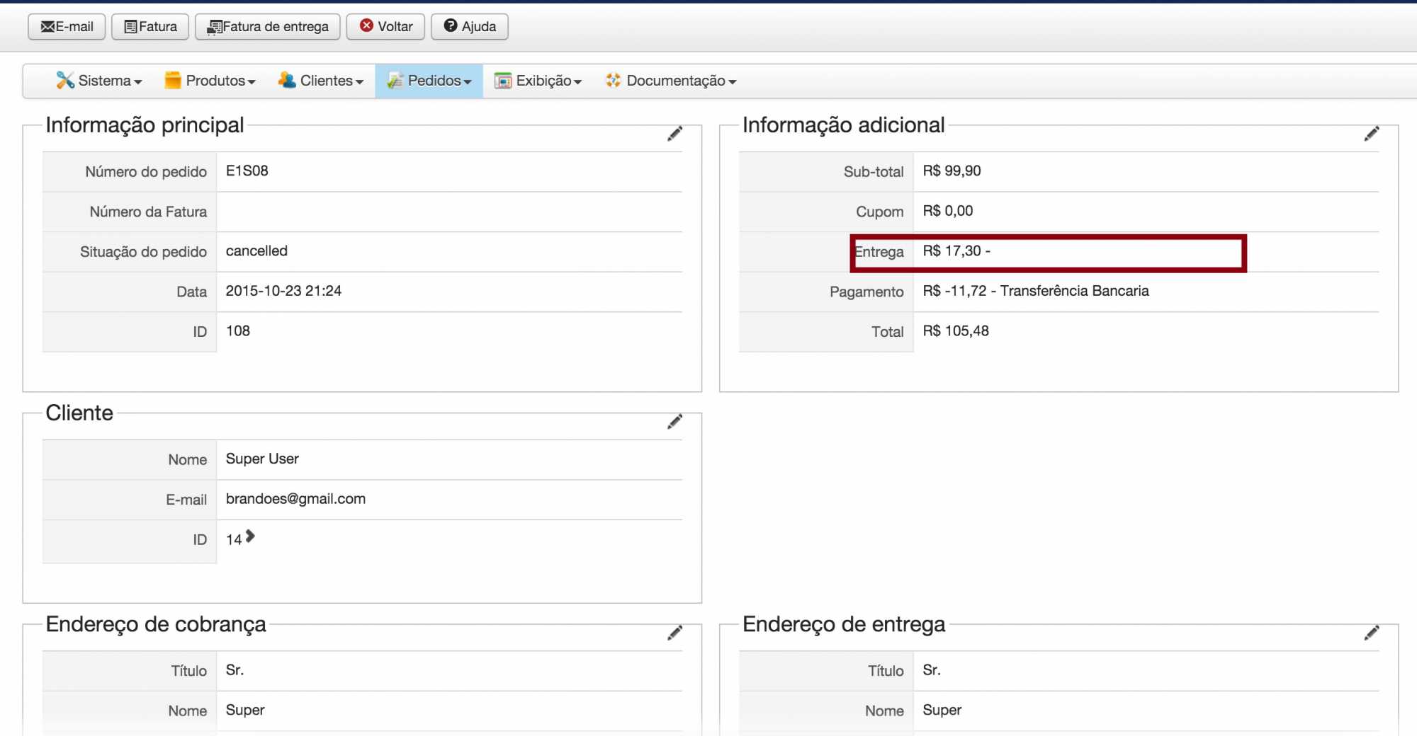

Hi how are you ?
I have a problem, with delivery, to my administrator page came only price to delivery, I don't know whats method my client select if PAC or SEDEX,
I used plugin correios from Brazil.
have a look image attached, I select in red what's problem.
if you check blelow payment is correct. came to front name used.
I hope you you help me.

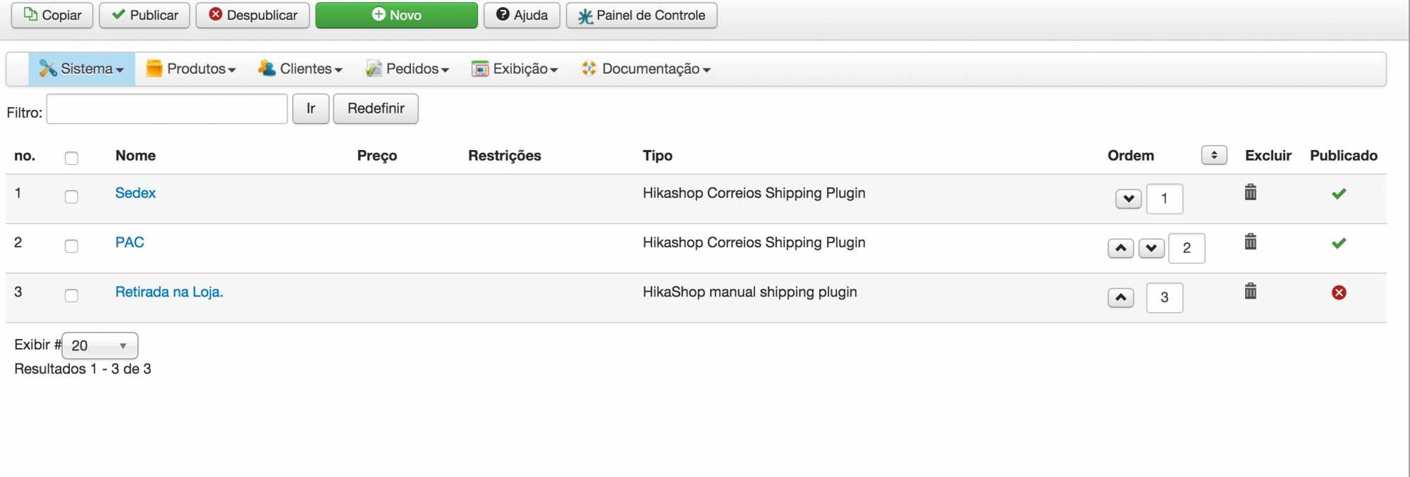

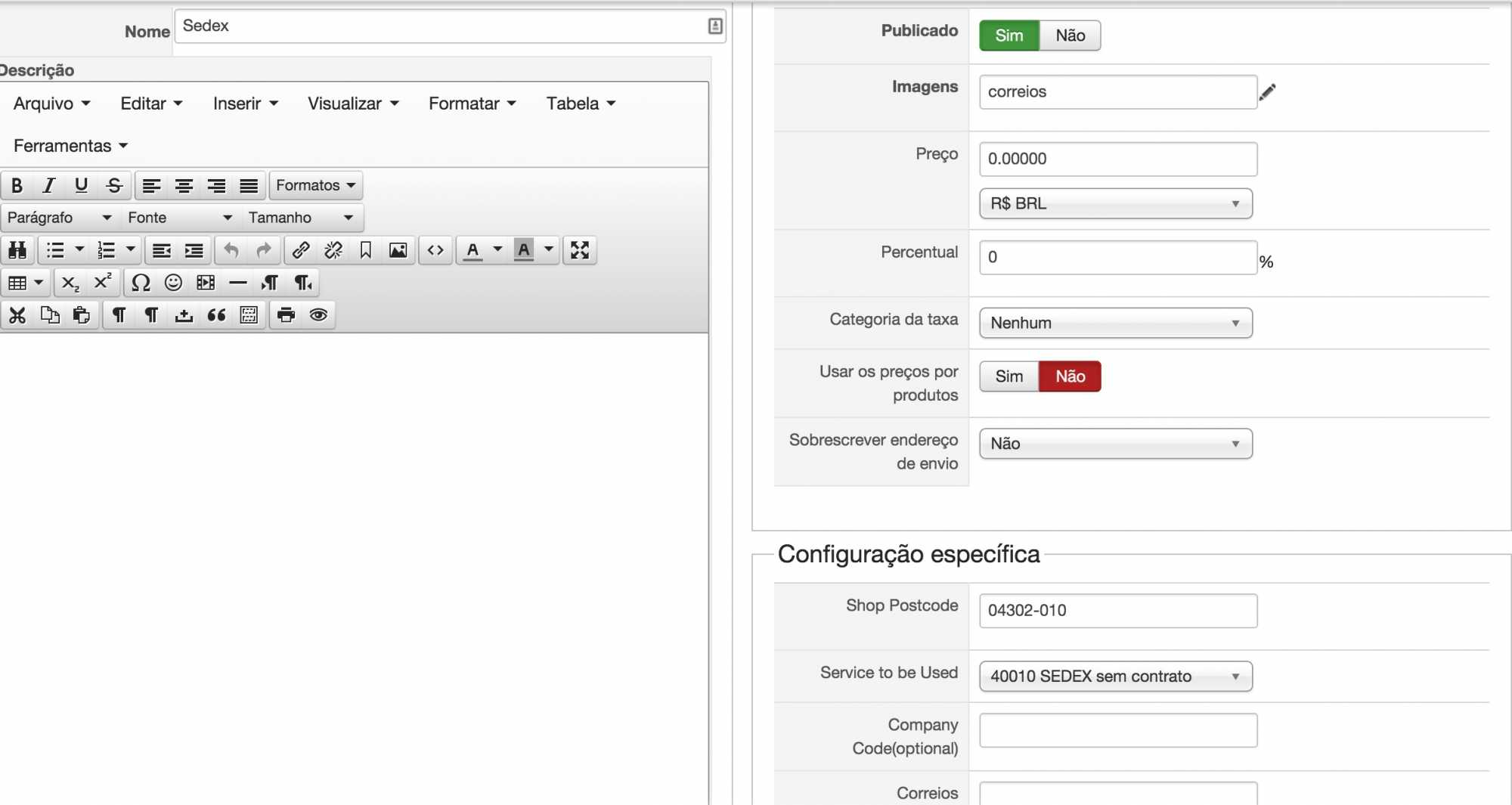

You should rename you shipping method through your shipping method configuration page ("Hikasohp->System->Shipping methods").
  • Posts: 28

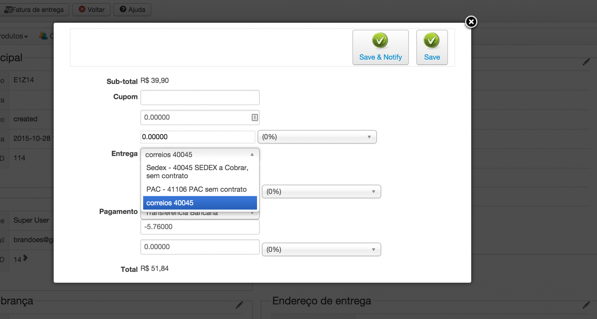

10 years 10 months ago #218470
I do that but not working.
have a look image attached.

  • Posts: 28
10 years 10 months ago #218722

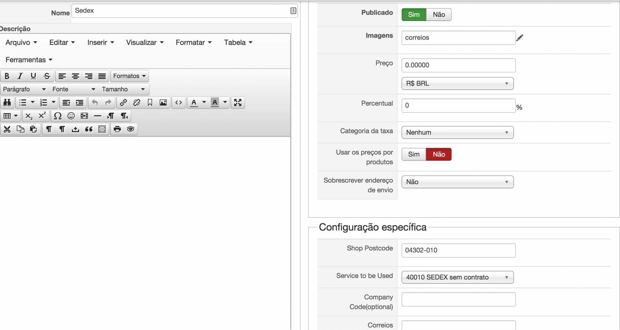

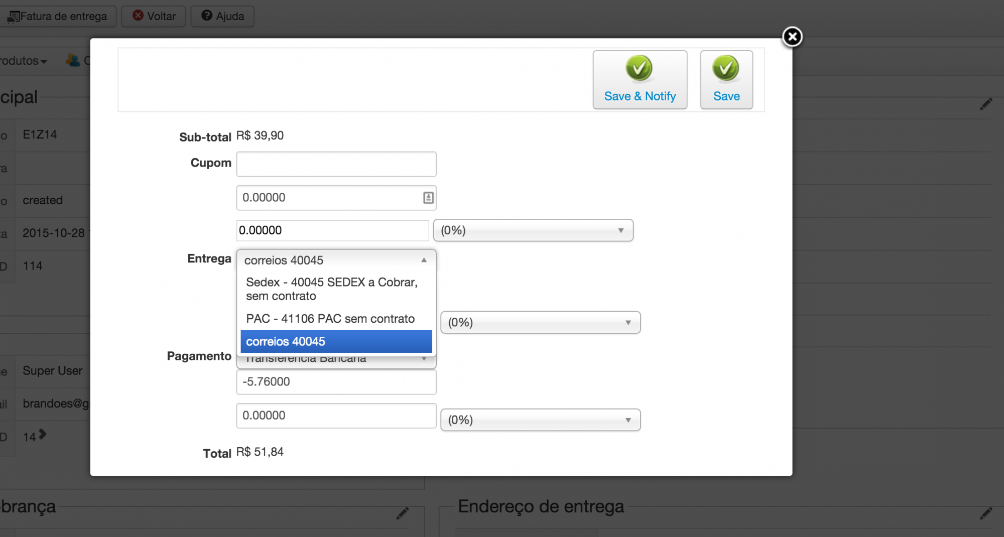

when you select delivery, have 2 coiche
SEDEX or PAC, have a look image attached when I edit order.
have more option.
10 years 10 months ago #218754
That's because you'll only be able to select the shipping methods you offered to your customers through your shipping configuration page.
  • Posts: 28
10 years 10 months ago #218788
But who I fix that?
If I offer only one delivery is complicated for me because customer think it's very expansive
Sedex is more expansive than PAC
I have client would like Sedex because is more fast, other costumer prefer pac because is cheap.
In this case I need set put 2 correios delivery 1 for Sedex other for pac. This is correct?

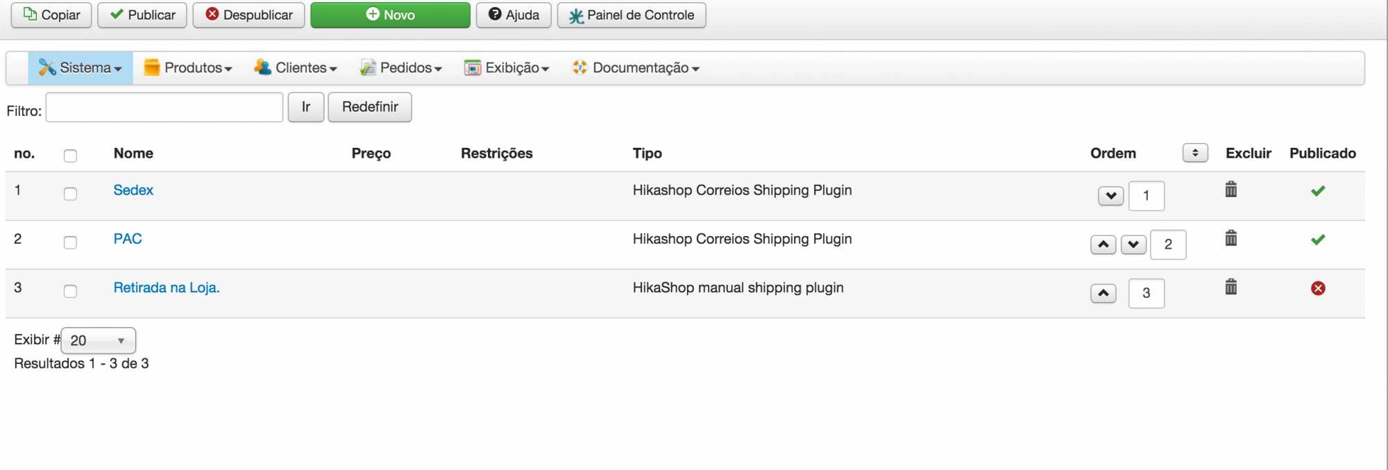

The correios wasn't originally developed by us, but a solution can be to create multiple Correios shipping methods, for each service you want.
  • Posts: 28
10 years 10 months ago #218875
But I created mult correios not show to me which method selected
Because I open this topic

10 years 8 months ago #227054
We fixed the issue on your end, there was indeed a problem with the id when the shipping method was selected.
Thank you for this feedback, we added this fix on our end too.
