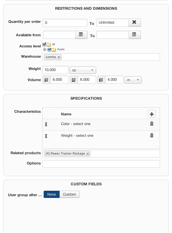

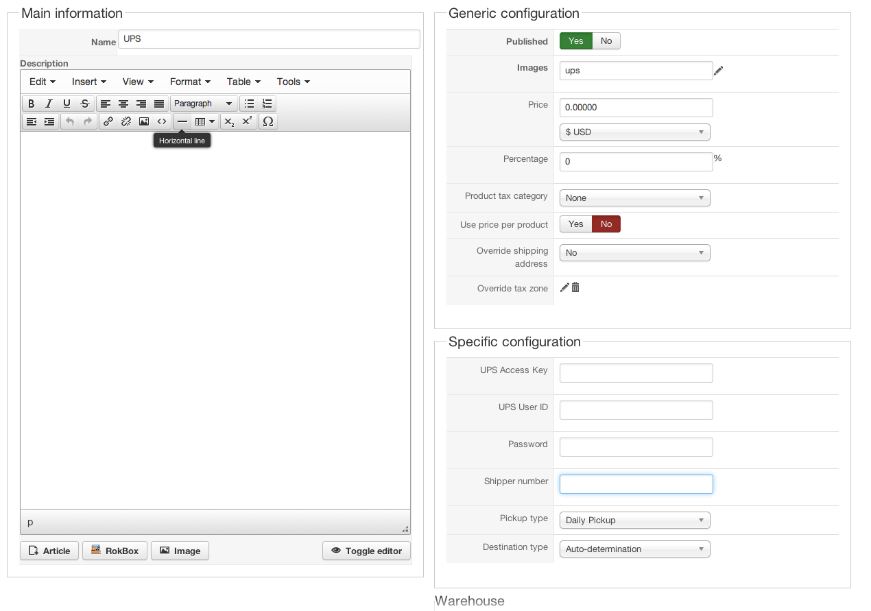

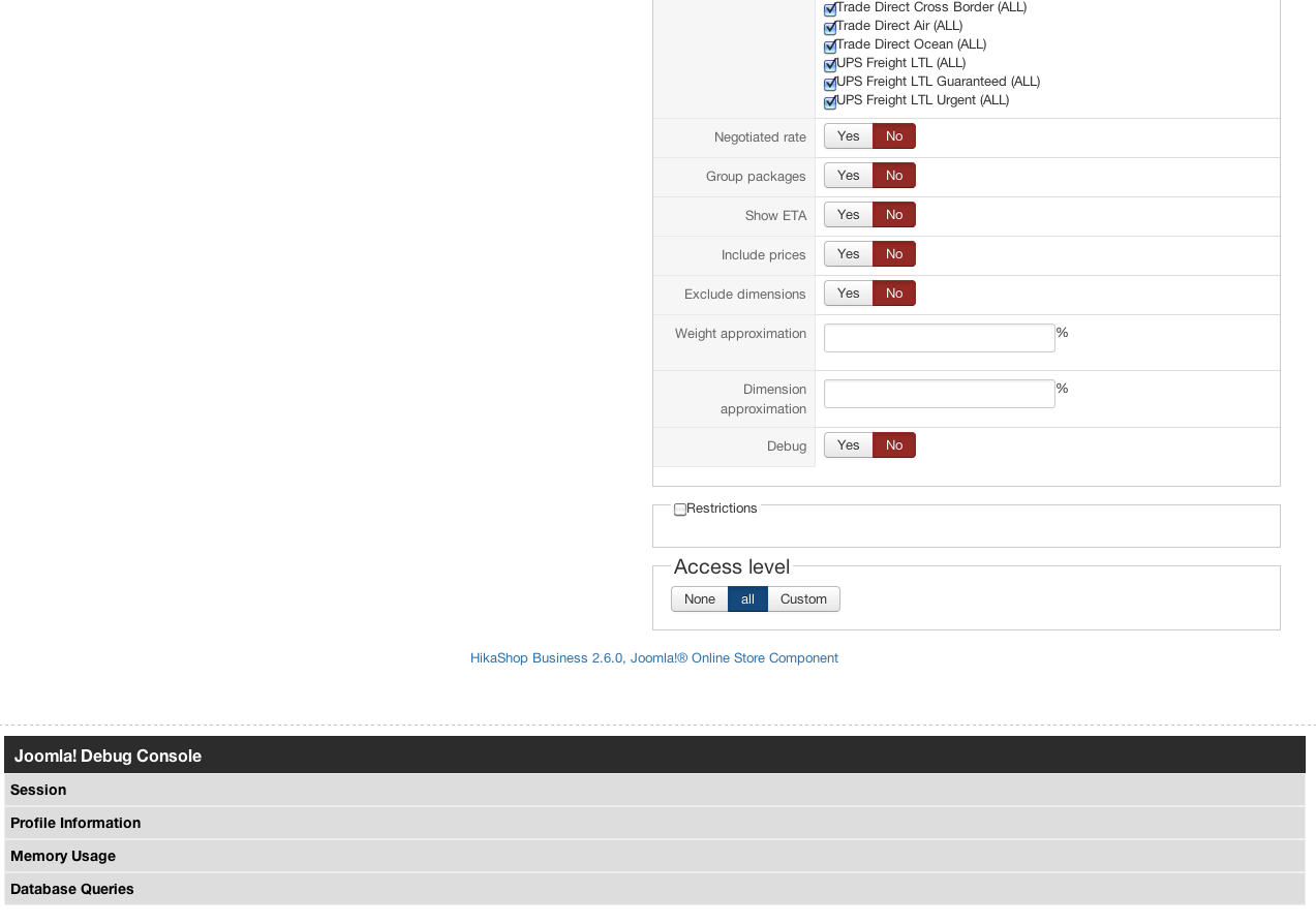

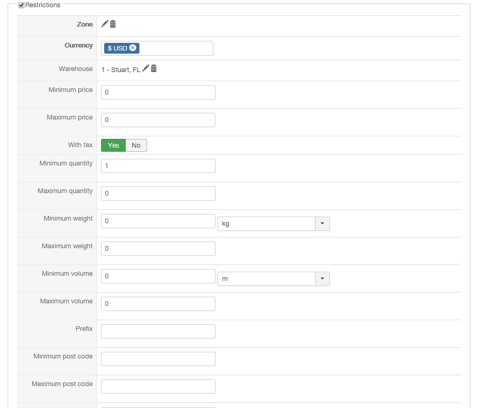

I am unable to get the UPS shipping method plugin to function. I have checked the manual, FAQs and Forum posts, but am still unable to isolate the problem/solution. I suspect it might relate to the warehouse setup in Product versus UPS settings.
The site is offline. I have attached 5 screen shots (removed certain account/product details). I can provide login credentials.

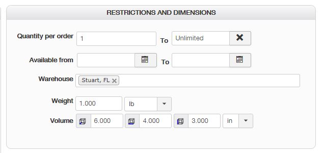

The warehouse is definitely a problem.
You selected a warehouse in the product, but in your shipping method (in the "restrictions" area) there is no warehouse selected.
From what I understand, you actually don't want to select any warehouse in your product.

10 years 10 months ago #218501
If you want to properly use warehouses, you'll have to add some products on that warehouse, so you'll have to test that situation :
- Set the warehouse in your product configuration page, set the same warehouse limitation in your shipping configuration page.

Hi Mohamed,
Thanks for your instructions. I thought I had performed those combination of settings before and still experienced the problem. Nevertheless, I set the warehouse for the product and then set the warehouse under restrictions section for shipping plugin. I also set the city name, country and postal code for the Warehouse section in shipping plugin and I now have a functioning UPS shipping method.
One thing I changed in the product restrictions settings was to input "1 to Unlimited" in the Quantity per order field. That had previously been set to "0 to Unlimited."

8 years 9 months ago #284129
In the UPS settings screenshot, you don't have anything in the UPS access key, the ups user id, the password and the shipper number fields. All these fields are required so make sure you fill them.
Also, the UPS shipping methods can only be calculated by UPS after the customer has entered his address, and that address must be a real address. So please make sure that this is the case when you're testing.

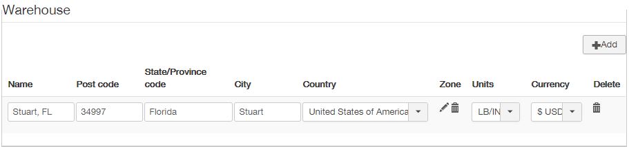

  • Posts: 6
8 years 9 months ago #284347
Hey,
thank you for the reply. I actually had all the UPS information entered, also our real address.
I found the issue. Under the warehouse in the UPS configuration, I had 'Florida' under state, instead of 'FL'.
After I changed that everything worked fine... Just took me a while to find that.
