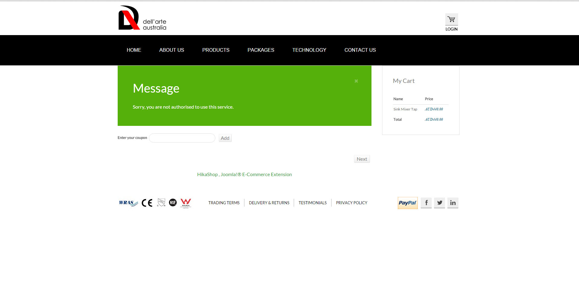

-- url of the page with the problem -- : clients.kreatives.com.au/cs/
-- Joomla version -- : 3.0
-- Error-message(debug-mod must be tuned on) -- : "Sorry, you are not authorised to use this service."

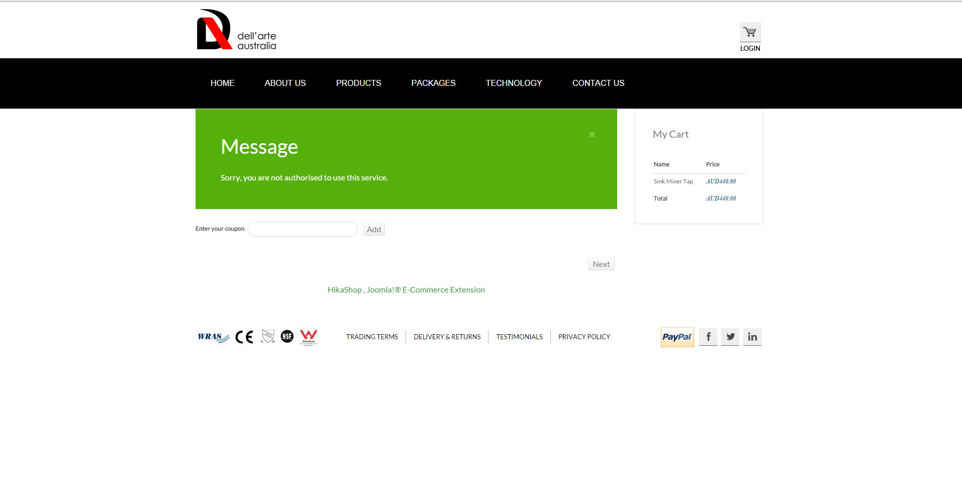

Hello
with the AU post (V2) shipping module I am getting message, even after using API.

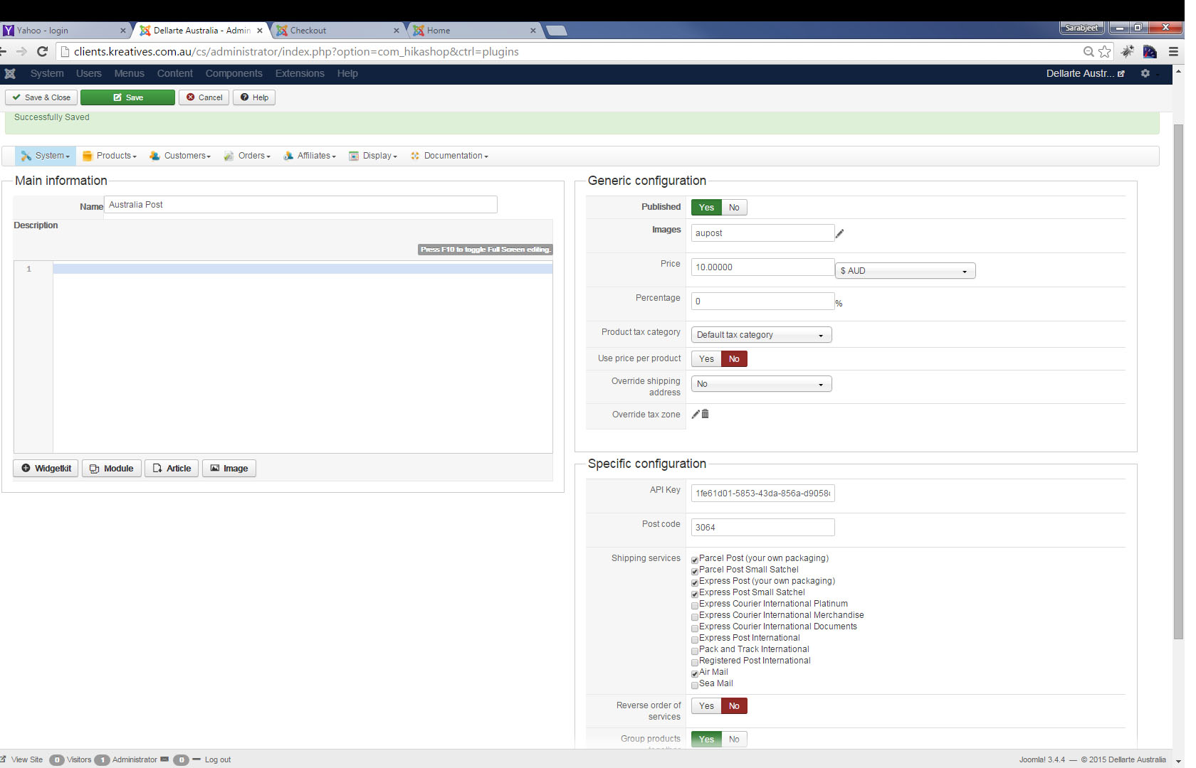

10 years 10 months ago #218497

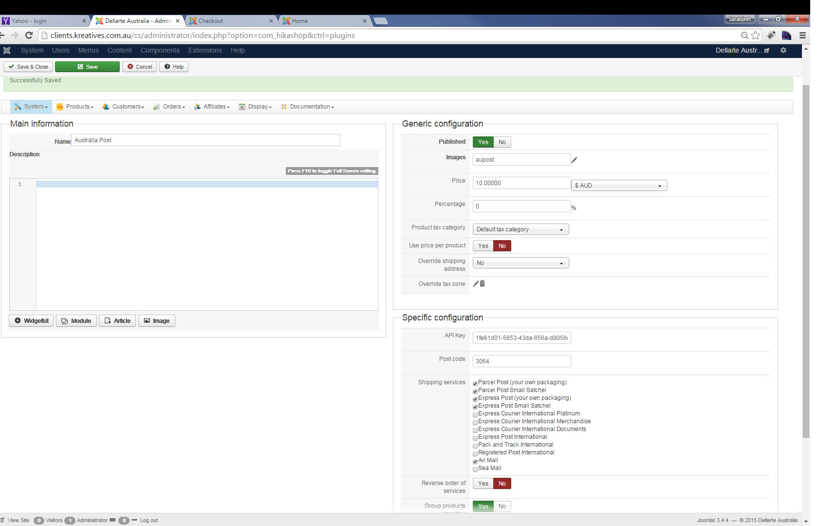

Can you show me through some screenshots how did you configured your Australia Post shipping method ?
Thanks.

10 years 10 months ago #218578
I just tested it on my end and it worked fine, your issue is probably coming from your Australia Post account, the best solution will be to directly ask them about that issue to be sure that your account is ok.

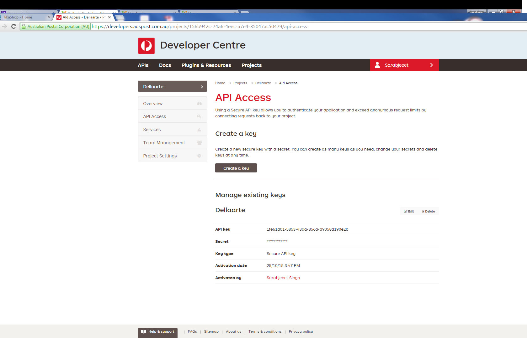

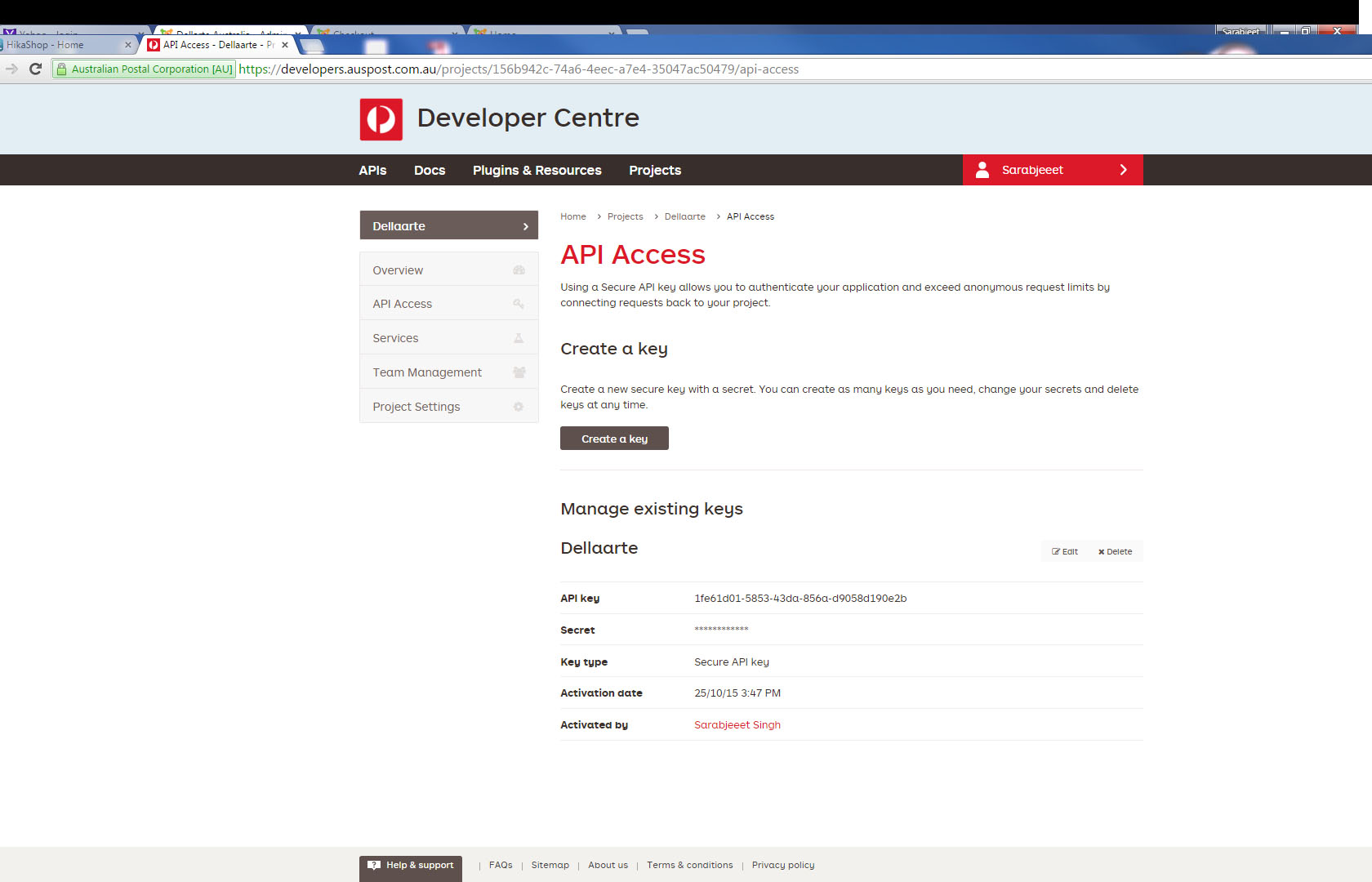

Use the following link to generate API
developers.auspost.com.au/apis/pacpcs-registration
The following user(s) said Thank You: avonrivercs
  • Posts: 59
10 years 10 months ago #219218
Thank you that worked, just a caution, I couldn't get the site to respond when using IE, but when I used Firefox, everything worked perfectly.

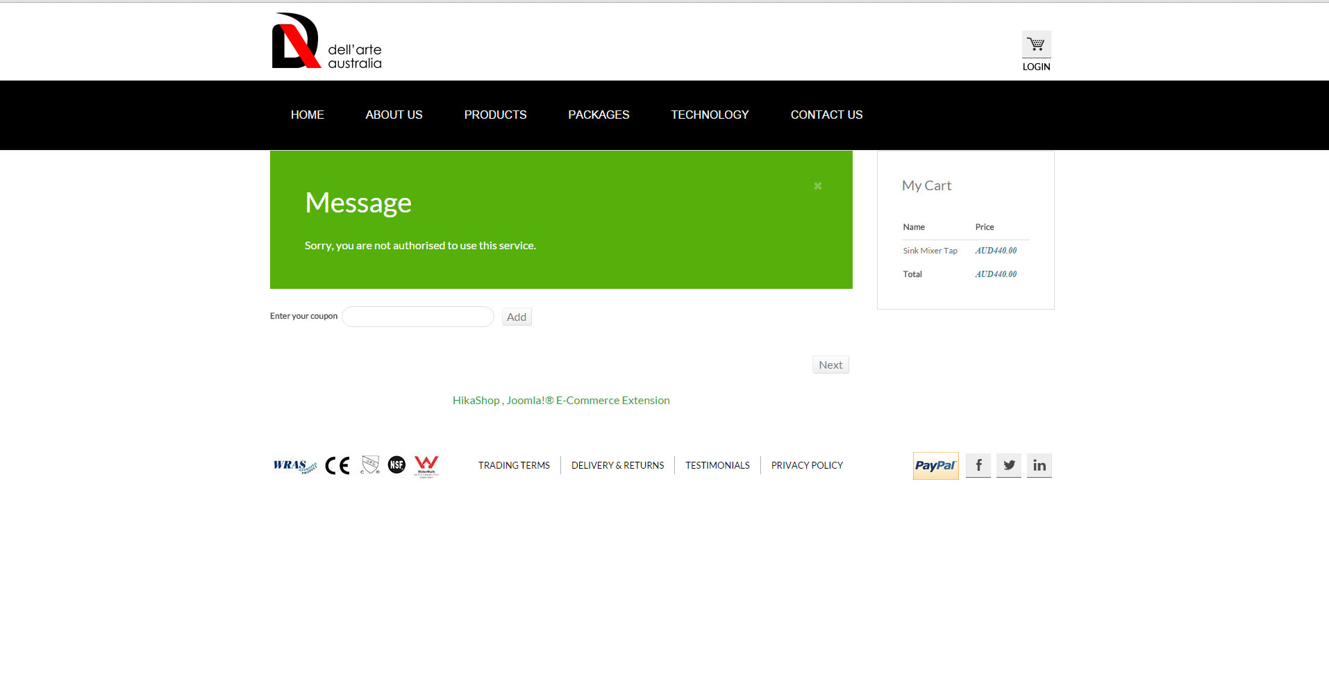

Also might be worth checking something Mohamed discovered that was causing this message to occur on my site. I am only selling within Australia so I had unpublished the "address_country" custom field via "Hikashop->Display->Custom fields" .
This meant Australia Post didn't have any country to work with, so I was getting the "not authorised" message. Once that was enabled the error message went away.
Note though, the postage values it gave me were still wrong (that's apparently the grouping problem that Mohamed is still looking into). I'll be sticking with Version 1 for a while yet.

10 years 10 months ago #220198
Thanks Mohamed, The link above worked. You need to supply an API number in the plugin to use it. Be aware that IE did not work properly on the AU post site, I had to use Firefox to generate the API.
