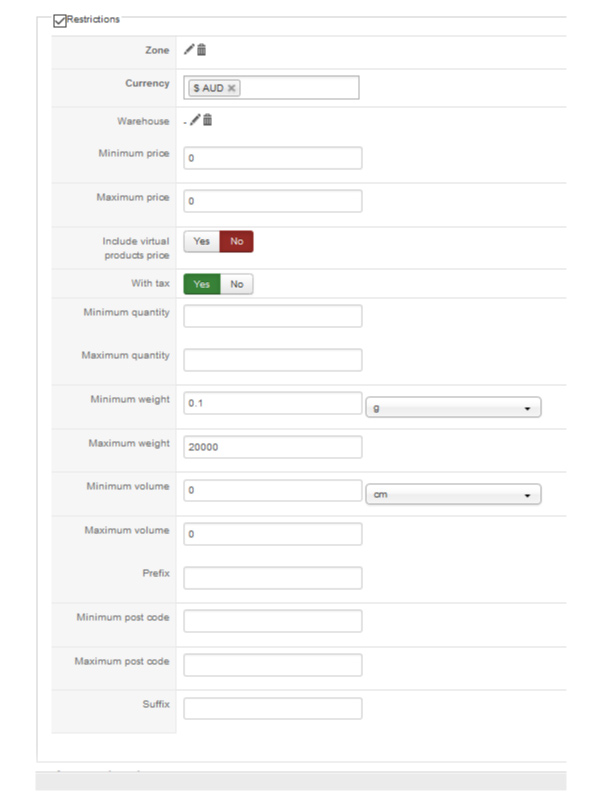

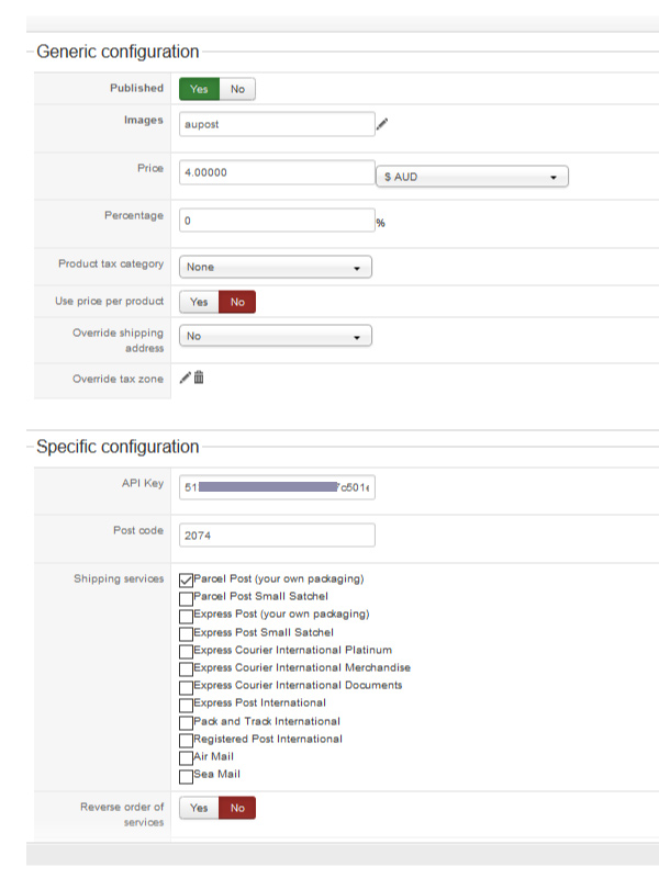

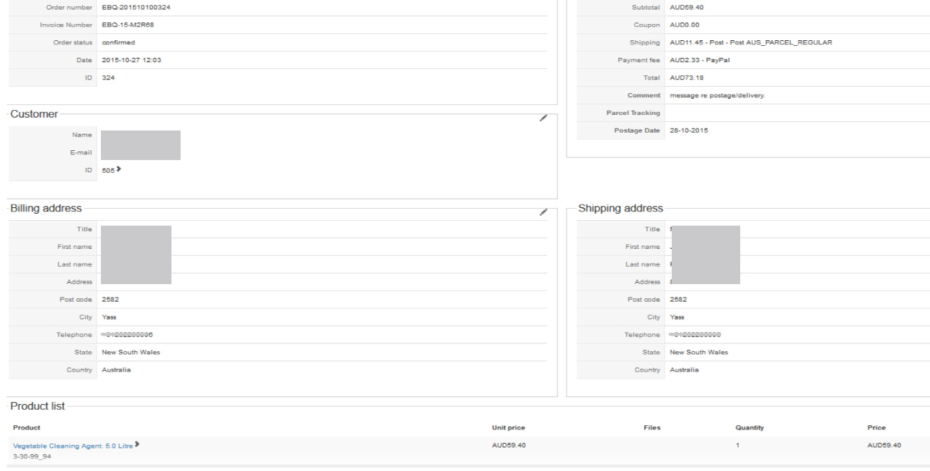

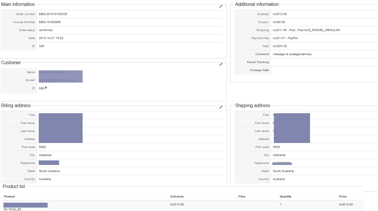

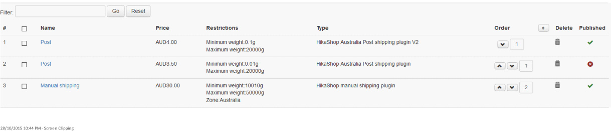

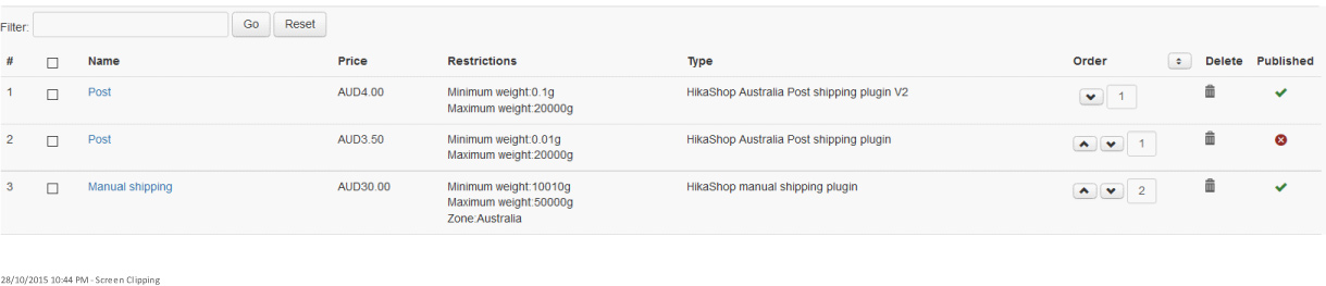

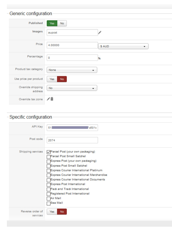

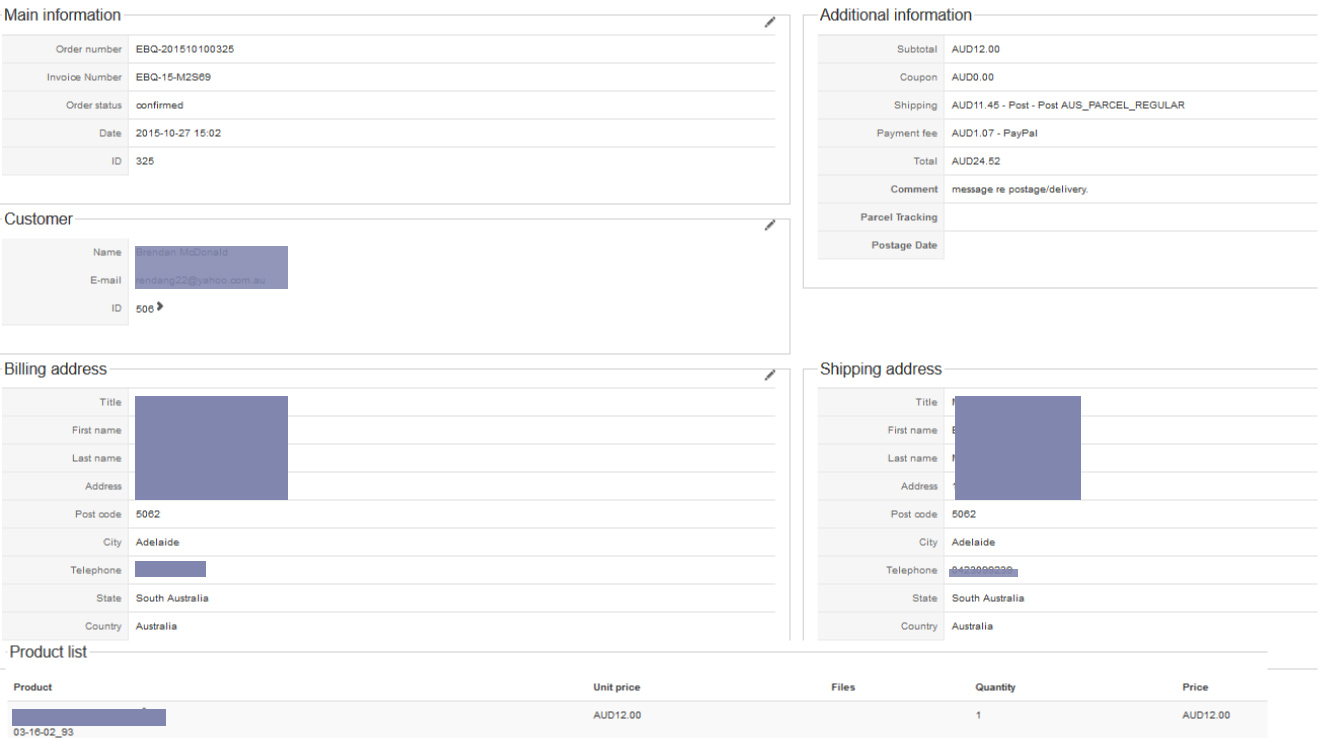

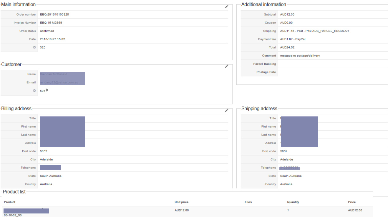

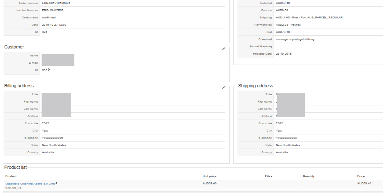

see attached screen shots of the backend setup and the orders affected; I have 'hidden' customer details
  • Posts: 47
10 years 10 months ago #218706
from screenshot AUP4 and AUP5 there should be a significant difference, as the one parcel is 1kg and the other 5kg; additionally the destinations are in different states the 1 kg parcel should be $19.60 (15.6+4) and the 5 kg parcel should be 20.35 (16.35+4)
Last edit: 10 years 10 months ago by khotso.
