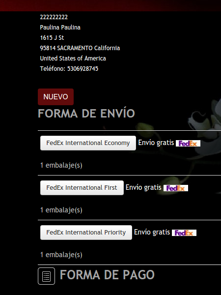

But when i send from Chilean address the prices are not showing at the Checkout, only number of packages,
maybe because Chile doesn't have any STATE with 2 digits code like California (CA) or other states ?
