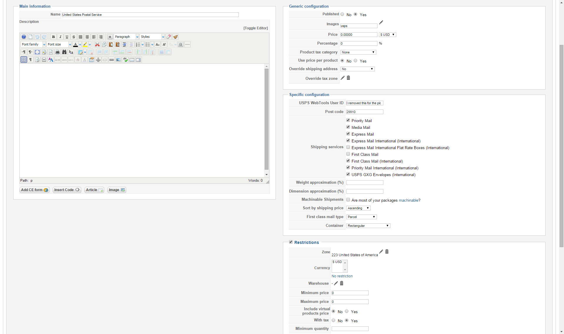

10 years 9 months ago #223224
Yes, the international shipping services are already selected, but it still does not charge for the services. Here is a snapshot.

  • Posts: 86187
10 years 9 months ago #223226
In the "restrictions" area, you've selected the USA in the "zone" setting, indicating that you want that shipping method to only display for the USA. Remove that restriction and it will work for all the countries.
