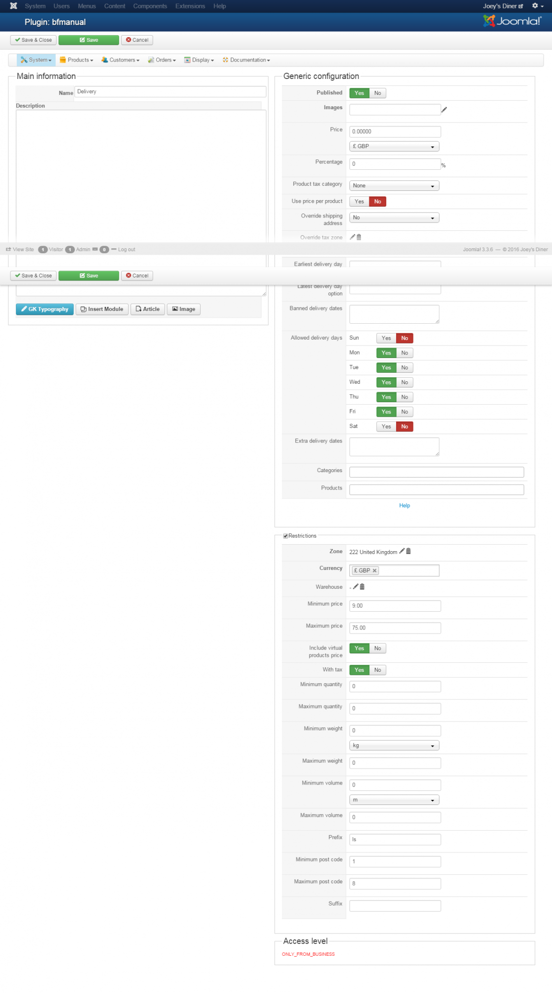

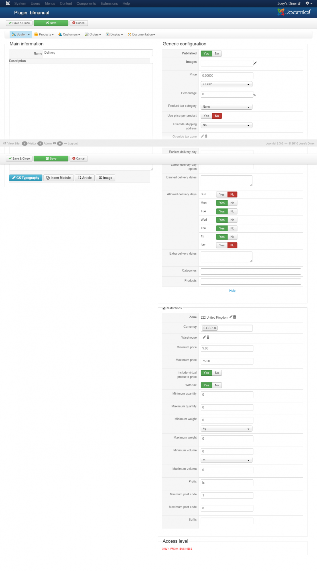

Hi, I have tried a lot of different things - I have installed brainforge manual shipping method but still the the option of delivery is not working.
Collection works!
Delivery doesn't!

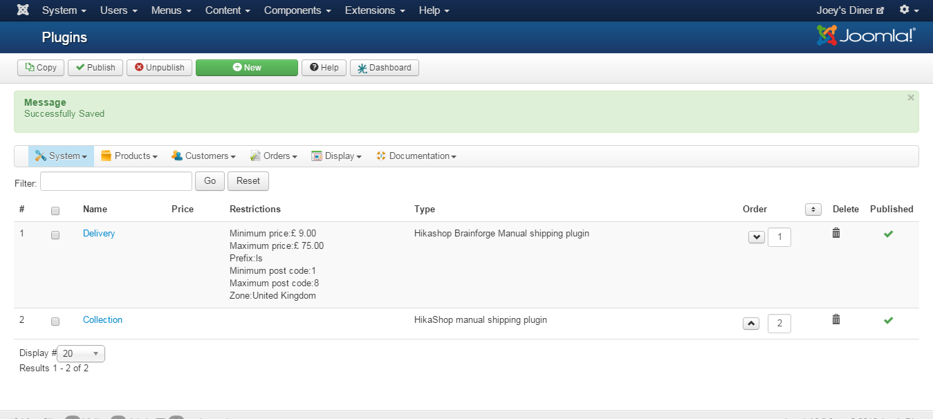

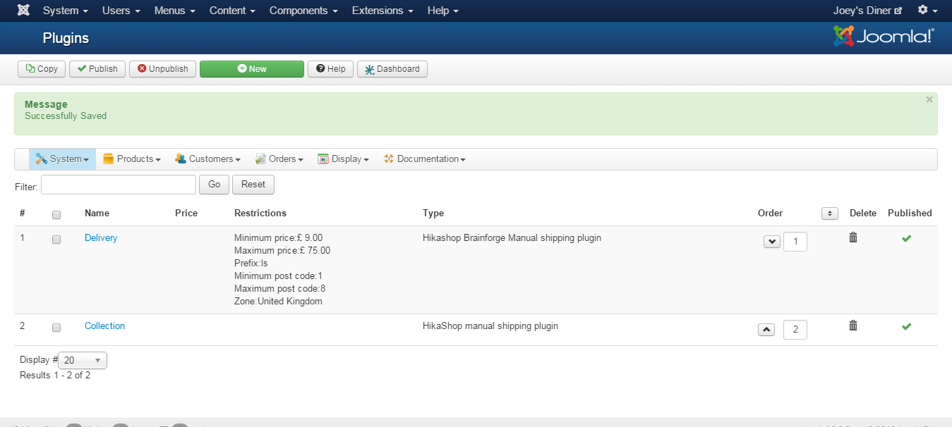

Delivery Restrictions: over £9.00 and under £75.00
Postcode Prefix ls
minimum 1
maximum 8
I am using a registered account with postcode ls11bx
I have attached the screenshot of the setups.
I have address_post_code enabled in custom views.
I just want the delivery option available for customers in the areas ls1 - ls8 ? Any help greatly appreciated!

That should actually work fine, can you show me which shipping address you are using ? Also checking each points of the "Shipping methods" section of the FAQ will probably do the job : www.hikashop.com/support/faq.html#ship

You have set the "Maximum Post code" option to 8 so with a number 11 after your post code suffix, you won't be able to use your shipping method.

Thank you - it is because the uk postcode is eg LS8 2PH so it reading both numbers as one - 82 - I put the max to 89 and it works fine now. Once again ta!!
