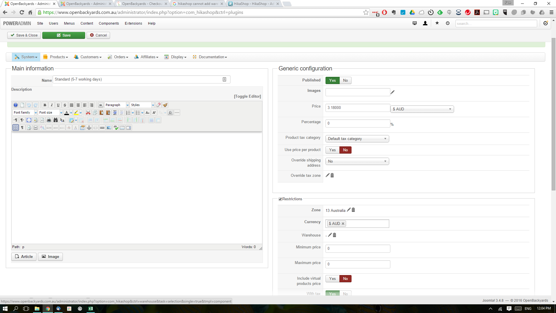

I am currently setting up our shop and I am unable to set the warehouse in the manual shipping method I have created. We need to set this to control the shipping price - at least that's what I think I need to do.
The set warehouse option is available but when I click the pencil icon next to Warehouse, nothing happens. It was working a few weeks ago but since updating, is not working. See attached screenshot for further info.
Forgive me if I am not explaining myself very well, I am a newbie!
10 years 6 months ago #232723
The solution will be to change the value of the "Popup mode" option via "Hikashop->System->Configuration->Display", and to try it again.
  • Posts: 3
10 years 6 months ago #233747
Thanks - that worked. Not sure why I couldn't figure that one out myself!
