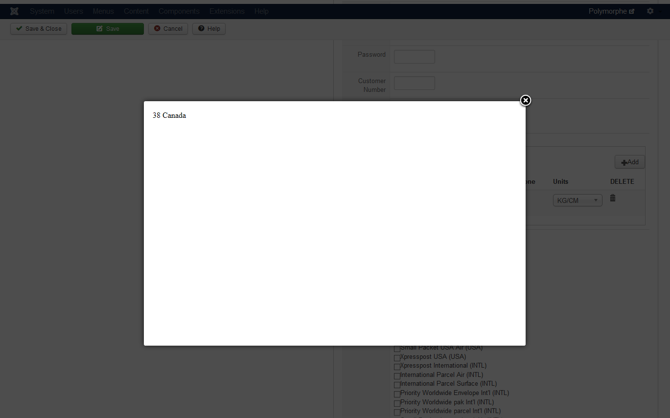

Yea, so now I'm having a problem with the Shipping method plugins.

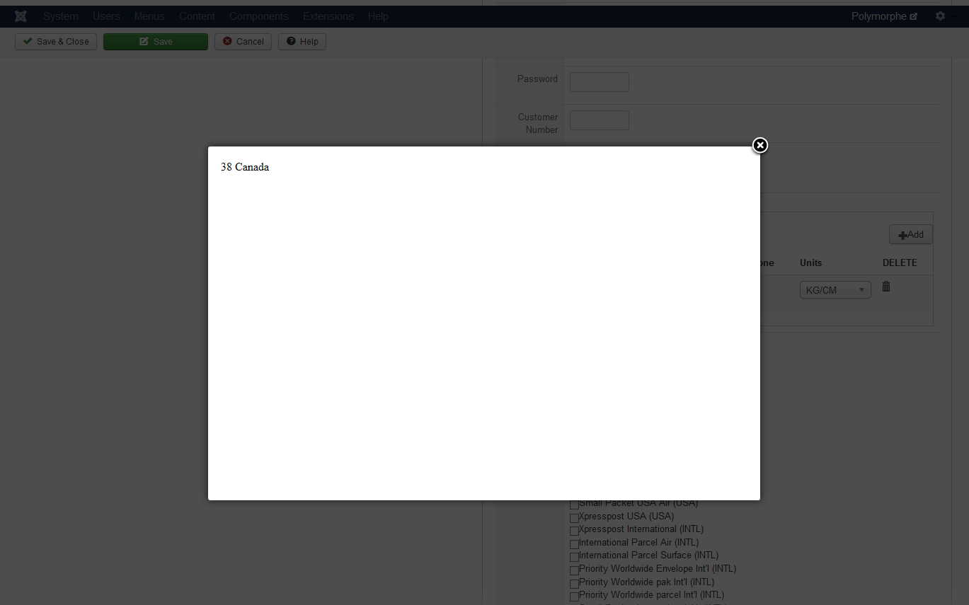

Basically when trying to choose a Warehouse zone, I click the pencil icon, choose the country or state, click the OK button and instead of putting the country I chose in the Warehouse zone params , the popup just stays open and displays the ID and the countries name, and that it (see attachment) . The value doesn't get registered , even if I close the window (obviously).
Now I've checked the console and I'm not getting any errors either, so I can't help with any of that sort of info.
I have tried it in several browsers and even tried it on the first version I got with Joomla 3.4.4 with Hikashop 2.5.0 and I get the same problem.
any ideas on how to fix?
Thx.
10 years 3 months ago #241859
That's actually weird, can you try it with a different value on the "Popup mode" option that you can find via "Hikashop->System->Display" and test it again ?
If it's still not working, can you :
- Activate the Joomla debug mode ("Administration->Global configuration->System->Debug System/Language")
- Set the "error reporting" option of the Joomla configuration to "maximum"
- Test it again so that you can see if it display an error message which will help you to understand from what your issue is coming.

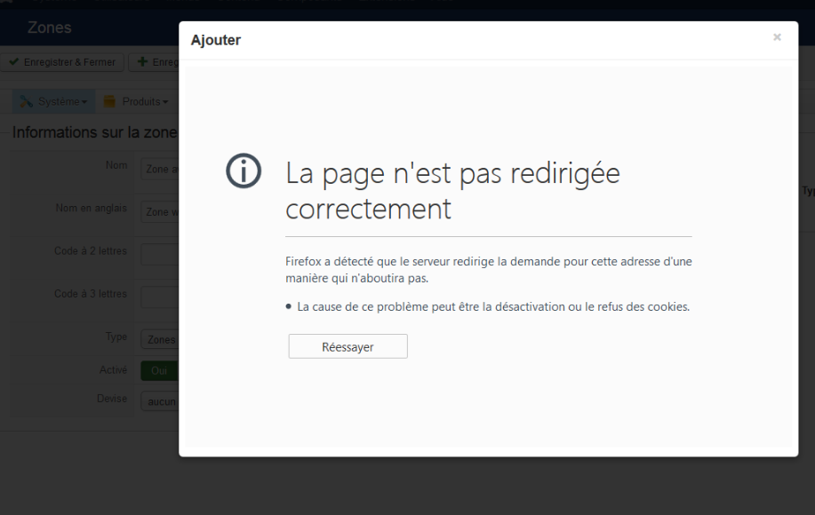

  • Posts: 54
10 years 3 months ago #241913
i have the same pb
When i try to ad a new contry in a new zone...
Why?

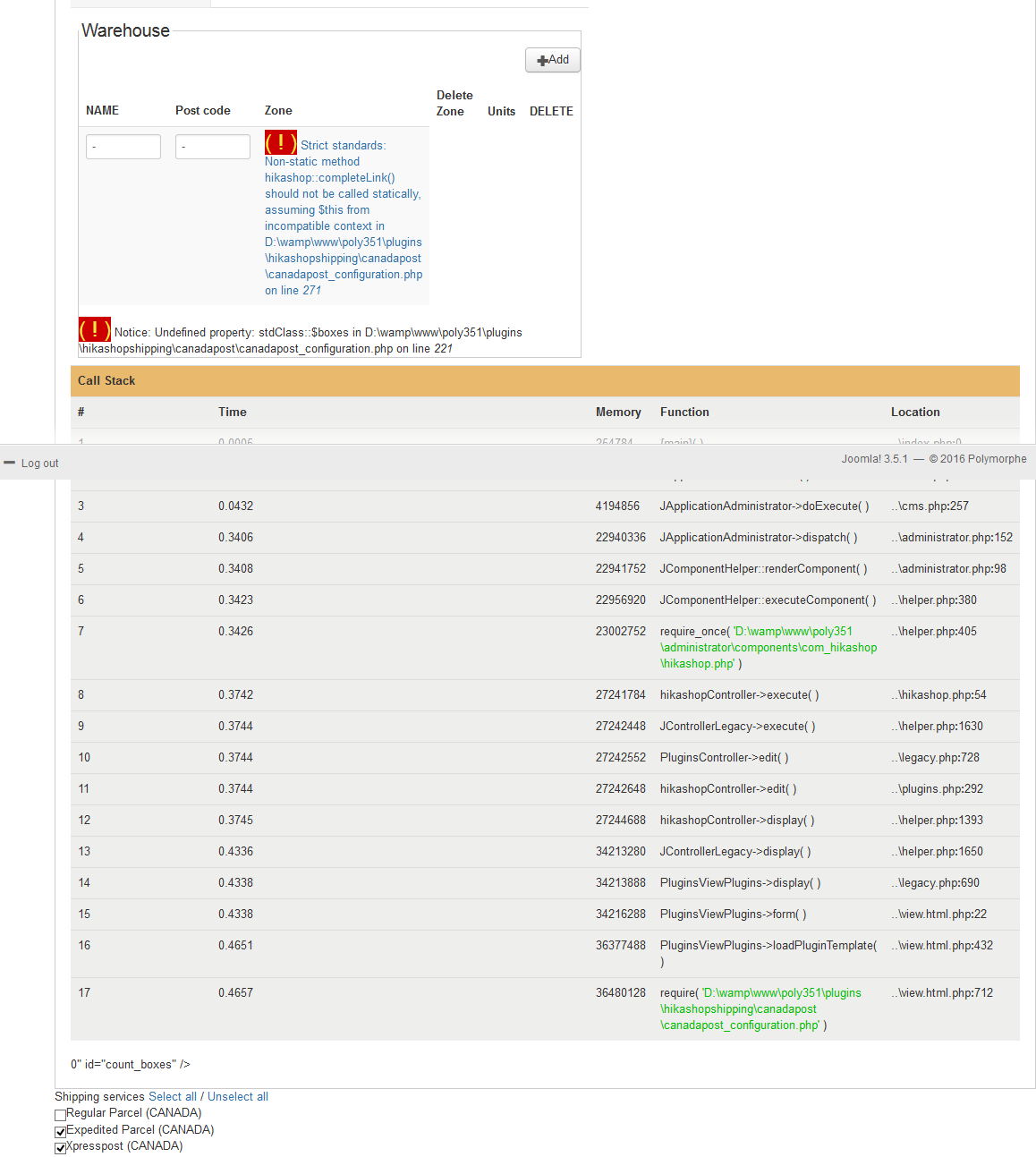

  • Posts: 56
10 years 3 months ago #241932
HI Mohammed;
Ok I tried what you suggested , but none of the popup worked - in fact it seemed like the modal never changed style either ( same gui : close button) but I'm not sure. All I am sure is that I get the same result no matter what I set it at.

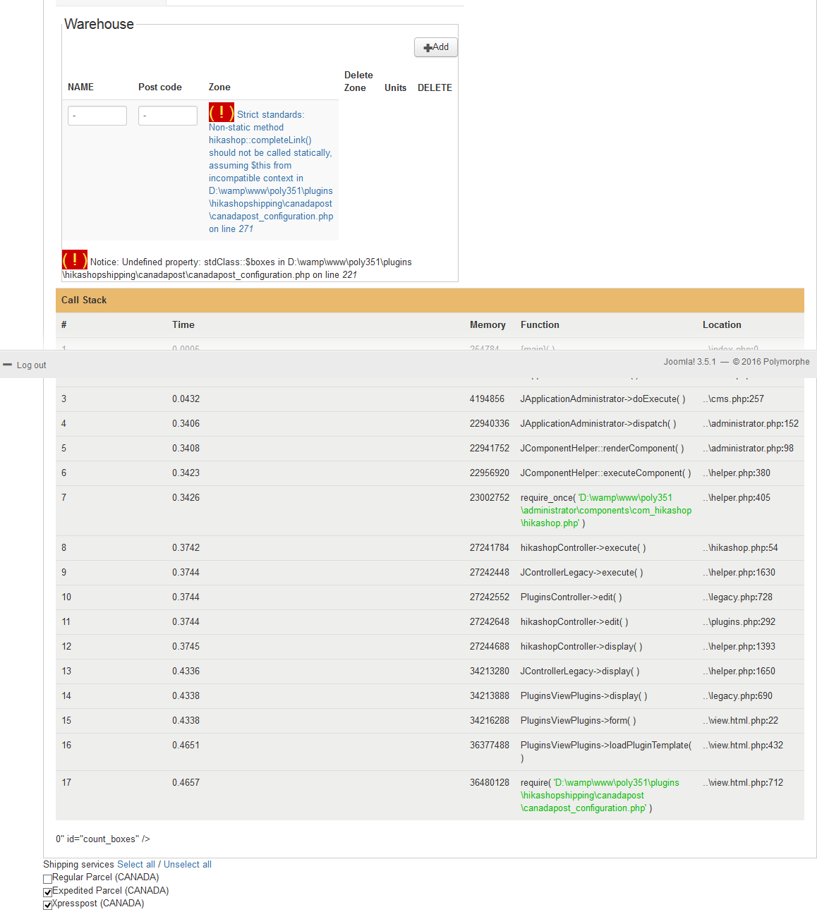

BUT, the error reporting has proven useful. (Please see attachment)
Now I already have contacted the dev for that plugin and upon testing, we realized it wasn't just a problem with this plugin, as I tested the UPS plugin's warehouse zone and I get the same result. ( Just to eliminate that possibility).
Anymore ideas sir ?
;O )

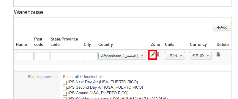

I've noticed in the code Squeezebox is hard coded into the onClick event of the EDIT anchor tag.

You see, the UPS plugin > Warehouse section > Zone edit,

  • Posts: 86183
10 years 3 months ago #242608
Look at the screenshot I gave in my previous message and you'll see that I was able to select the country of the warehouse for UPS:
monosnap.com/file/920VtcFvdYnVeLqRI7nmCNqGNVfbSM
But I understand what you mean. It only doesn't work if you use the checkbox and then click OK. If you click on the name of the zone, it works. I've made a patch so that it works on both cases.
