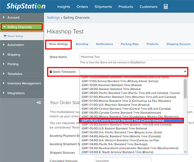

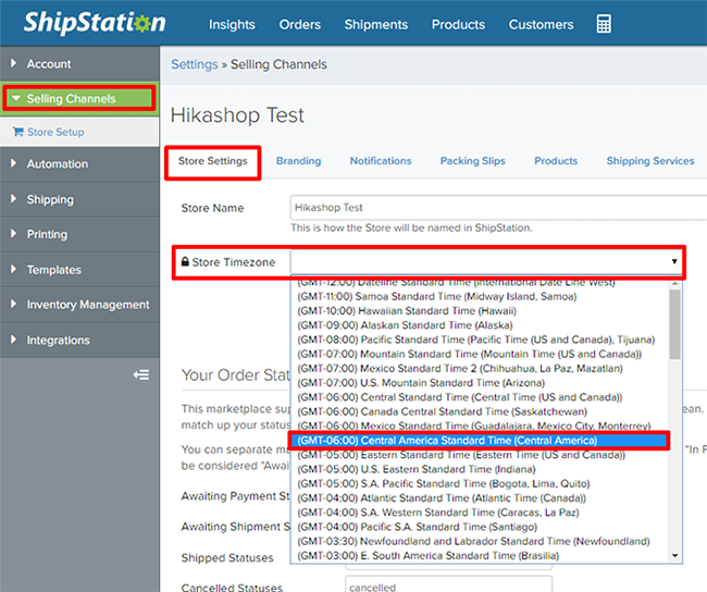

With my message, I asked you to provide us the log file (learn more about this here ), but for this you have to switch On the Debug mode of your Shipstation plugin (I switch it myself in your website, thanks to don't switch it Off until your issue isn't solved).
From what I can see from your website backend everything seems right to me, but if issue is always here...

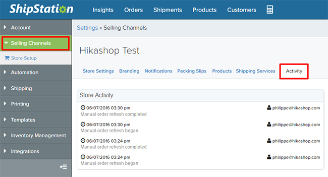

- Check if you have define your Store Timezone in your Shipstation backend account settings here :
- Check if you have some data about Shipstation processing in your Shipstation backend account here :
- Provide us the Log file, we expecte to have some data about your issue...
Awaiting news from you.
Last edit: 10 years 3 months ago by Philip.

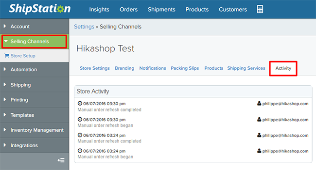

  • Posts: 62
10 years 3 months ago #242320
Thank you again for your support!
I have set the correct timezone.

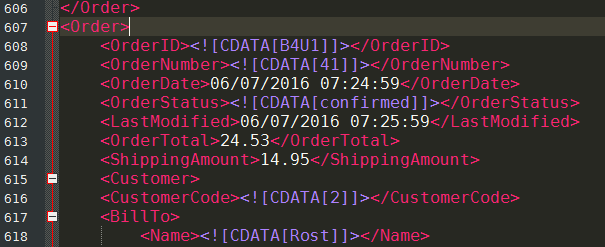

Here is the log file, along with a screen shot of the activity file from Shipstation. It looks to me that from the activity report it is still having an issue with the date set up, though I did change the 2 areas in he plugin as suggested.
10 years 3 months ago #242366
I had a look on your Shipstation settings page AND on your backend website, and everything seems right to me...
So, other possibilites may be from Shipstation setting page ( http://www.shipstation.com/ )
- Bad shop configuration ?
- Did you contact Shipstation support ?
- For a reason or another, your website can't communicate with Shipstation Servers ?...
Sorry for this uncomplete answer, hope you will find the roots issue.
If you get it, thanks to make a return on this topic for make everyone progress.
Regards.

Hi Philip,
This is what Shipstaion reported:
Here is the full error message showing on your Custom Store connection:
Error in XML. Reason: The 'OrderDate' element is invalid - The value 'Mar/07/2016 22:10:00' is invalid according to its datatype 'DateTime' - The Pattern constraint failed.
To resolve this error, you'll want to have whoever built the custom store integration to change the format of the OrderDate field to be "MM/dd/yyyy HH:mm". The details of how the OrderDate field should be formatted can be found within our Custom Store Development Guide here: help.shipstation.com/hc/en-us/articles/205928478
So it would seem that the plugin date needs to be changed, correct?

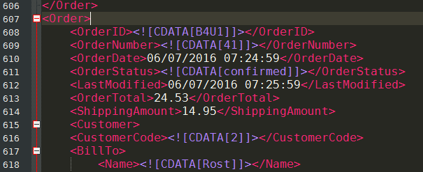

Plus, I don't really understand from where does these results come from... See this picture from your log :
As you can see by yourself the date format created by your Shipstation is correct.
This date format error that support tell us isn't from the same website OR Shipstation account, I don't know...

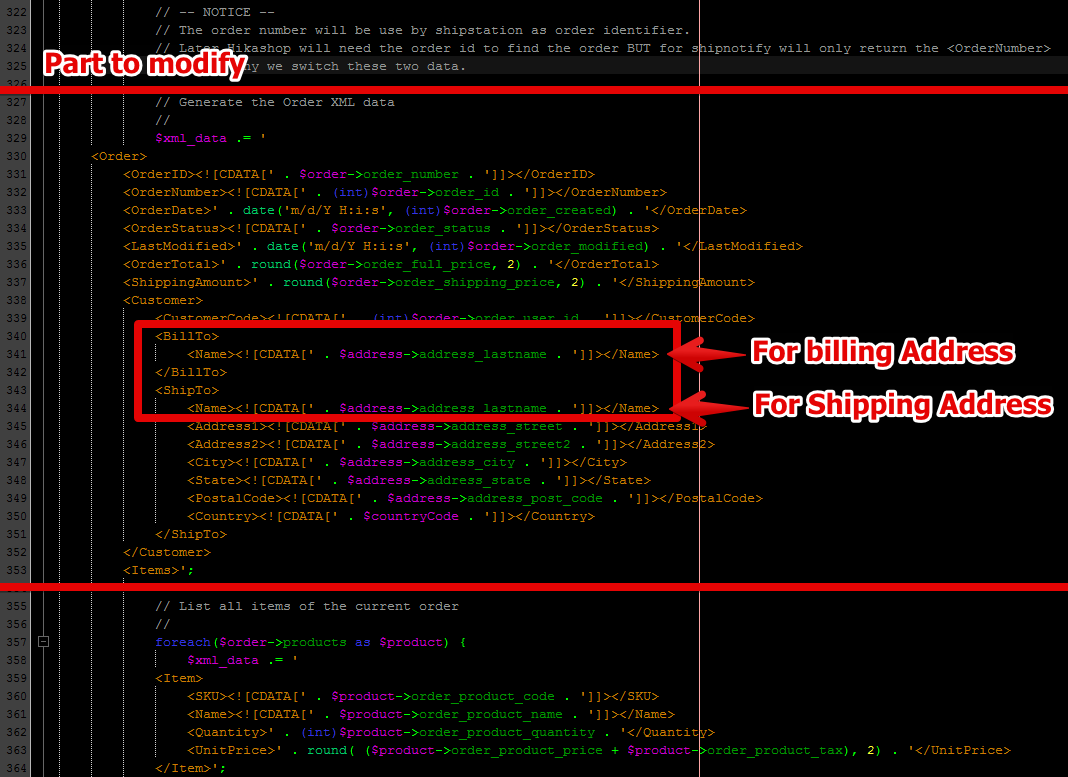

One thing that we are missing though is the first name of the customer. I looked in the shipstation plugin code and I don't see a field for first name, unless I over looked it somewhere.
10 years 3 months ago #242642
Happy yo learn that problem is now solved !
For the second point, I check the Shipstation documentation and there is no field for the first name...
But, you can try this 'around line 340, in your plugin shipstation.php :
<ShipTo>
	<Name><![CDATA[' . $address->address_firstname . ' ' . $address->address_lastname . ']]></Name>
	<Address1><![CDATA[' . $address->address_street . ']]></Address1>
	<Address2><![CDATA[' . $address->address_street2 . ']]></Address2>
But I don't know if that will works...

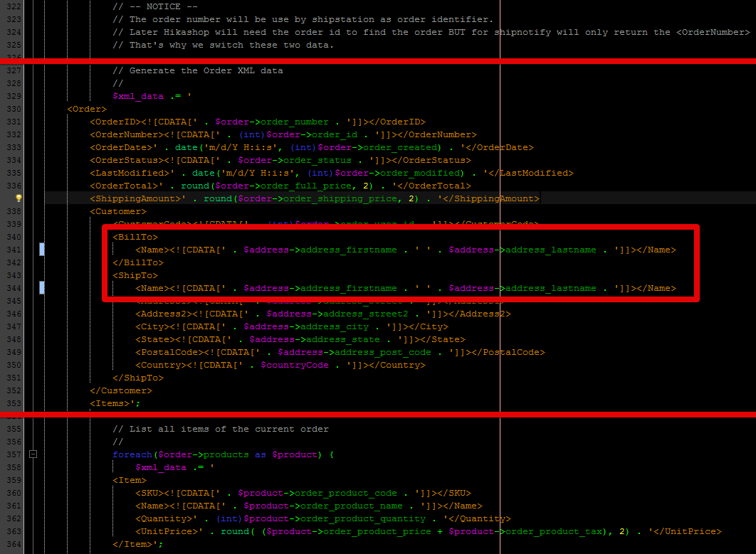

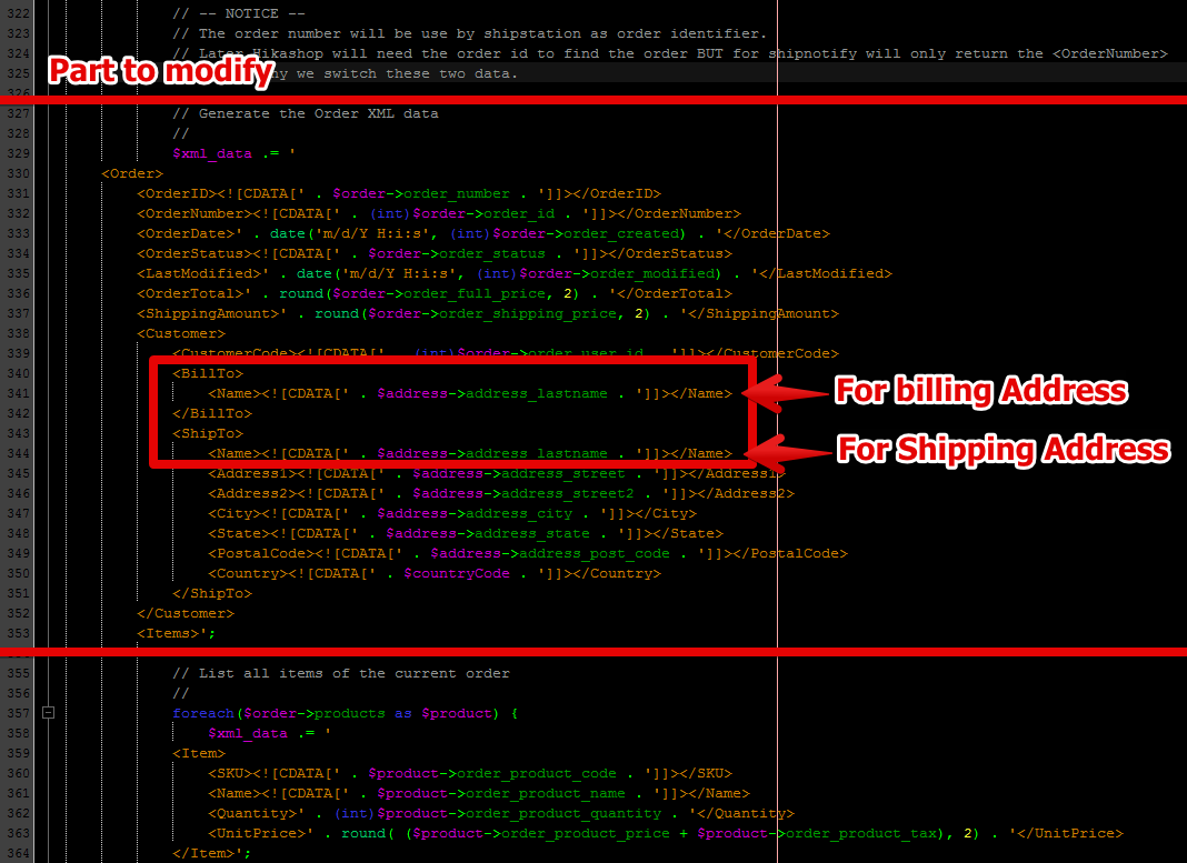

10 years 3 months ago #243362

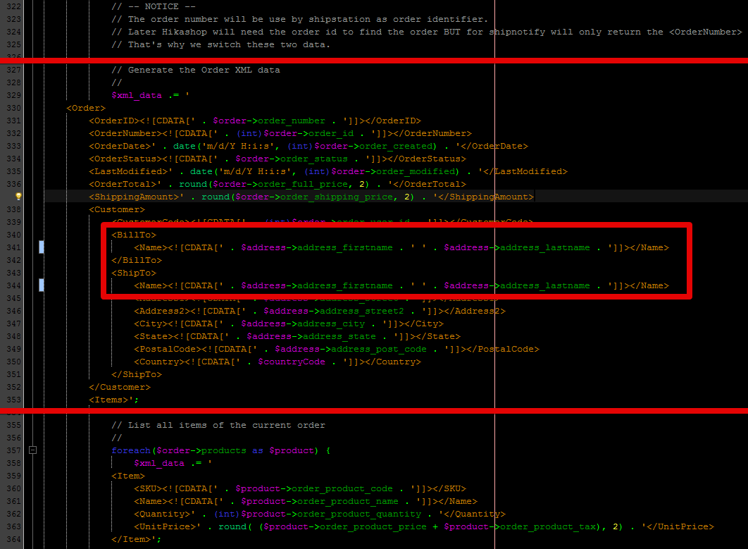

Is this where you want it (line 343), or do you mean exactly on line 340 in between the "preg_match"?
10 years 3 months ago #243494
No, the custom code must be modifiy in your generate XML process, more precisely here :
Starting around line 329 :
// Generate the Order XML data
			$xml_data .= '
	<Order>
		<OrderID><![CDATA[' . $order->order_number . ']]></OrderID>
		<OrderNumber><![CDATA[' . (int)$order->order_id . ']]></OrderNumber>
		<OrderDate>' . date('m/d/Y H:i:s', (int)$order->order_created) . '</OrderDate>
		<OrderStatus><![CDATA[' . $order->order_status . ']]></OrderStatus>
		<LastModified>' . date('m/d/Y H:i:s', (int)$order->order_modified) . '</LastModified>
		<OrderTotal>' . round($order->order_full_price, 2) . '</OrderTotal>
		<ShippingAmount>' . round($order->order_shipping_price, 2) . '</ShippingAmount>
		<Customer>
			<CustomerCode><![CDATA[' . (int)$order->order_user_id . ']]></CustomerCode>
			<BillTo>
				<Name><![CDATA[' . $address->address_lastname . ']]></Name>
			</BillTo>
			<ShipTo>
				<City><![CDATA[' . $address->address_city . ']]></City>
				<State><![CDATA[' . $address->address_state . ']]></State>
				<PostalCode><![CDATA[' . $address->address_post_code . ']]></PostalCode>
				<Country><![CDATA[' . $countryCode . ']]></Country>
			</ShipTo>
		</Customer>
		<Items>';
Replace the code by this :
			$xml_data .= '
	<Order>
		<Customer>
			<BillTo>
			</BillTo>
			<ShipTo>
			</ShipTo>
		</Customer>
		<Items>';
in order to have this :
Hope this will works.
