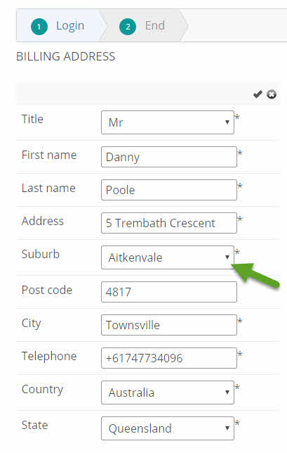

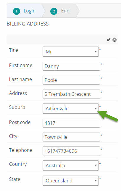

Hi, I am trying to setup suburb shipping zones, I have completed the following:
  1. Created Zones... Type: Shipping Zones (lets call the zones, zone a, zone b, etc)

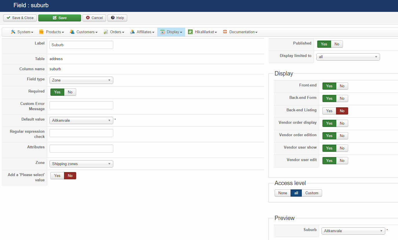

  2. Created a Custom Field... Table: address | Field Type: Zone | Zone: Shipping Zones | Display Front End: Yes (all zones are showing in the dropdown)
  3. Created Shipping method... Type: HikaShop manual shipping plugin | Restrictions - Zone: selected desired zone (e.g. zone a)
Now when I test it in the front end and select 'zone a' the shipping method i have set up for zone a does not show.
Am i missing something?
HikaShop: v.2.5.0
Joomla: v.3.4.3

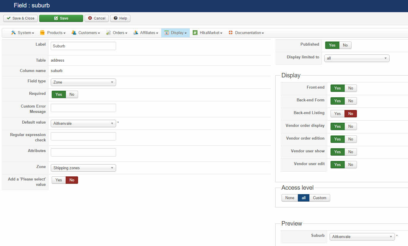

10 years 3 months ago #242623

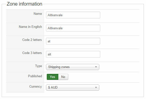

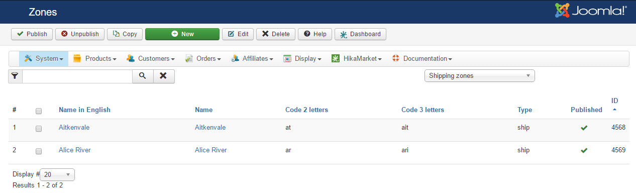

Hi Mohamed, Thank you for your reply, I have now gone through the checklist and still have no positive results. I have added screen shots so you can confirm I have set it up correctly.
HikaShop: v.2.5.0
Joomla: v.3.4.3
10 years 3 months ago #242662
Your issue is that you can't filter your shipping method regarding a zone using a custom field, but using the defaults address fields. Also, Can you show us how you configured your custom zone through some screenshots ?
Thank you.

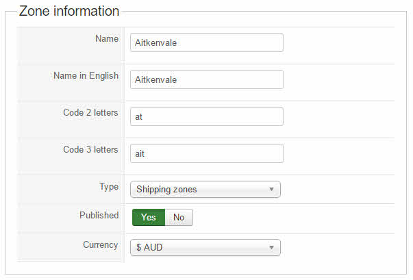

  • Posts: 64
10 years 3 months ago #242793
Sorry, I'm not understanding if you are telling me a solution, fact or stating my problem? If you are stating my problem then yes I am trying to filter a shipping method by using a custom field that is selecting shipping zones and it is not working.

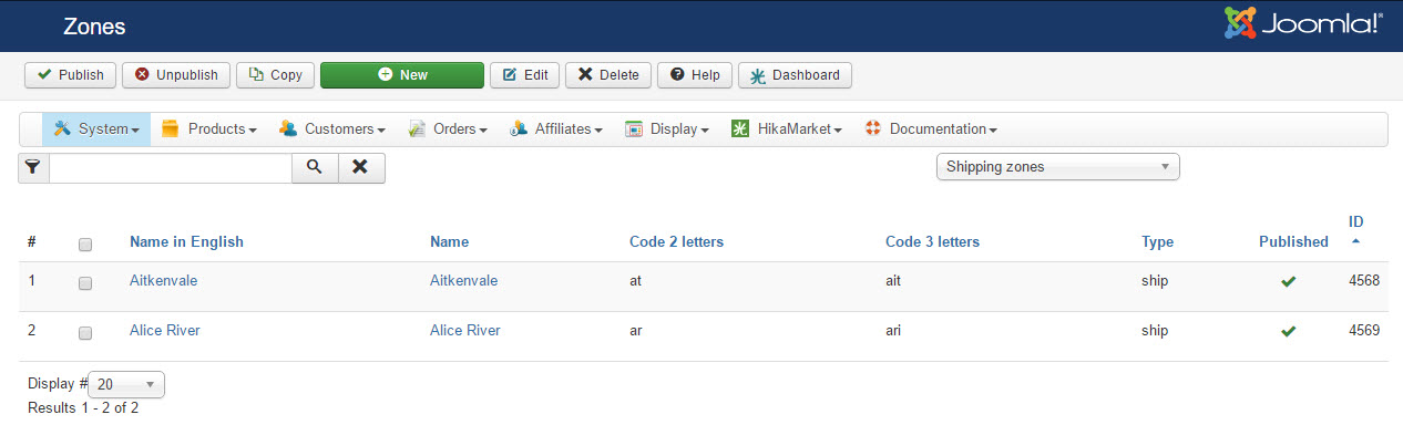

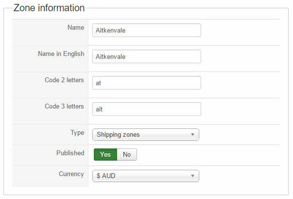

By Custom Zone do you mean the zone setting in System > Zones? The setup for this is shown in the image 02-zone.jpg.
If this is not correct then please specify the location of the screen shot you require (e.g. Display > custom fields > etc.)
HikaShop: v.2.5.0
Joomla: v.3.4.3
10 years 3 months ago #242807
I'm sorry If my response wasn't clear, I'm telling a fact, for the moment you can't restrict a shipping method :
- On a custom shipping zone which don't have any sub-zone
- By using a custom field which will only enable your customers to select their delivery suburb and display it through invoices.
In fact, for the moment you can only restrict your shipping methods by zones using countries and states zones (also by using post codes) that you can find via "Hikashop->System->Zones". If you want to create a custom shipping zone, you'll have to add some countries/states in it as "sub-zones".
To do what you want, the best solution will probably be to directly edit the code of the shipping plugin to support the "suburb" restriction which will require some development skills.
Last edit: 10 years 3 months ago by Mohamed Thelji.

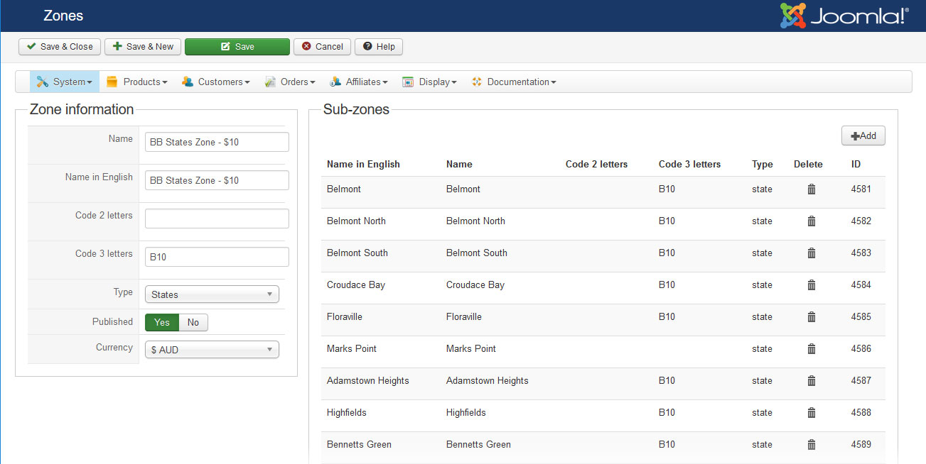

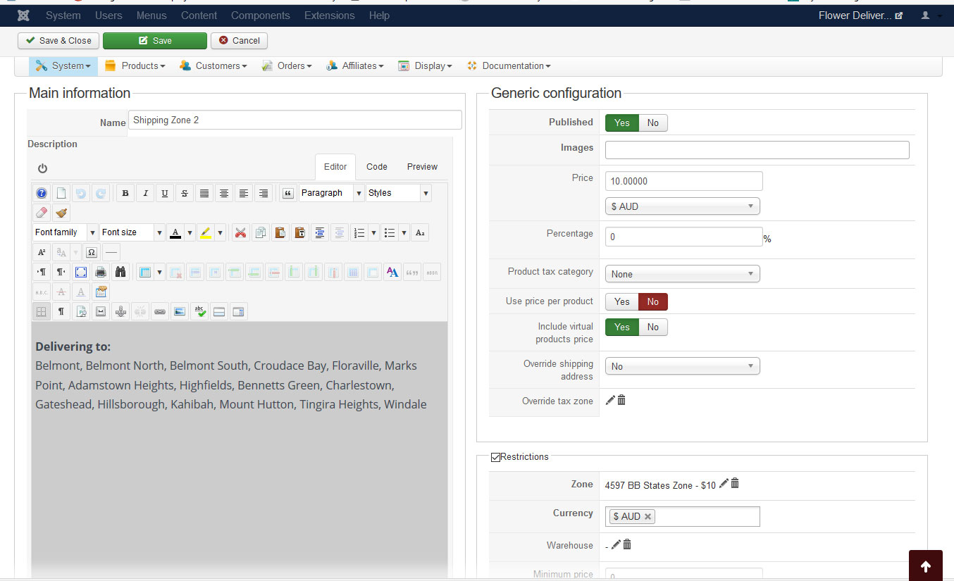

9 years 5 months ago #266852
Hello Lene,
We'll probably need to see through some screenshots how you configured your shipping methods but also your zones, to properly understand why you are having that issue.

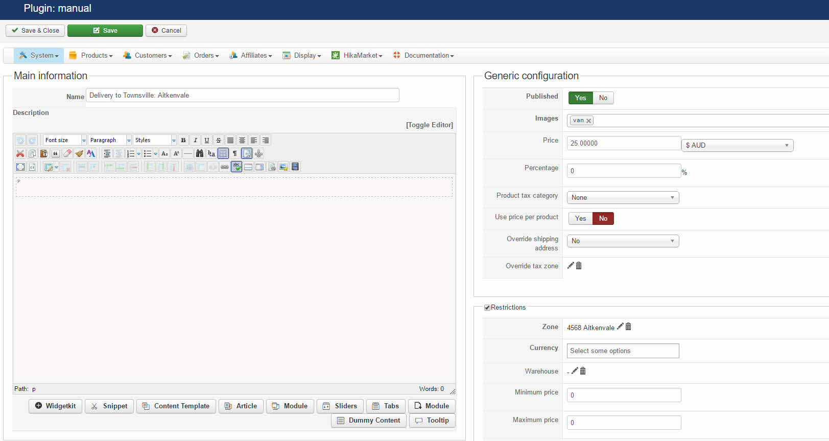

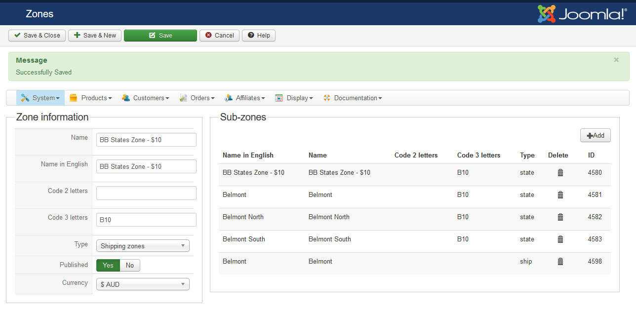

  • Posts: 191
  • Thank you received: 5

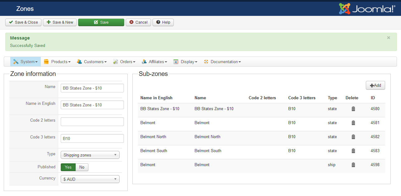

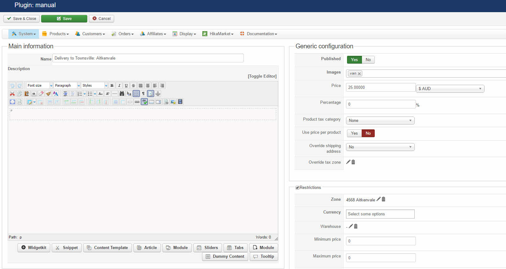

9 years 5 months ago #266890

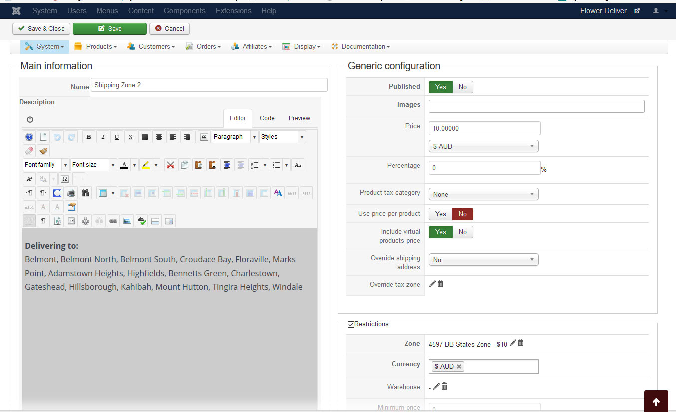

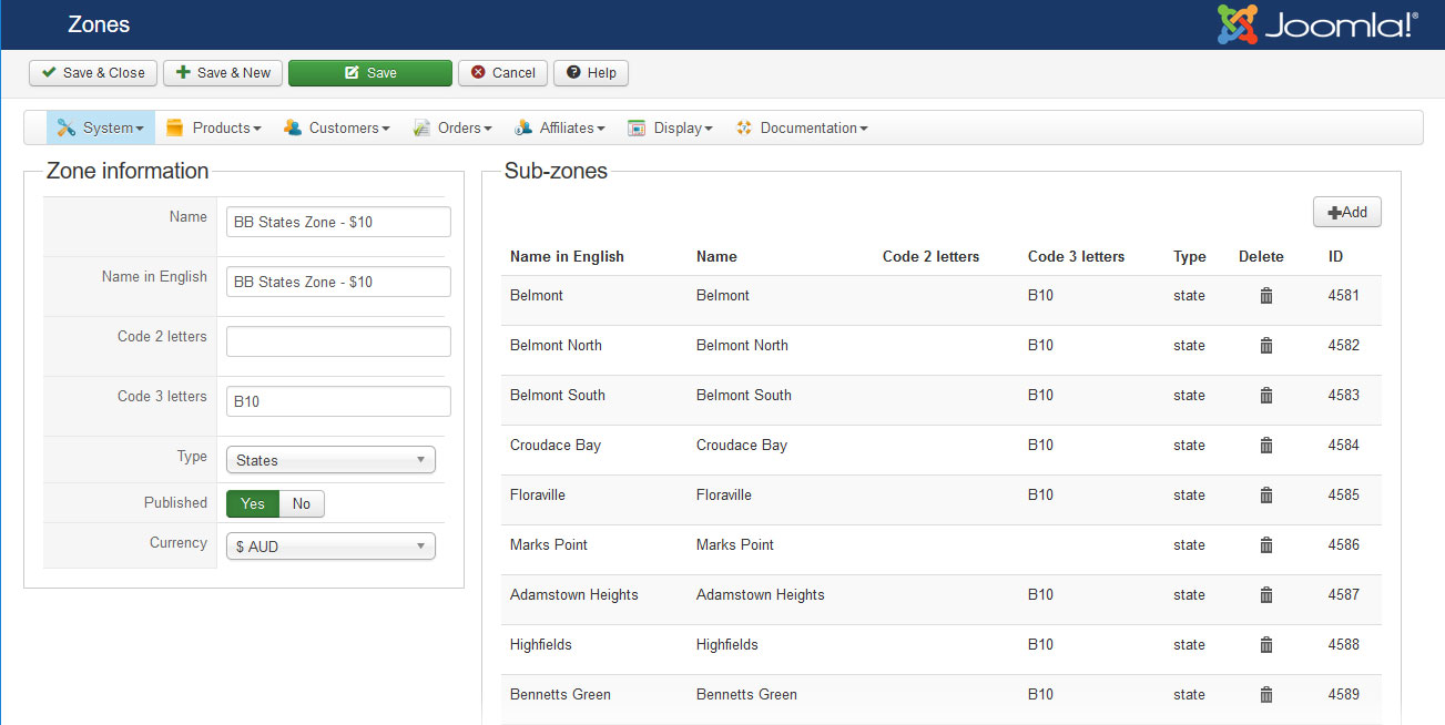

Hi Mohamed,
I have attached photos of the setup.
state-zones.jpg - shows the states added as sub-zones to state zone
shipping-zone.jpg - shows the shipping zone with the added state above as sub-zone. It also shows other options that I have tried to get it working
shipping-manual.jpg - shows the manual shipping that I have setup adding the shipping zone that I setup above
The site is only on my localhost at the moment.
Thank you
Lene
9 years 5 months ago #266917
Hello Lene,
As I said through my last message :
For the moment you can only restrict your shipping methods by using the "countries" and "states" fields, so to support the "Suburb" field, you'll have to directly edit the code of your shipping method.

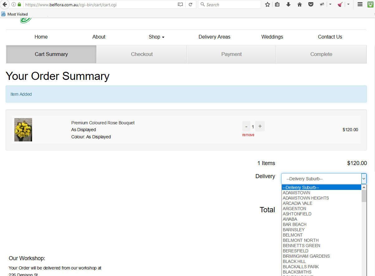

9 years 5 months ago #267100
Gould I have some guidance please. A shop is no good without shipping...

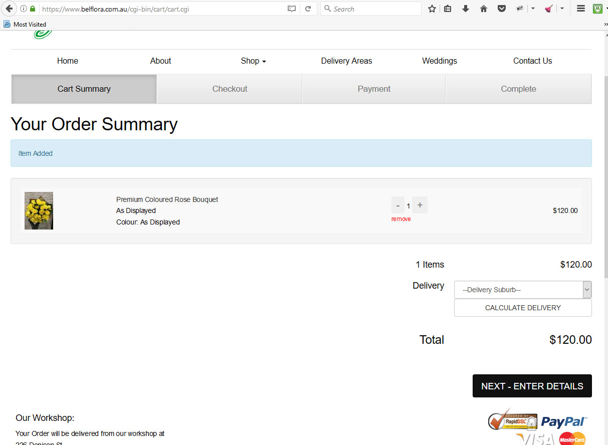

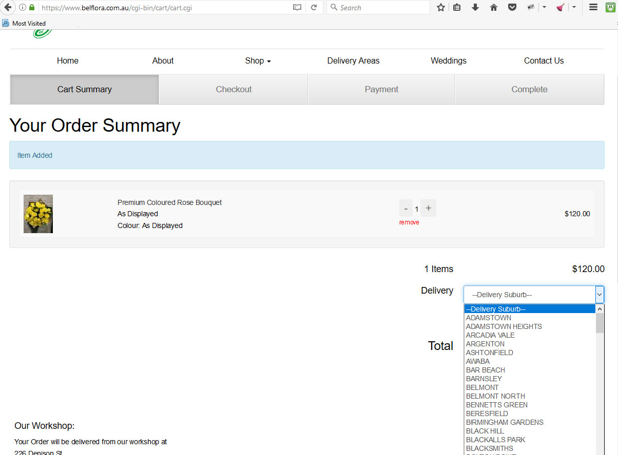

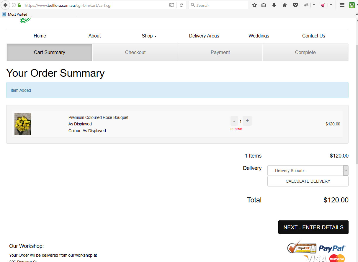

I have attached some images from another flower shop; www.belflora.com.au/ . You can select delivery suburb and calculate delivery.
Lene
Last edit: 9 years 5 months ago by lt635.
