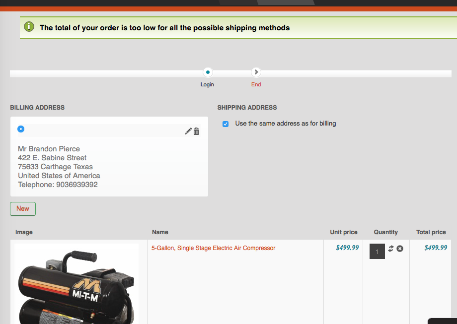

-- url of the page with the problem -- : www.mgcleanersllc.com
-- Joomla version -- : 2.5.8
-- Browser(s) name and version -- : Safari

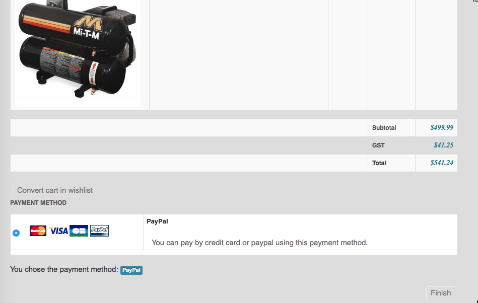

-- Error-message(debug-mod must be tuned on) -- : The total of your order is too low for all the possible shipping methods

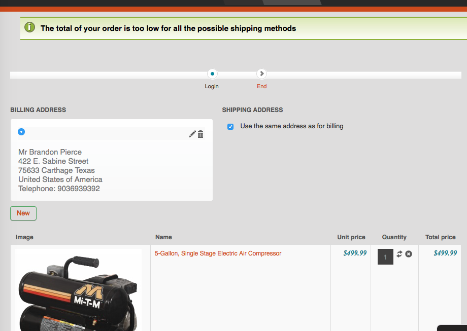

I am having trouble getting the option for UPS shipping to show up. I am getting the error: "The total of your order is too low for all the possible shipping methods"

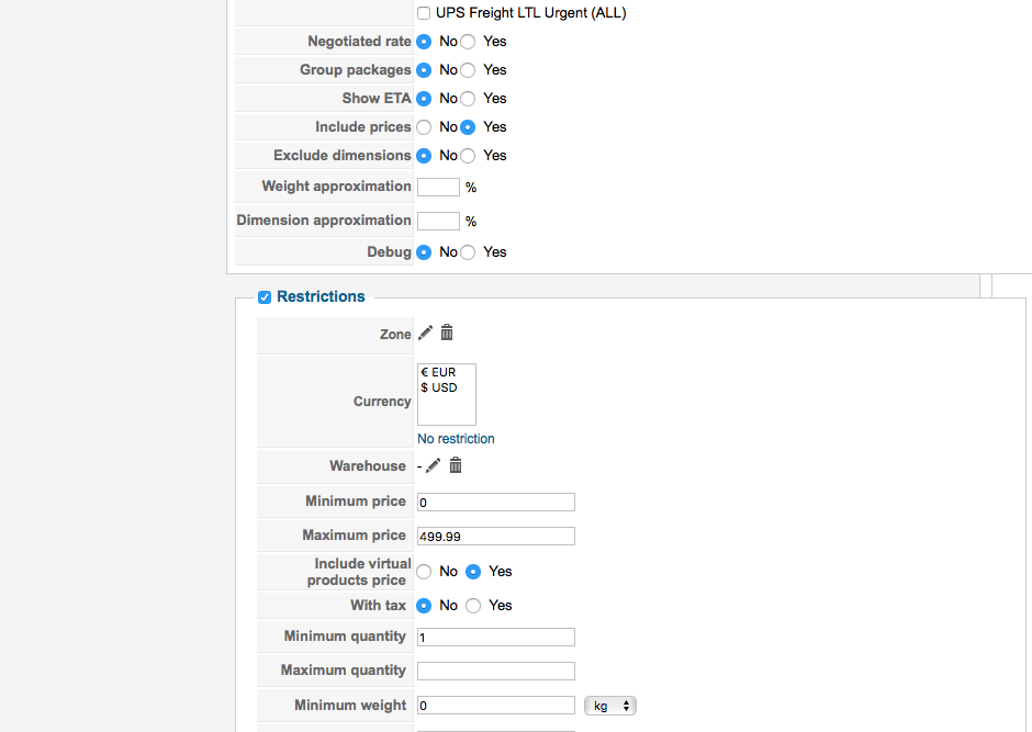

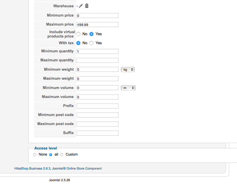

I have gone through the FAQ and it seems that everything is in place. I have tried different ways to adjust the restrictions and even removed all restrictions.

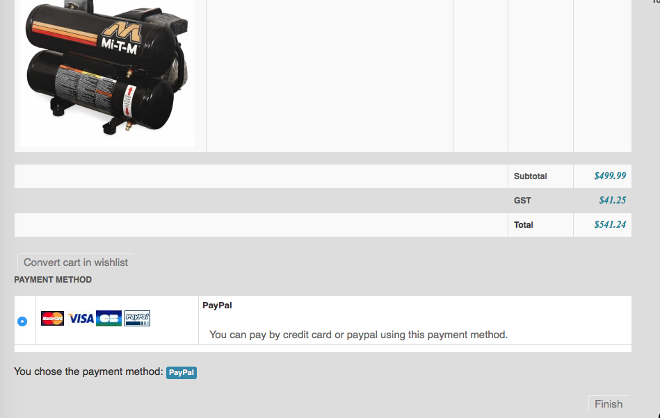

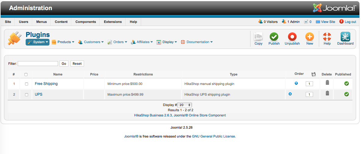

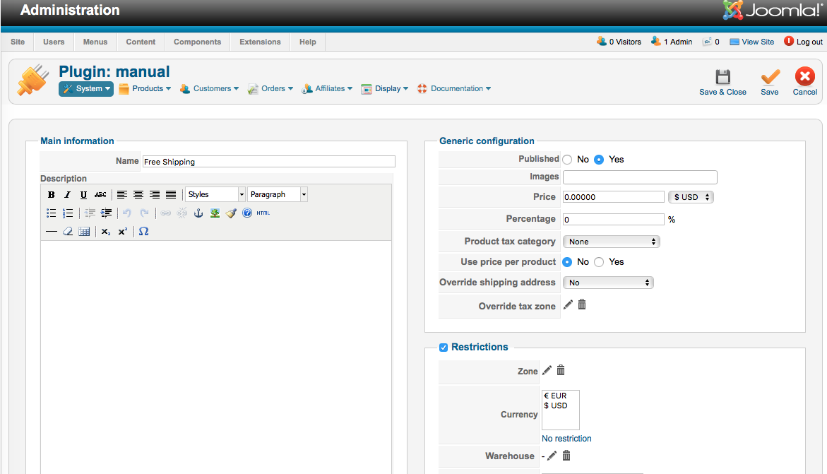

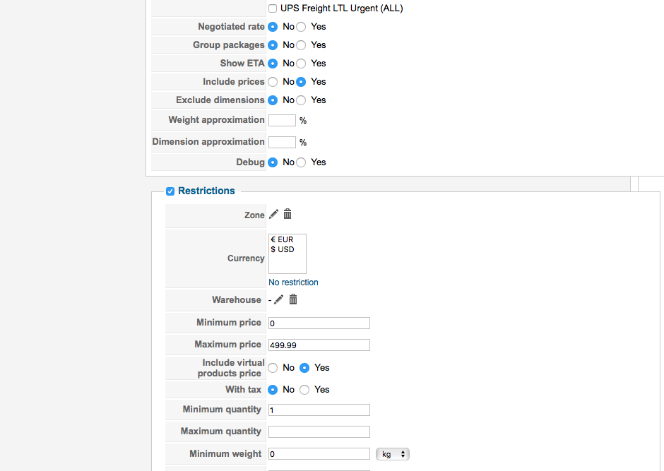

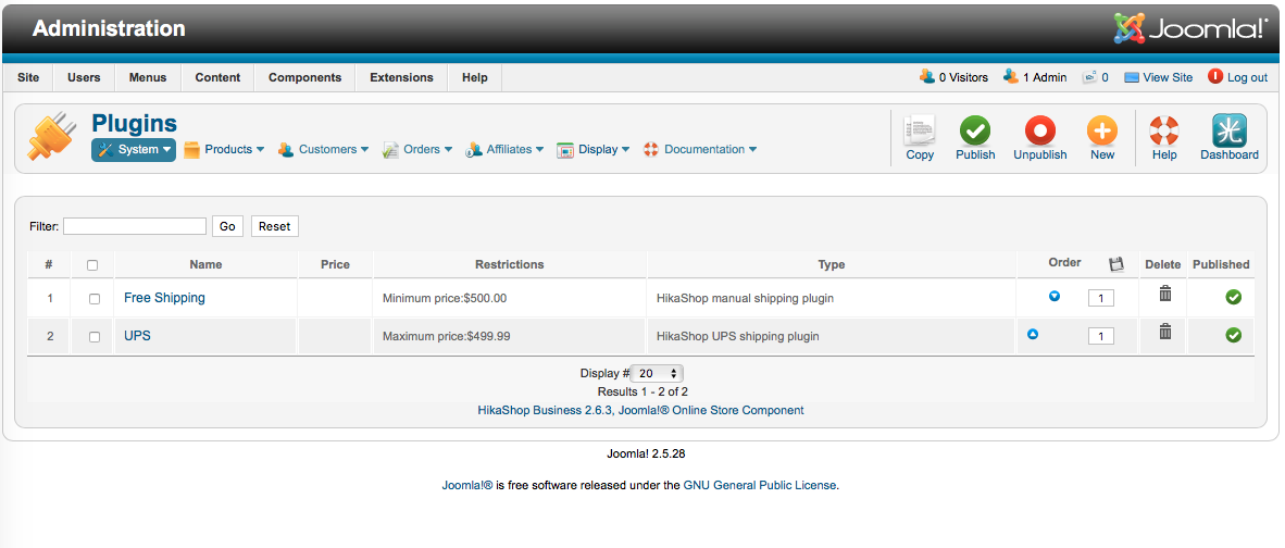

Manual, "free shipping" is on and working. I have it set to use free shipping on orders over $499.99, This works flawlessly. I have set the UPS option to anything under $499.99, but continue to get the message: "The total of your order is too low for all the possible shipping methods."

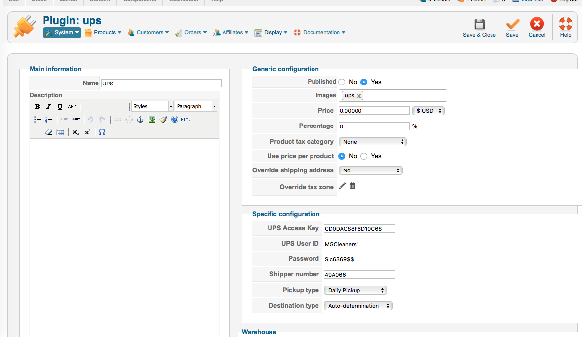

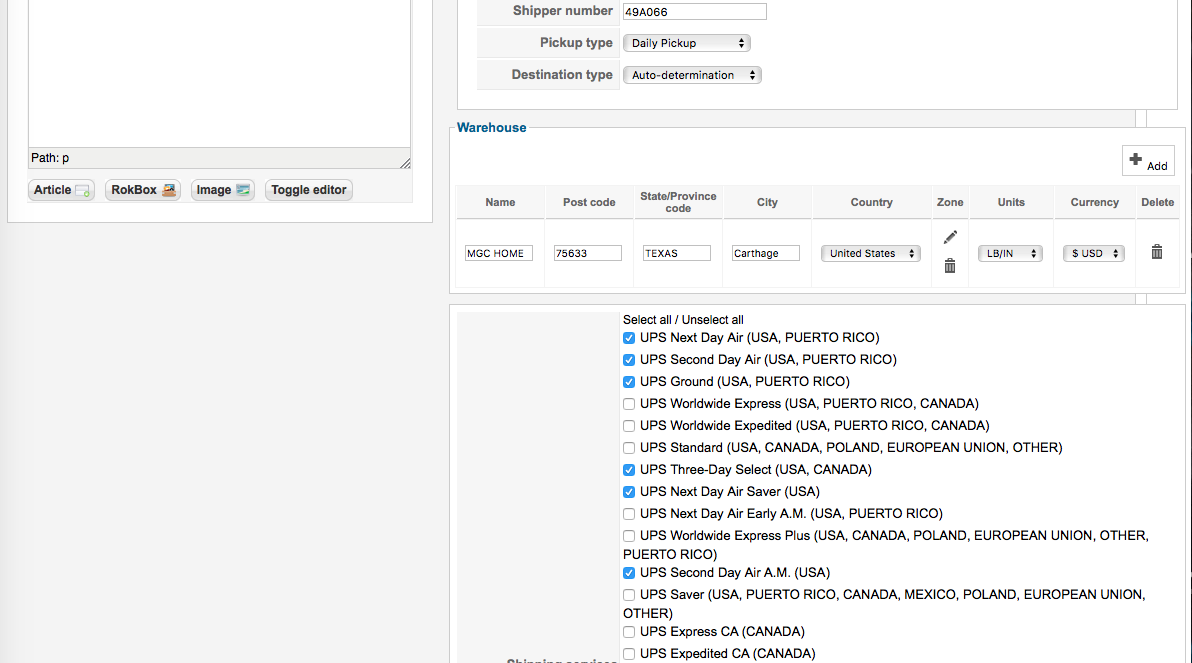

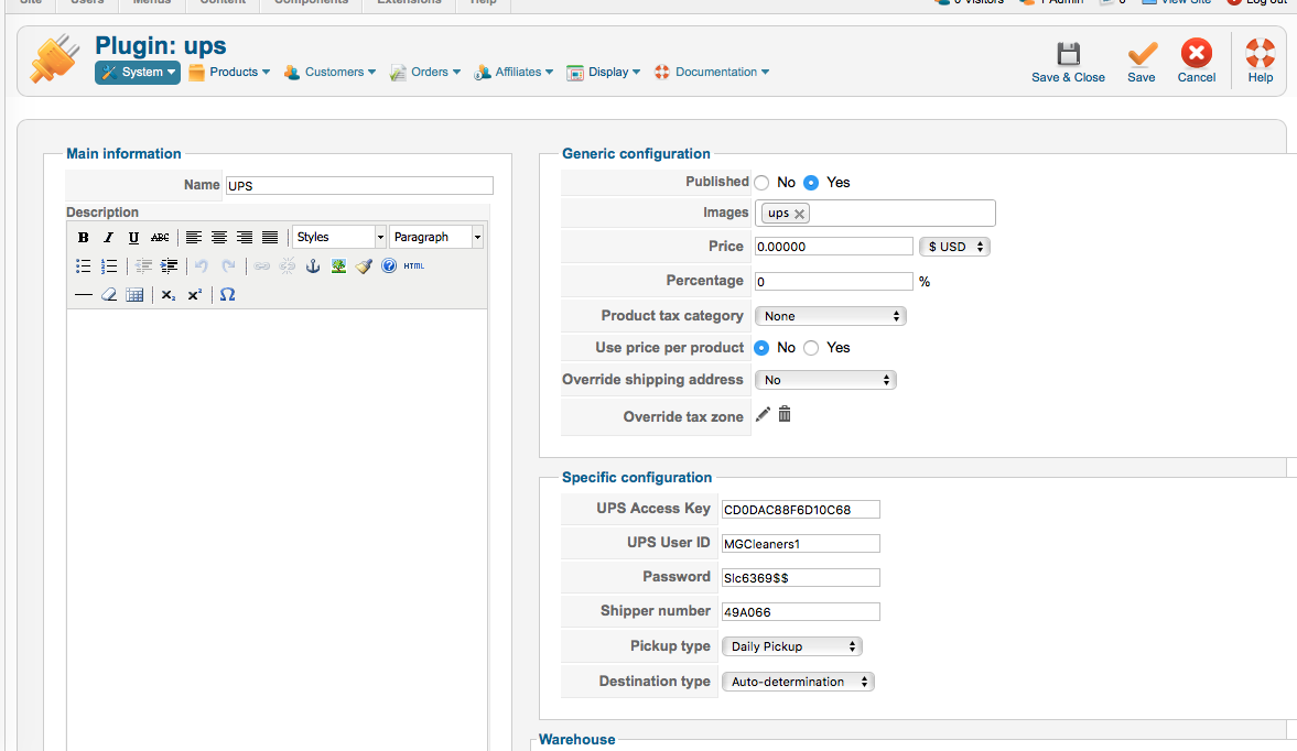

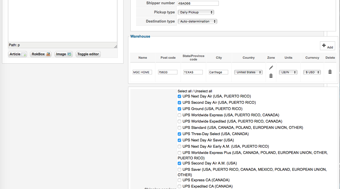

Firstly, you should change the value of the "State/Province code" option through your UPS shipping configuration page by "TX" instead of "Texas" and test it again.
Thank you.
  • Posts: 4
10 years 3 months ago #243096
I did this and get the same error. As expected. I have tried several different variations, including deleting the shipping option and starting over 3 different times. The same error message occurs for anything that doesn't qualify for the manual shipping option.

Also, can you test it with equals "Minimum/Maximum Price" options like $499.99 or $500.00 ?
Thank you.
Last edit: 10 years 2 months ago by Mohamed Thelji.
  • Posts: 4
10 years 2 months ago #244366

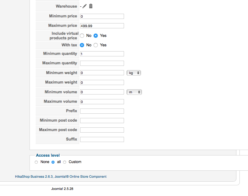

I currently have the shipping maximum set at $499.99 since my site offers free shipping on orders over $500.00. Since, I have also tried setting the minimum purchase to $.01, with no change in the error I receive.
10 years 2 months ago #244449
I tested it with the "minimum price" option of your Free shipping method set to 499.99 and it worked fine, so you should actually play with "Minimum / Maximum Price" options to exactly get the behavior you want.
