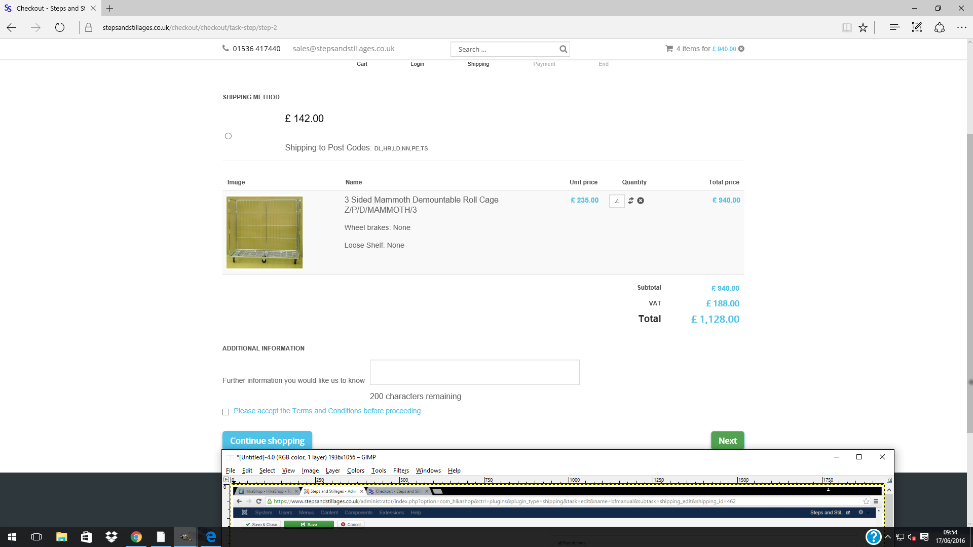

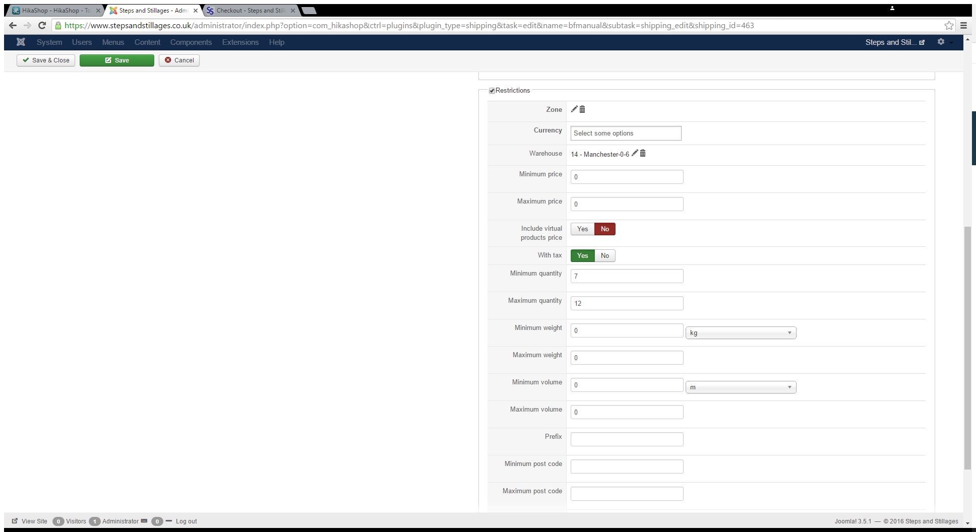

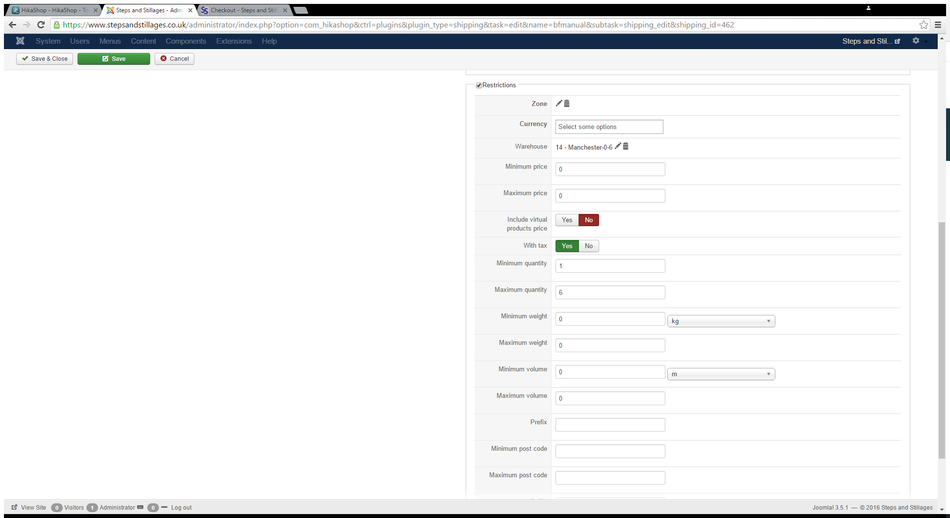

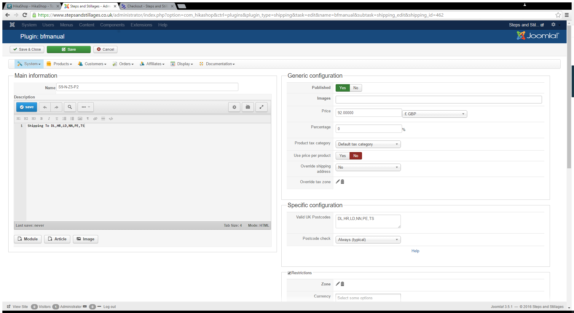

I have shown results for this product 3 Sided Mammoth Demountable Roll Cage shipped to postcode NN17 5XY, although I created a test manual shipping method with no post code restriction and it still didnt work. Quantity purchased 4. The product has warehouse set to Manchester-0-6. Here is the shipping method that should be used for this quantity.
Product www.stepsandstillages.co.uk/products/rol...emountable-roll-cage
Results:
Here is the shipping method it is using:
All methods that use weight instead as the restriction work fine.
