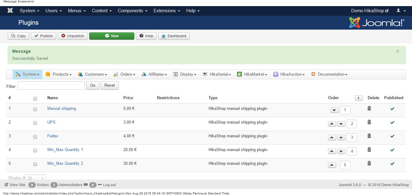

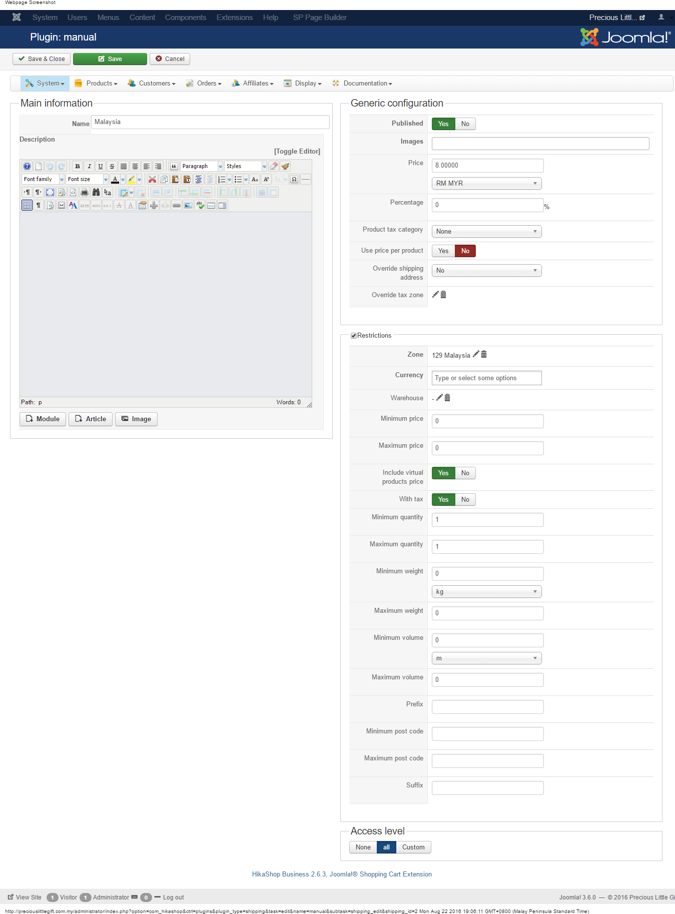

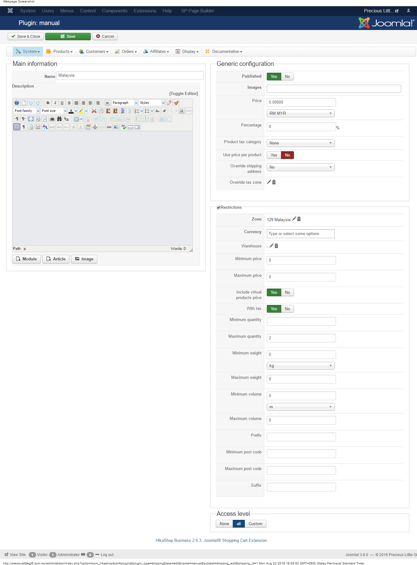

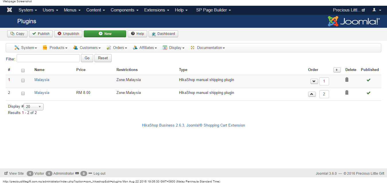

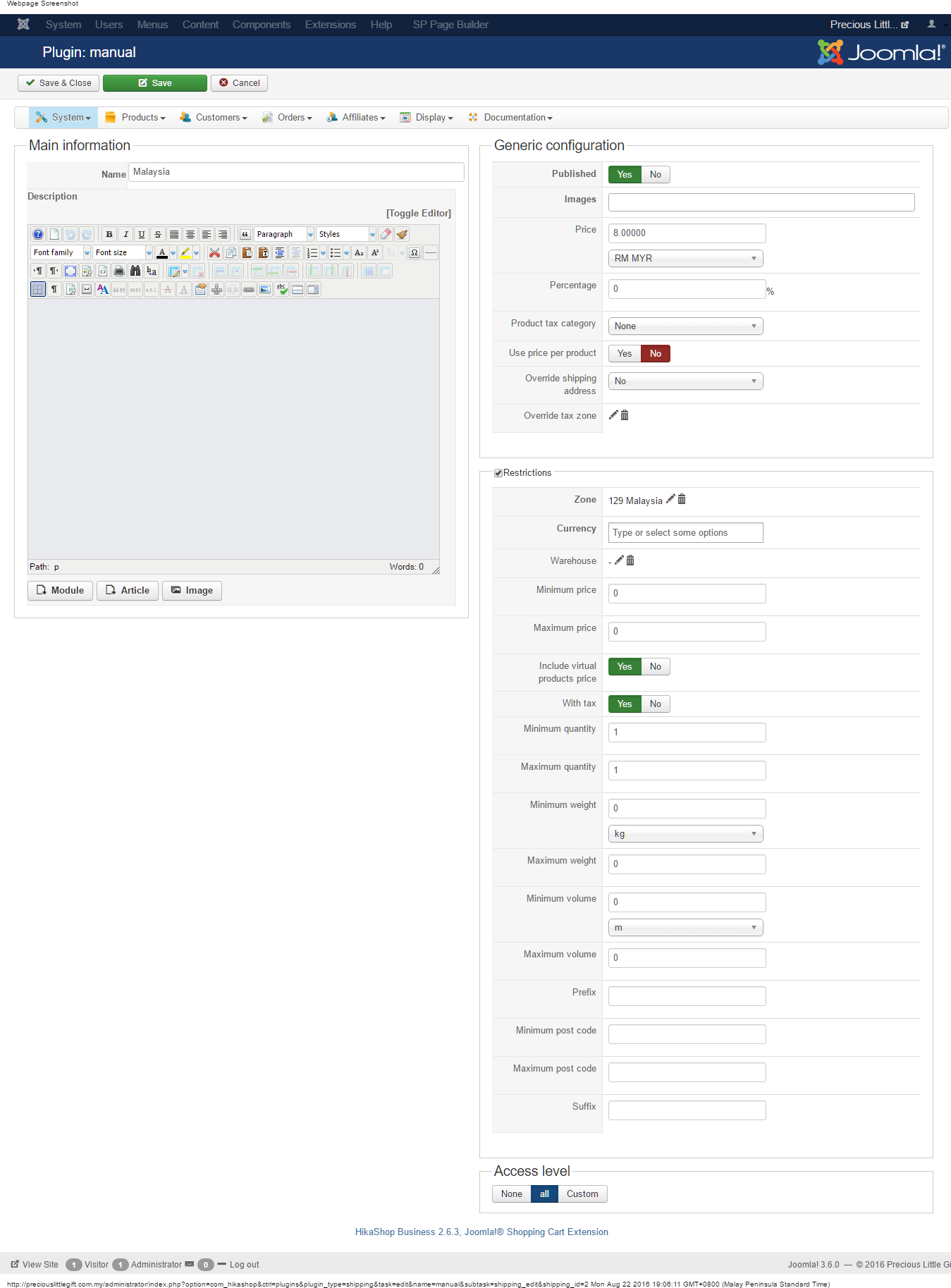

We have configure 2 shipping method by minimum and maximum quantity as below

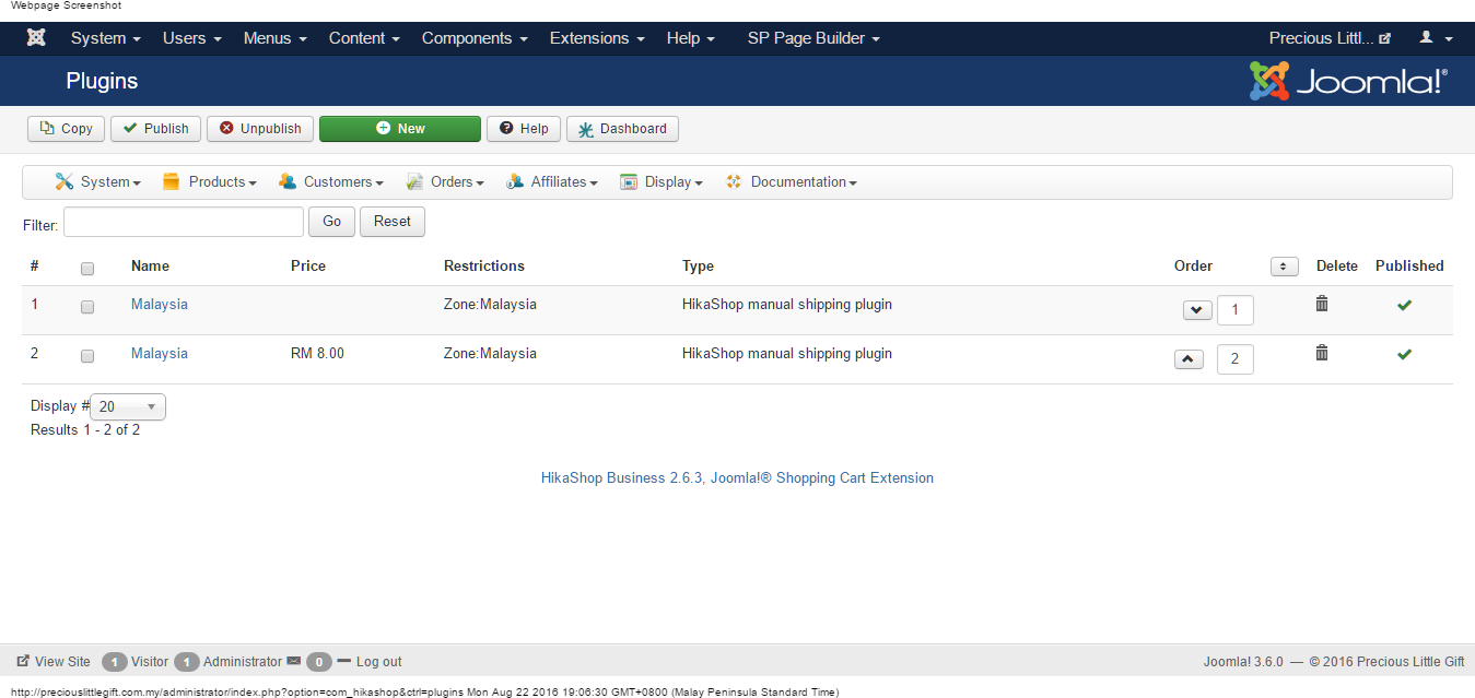

However, whenever we save the restriction is not shown at shipping method listing as below
When we try to check out with one item or 2 item, both shipping method shows together, and one important things, payment method is missing althought we put it at same step with shipping

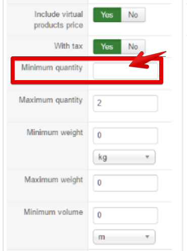

nicolas wrote: Hi,
1. Do you see the restriction if you edit the shipping method ? If yes, then it's taken into account and it's just the listing not supporting yet the display of that restriction.
Nope, the min qty and max qty was not reflected as in screen shot after we hit save
hikashop.com/media/kunena/attachments/33...ration_-_Plugins.png

9 years 11 months ago #248484
Can you give us more information about it ? do you mean that you were not able to save your shipping configuration ?

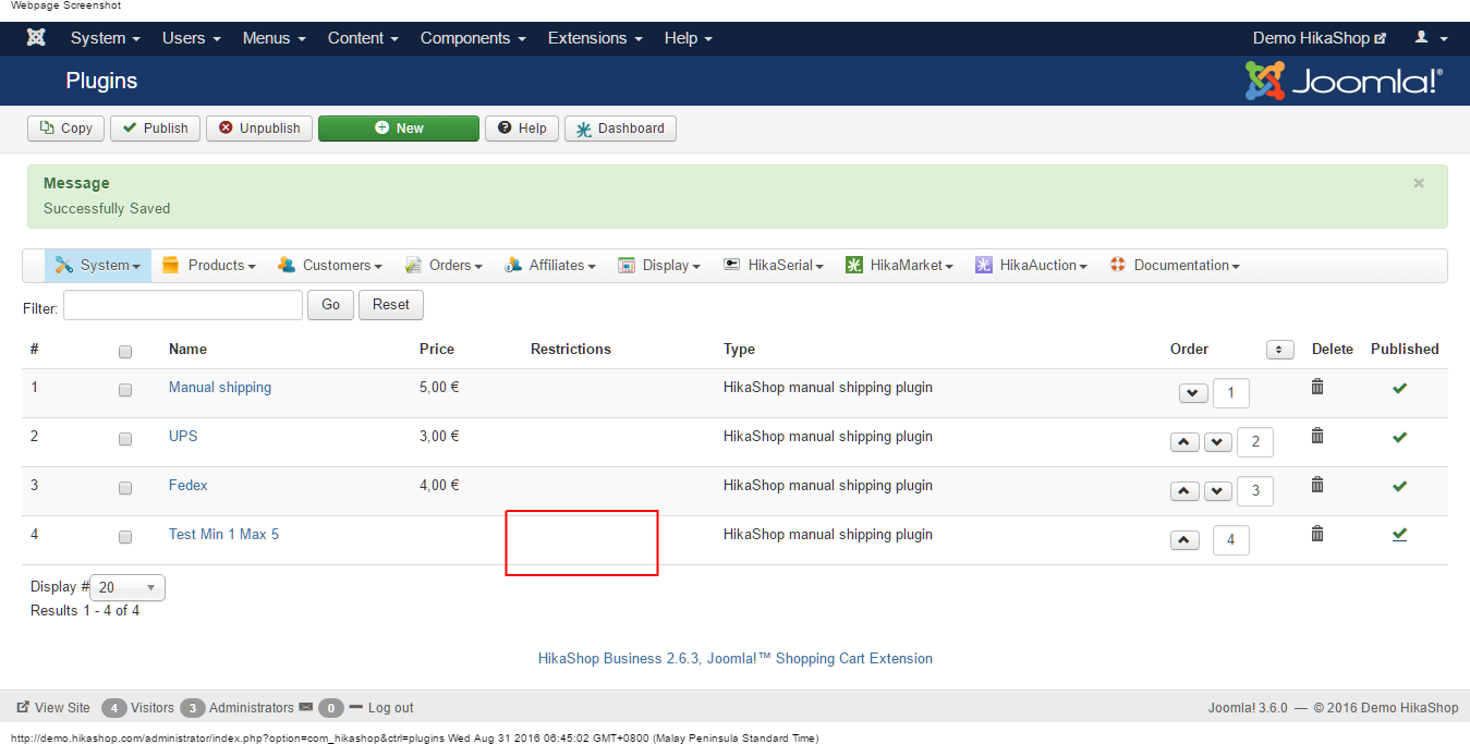

Dear Theji
Yes, it was not saved

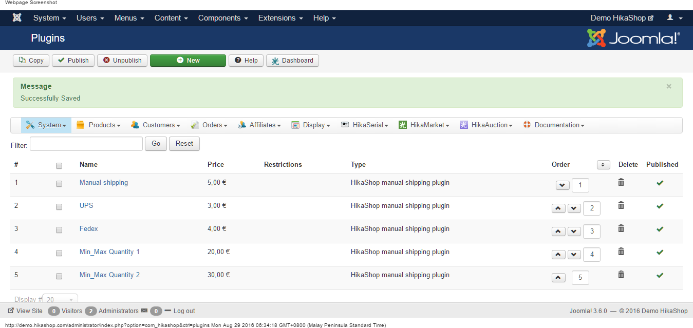

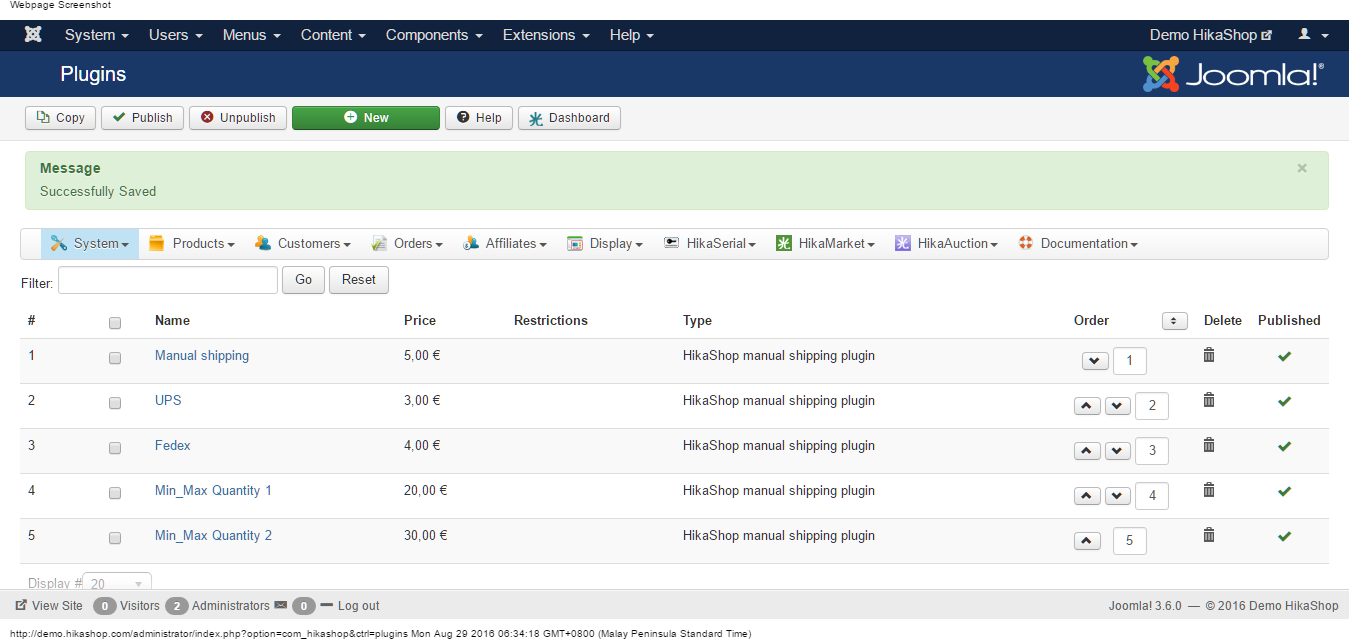

i have replicated the problem on demo.hikashop.com
Please see the screen shot below

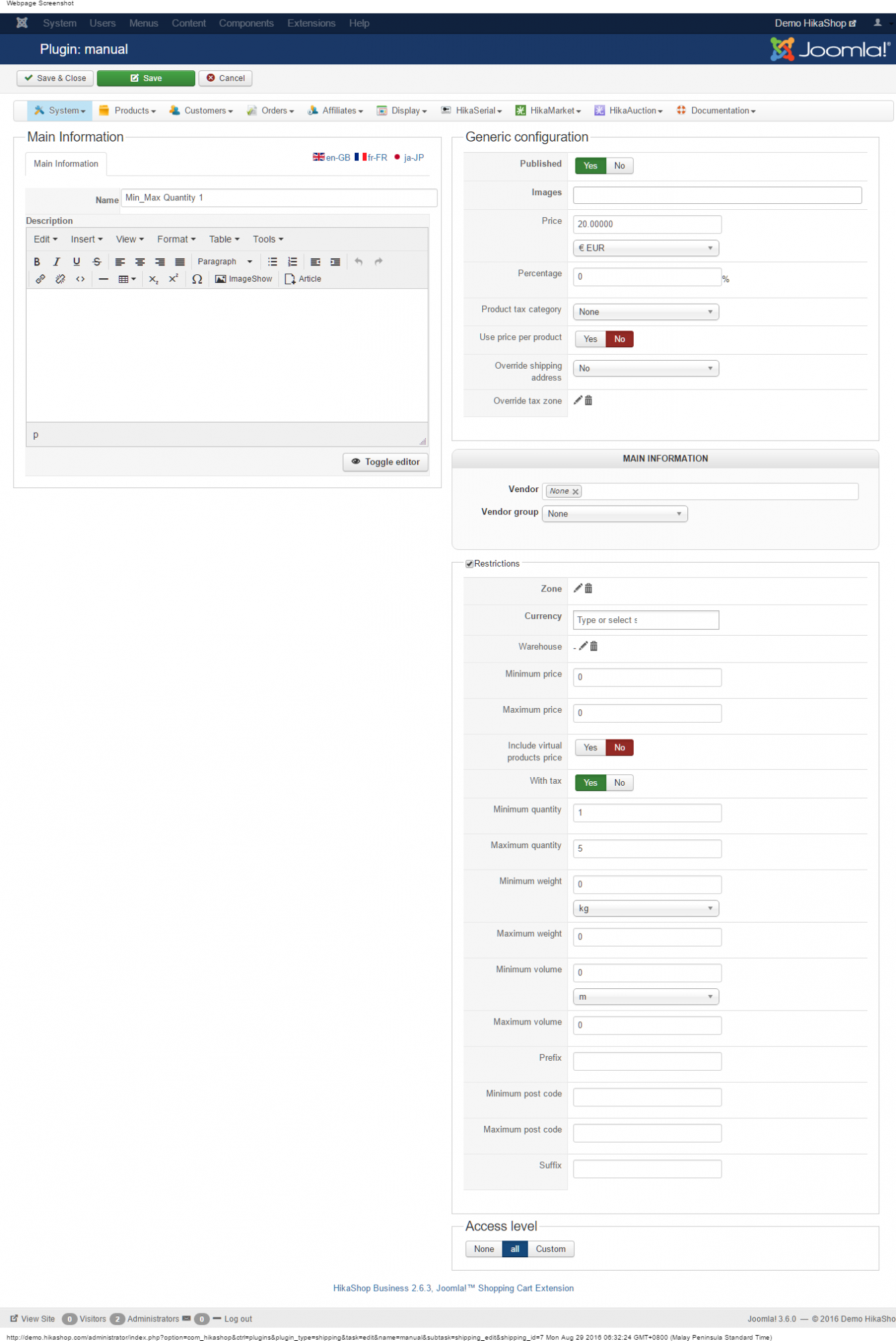

The restriction for min and max qty was not saved after hitting save and close button, please check for the 2 shipping method in demo site

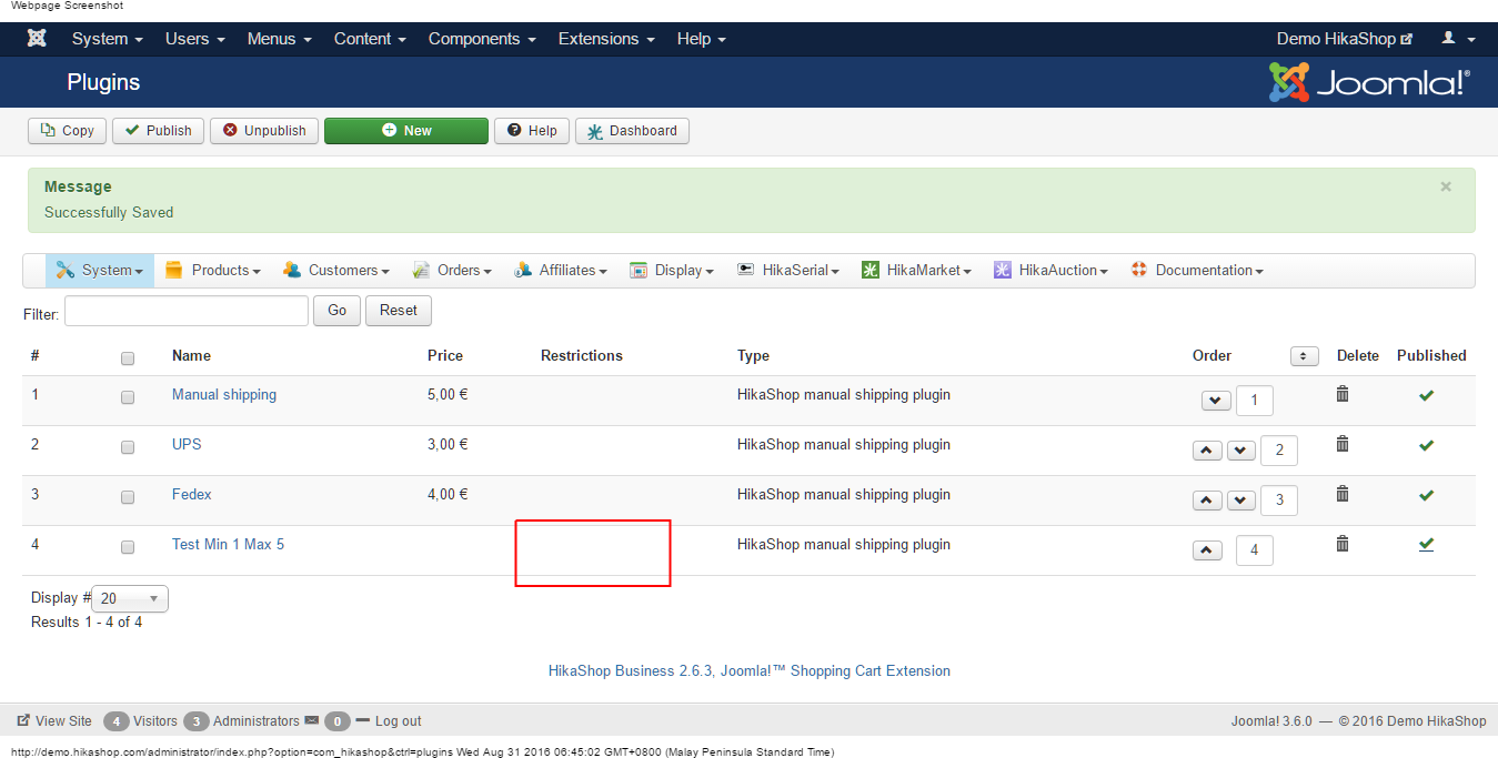

Dear Philip
it happen on every recent version of hikashop including your demo
Please help to provide your screen shot of below page after you save your min and max quantity restriction on demo.hikashop.com

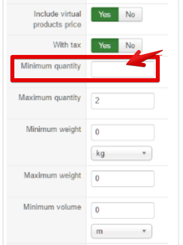

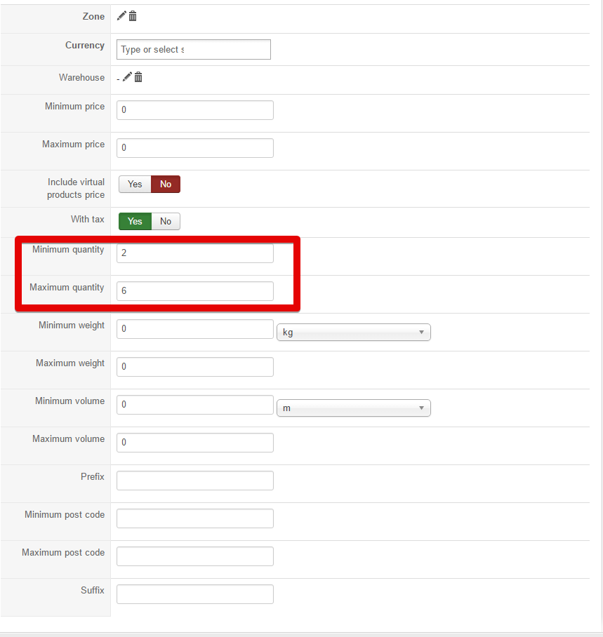

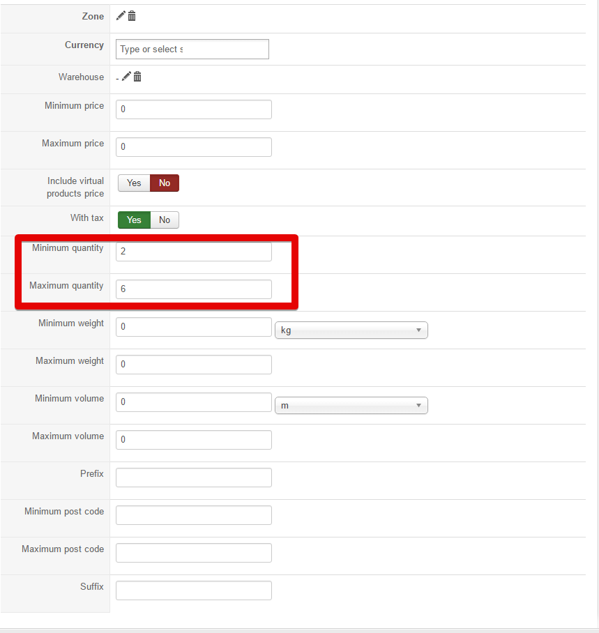

9 years 11 months ago #248707
Actually, even if the "Min qty" stay empty, without setting a value for that option, its default value will be 1 (you can only use a shipping method if you have at least 1 product in your cart).
Also, when I test it through the demo website the minimum quantity is always correctly saved even if I set it to 1 - 0

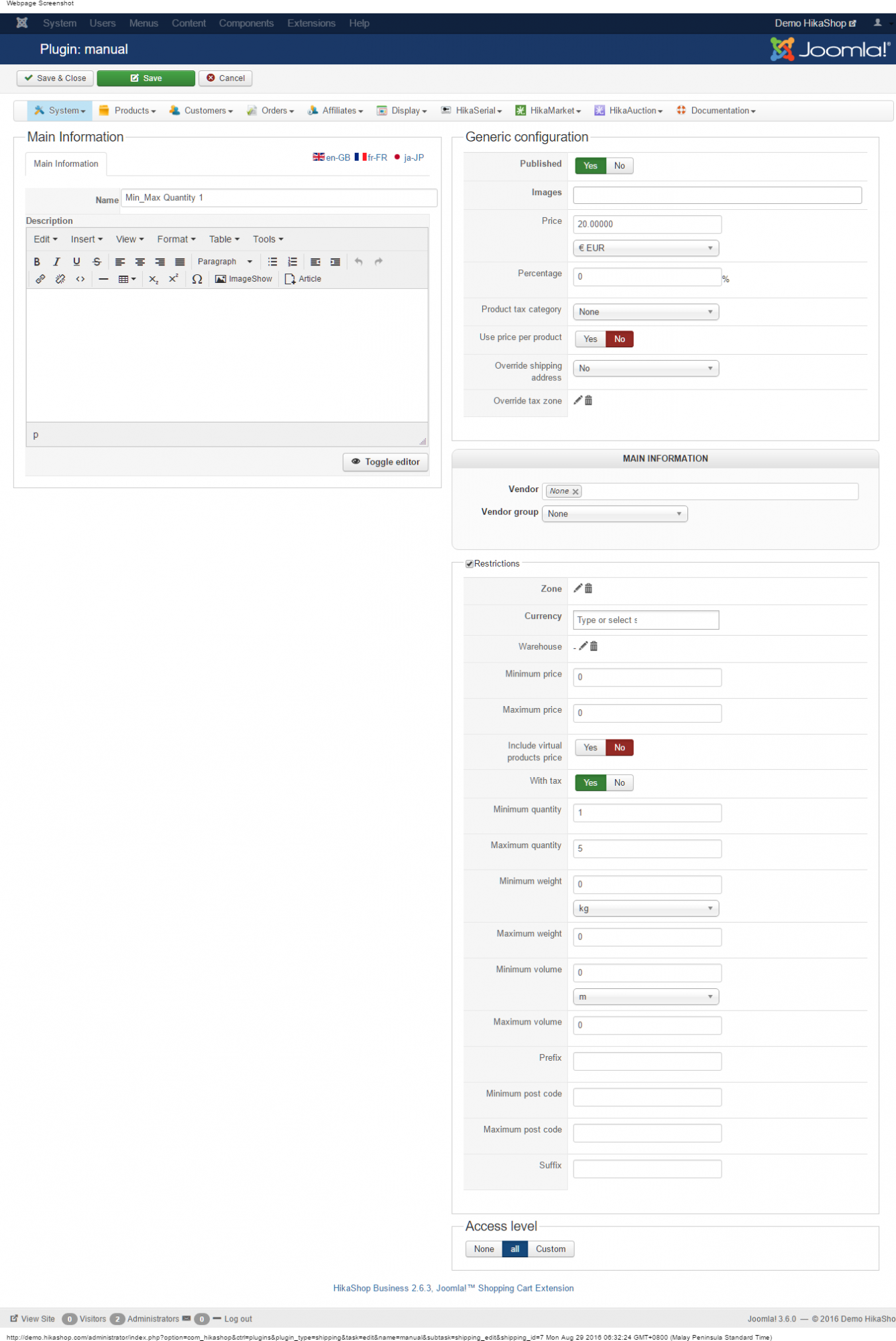

9 years 11 months ago #248788
Dear Thelji
This is the screen after i "save and close" restriction of minimum quantity 1 and maximum quantity 5 on demo.hikashop.com
Can you give me your successful screen shot?

9 years 11 months ago #248820
It's true that the "Minimum/Maximum quantity" restrictions are not listed through the "Restrictions" column of the shipping method listing page ("Hikashop->System->Shipping methods"), both these options are correctly saved if you go through your shipping method configuration page.
