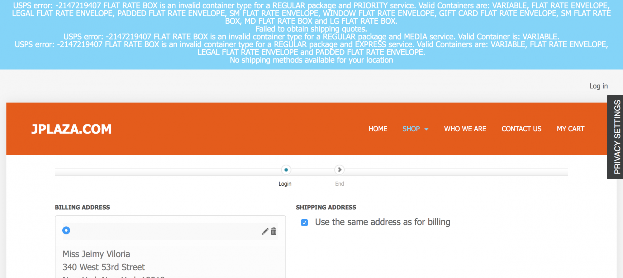

-- Joomla version -- : 3.6.2
-- PHP version -- : 5.6.24
-- Browser(s) name and version -- : SAFARi 9.1.2
-- Error-message(debug-mod must be tuned on) -- : USPS error: -2147219407 FLAT RATE BOX is an invalid container type for a REGULAR package and PRIORITY service. Valid Containers are: VARIABLE, FLAT RATE ENVELOPE, LEGAL FLAT RATE ENVELOPE, PADDED FLAT RATE ENVELOPE, SM FLAT RATE ENVELOPE, WINDOW FLAT RATE ENVELOPE, GIFT CARD FLAT RATE ENVELOPE, SM FLAT RATE BOX, MD FLAT RATE BOX and LG FLAT RATE BOX.
USPS error: -2147219407 FLAT RATE BOX is an invalid container type for a REGULAR package and MEDIA service. Valid Container is: VARIABLE.
USPS error: -2147219407 FLAT RATE BOX is an invalid container type for a REGULAR package and EXPRESS service. Valid Containers are: VARIABLE, FLAT RATE ENVELOPE, LEGAL FLAT RATE ENVELOPE and PADDED FLAT RATE ENVELOPE.
No shipping methods available for your location
I keep getting this error. I changed the configuration in different ways with no luck. I need help
9 years 11 months ago #248727
As it's said on the error message, you'll just have to change the value of the "Container" option to "Variable" for example through your USPS configuration page.

  • Posts: 8
9 years 11 months ago #248755
Thank you so much. Now that part is fixed.
