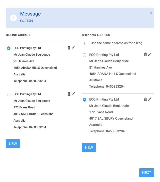

  • Posts: 7
9 years 10 months ago #249869
Thank you for the reply.
I have tried the restrictions but I keep getting an error message when the restriction is reached.
I must be doing something wrong and that is why I thought maybe there is something else.
See attached for the error.
  • Posts: 85995
  • Thank you received: 14167
9 years 10 months ago #249883
This means that shipping method method was found.
You should have one shipping method with a price of 0 and a "minimum price" restriction of the amount for the "free shipping case".
