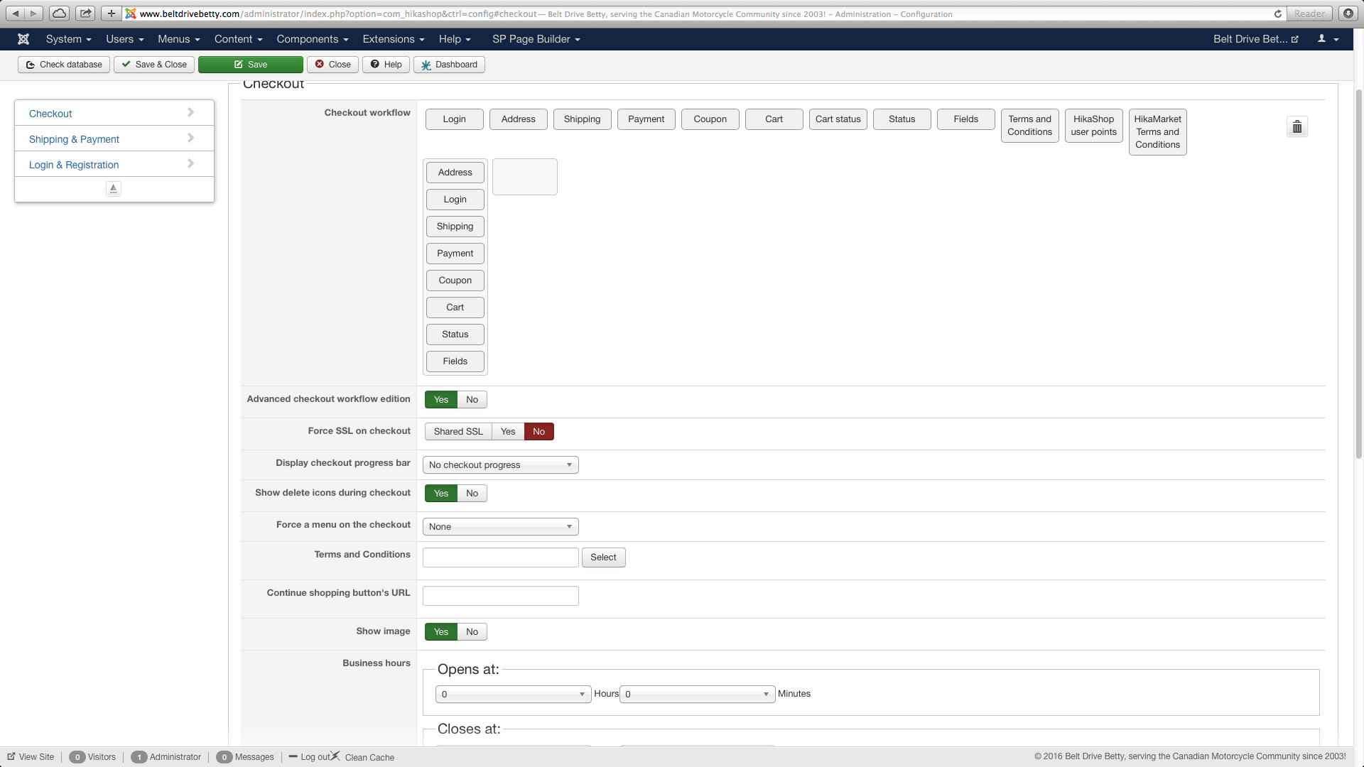

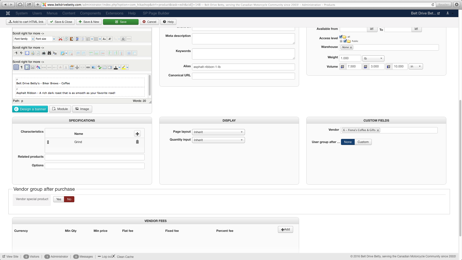

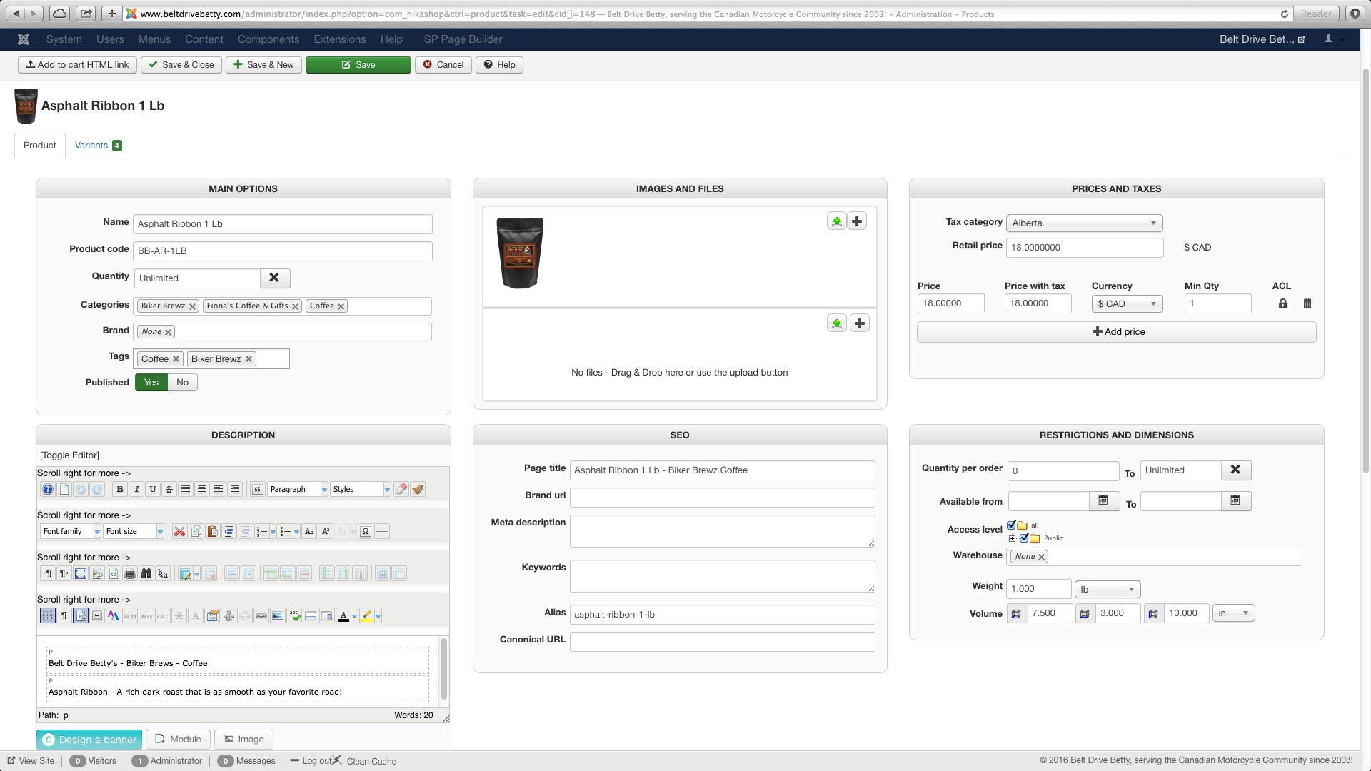

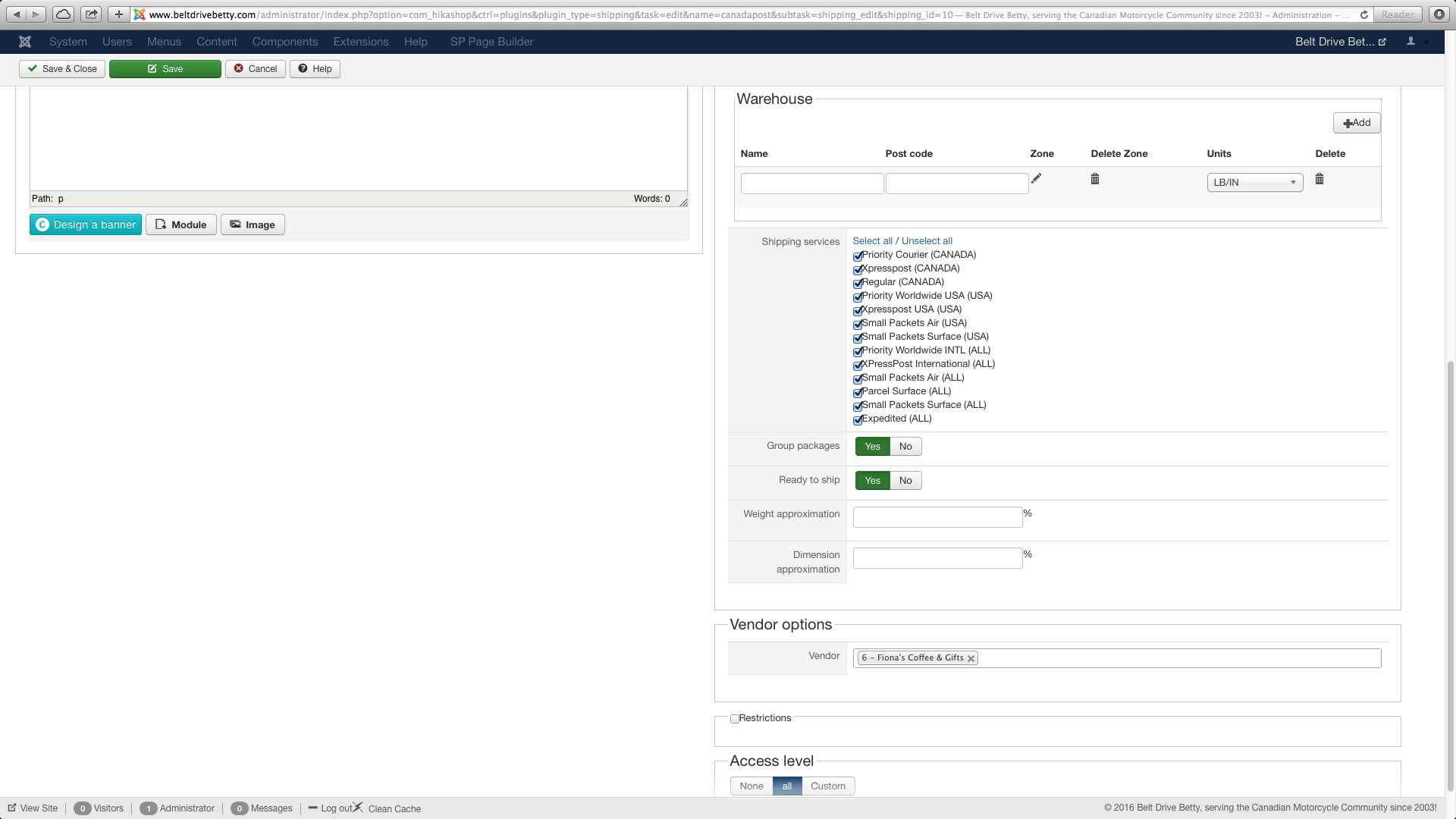

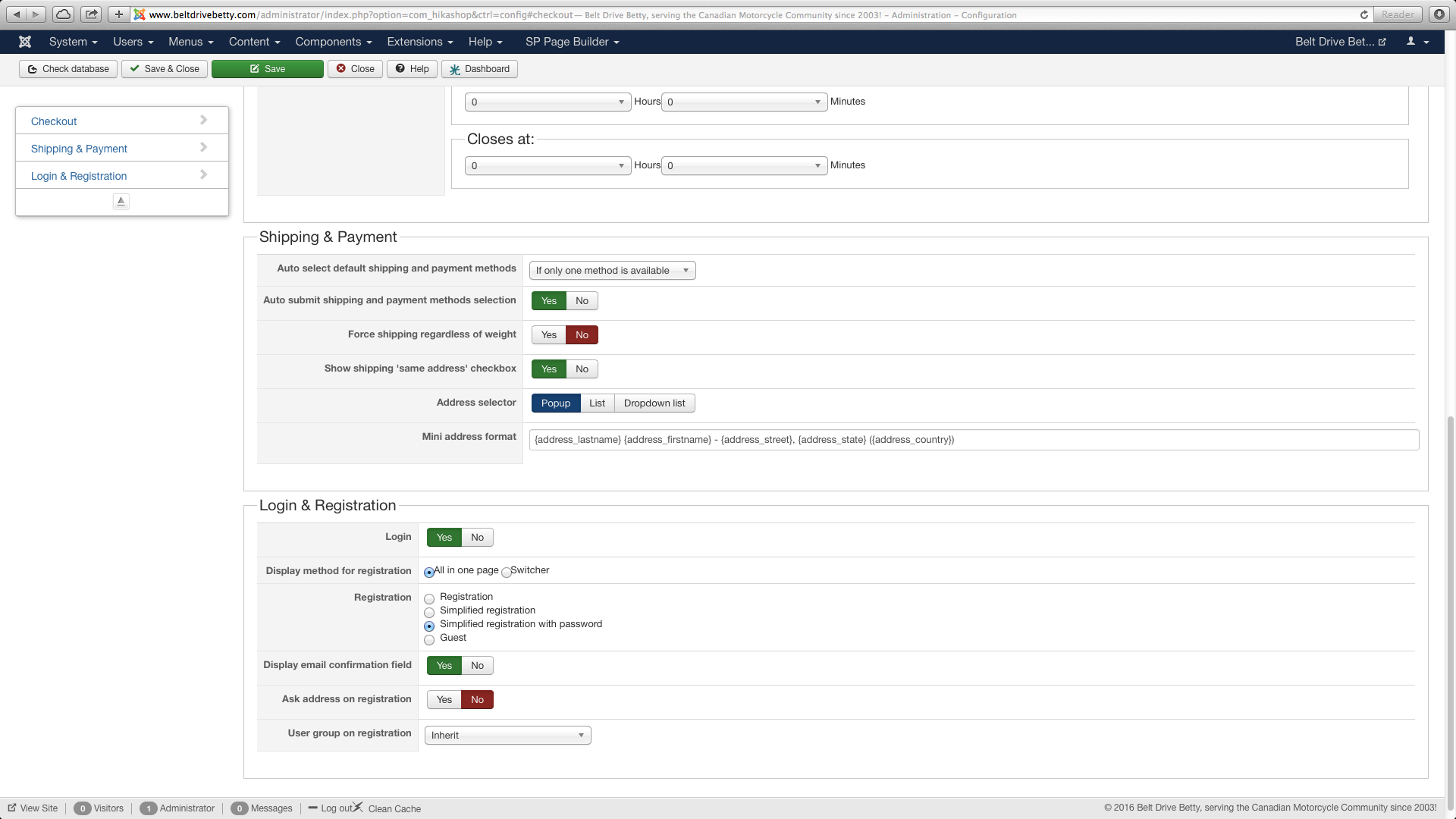

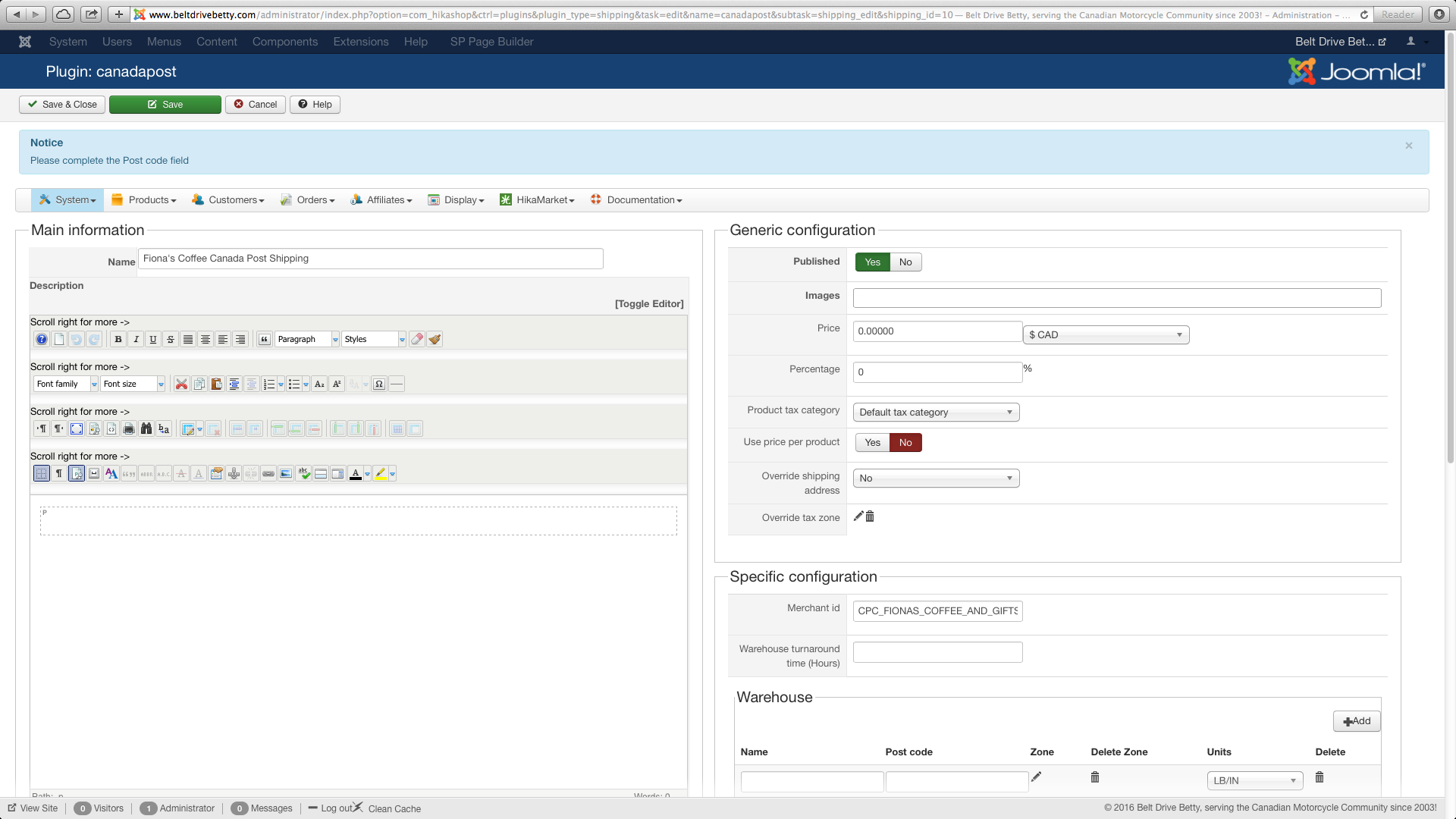

Sure, can you show us some screenshots of how you configured your :
- Canada Post shipping method via "Hikashop->System->Shipping"
- Products that were added to your cart when you tested it
- Checkout workflow via "Hikashop->System->Configuration->Checkout"

Attached are screenshots. Also important to note, this canada post plugin is for one vendor in the hikamarket. Thank you

I don't know how you exactly planned to use your shop, but regarding your canada post shipping method, you'll have to configure a warehouse through the "warehouse" tab of your canada post shipping configuration page, but also a "warehouse turnaround time".
