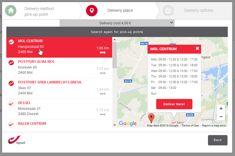

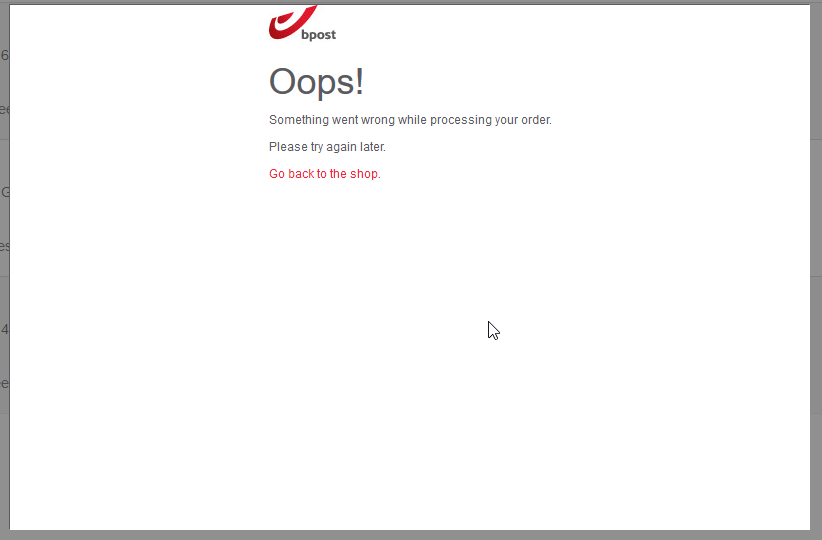

I installed the bpost plugin and it seems to do the trick ..; however, if I start the shipping manager from Hikashop i can go through some steps but all of a sudden that finishes with "Oops! Something went wrong while processing your order. Please try again later.". Then the only choice I have is to go back to the shop-page...

I might add that I changed bpost.php because of an error I had at first ... the package price had to be in eurocents ... so I changed line 330 from
$vars['orderTotalPrice'] = $order->full_total->prices[0]->price_value_with_tax;
into
$vars['orderTotalPrice'] = IntVal($order->full_total->prices[0]->price_value_with_tax*100);
and the error went away ...

We actually already fixed that issue, so you should download the last Bpost shipping version via :
github.com/HikaShop/hikashopshipping-bpost

Indeed ... I downloaded the new version and it worked from the start ...
Nice ... as usual ... thanks
