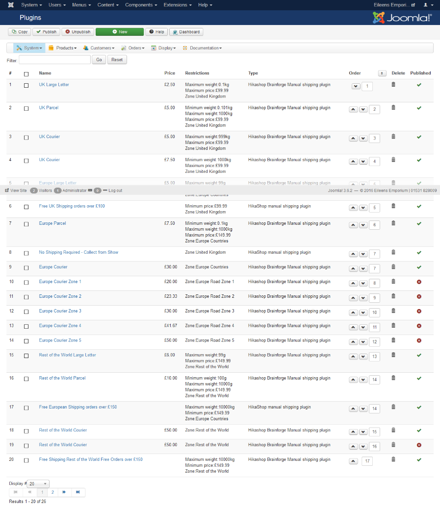

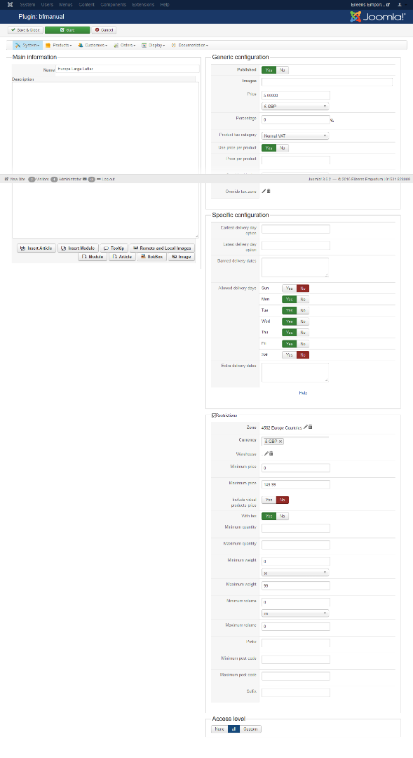

  • Posts: 54
9 years 9 months ago #256331
I have attached screenshots for all our shipping methods and the settings within the 'iffy' one
  • Posts: 86183
9 years 9 months ago #256378
I see that you're using the brainforge manual shipping method instead of the standard manual shipping method, so maybe there is a bug in that shipping method that wasn't found yet.
If you try with the manual shipping method instead, do you get the same problem ?
Also, you didn't provide instructions on how to reproduce the problem on your website.
