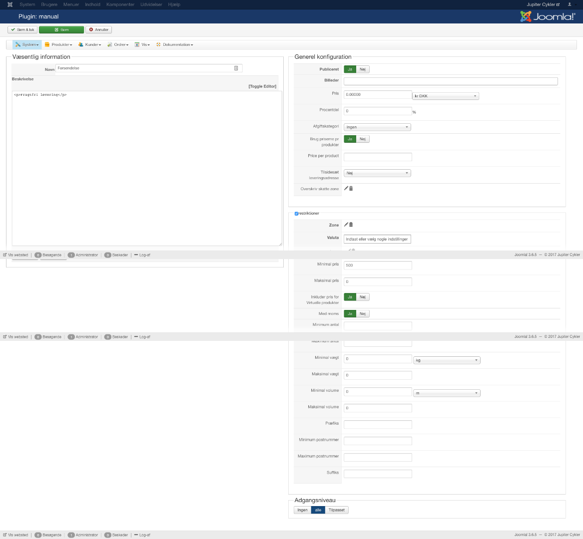

Im currently trying to setup price-per-product shipping fee on chosen products, but facing some issues.
For what i understand of the functionality, it should be possible to determine specific additional shipping fee on specific products based on every generel shipping method.
I'm facing several problems:

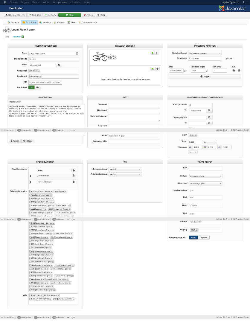

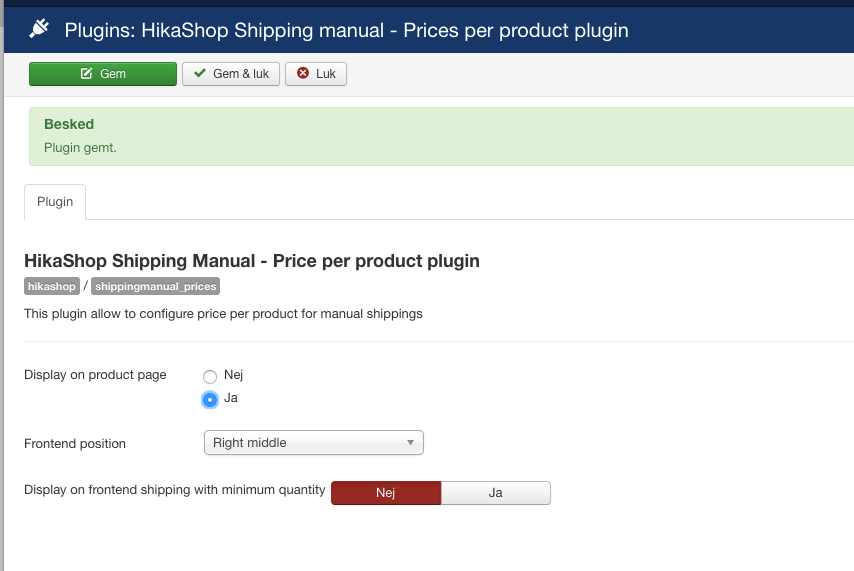

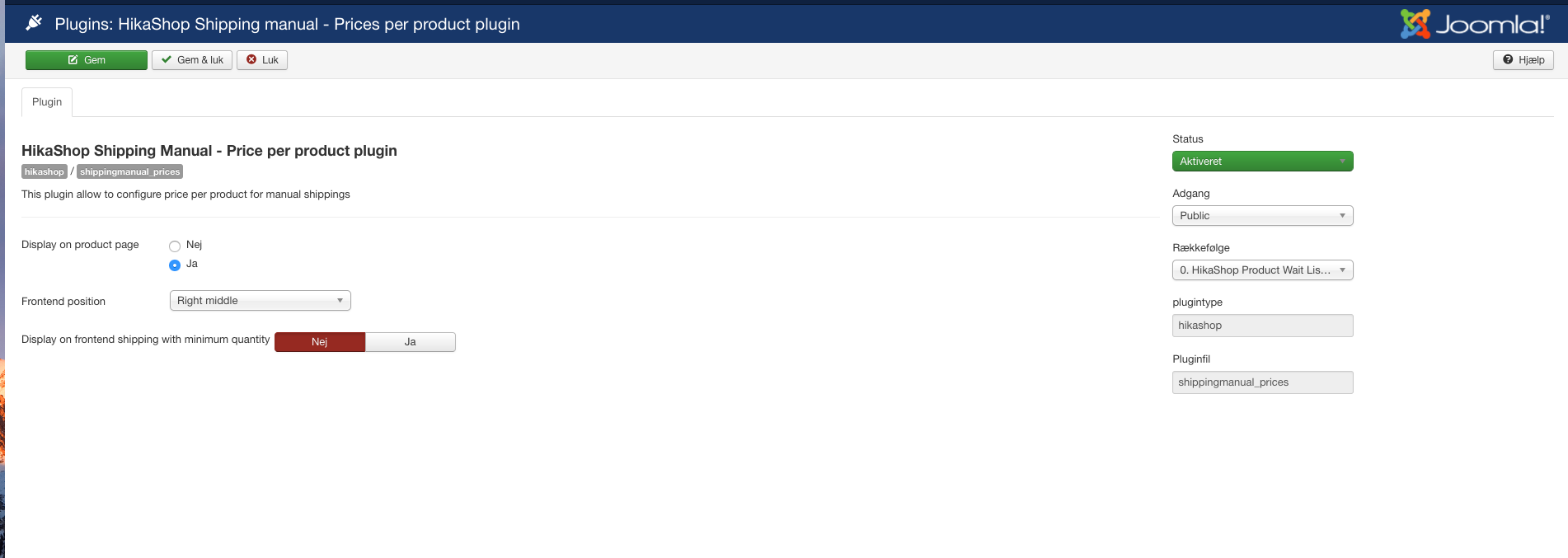

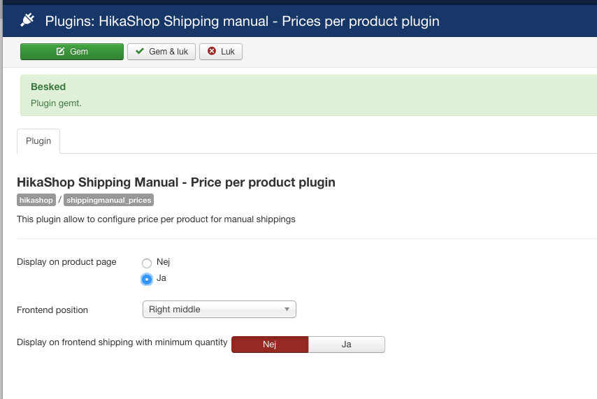

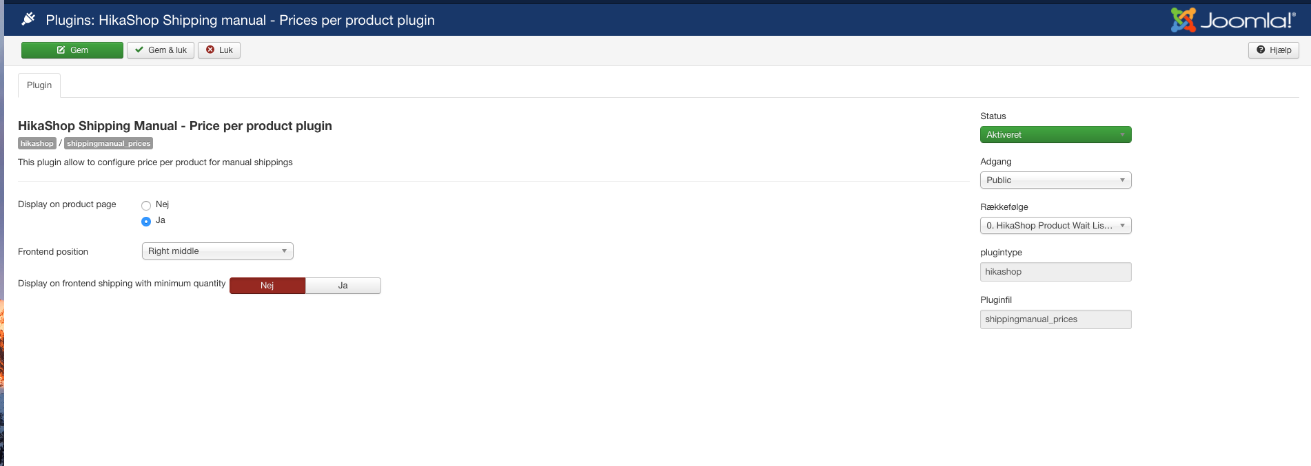

1. I've enabled the "price per product" plugin - but not able to see the configuration-box on the product page in the administration.

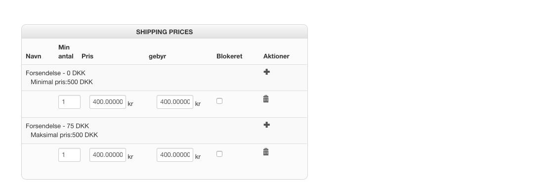

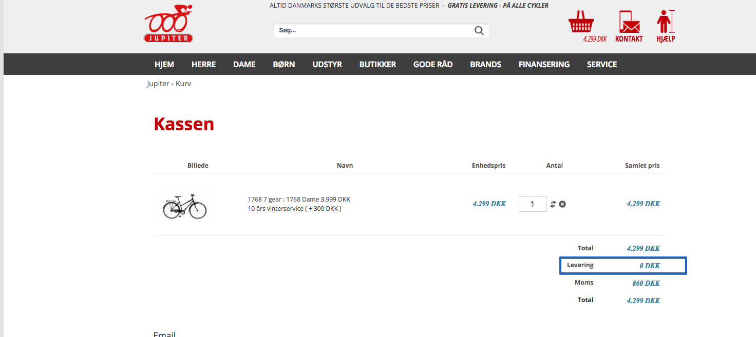

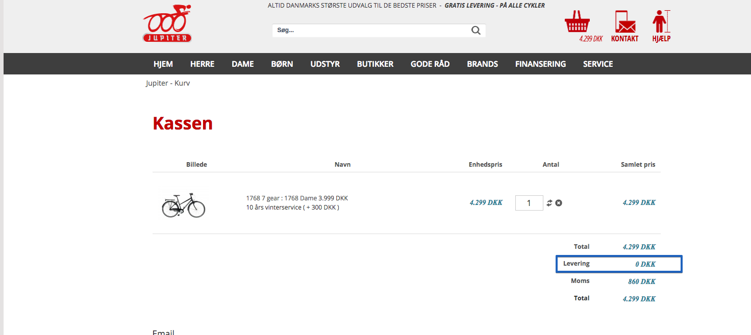

2. (Yesterday) i was able to see - but even though i set up a shipping rule for my products, the addiotional fee did not come up frontend in the checkout flow.
2.1 I got it to work - but it seems like it only happen with products without any variants - and only on one of my 2 general shipping method.
Am i doing anything wrong here, or does it need a fix of some kind?

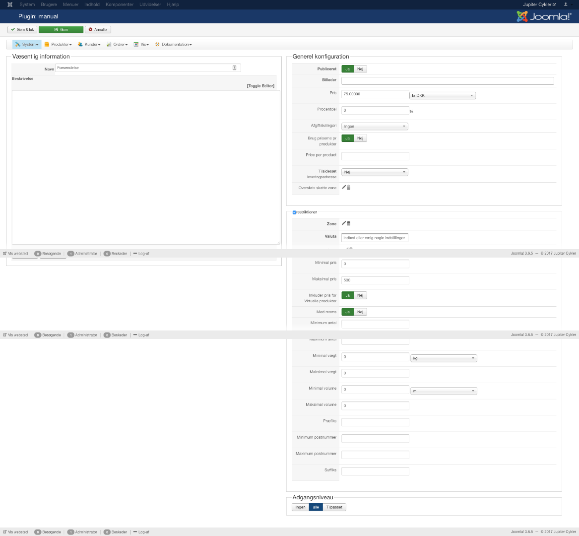

9 years 7 months ago #260912
Note that you should also make sure that the "Use price per product" option is set the YES through your shipping configuration page, so that it can be displayed through the "Shipping prices" tab of your product page configuration page.
Hi Mohamed
This is already enabled to :)
Still not working.

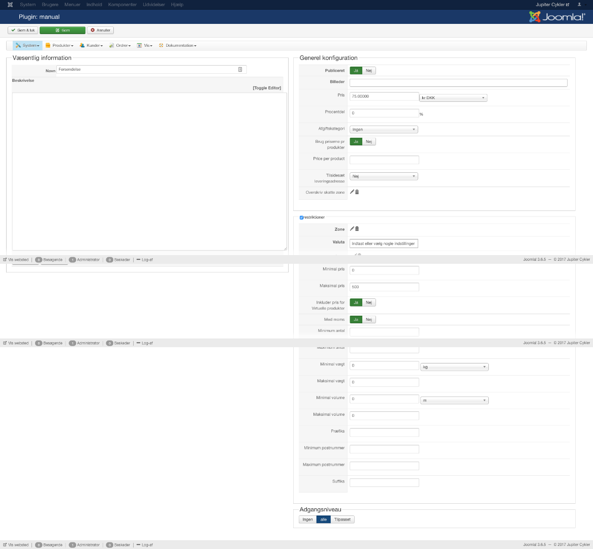

The "Price per product" input field that appears on the the shipping-method (general) page, is this field for adding a shipping-price for every product in the basket?

Hi again, Mohamed.

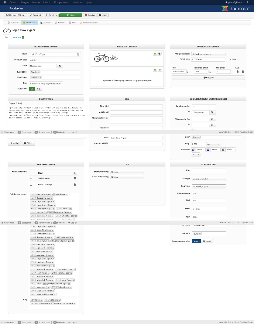

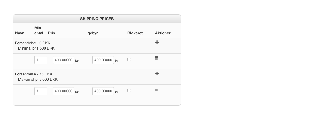

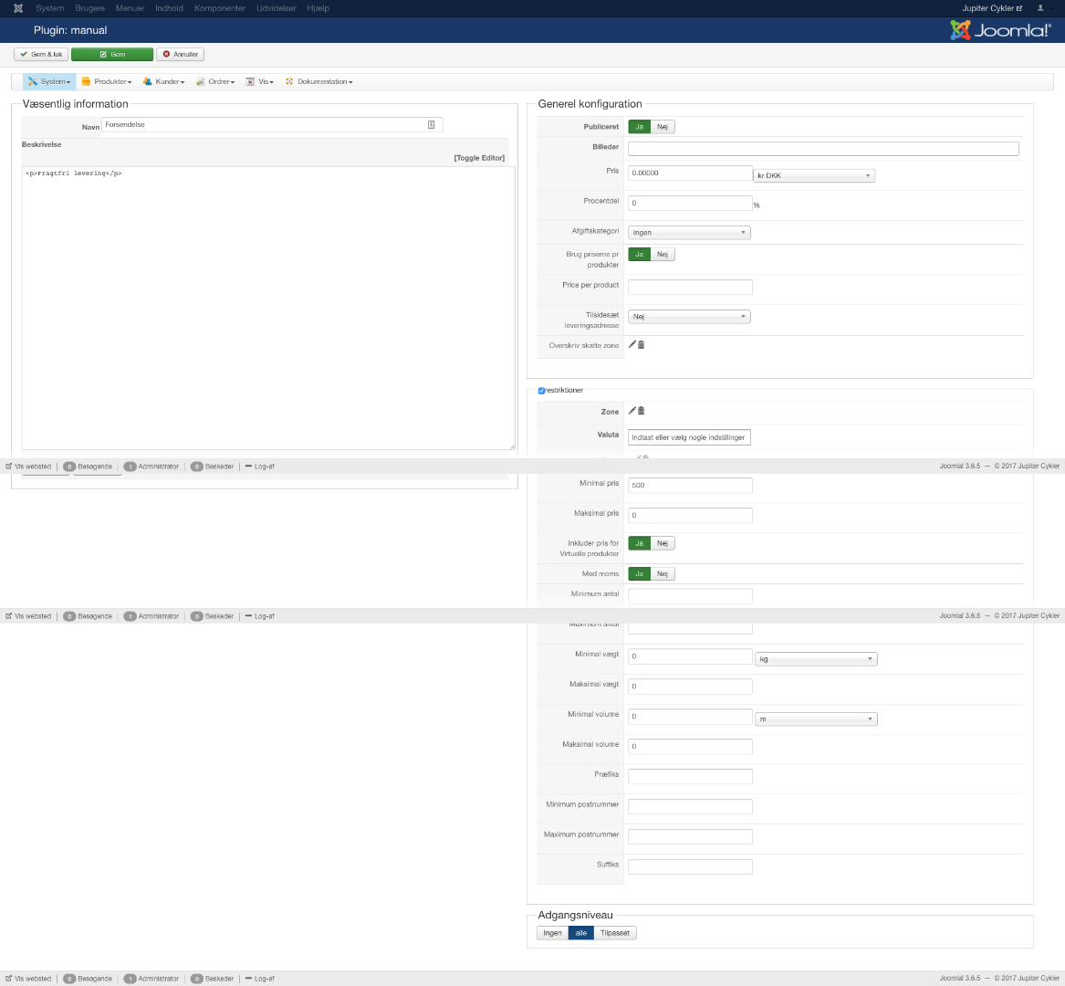

I've uploaded the complete flow here.
Can't see why this not should work?
  • Posts: 14
9 years 7 months ago #261090
@Mohamed
I've fixed it - i was sure i could make a general shipping fee only on the general product. I've now set a fee on every variant, and it works like a charm.
Thanks for helping me out.
