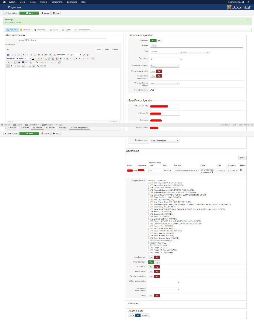

Hi All,
Thanks for the great component.
My question is with regards to shipping through the UPS plugin. I have set all the correct parameters (see image) in the plugin and the plugin does seem to be working fine. However, the rates are through the roof. How can I ensure the rates are the actual rates in UPS shipping? The main issue seems to be the grouping of packages, Hikashop UPS plugin groups the items in too many packages (boxes) as opposed to the UPS website which actually asks me how many boxes I need for my packages.
Am I missing something?
Edit: Bigger picture here i.imgur.com/YW5YUHf.png

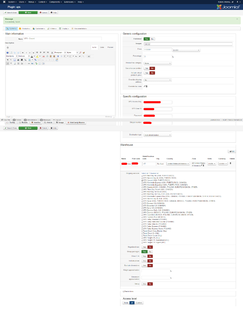

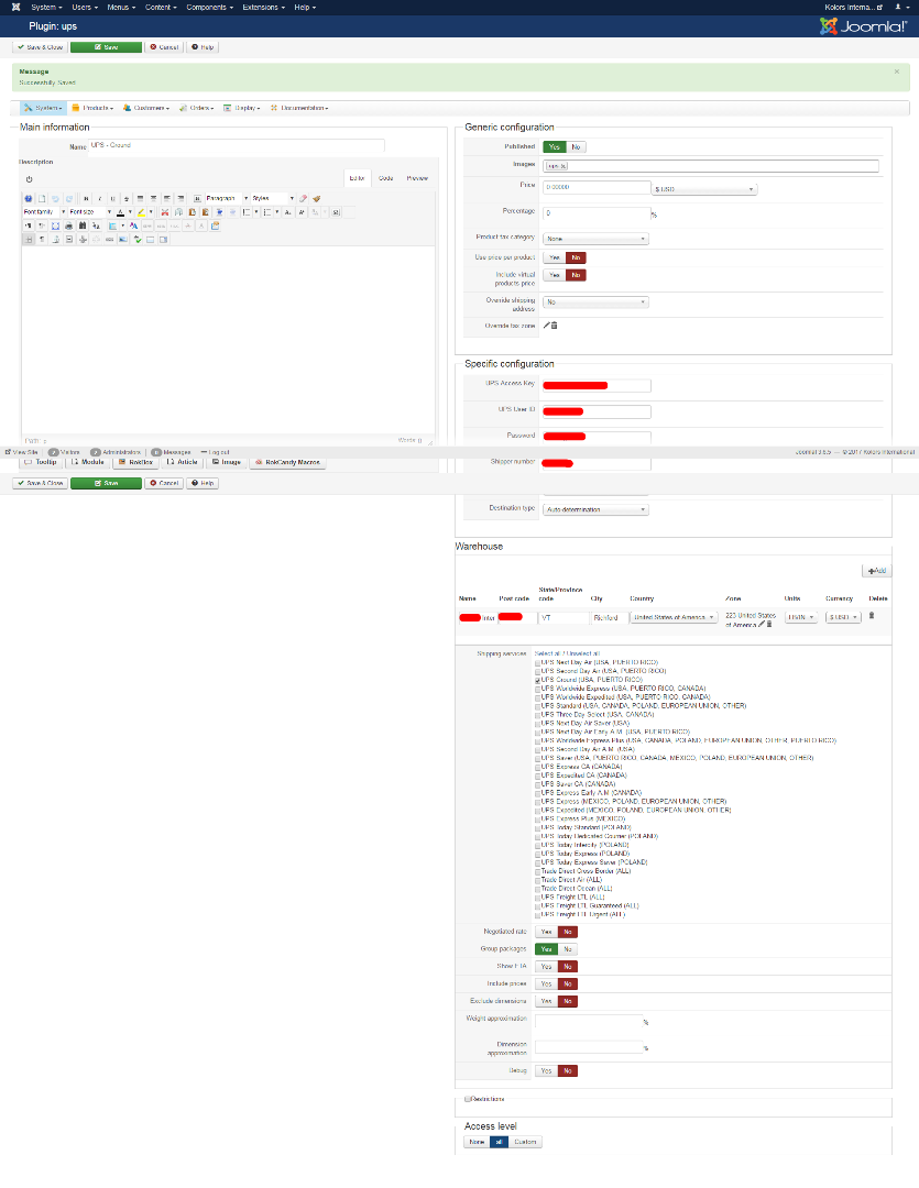

I made further discoveries, please see the UPS shipping calculator image here: i.imgur.com/P5tsJnD.png
Notice how I have set 96 quantities of products that each weigh .250 lb, adding to a total of 24 lb. As you can see from the screenshot I used 1 box to insert these 96 items (1 package) and the price is 23.89$ USD for UPS Ground.
The same 96 quantities on HikaShop, when inserted into cart and checked out are calculated to use 3 packages instead, which come up to a total of 50.78$ USD for UPS Ground. Screenshot here: i.imgur.com/Au8lYDa.png
My question still stands, after an extensive amount of research, how and where does HikaShop UPS plugin calculate how many packages to use? Reading through this forum it looks like the Canada Post plugin actually has variables we can set for package info, does the UPS plugin have this information somewhere too?
