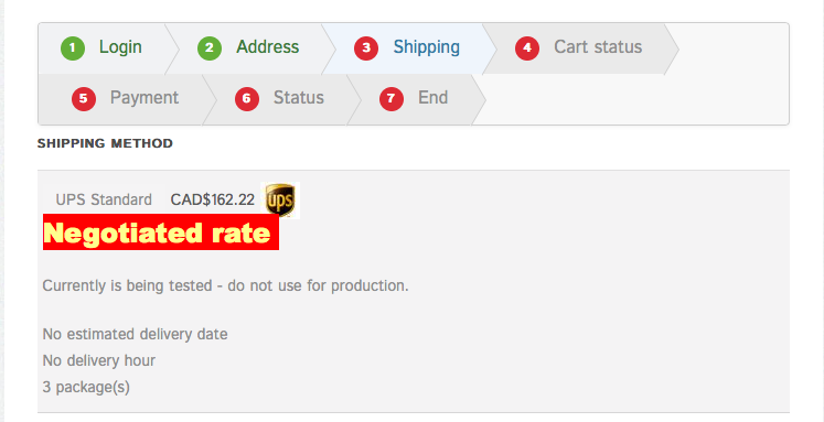

I cannot get my negotiated rates from UPS. When I log in to my UPS account I can see my negotiated rates but they are not returned when the plug in is displaying the rates. I have set "Negotiated Rates" to YES.

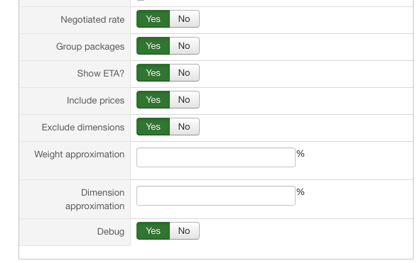

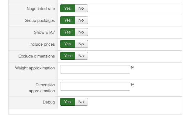

That's weird, in that case can you :
- Enable the "Debug" option of your UPS shipping configuration page
- Try it again and check in the comments of your Checkout workflow's HTML code ("f12") to directly see the code sent to the UPS platform
- Show it to me so that we can check differences for both case ( with one or multiple products in our cart).

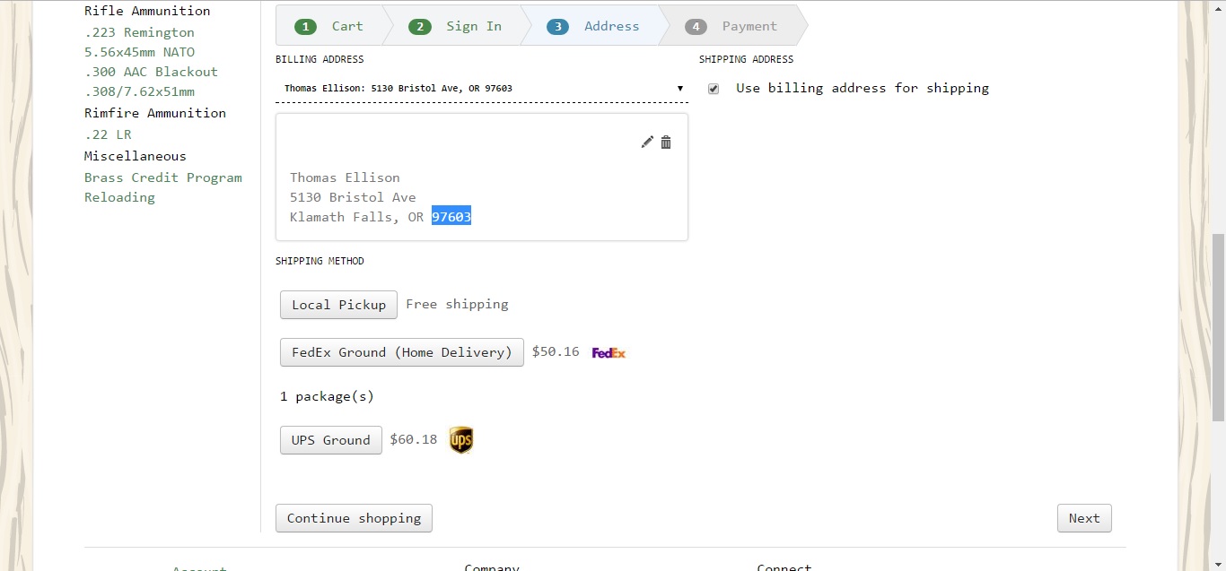

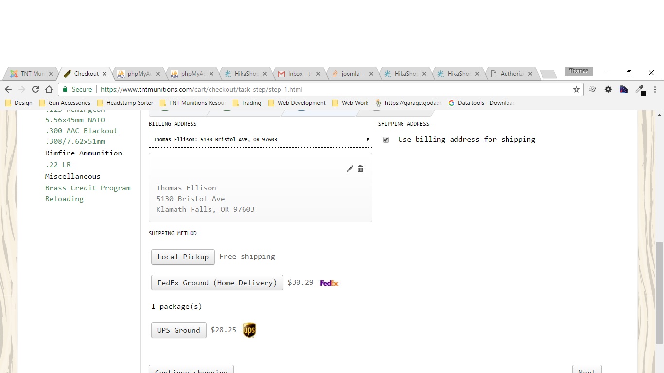

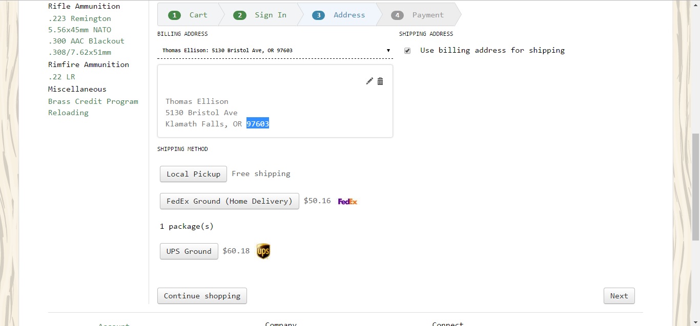

Ok I've got debug enabled. 2 products in the cart it comes back with a rate of $60.18. When I go to make the label in UPS World Ship the published rate that comes back is $58.43 and the negotiated rate is $49.74. If you add $1.75 to the $58.43 which is what I have set up for the shipping plugin you get $60.18 so it is definitely returning the published rate. Here's a screenshot of the checkout:
and here is the html code from debug:

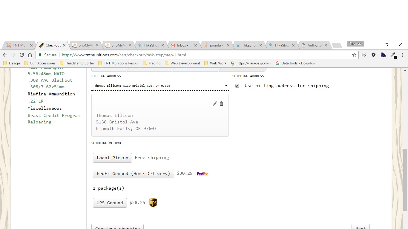

1 product in the cart it comes back with a rate of $28.25. When I go to make the label in UPS World Ship the published rate that comes back is $32.74 and the negotiated rate is $26.50. If you add $1.75 to the $26.50 which is what I have set up for the shipping plugin you get $28.25 so it is definitely returning the negotiated rate in this case. Here's a screenshot of the checkout:

9 years 6 months ago #264472

So instead of returning 71.51 + 1.75 (normal price), the UPS plugin is returning 58.43 + 1.75 = $60.18 (negotiated price) returned by UPS.

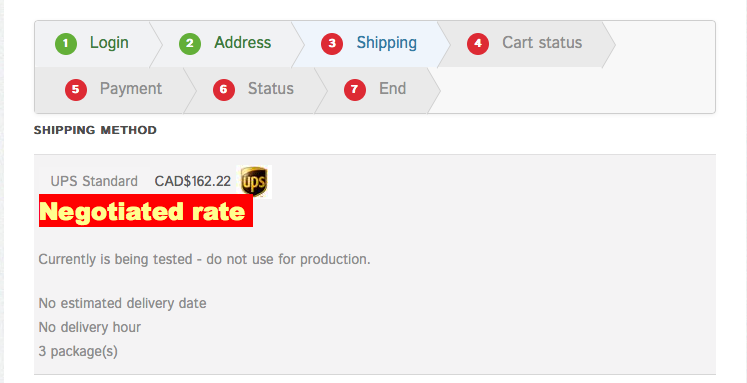

  • Posts: 8
9 years 6 months ago #264767
I have updated everything but still do not get the correct negotiated rates returned. Is there anyway to enter the default package size and a maximum weight fro each package, similar to what's on the UPS shipping website?

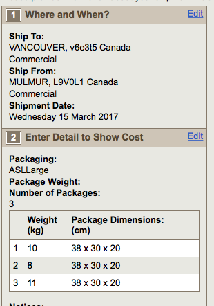

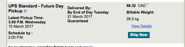

  • Posts: 8
9 years 6 months ago #264912

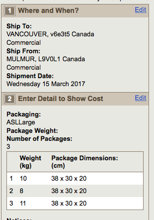

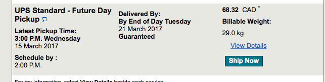

I have upgraded everything including the file you attached. Hockshop seems to be calculating the correct number of boxes but is not returning the correct shipping charge. I have attached the screen shot of the UPS Info and the info HikaShop shows.
All of our products are sized in metric. The ones in this example are 15x11.5x0.5 60g each. The boxes we use hold approx. 150 of these.
I just don't know where to start looking to get this working. The FedEx plug-in seems to work fine, I did a test using it but we don't ship with FedEx.
Any assistance will be appreciated.
9 years 6 months ago #264964
Can you also show us the code that was sent and received from the UPS platform ?
