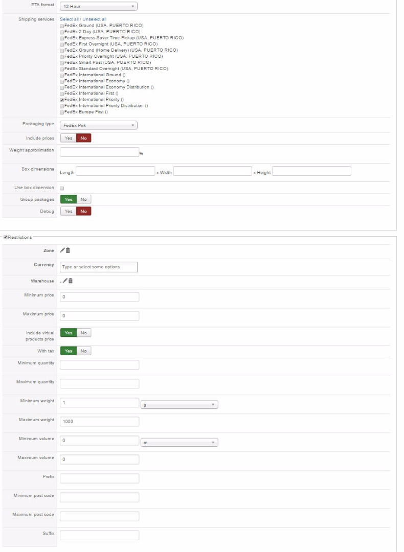

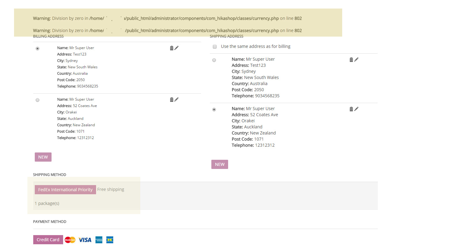

When I try to use the Fedex option 'Group Packages', it does two things:
1. All Fedex shipping returns as FREE SHIPPING in the Checkout page
2. I get this error: Warning: Division by zero in /home/xxxxx/public_html/administrator/components/com_hikashop/classes/currency.php on line 802
If I do not have the Group Packages selected then everything is OK and a price is returned from Fedex. But as it's making every product have its own package the end price is wrong.
Thanks!

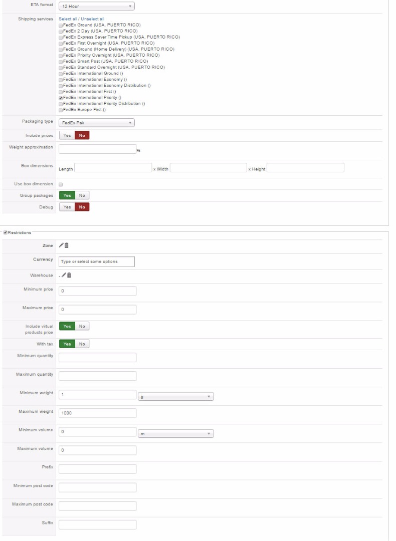

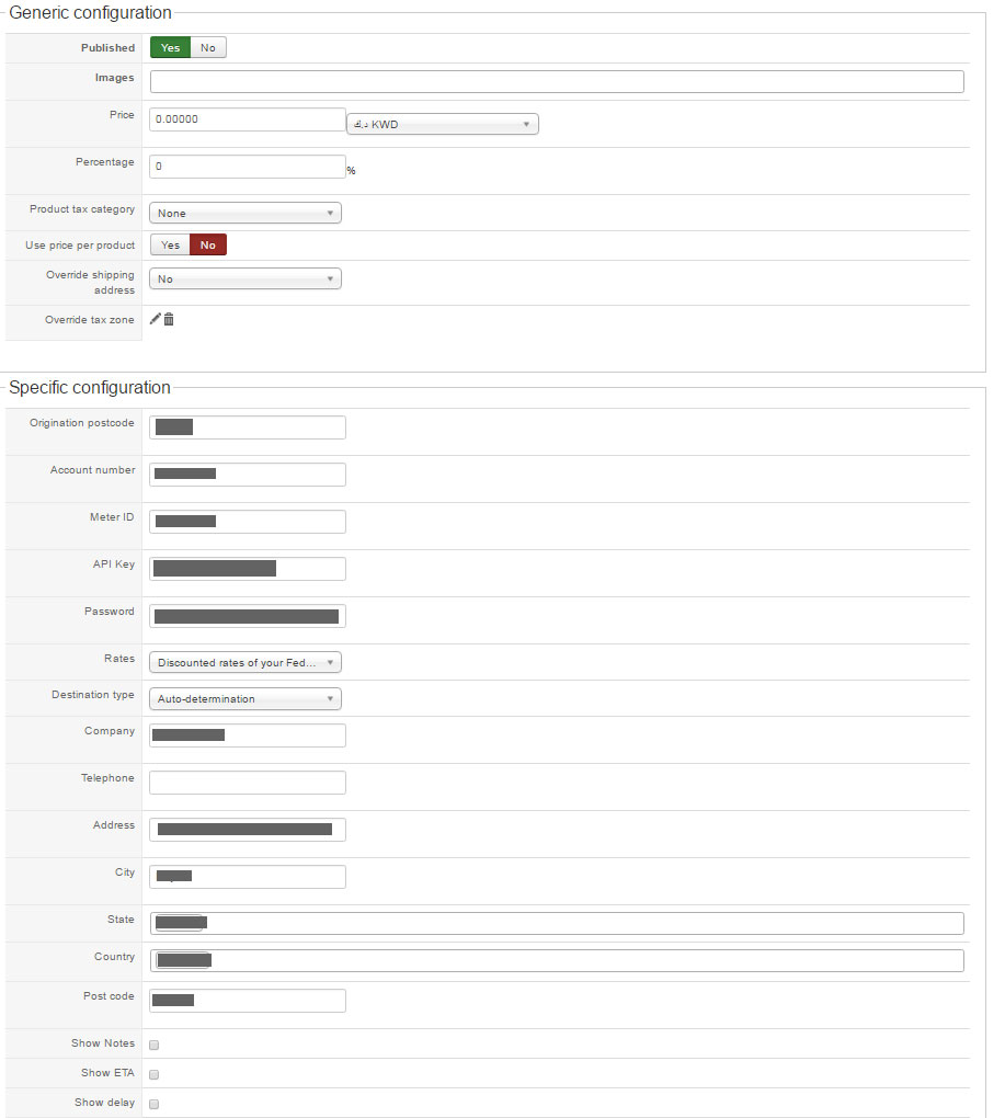

If you can't use the last Hikashop version, we'll need some screenshots of how you configured your :
- FedEx shipping method
- Products weight / dimension
- Checkout workflow via "Hikashop->System->Configuration->Checkout"
So that we can understand your issue.

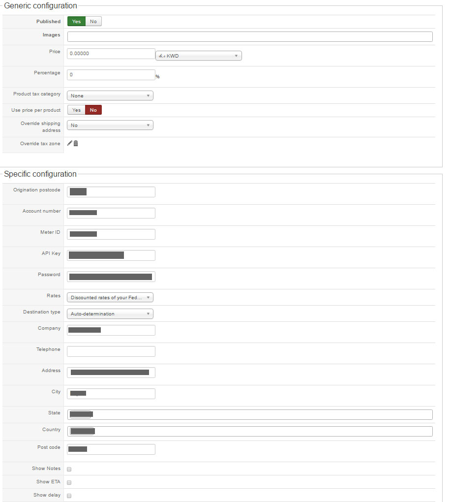

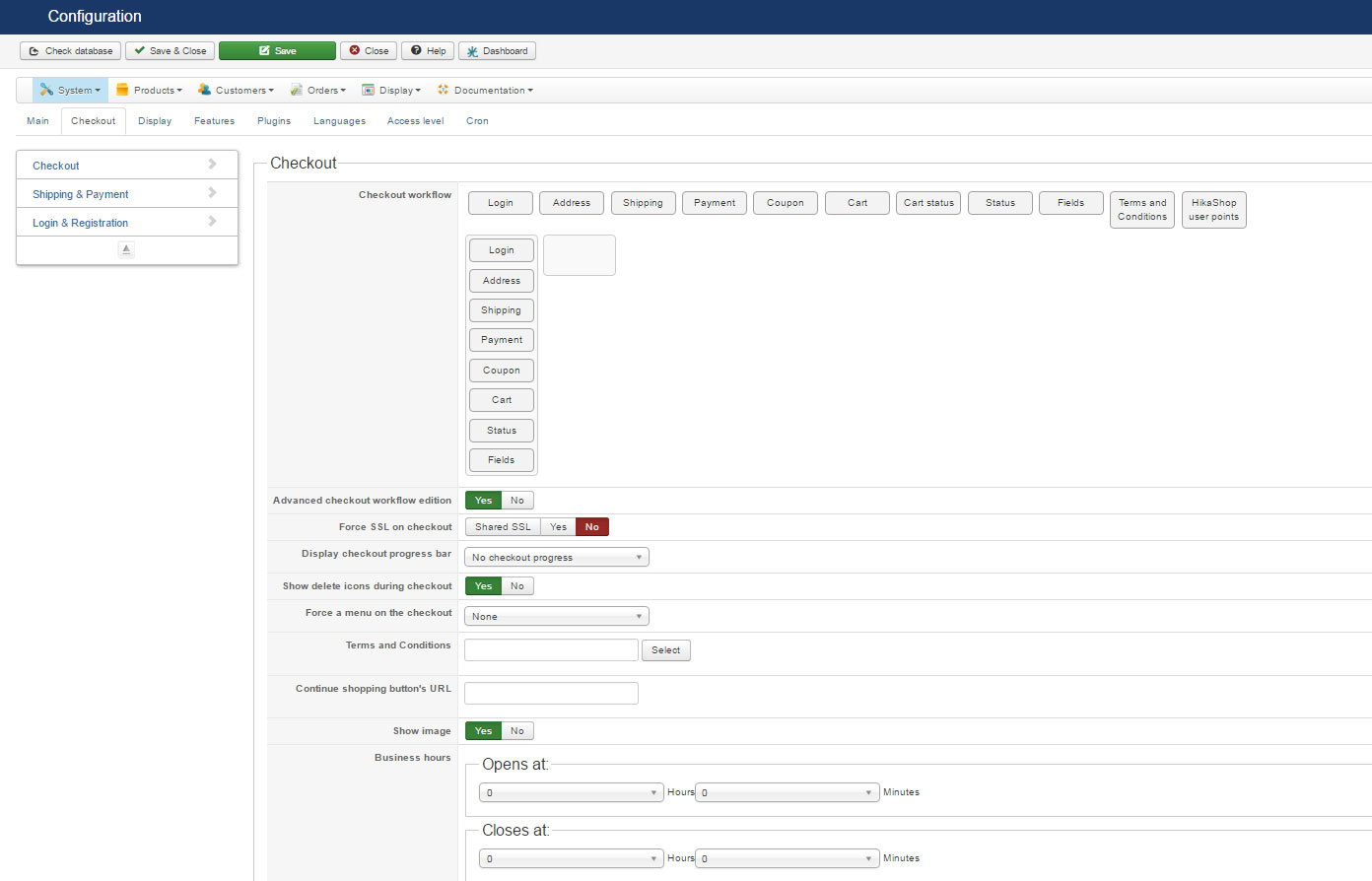

  • Posts: 27
9 years 4 months ago #264934
Thanks for your reply.
Images attached...
Last edit: 9 years 4 months ago by Rapid.
