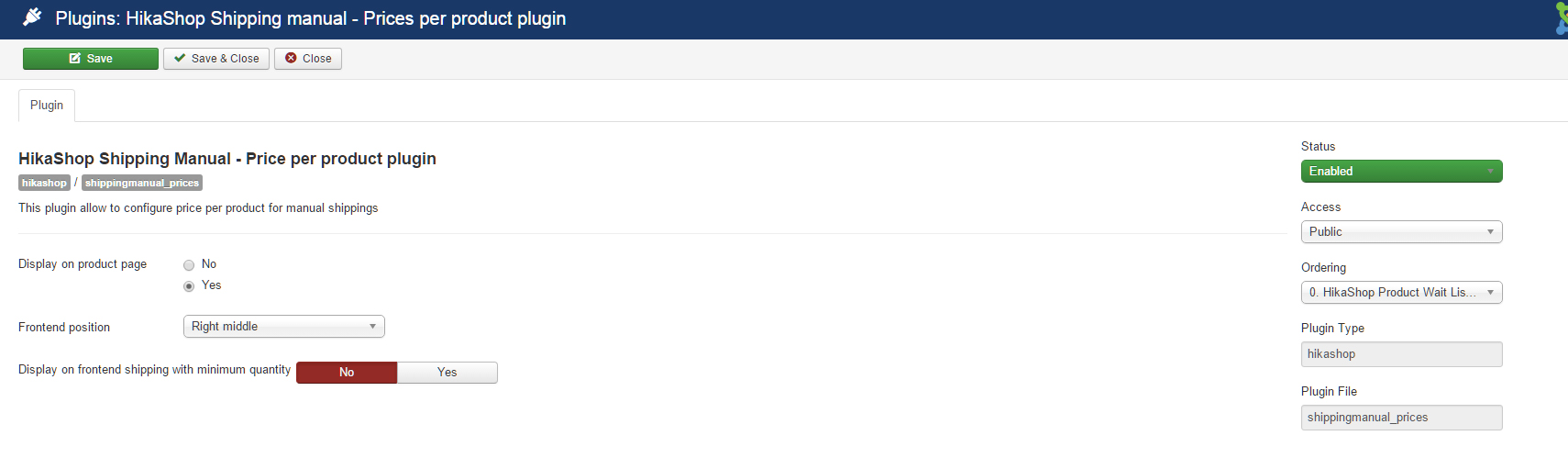

9 years 3 months ago #266753

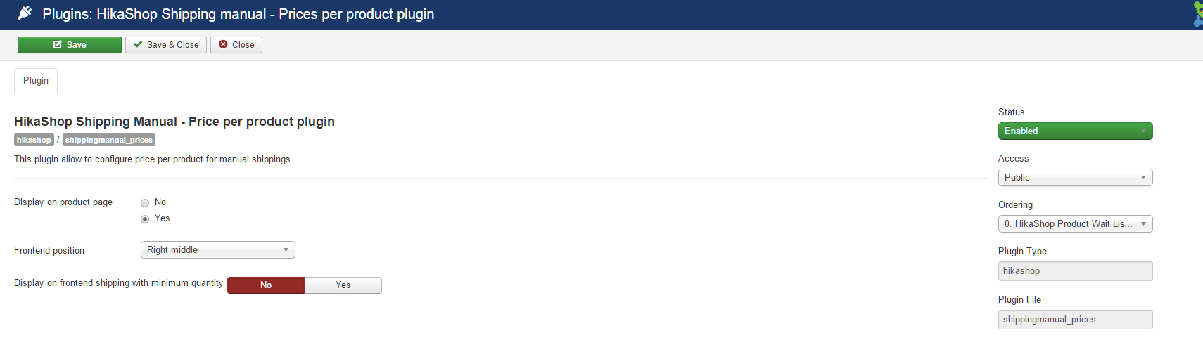

If you don't see any "Shipping prices" tab through your product configuration page, you'll have to publish the "HikaShop Shipping manual - Prices per product plugin" plugin.
  • Posts: 1183
  • Thank you received: 13
9 years 3 months ago #266823
the plugin is already published but i still don't see any shipping prices tab
Thank you
9 years 3 months ago #266837
Did you also set the "Use price per product" option to YES through your shipping method configuration page.

If you have properly published the "HikaShop Shipping manual - Prices per product plugin" plugin, can you check through your shipping methods configuration page that you have set the "Use price per product" to YES ?
Thank you.

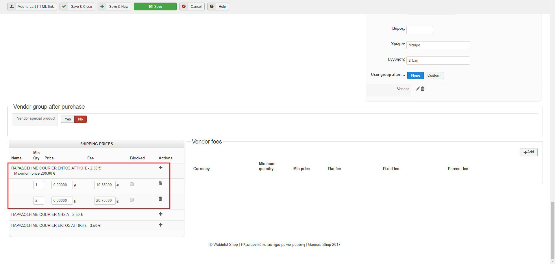

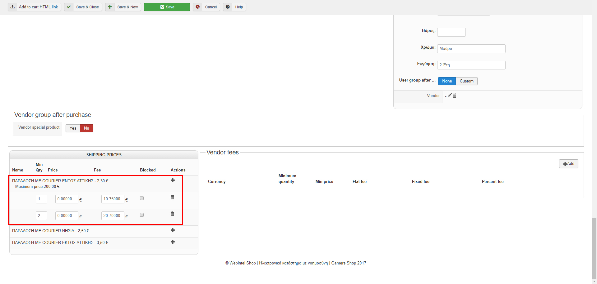

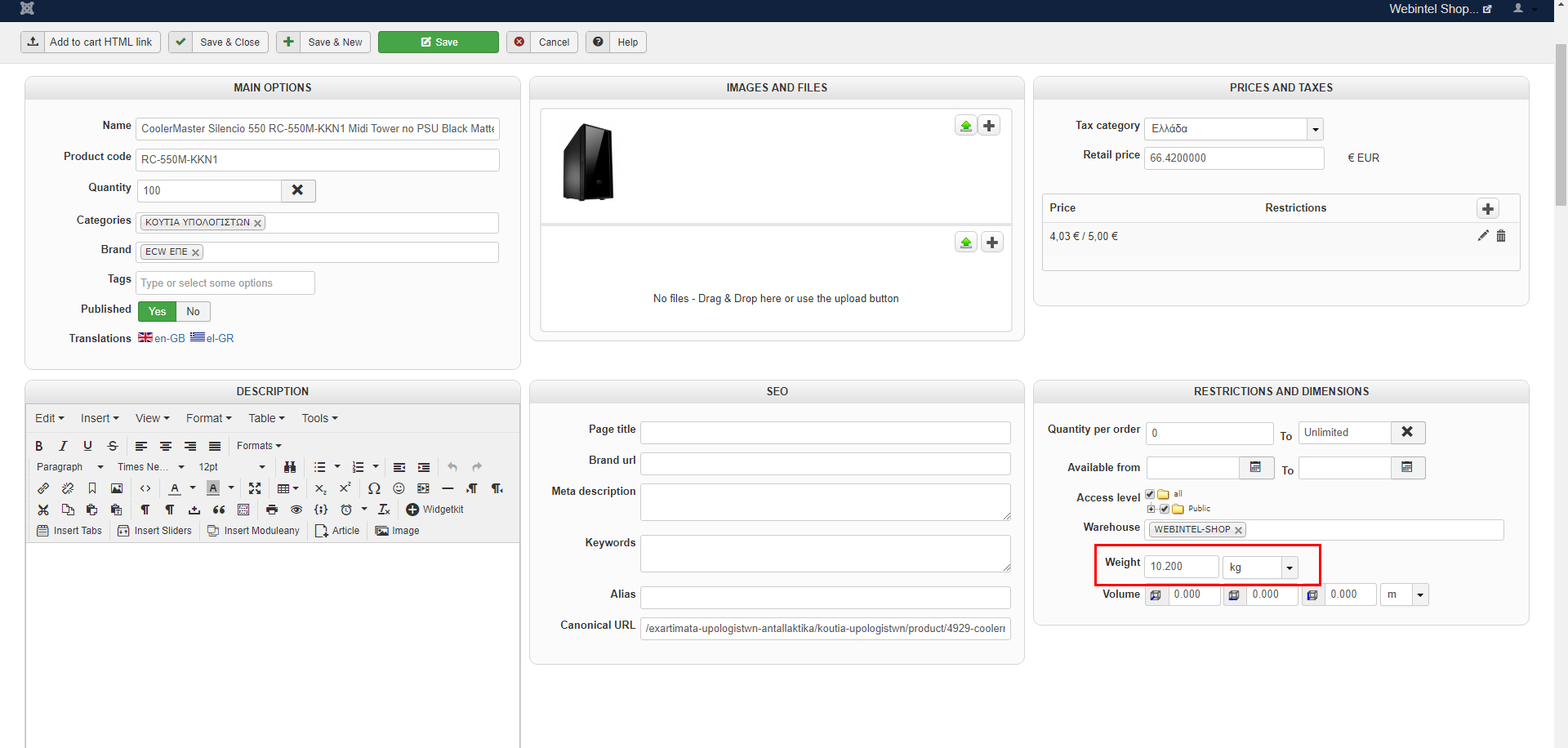

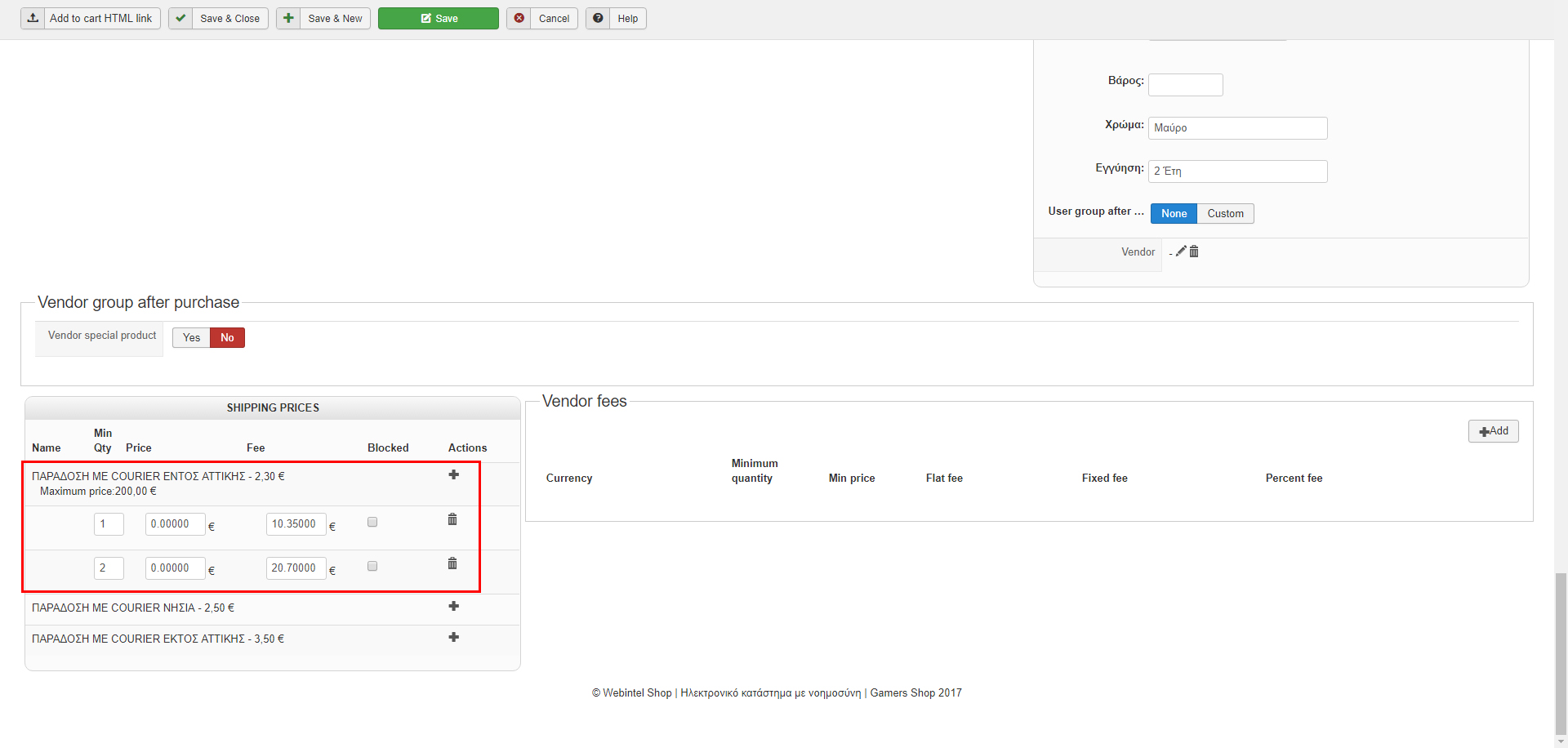

8 years 10 months ago #277672

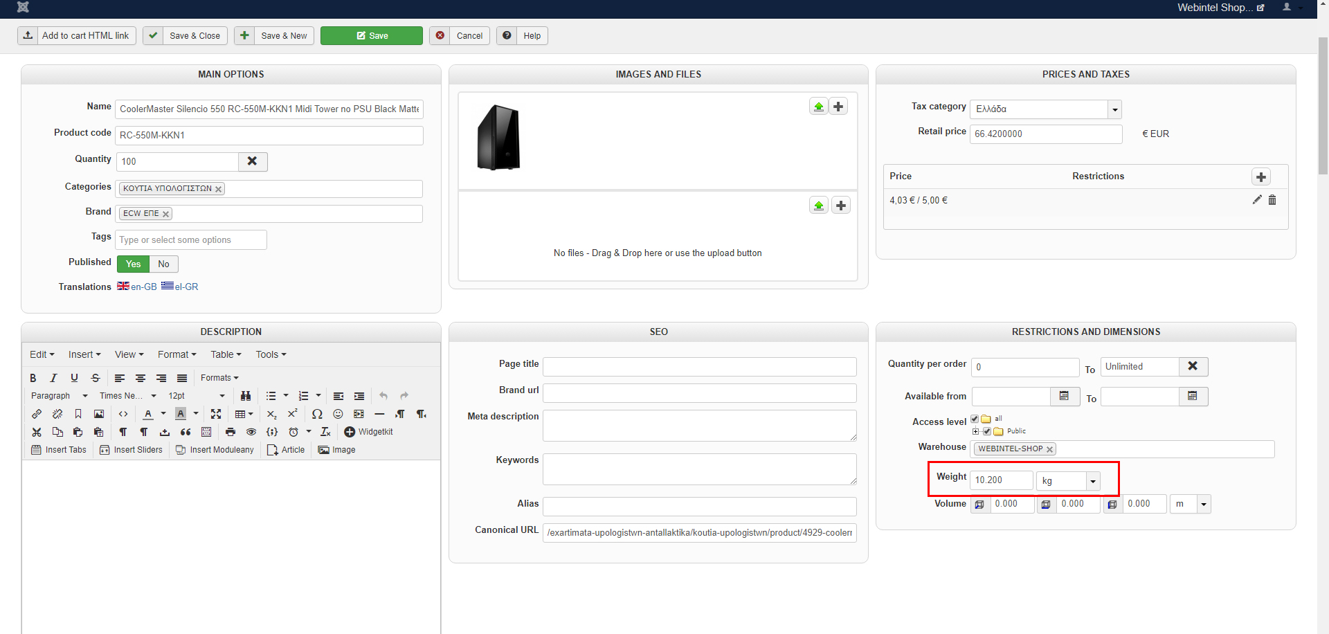

i have set "Use price per product" to yes, i have not filled in any prices per product, in the files attached you will see the configuration i did in the "shipping prices" tab in product configuration page.
The problem is that in this perticular product the weight is 10.200kg and if i understand correctly i have to add actions for every possible minimum quantity? Otherwise, if i add 2 quantities of this product (20.400kg) the extra cost should be: product price+cost of courier+23€ weight cost (1.15 for every extra kg).
Please i really need some help with this it's confusing!
Thank you again
8 years 10 months ago #277691
In that case, the best solution will probably be to directly set the "price" option to 10.35€ through the "Shipping prices" tab of your product configuration page.
