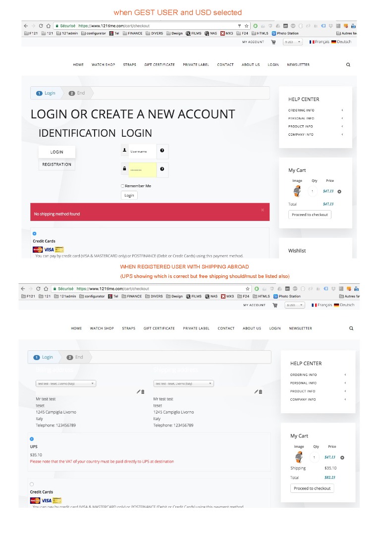

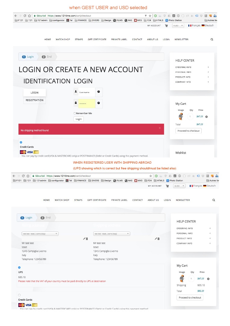

Hello support
I just noticed that I have the message "no shipping method found" anytime (and for all products) when I chose the USD currency.
If I switch to EUR of CHF, no issue but impossible to display a shipping method in USD
We have a manual shipping plugin for instance which is Swiss Post, free of charge for all products and without any restriction, I don't see why it isn't displayed when the USD (only) is selected?
Would you have an idea?
Thank you for your help
Jean-Loup

  • Posts: 166
  • Thank you received: 6

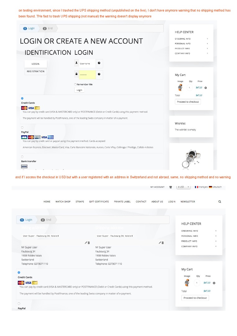

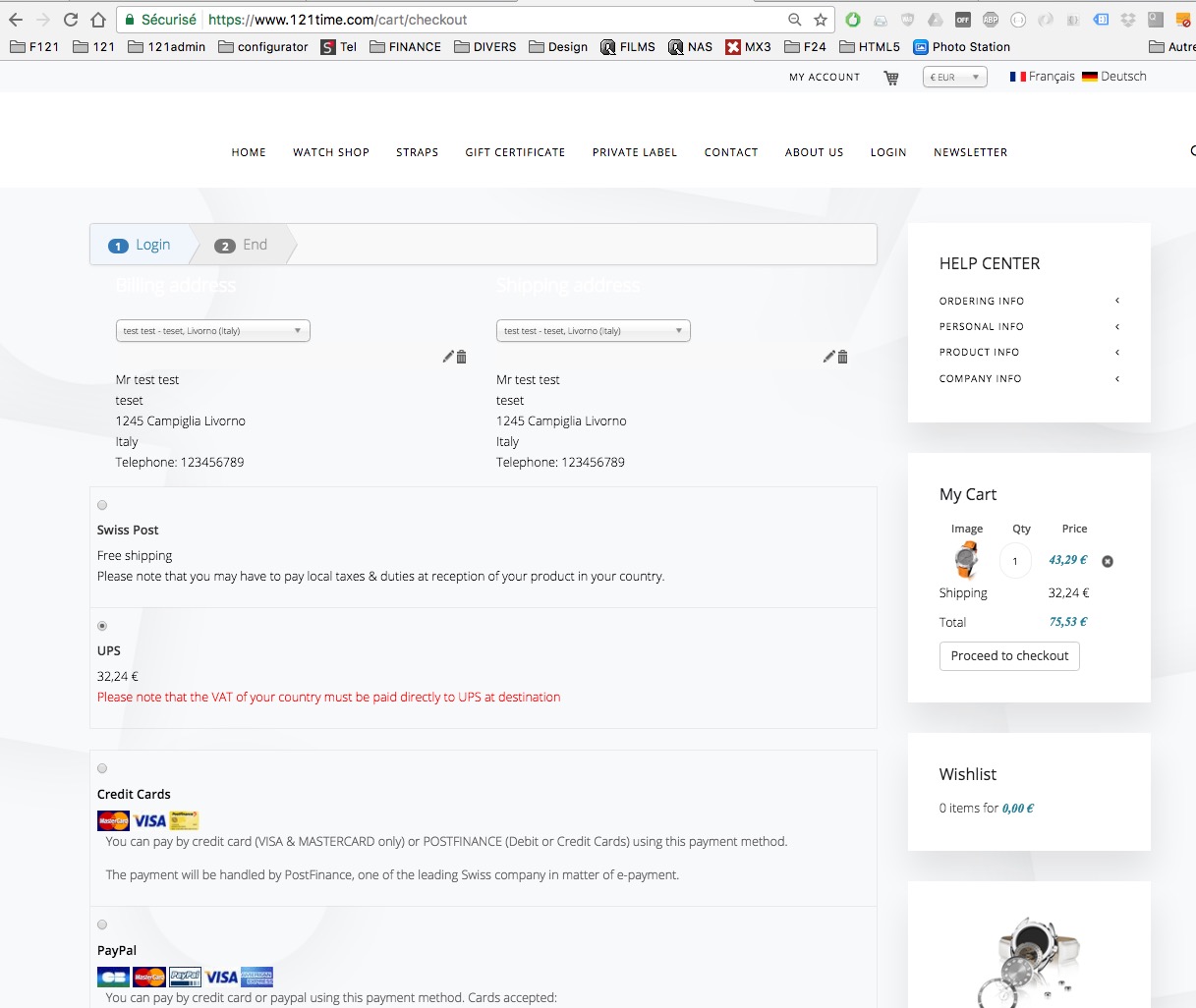

9 years 5 months ago #267038
IF I create an user with a delivery address abroad, then the UPS manual shipping method is coming which is correct.
But still no display of the free shipping method. Desperately trying to find an explanation...
With all currencies except USD both shipping method are displayed for guest users in the checkout page, which is basically correct but should be also with USD.
For information:
Swiss Post: No restrictions in plugin.
UPS EUROPE:
UPS Worldwide:
UPS America:
Shipping zone limitation (only)
All are manual shipping method with fixed amount for price except Swiss post which is free
Include virtual products: yes
Shipping zone: currency ”none” everywhere
Force shipping regardless of weight: YES
No manipulation of ISO codes of currencies
Please help, half our traffic comes from the US ;-)
thanks
Last edit: 9 years 5 months ago by jean-loup.

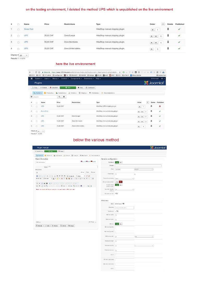

9 years 5 months ago #267041
Can you provide a complete configuration screenshot (with all view setup) ?
I suspect that something in your configuration leads you to this issue, but can be sure of it.
Especially, with the fact that you delete your shipping method and recreate it, as results you succeed to make it work as expected.
Awaiting news from you.
Last edit: 9 years 5 months ago by Philip.

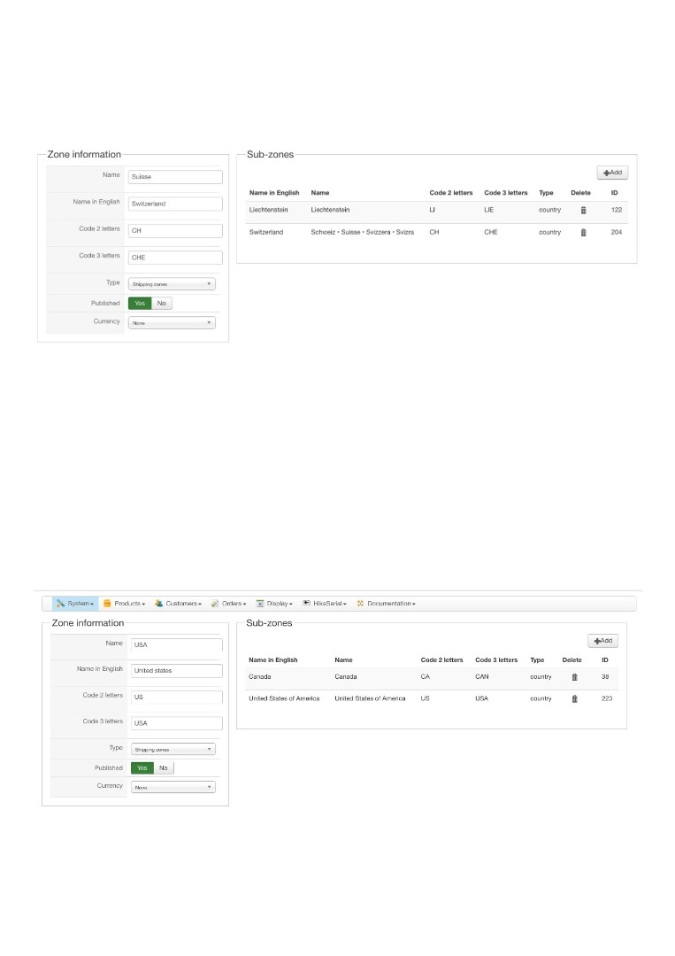

  • Posts: 166

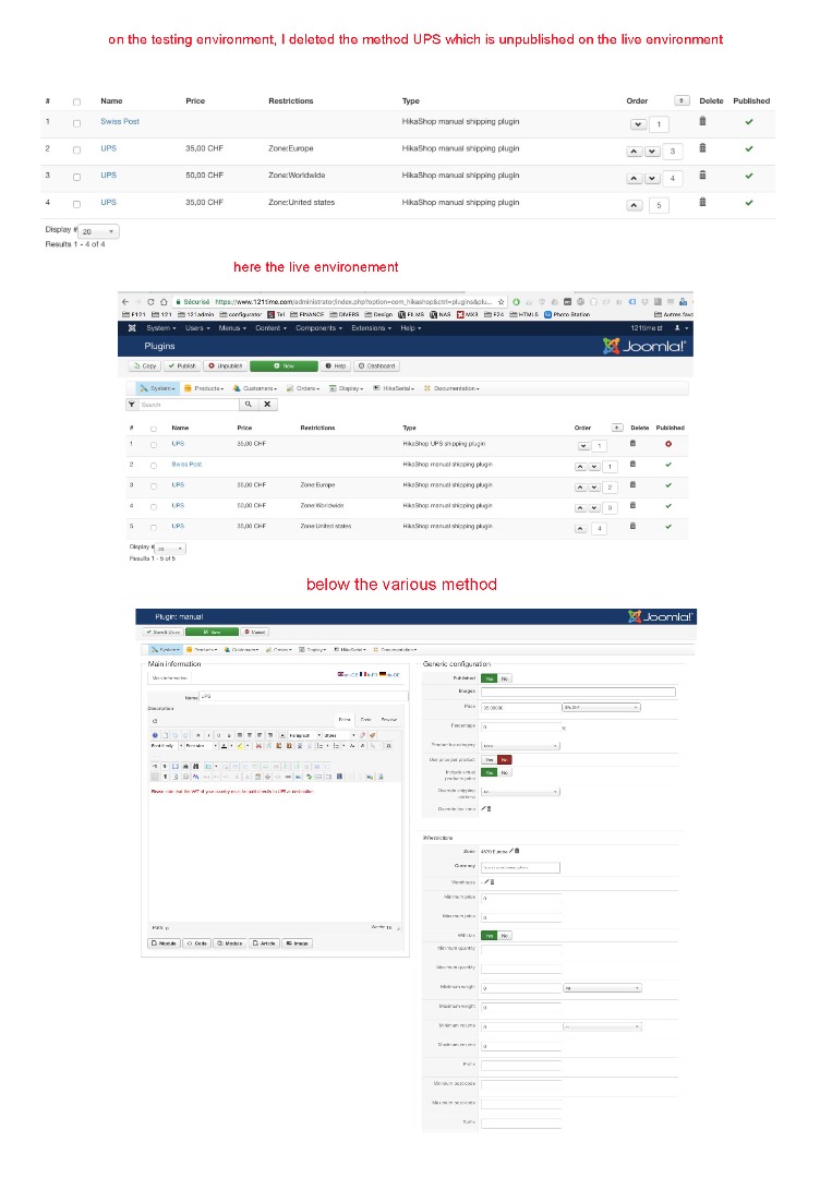

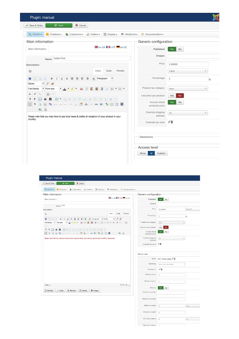

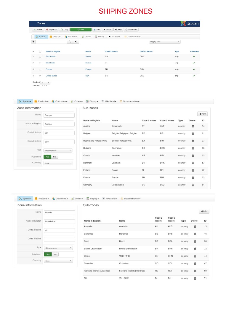

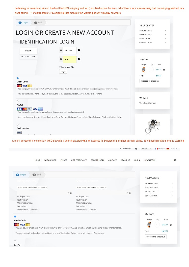

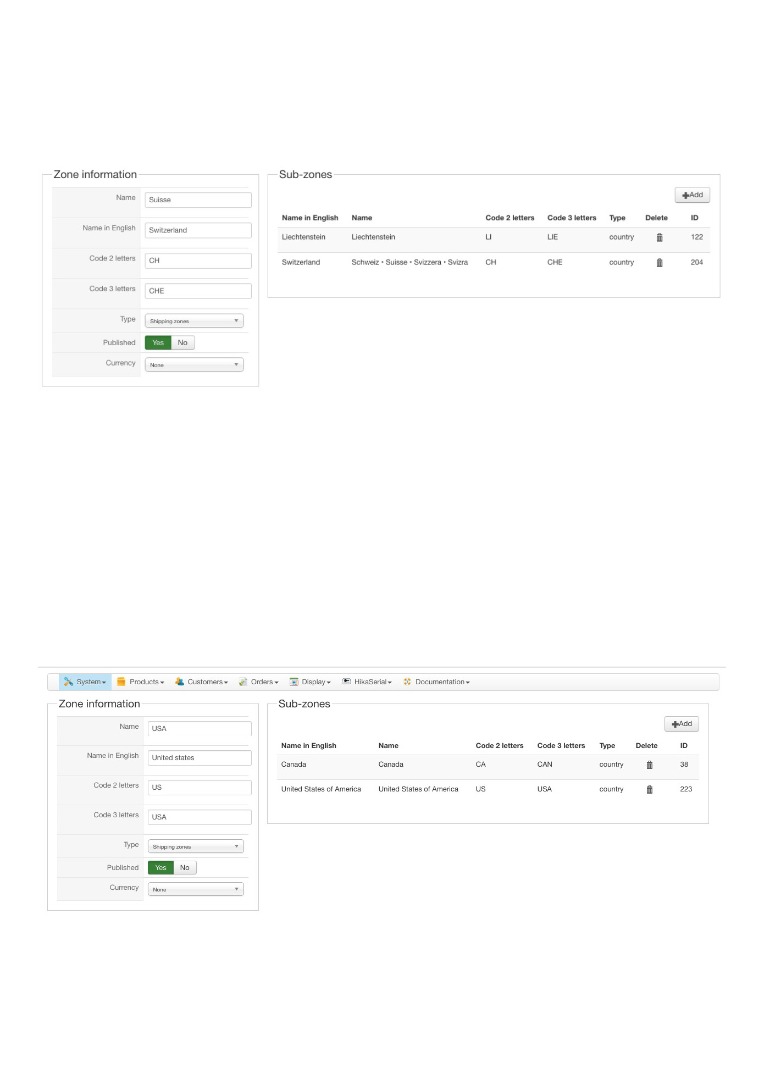

9 years 5 months ago #267134
thank you Philip, please find a pdf with all the screenshots.
It is with pleasure also I give you the access to our staging (or live) environment (testing has no cache at all, may help)
After hours and hours trying to understand the reason and after soon 2 year of intensive use of your fantastic software... I guess that it may be a bug... but I'm maybe wrong since I'm not a professional IT.
Jean-Loup

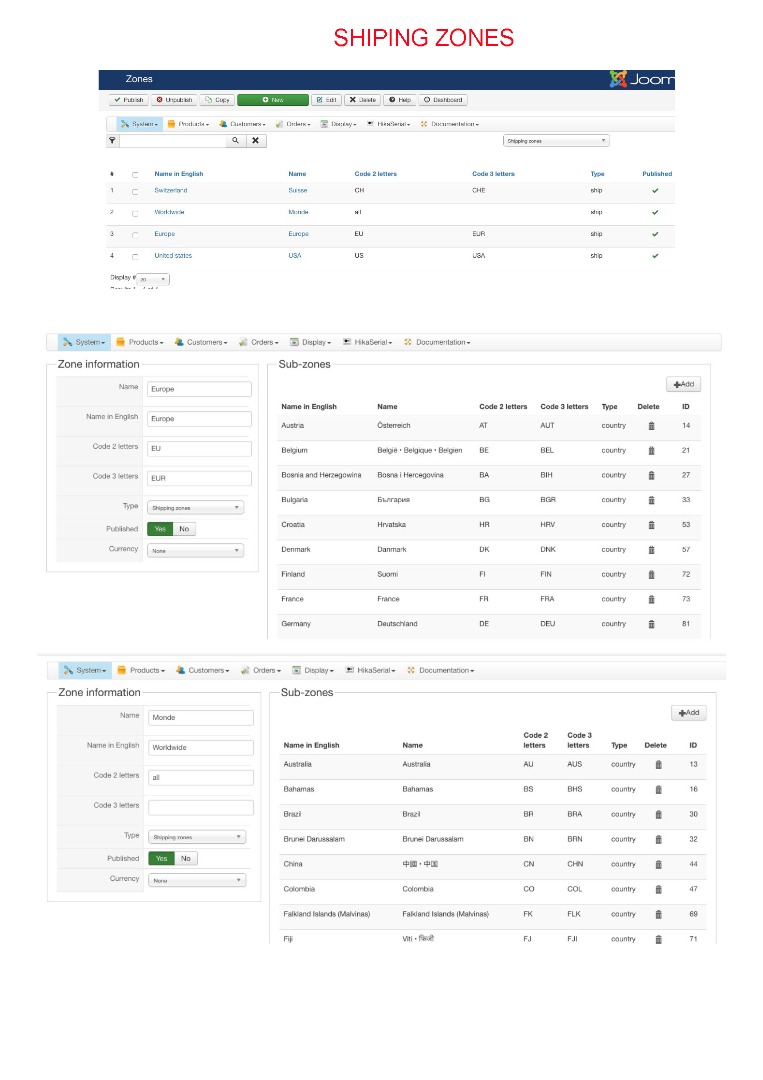

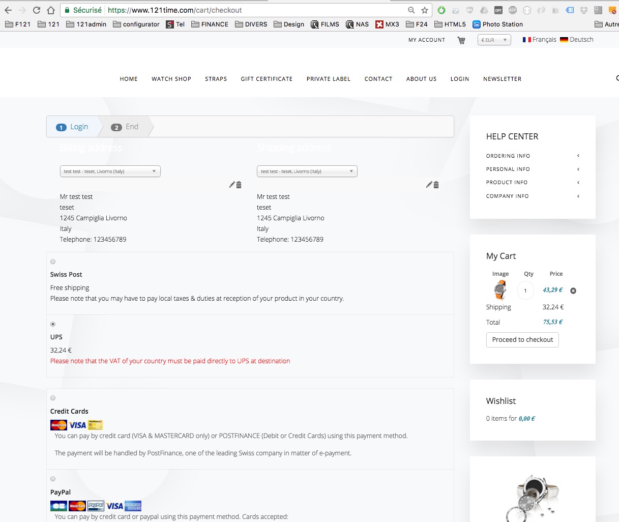

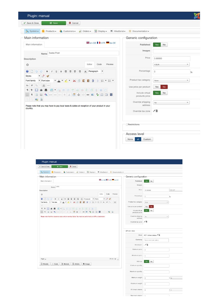

  • Posts: 166

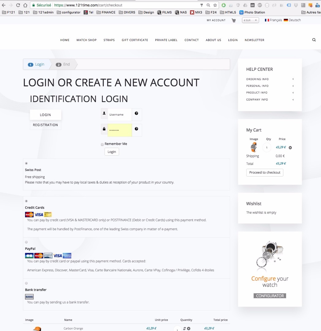

9 years 5 months ago #267135
and the normal display
please note that I couldn't upload a pdf with 8 pages and less than 2.9 MB
  • Posts: 166
9 years 5 months ago #267137
maybe easier to read, compressed pdf
9 years 5 months ago #267163

  • Posts: 166
9 years 5 months ago #267300
good morning
I see that it is working perfectly this morning on the testing servers??? Could you do anything in order to make it work???

  • Posts: 26386
  • Thank you received: 4078
9 years 5 months ago #267435
After a lot of tests with Mohamed, we saw that the problem was coming from JOTcache component.
By unpublishing all shipping methods, the one called "UPS" was still displayed ; it was then clear that it was related to the cache.
So we have added exceptions for HikaShop / HikaSerial in JOTcache configuration and it was then working fine.
If you change your configuration, if you unpublish and change content and in the front-end the content is not up-to-date ; it's related to the cache.
And if you have issues when you're not logged and you do not have the same issues when you are ; it is also a sign for cache issues.
The following user(s) said Thank You: jean-loup
