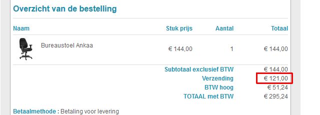

I'm looking for the right string to modify in the confimation email that goes to the client.
In this email the shipping is showed with tax and I would like to show it without tax.
FYI : The setting of the site is to show both prices but on some parts of the site the displaying of prices is changed because that is what the customer would like to see.
I've managed to change the price display by changing the strings used to the ones without tax. This I managed to find on the forum myself but I have had no luck with changing the shippingprice.
Thanks in advance

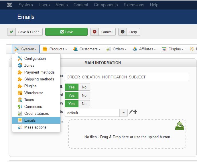

Hi Jerome,
Appologies for not changing the code the correct way :(
The email I'm trying to change is the one that is send when an order is created. (Configuration > System > Email).
There I select the order created mail and do the change in the Pre-load block.
I test by creating an order and see what's in the email that is send.

Is just tested again if I'm in the right file and it's the "order creation notification" email I need to edit.
Testing with an extra piece in the HTML part is showing this in the confirmation email.
What I did not get right is the syntax for not showing the tax on the shipping.
Anyone willing to help with this by sending a piece of code that I can try ?

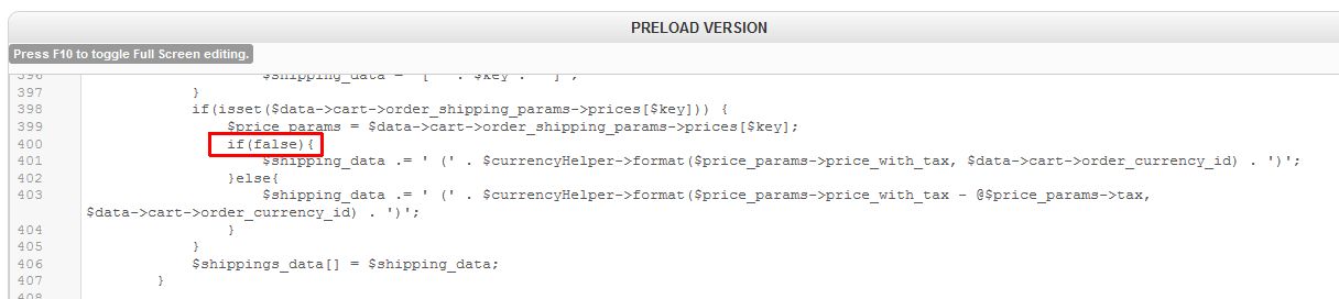

  • Posts: 341
  • Thank you received: 27
9 years 4 months ago #268453
I did exactly what you suggested but the confirmation email still shows the shipping price with tax.
Tried the same modification on my clean development site and here it also shows the shipping with tax in the order creation notification email.
Sorry about the trouble but it looks like it's really not changing anything.
  • Posts: 86183
9 years 4 months ago #268455
Well, I don't know what you're doing wrong. Or maybe we're not talking about the same thing.
Please provide screenshots of the situation and the modifications, etc so that we can better understand.

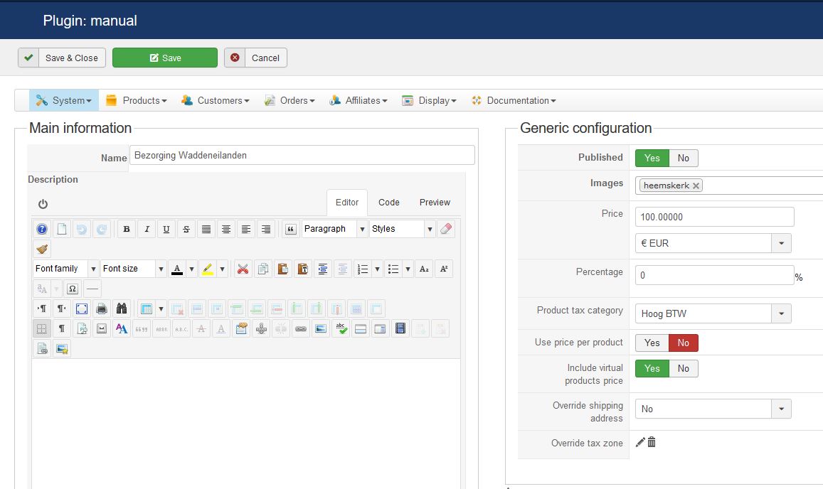

  • Posts: 341
9 years 4 months ago #268483
Here are some screenshots of the config and the changes I made.
