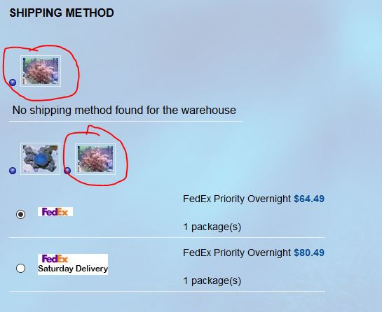

-- Error-message(debug-mod must be tuned on) -- : No shipping method found for the warehouse: 1
When ordering more than one variant of an item, we get "No shipping method found for the warehouse: 1" when trying to checkout. Ordering either of the variants separately works fine, it is only when ordering 2 or more variations of the same item, any item.

Ok the error comes up when two different variants from the same item are chosen. In this case the site sells tropical fish and corals. The corals come in different sizes. If someone chooses a single size of coral, the order and shipping method work fine. But if they want two sizes of coral for example a 2" one and a 4" one, then the error stating that there is no shipping method found for that warehouse. If you remove either of the variants, doesn't matter which one, it works fine.

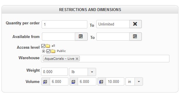

My main question would be about your warehouses.
What is your warehouse configuration ? (and why are you using these warehouses ?).
I don't have the impression that it's the dynamic warehouse system from HikaMarket since there is no title for the warehouses (because HikaMarket name the dynamic warehouses with the name of the vendor).
Afterwards, it would be information about your product and its variants.

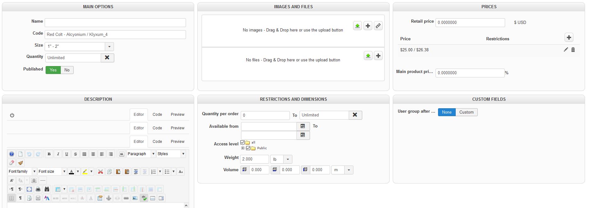

How the warehouse is assigned ? Only on the main product ? What is the variant settings about that ?

The only place to assign a warehouse is on the main product. I've included some screen shots of the main item warehouse setup and of the variant's setup.
Thanks!
8 years 11 months ago #276600
We were able to reproduce that issue on our end, and we have added a fix through the last Hikashop version that you can download through our website.
