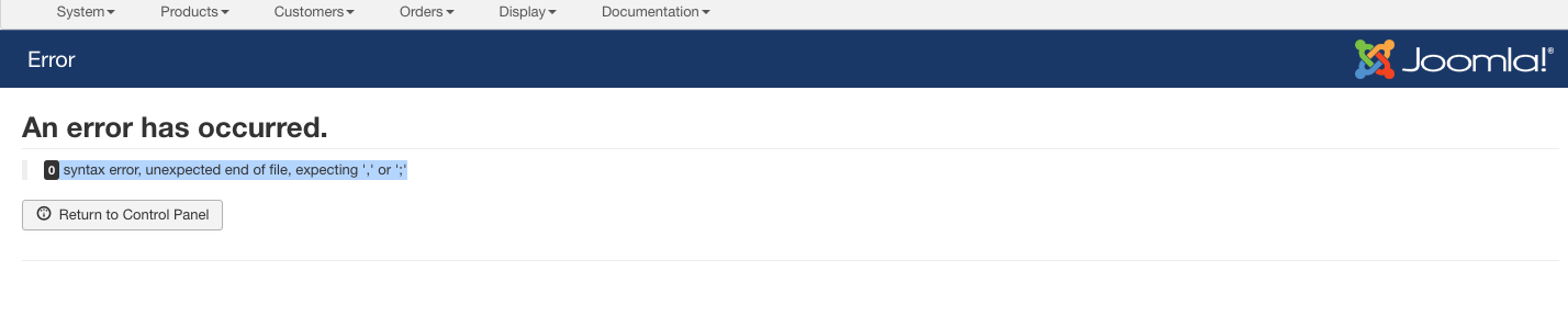

This is the error in Debug Mode :
An error has occurred.
0 syntax error, unexpected end of file, expecting ',' or ';'

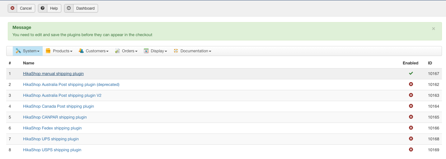

  • Posts: 89
9 years 2 months ago #273188
This is the Errors Log attached.
My Screen before the error is attached and obviously I am not able to reproduce the error as the Demo is Hikashop Business and I have Hikashop Essential.

  • Posts: 86183
9 years 2 months ago #273201
That log doesn't contain the error message relative to your problem.
So it looks like the issue is linked to the manual shipping methods plugin on your website.
If you try with another shipping method, do you have the same problem ?
If you rename temporarily the folder plugins/hikashopshipping/manual do you have the same error ?
This looks like you have a corrupt file on your website like you would get if one file of HikaShop was not transfered completely when uploading all the files of the website to your hosting via FTP.
So downloading again the HikaShop install package on our website and installing it on yours again might help.
